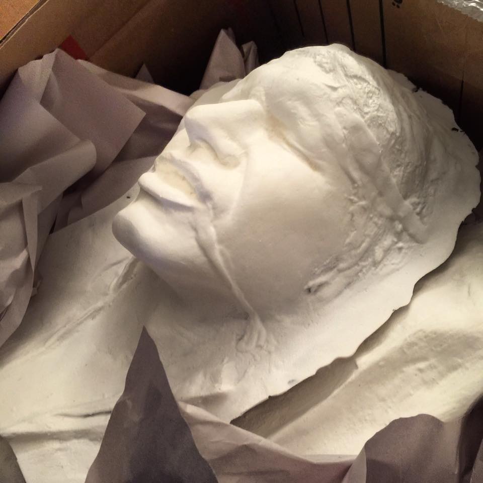

Because my door was going to be slightly smaller than the original, I opted for KingJawa's cast that was cut and came in pieces, which would make it easier to fit my needs.
I contacted KingJawa and got my Han within 2 weeks.
The cast is a bit rough, requires some dremeling, light sanding and bondo. But overall, I am pleased with it.

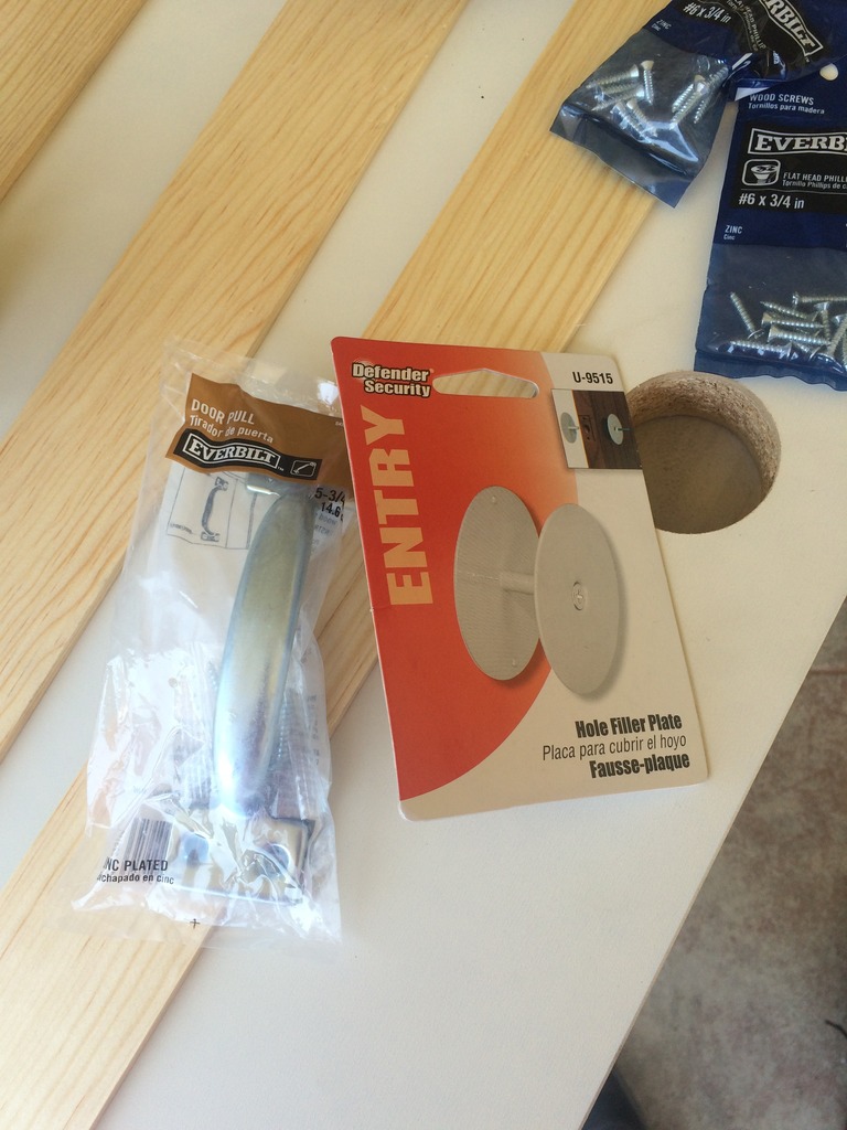

I also picked up this door hole filler plate. I will not use a door knob and will opt for handle.

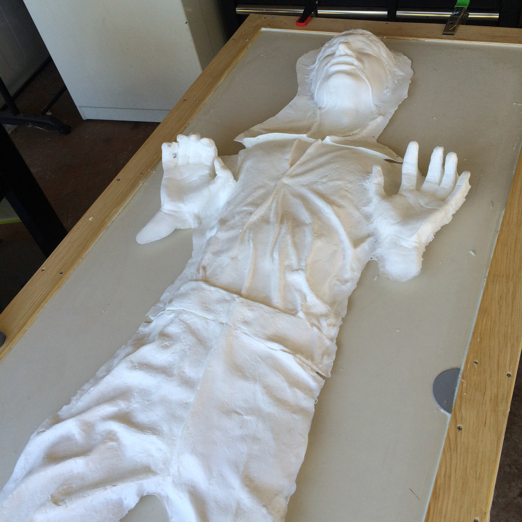

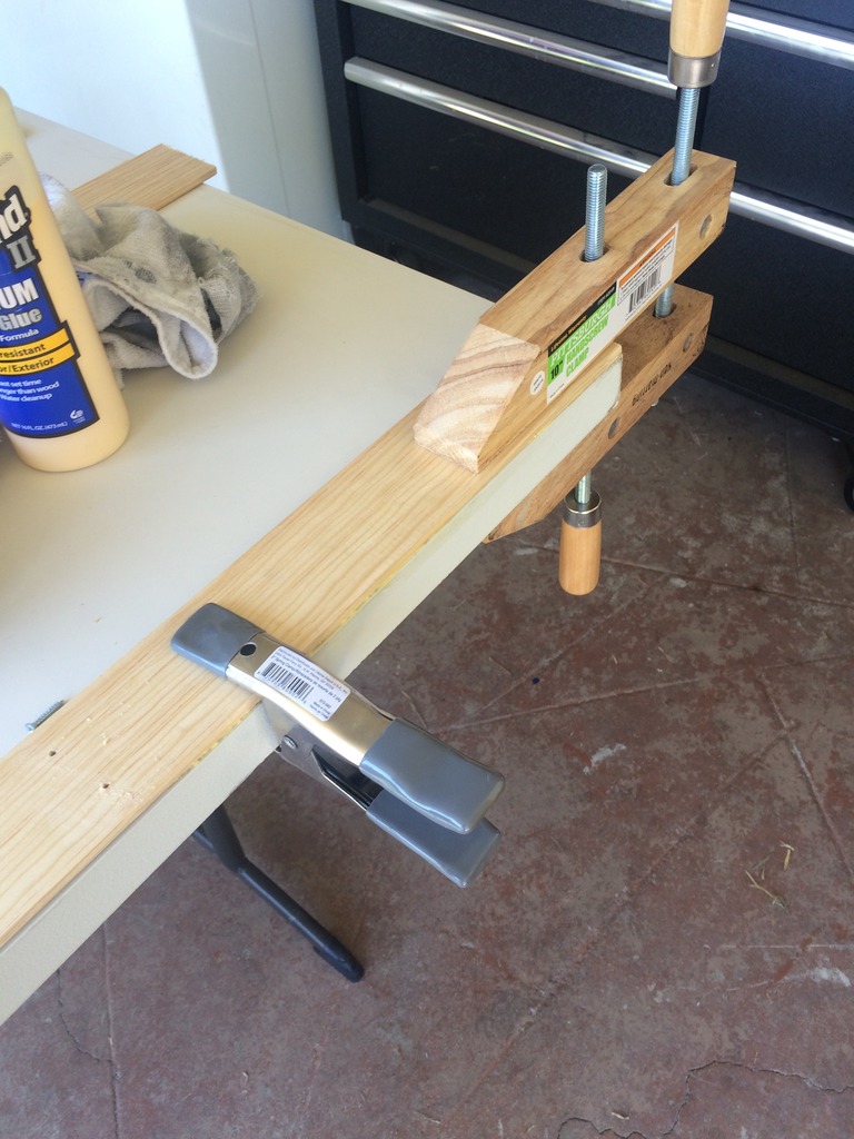

On to cutting the pine to fit the frame, wood glue, screws and clamps to secure with panel edges:

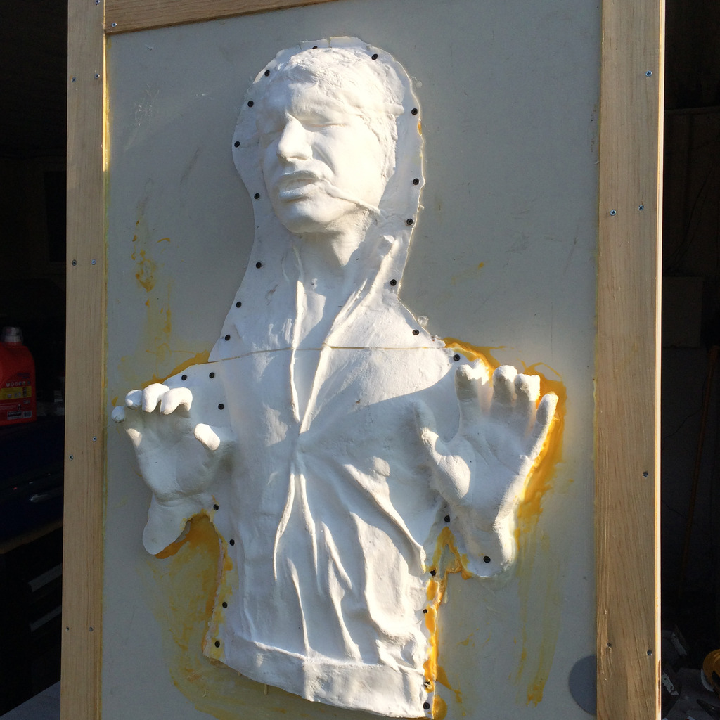

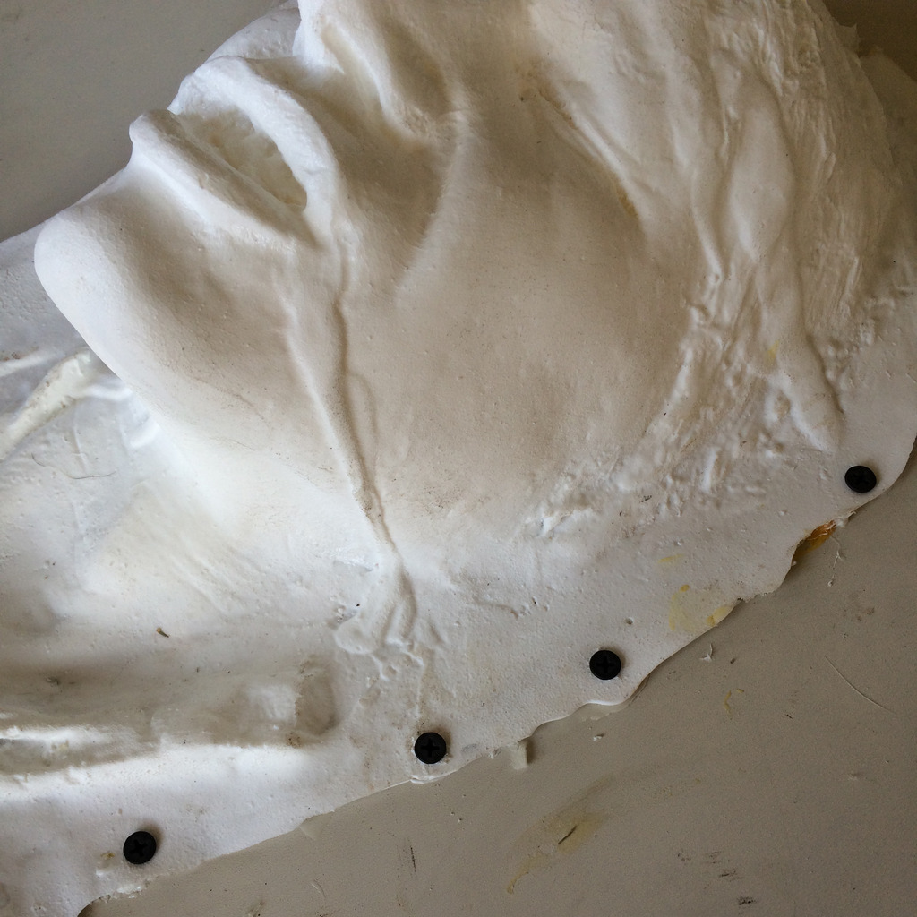

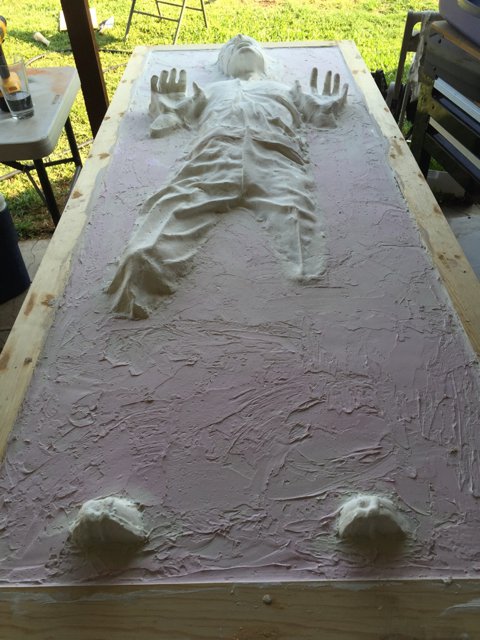

On to the placement of Han. King Jawa's cast came foam filled and it was not done precisely. The foam, required trimming that was not as fun as it sounds in order for the cast to lay flat.
In order to secure Han onto the door, I used a combination or epoxy, wood glue and screws. It was not pretty, but it worked. You only need glue/epoxy where the mold and foam
backing makes contact with door.

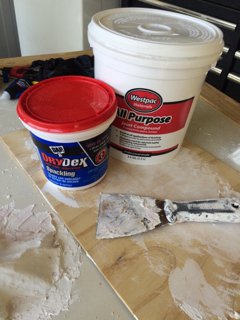

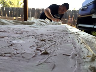

In order to start applying the texture. I went with a recommended mix of half joint compound and quick dry spackling.

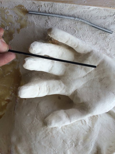

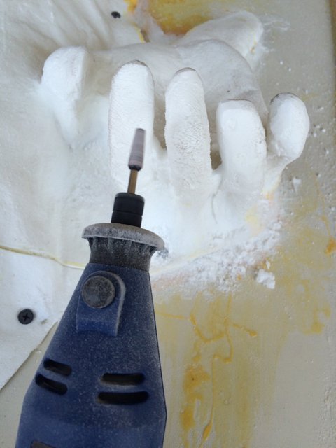

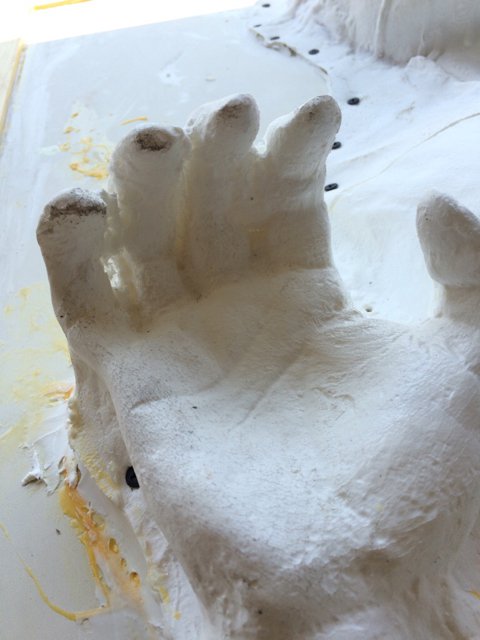

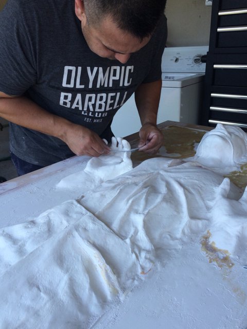

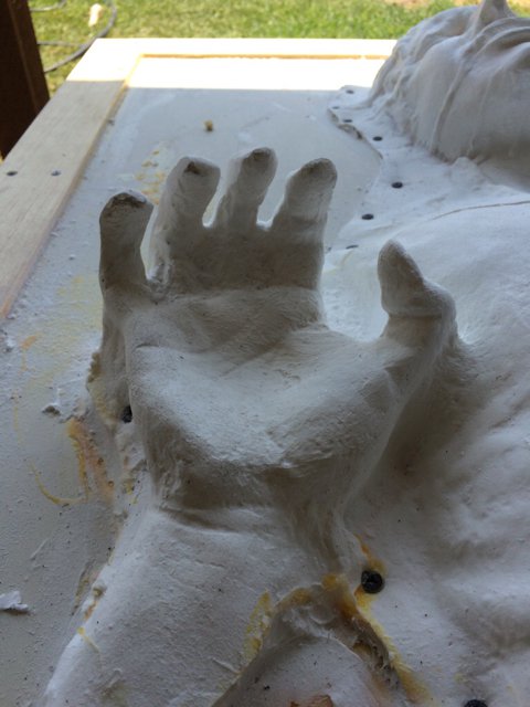

KingJawas mold needed some light sanding and clean up to smooth parts out. One of the areas I really cleaned up was the webbing between the fingers.
I Dremel to my preference to have a cleaner visual of Han's hands

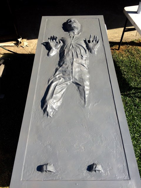

Progress is moving along.
I finished up the last of Han's hands using thin and flexiable sanding sticks found at Hobby Lobby.

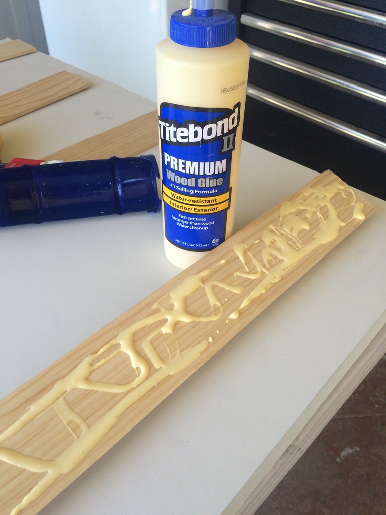

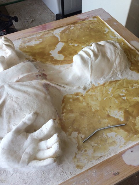

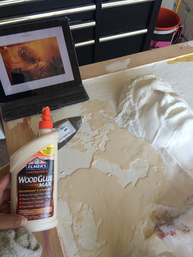

Next, I added the last layer of texture. I used wood glue to help give me the frozen liquid look as seen in the reference images.
I layed down the glue in the pattern I wanted and spread it thin. I did this in a overlay pattern, allowing sections to dry before layering again
I am pretty pleased with the outcome. Tommorrow, the painting begins!!!

1 can covered most of it. I let it dry an hour before hitting it with the second can.
2nd coat of primer
