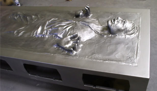

Han in Carbonite. The madness finally begins!
i had one of my rubber HIC's used as a table. it looked amazing. Another guy put one into the hood of his car. Ill see if i can find the pics.

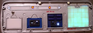

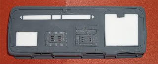

Here's the panel with the areas going to be lit hollowed out.

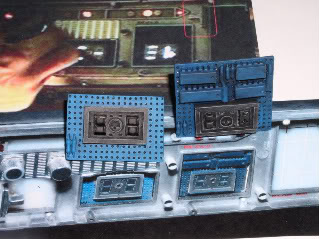

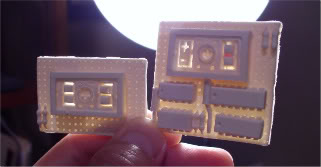

Here's the two digital displays. They were cast hollow to make it easier to cut out the counter area. Pic on the left is the straight cast. The one on the right has the areas lit hollowed out with an exacto knife. If I'm going to have each part of the digital counters blinking then it looks like I'll need 13 LEDs for this part.
I'm going to need to isolate the LEDs so there won't be any light leaks. Will use a 1/4th rod that happens to fit a 5mm LED perfectly. I crimped one end of the aluminum rod to get the shape closer to the digital display. Pic on the right is the back side with the rods superglued in place. I added exoxie putty to the backs of both to give it extra support to the aluminum rods (small pic on the bottom).
Here's the panel primed and with the white translucent plastic sheet cut and dry fitted in place kinda like what I did with the aluminum sheets for panels 3 thru 8. Translucent sheet was obtained from Mr. Wise of Rebelscum.com (thanks again!).
Here's a test shot of the LEDs to check for light leaks. All the lights will be blinking yellow on the digital displays and I have them on order, so I'm using a blue and red LED for this test til my shipment of LEDs arrive.

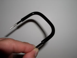

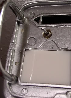

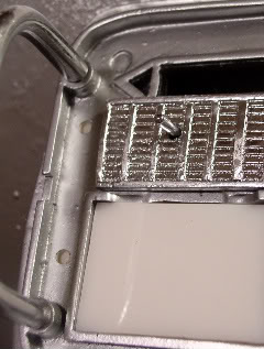

Wanted to give the handle bars some support so I drilled a hole in the bottom and glued a rod in place. I drilled holes thru the panel itself so it can receive the reinforced rod.

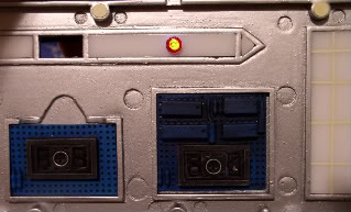

Here I'm trying to match the colors on the digital displays.

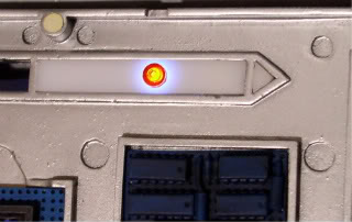

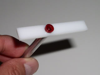

Here's one of the lights on the plexi strip. Greeblie was painted with transparent red and a rod glued to the back hold the LED. 2nd pic is the strip installed with light leak test. You can see a slight halo around the red greeblie part.
Painted the inside of the rod and the plexi with black and it seemed to take care of the light halo.

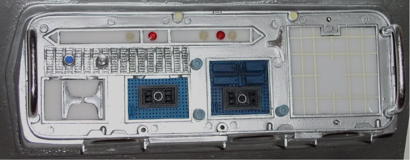

And here's my Hero Panel with all the parts positioned in place. Nothing glued down yet. Still waiting for the LEDs so that's where I'm at for now. Thanks again for looking!

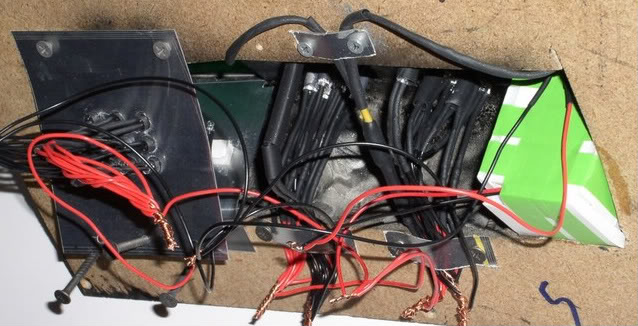

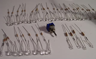

Here we go with the LEDs wired up with the resistors. Going to use 13 5mm LEDs for the blinking digital display, 4 3mm LEDs for the plexi strip, and maybe 5 5mm LEDs for the large green square.

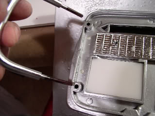

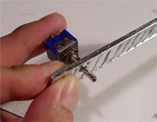

Here's the ON/OFF switch. It's going behind the metal looking bar that sits just below the plexi strip and one of the knobs will hide the switch.

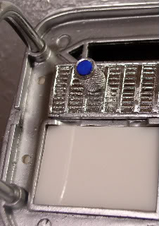

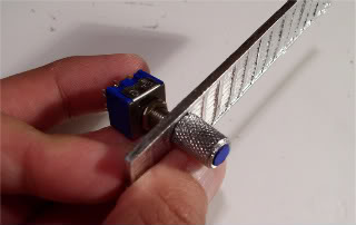

Here's the switch screwed in place, with the metal looking bar, and knob that will hide it.

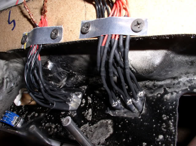

Here's a shot of the back of the Hero Panel with the 13 blinking LEDs wired up. Not a pretty site but it will do.

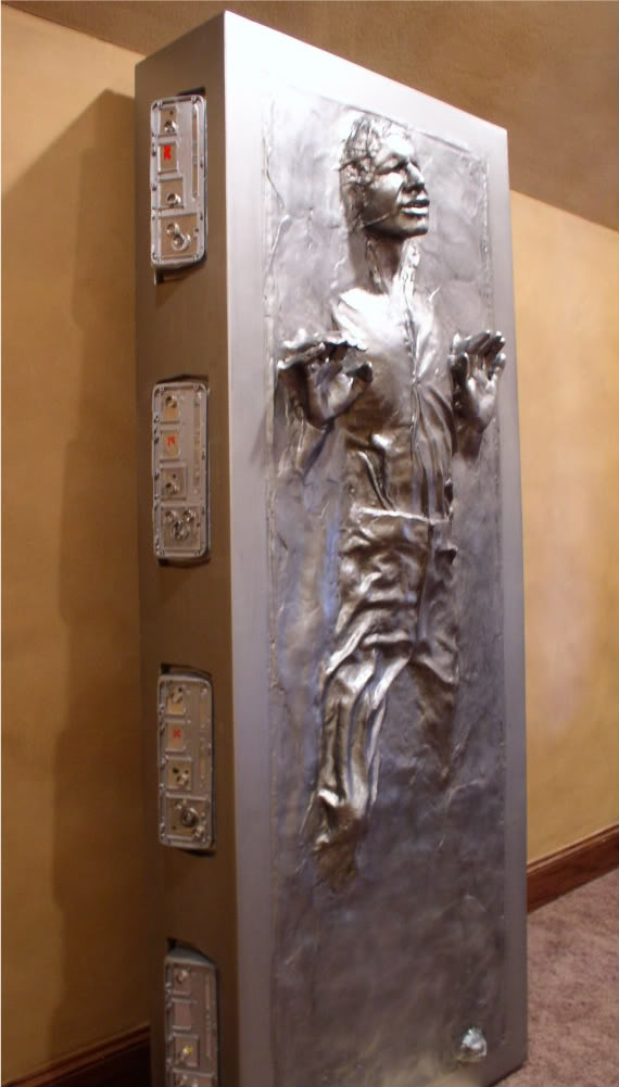

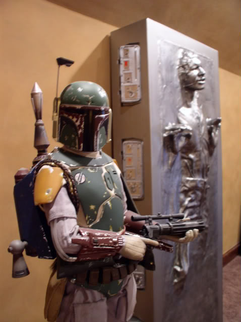

Solo's now in the house and I was able to mount the panels on the left side. Will finish the rest of the LEDs this weekend and should be close to finish soon. Thanks for looking!

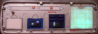

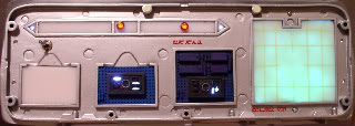

Here's a shot of the finished Hero Panel all wired up with a total of 26 LEDs.
Here are shots of the digital counters lit up and all 13 LEDs blink randomly.
I've got some minor cleanup and putty work to do. Should be able to glue all the parts down soon and mount the final panel to the frame. Thanks again for looking!

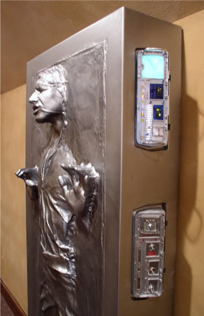

So here's where I'm at with my HIC. Was able to mount the panels on the right side and secure the HIC to the wall. The only thing left is to make the clips that goes on the face of the panels and also the metal parts that goes on the two notches that were cut out earlier of each panel.
Here's a shot of the finished Hero Panel. Project is 99% done and thanks to everyone for following along!
