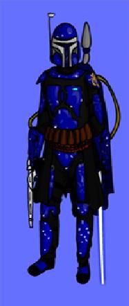

I am a 17 year old preparing to make his first suit in hopes of joining the Mandalorian Mercs this year (when I'm of age)
I have read many threads and know how to make my armor but here's some questions I'd like the pros to answer
I'm trying to decide between two concepts to make my armor. which is more durable/realistic and friendly on a limited budget (I know old story)
Plastic: trash cans, barrels, PVC
Cardboard: Resin, OR Fiberglass and Resin
Or that Sintra stuff? (how cheap is it and how "SAFE" my mom has dogs and I don't want anything that will poisan them if it drips or something)
and The Helmet...I have the Wizard templates but I just need to know "step-by-step" pictures and instructions
Working on a sketch so bear with me I do have a prototype though
(made on the Mandomaker at Mandalorianmercs.com)

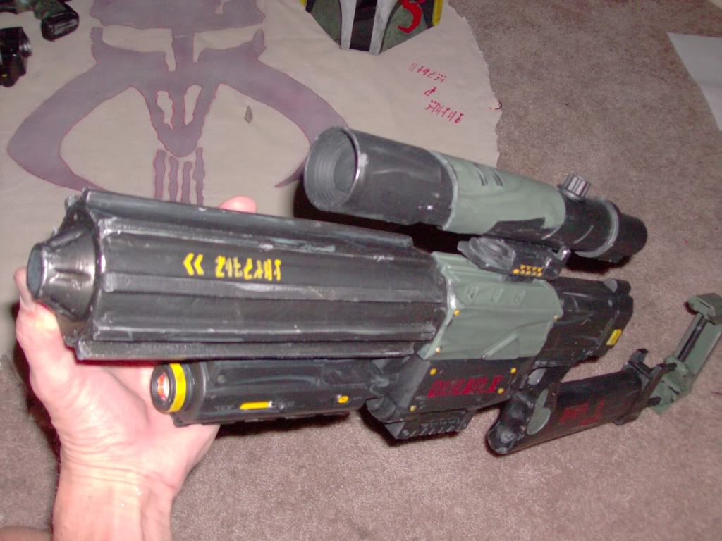

No mate, it is against the Mercs CRLs.
That doesn't mean you can't use it, just make sure it can't be instantly recognisable as a HALO gun, same goes with any NERF type gun as well.
A good example of what I mean is Solus Keer's Nerf gun:
