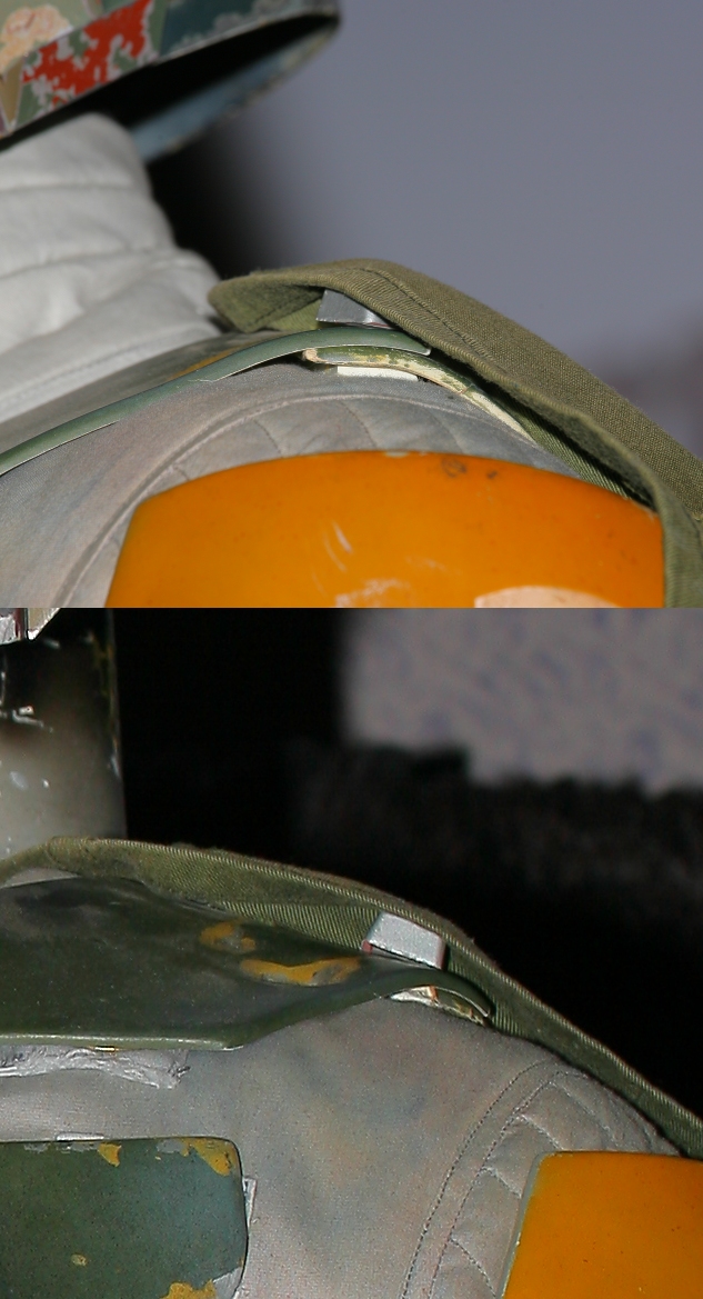

Where I am conflicted is how to effectively hear people better with my helmet on. I don't particularly want to drill holes through my beautiful helmet, so I am considering requesting a modified Uproar (http://www.thedentedhelmet.com/f31/uproar-helmet-hearing-aid-50004/?highlight=microphone+helmet) or something similar where I could place the two microphones under my armor (I specifically was thinking about placing them under the collar armor near the edge where the overlap occurs due to stud emplacement.
http://www.thedentedhelmet.com/attachment.php?attachmentid=69827&d=1363789660
My question is what hearing aids have people utilized WITHOUT drilling holes in their helmets and how did they place them. Does this sound like a good idea for my helmet?
http://www.thedentedhelmet.com/atta...s-left-collar-attachment-jpg-69827d1363789660

I did solve this little problem. The bluetooth piece was a no go, but what I was able to get for 13$ was this...
http://electronics123.com/shop/product/super-stereo-ear-kit-kit-4953
They do have an assembled version here...its 27$
http://electronics123.com/shop/product/super-stereo-ear-kit-assembled-4954
The advantage of the unassembled version (besides cost) is that you can manually extend out the wire to the microphone pickups. I have mine located under my shoulder bells, one on each side. Works great!
