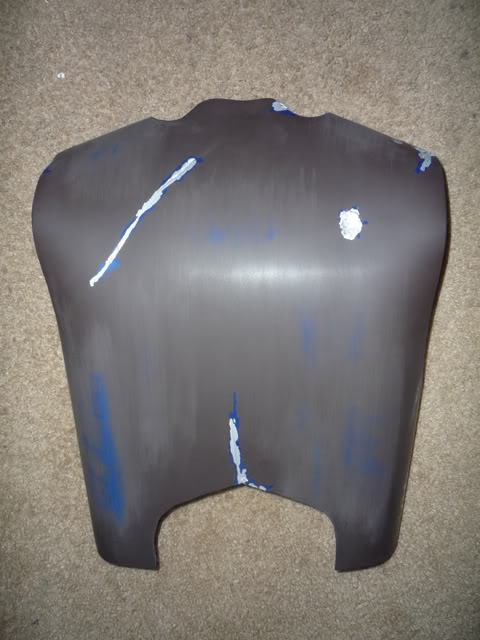

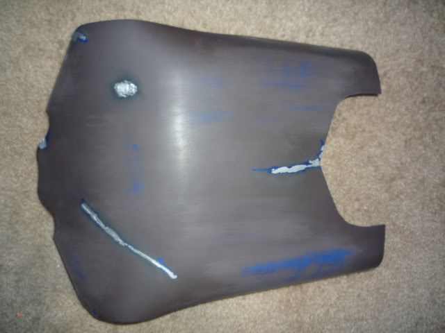

Ok. Im back after a very cold mission to Minnesota. I got to work on the back plate, and here are some update pics, (again this is practice for my upcoming ESB, so I am experimenting with colors and techniques, so its not accurate):
This is the side. I figure in a real suit, this area would get a lot of wear and tear.
still needs more sanding, and some charcoal blaster marks after that.

...and thanks to all for your positive comments. I enjoy constructive criticism, good and bad. More to come...

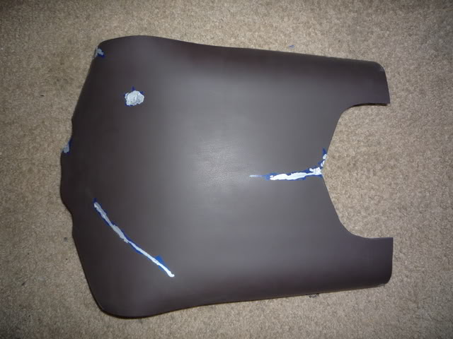

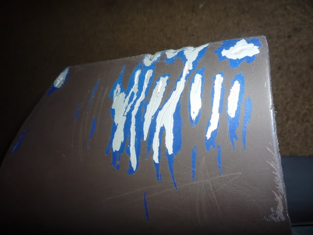

I practiced on some sanding techniques today.
I used different grits to cut thru the top layer and reveal the middle blue layer. I am going over that again with the 1000 grit wet to get a nice weathered, but smooth look. I dont have access to an airbrush, so I am looking for advice on what kind of charcoal to get to do the blaster flashes by hand?
Any thoughts are appreciated.

Artist's charcoal would probably work for what you want, they come in stick form (similar to chalk) and and a more natural form (like a burnt stick) with varying degrees of hardness. You can find them at any decent art store like Aaron Bros or Michael's, just look in the paint/artist supplies section and you'll find them there. After you're done applying the charcoal just be sure to apply something like Dull Coat or a clear coat to seal the charcoal otherwise it will just simply brush right off.
If you already have your flightsuit this would be an excellent opportunity to weather that a little too by wearing while doing the blaster flashes on your armor. Working with charcoal is a messy business and charcoal dust would make for an excellent weathering agent for the flightsuit although I think it might wash out of most clothing; it's been a long while since I've last used charcoal so I don't remember how well it stains in the long term.
Great. I have plenty of charcoal sticks, in many colors. I use them to draw with. I was unsure if I could use them, but with a clear coat, that seems pretty easy. Thanks for the info. Since I dont have to go get anything, Im going to start on it now.

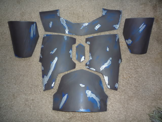

Well I added some charcoal flashes and sanded a bit more. It is hard to see and it doesn't show up as much because the armor is dark brown, so I was kinda disappointed, but certain colors don't look as well next to each other. (an example would be in FettDads paint up, the charcoal black against the yellow shoulder looks amazing, the contrast is good. Brown and black are just to close to look as good, IMO.) Also I would have added less battle damage, the more there is, the less realistic it looks I think. I am still fairly happy with what I have done for my first attempt. I need a flightsuit or something to put this on so I can see what to do next. I really enjoy both the masking techniques and the revealing techniques of painting and sanding.

dankenman, that is one of the best trash can armour builds I have ever seen!!!:cheers Splendid work!!! You backplate is amazing!!!:thumbsup::thumbsup::thumbsup: I'm on my third go at a backplate, and it's just not working :facepalm:wacko:confused. Any tips or tricks I might not know?

Patience and a heat gun my friend. Basically I heated it up, molded it, and ran it under cold water to solidify. I just kept repeating that process, and working my way around it until I was satisfied. Also I found that when you run cold water on one side when it is hot, that side shrinks a bit faster than the other. So if you need to bend an area a little more, run cold water on the side you want to shrink. If you just dip it in cold water, it will re-solidify just as it is. Don't get me wrong, it wasn't easy, and got a bit frustrating. Thanks for everyone's kind words, and don't sell yourself short A'den Kyramud, I have seen your work and it is excellent!
