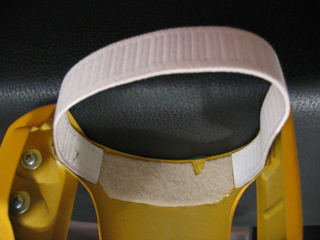

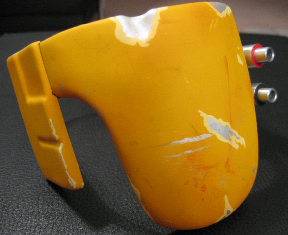

Hi all, I've attached some pics of the completed left knee. Same technique was used to do it, including pastels used for shading.
I've also attached a pic of my attachment method. I glued a strip of velcro into the center part of the knee pad using "Shoe Goo", and attached a matching piece onto the knee area of my jumpsuit. I also used Shoe Goo to glue on the elastic straps. The velcro supports the knee armor and keeps it from slipping, so the elastic is basically there just for show.
If you notice, the elastic is glued onto the center knee pad portion, NOT the side parts. So during wear, there is no stress whatsoever placed on the side parts of my knees. I did a wear test the other day when everything was dry (much to my wife's amusement :lol: ) and it worked like a champ!

Outstanding job Superjedi, right down to the correct red and black rings on the left darts. Love your detailed weathering technique of using the pastel powders and the charcoal pencil. Outstanding bro, FP would be proud.

I love weathering! It's one of my favorite things about the whole 'look' of the Star Wars universe. . . it's dirty! :D
