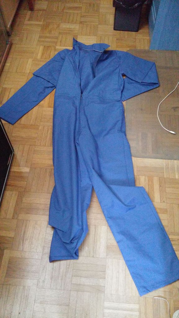

bobamaker is too blue. not purple :(
The Bobamaker flight suit can be corrected fairly easily. I have done one in the past. It just needs to be lightened some and then add the needed purple and pearl gray. I used a light bleach solution to lighten it and then added the other colors until I reached the desired blurple.

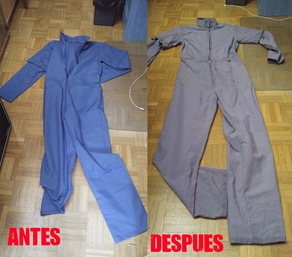

Hi Friend, thanks for the help, you can tell me how I get wear color? what are the steps to get that color? I am a bit lost
thank you very much!
I would start by adding some purple and gray. Just a little bit. Then you can use the 10% bleach solution to weather and tone down the color.
When I used the bleach I started out spraying just a bit on the back and testing how much was needed. I did this because the back is not seen when you are wearing the full armor. Once I decided I had it about right I did the whole suit and then washed it to get the bleach back out.
It really is a bit of trial and error. The good thing is you can undo most anything that you do. If you mess up it is just an exercise of going back a few steps and going again.
