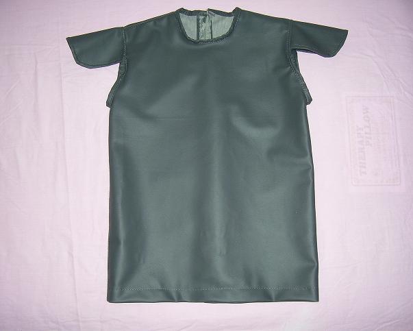

Hi man, here is my Jango Jackets and others that I design.I used semi leather............any quiestion let me know......I have more pictures and others

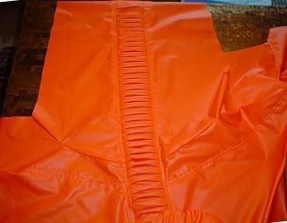

Piggybacking on the 'snowspeeder jacket material' suggestion, I found this at the Rebel Legion online, from a Snowspeeder Jacket sewing tutorial:
"Preferrably a coated wind-poplin or nylon "jacket fabric" that has a bit of
stiffness in it. It is somewhat in-between a typical windbreaker fabric and a
rain coat fabric.
It's a light-weight looking fabric with similar drape and sheen to the PrePro flak vest:

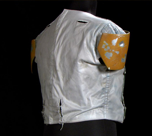

I don't believe there is a thread. But I've spoken with several people who have handled the real vests.
Plus Clothears Costumes (with whom I've worked extensively on the Fett soft parts) made the observation that because of the way the fabric frays around the JP harness slits it is likely a cotton.
Sateen was selected for their early vests and now I believe they use a PU coated material. They have not yet been able to find a fabric with the correct weave and properties. Nor have I.
So really it's a trade off. The tackle twill has a similar weave and sheen to the original fabric but is too rigid and thick.
The sateen isn't the right sheen when dyed and not the right weave.
The PU coated stuff is about the right sheen and softness but not the right weave and is "swishy" (makes noise like ski pants)
So I'd love it if someone found the right stuff. But anything close is probably just as close as what we already have so don't stress the correct weave too much.
