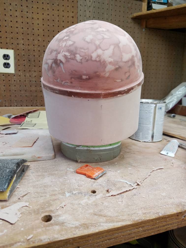

Times been short lately. Been busy doing life things. Had a few hours today to spare. Managed to bondo the rear, ears, and right faceplate. Still have some things to smooth out and finish shaping the r ear (had to build it up to flatten it out for the bits and pieces). Glazing soon to follow.
Heres a few photos from the end of today's session.

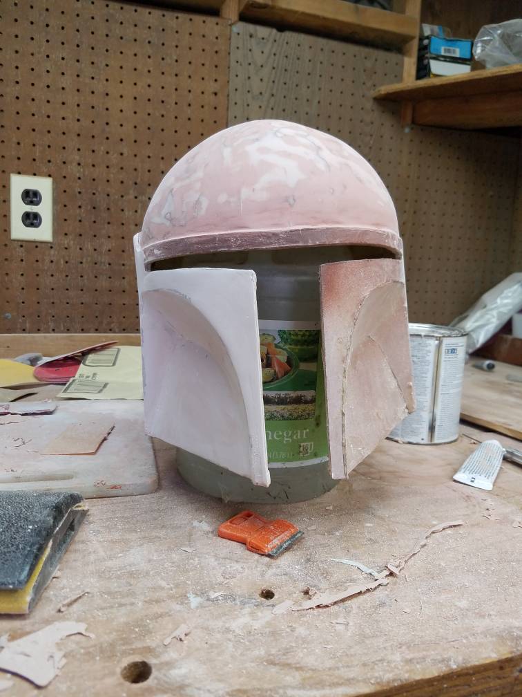

Thanks for the support. It's far from perfect. Tons of lessons learned for round 2. I'm still considering scrapping the earpieces and rebuilding them with just a frame and building it out out of bondo vice the mat board.

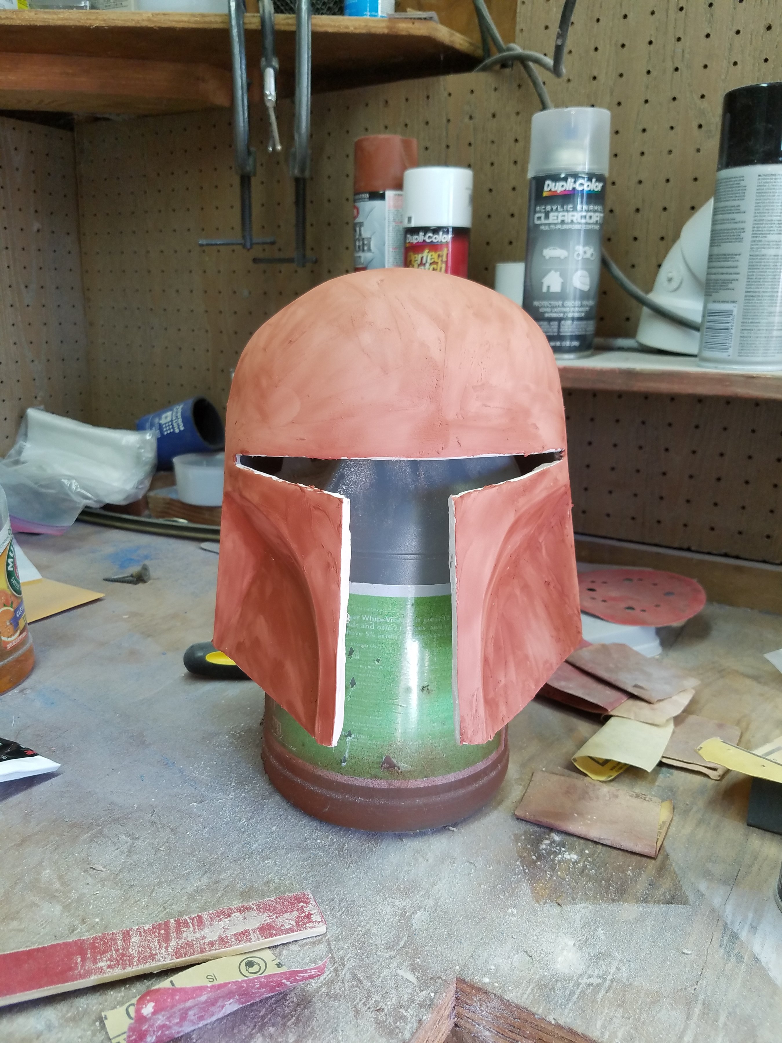

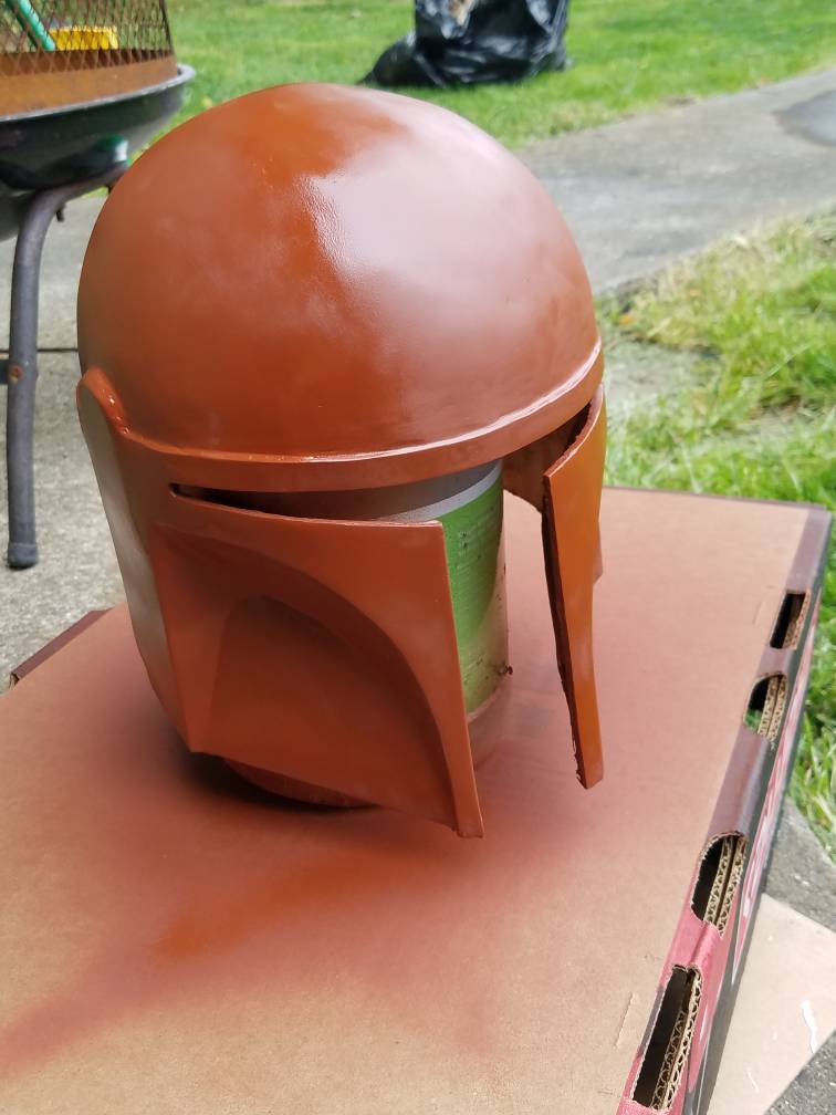

Coming along nicely. Finished with the helmet for the most part. Threw a few coats of primer on it. Now time to get the ears squared away. Still not sure if I'm going to work on the ones I have or rebuild then from scratch.

Thanks! Still quite a few imperfections that would drive me crazy if it were for me long term, but for a kids Halloween rig, it will do. They're gonna use and abuse it anyway.

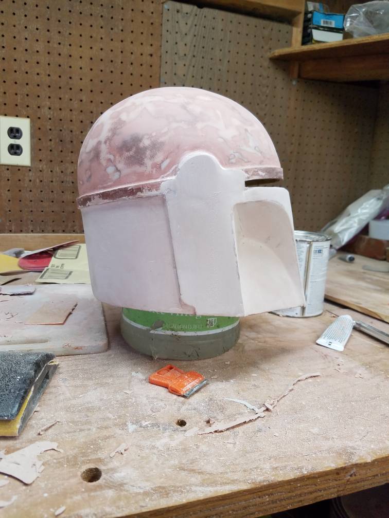

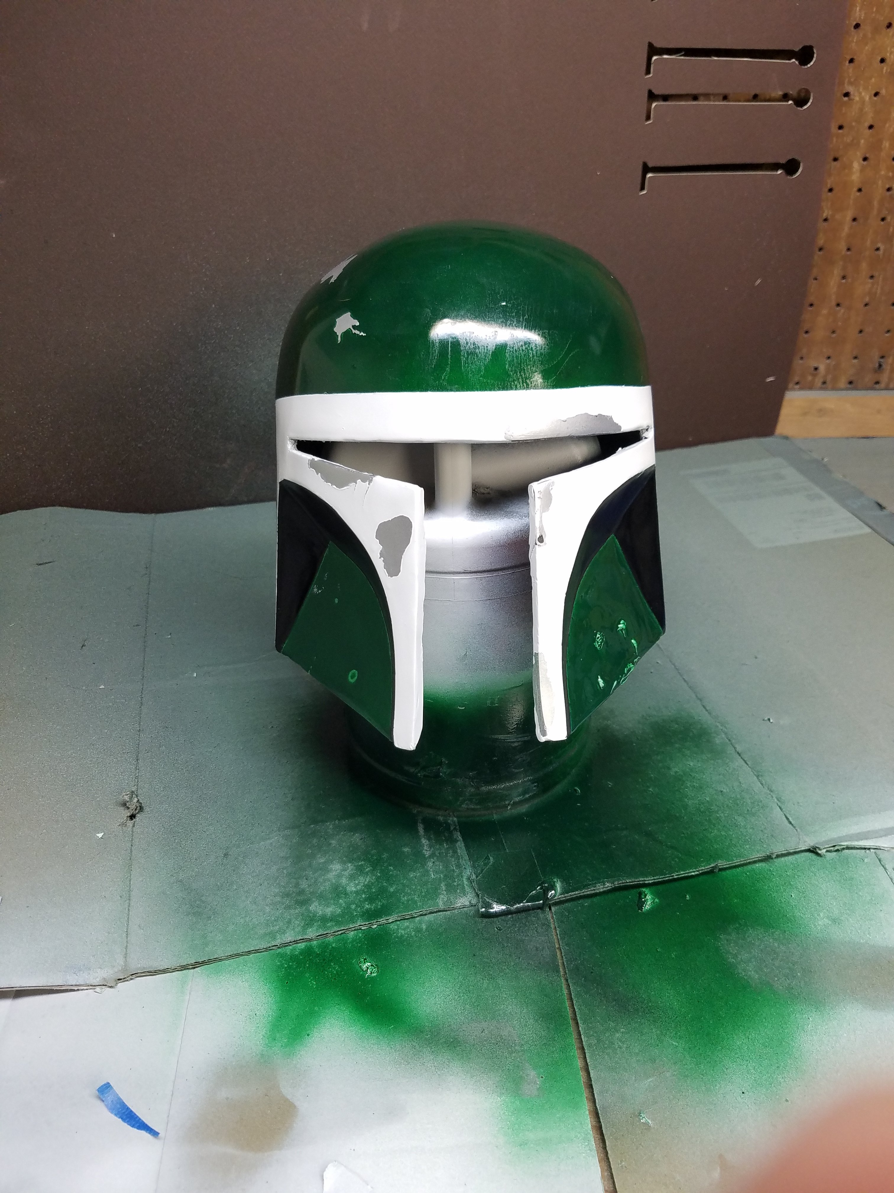

Running out of time for the Halloween bucket, so it ain't gonna be perfect. Shaved the ears and top rim to make a more modern look (and selfishly save time). Glazed up here for the final sand.
There is no good way to get it off... that was the problem I ran into for 5he helmet on page 1. The most recent pic is a different helmet entirely where I used scotch tape to hold the template on an just used a surface cut to score it. Removed tape and finished the cut.
Side note, I've taken tons of pics, but posted few. One more spot to paint and she'll be ready for a clear coat! It's not up to Merc quality, but I'm happy with it considering the time crunch I put myself under.
Thanks! I put this latest together in about a week and a half from start to finish. Several days off work in there were used in this full time. Others got what attention they COULD after my 12 hr day (like today).

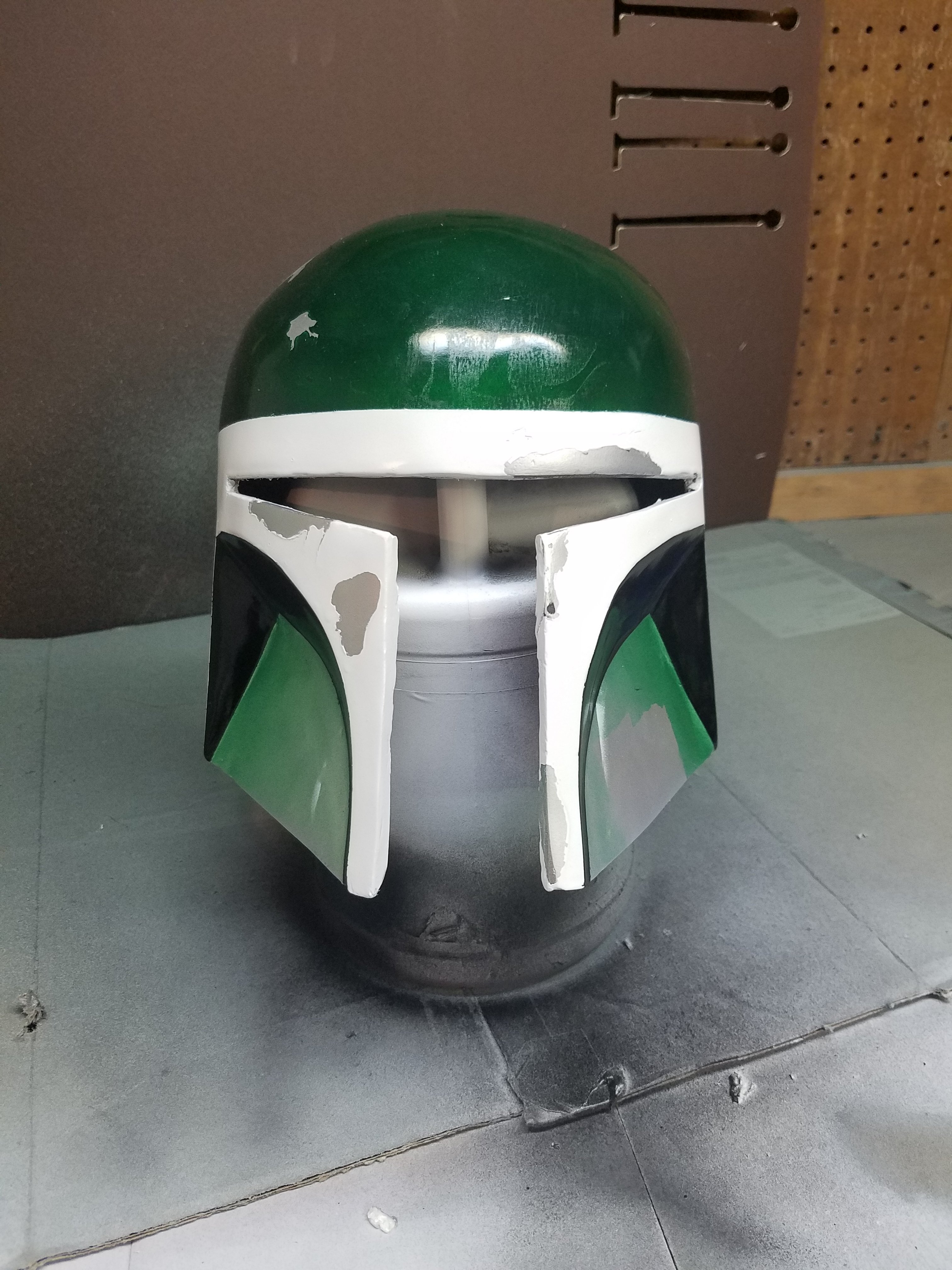

All I had time for today was the last masking and cheek paint. Gonna get a clear tomorrow followed by a visor and foam liner in my next few days off.
Hares how she sits tonight. Cheeks are still wet and the toothpaste still needs to be removed. I'll update once it's all ready.
It's not perfect. I've been in a time crunch and my hastiness can be seen in masking marks in some paint. Felt dry. Wasn't dry.
