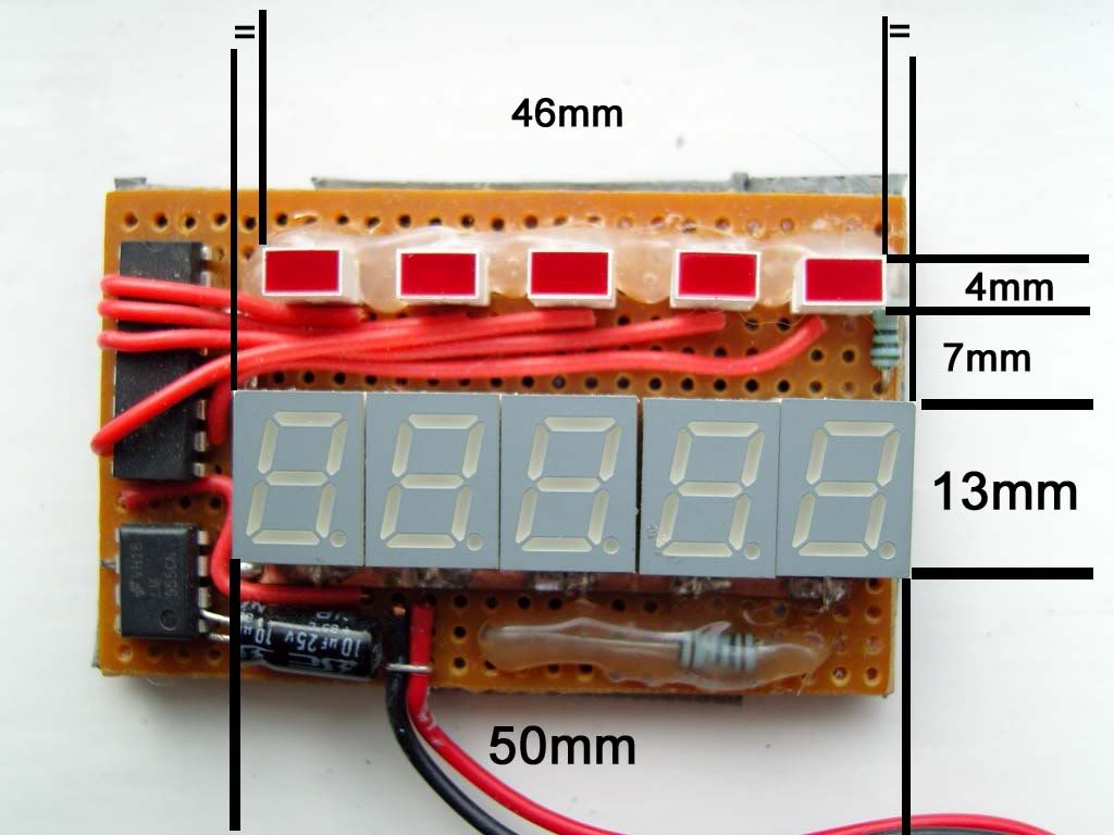

Fettronics chest lot dimensions?

What size slots are needed for the Fettronics chest lights?

What are the dimensions of the board?
The board its self is only 2 inches tall by 2 3/4 inches wide. The Top lights are 47mm wide and 4mm high. The Bottom Segment's Characters are 7mm wide and 10mm tall. The width of all segments together is about 49mm. Spacing between the top lights and bottom segment is 8mm, but this can be adjusted to you specifications. Just let us know when you order.

This is what I have.
I need to update my pictures on my FAQ page, but the dimentions of my current boards are pretty much the same. The new boards have the top and bottom segments seperated but a ribbon cable, so they will fit a large array of spacing between the top and bottom slots.
The typical spacing (measurements from the WOF templates, any one?) is 5mm high for the top slot and 10mm high for the bottom slot, with 8mm between.
