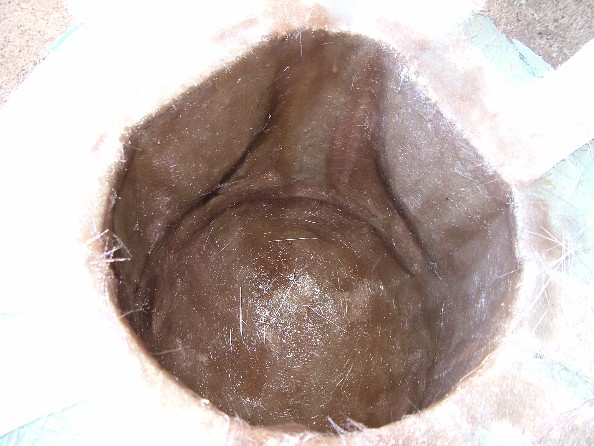

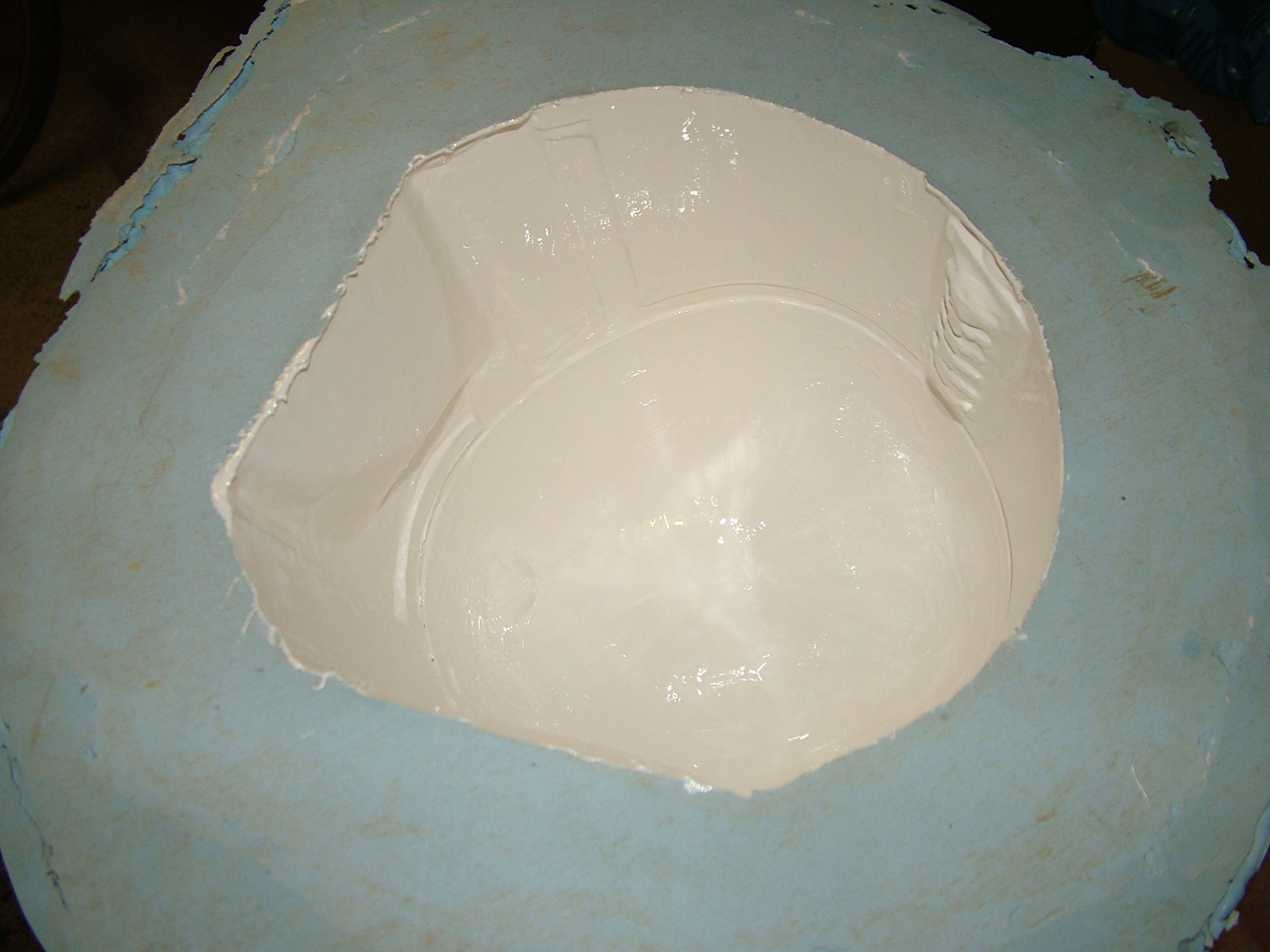

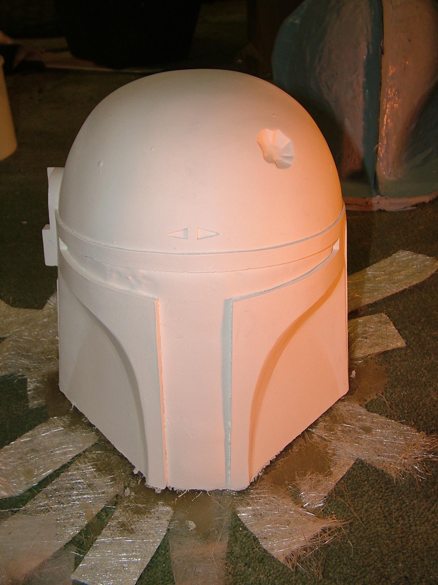

Ok, respirator and gloves again. Time to cast a bucket. Assemble the mould and support cast, fasten all screws well.

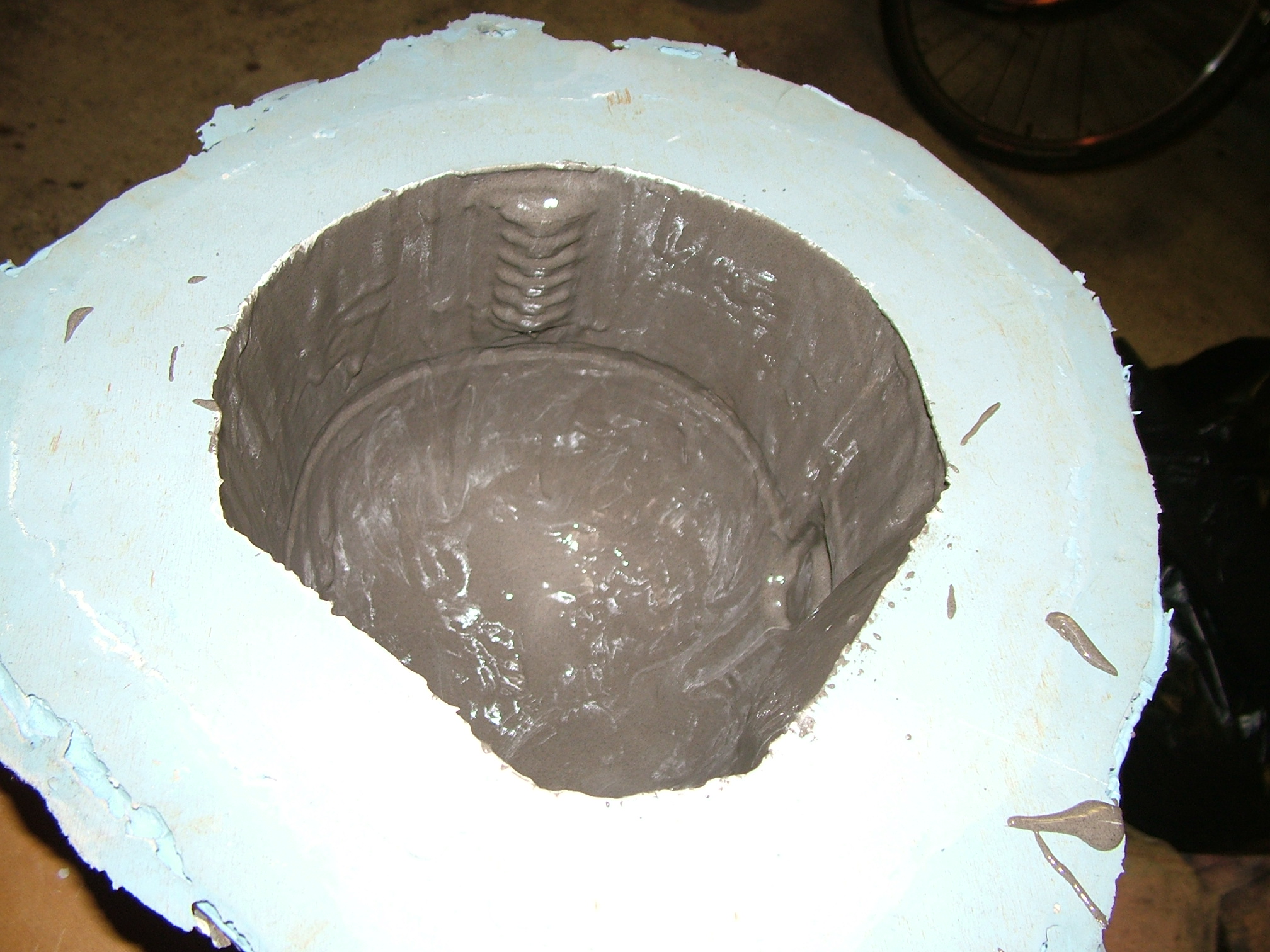

Gelcoat first. Mixed up and brushed onto the interior of the mould. Make sure of a nice even spread and get right into all nooks and crannies. Allow it to go off until tacky. Don't allow it to go off completely or there's a good chance the next layer won't bond to the gelcoat.

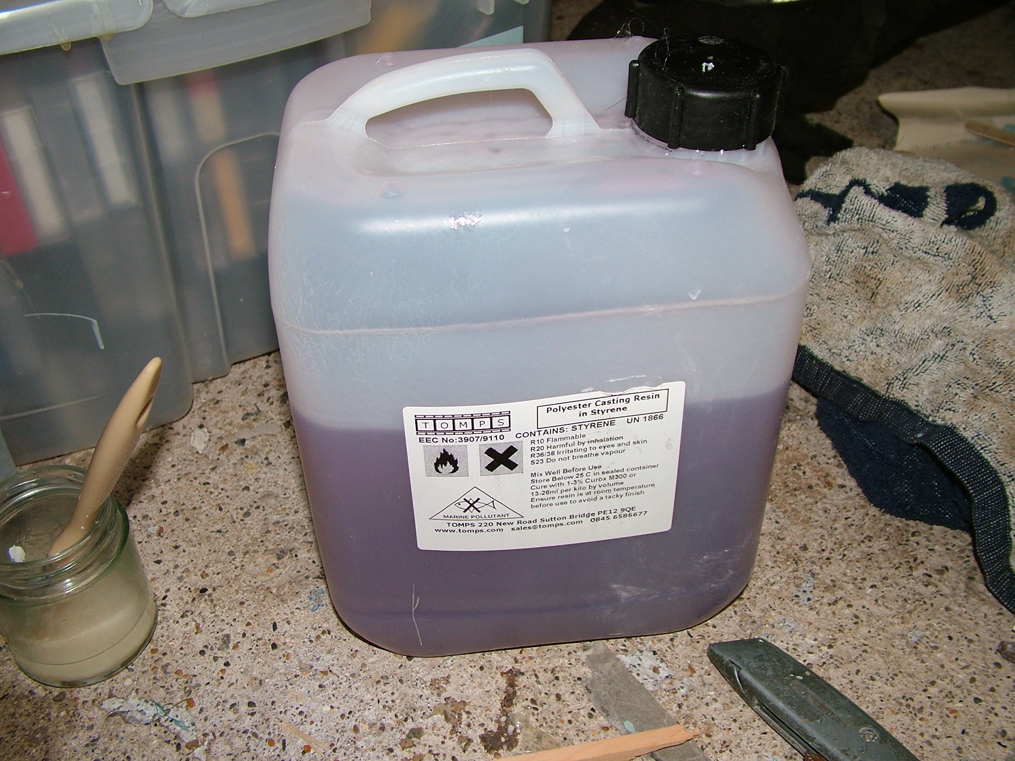

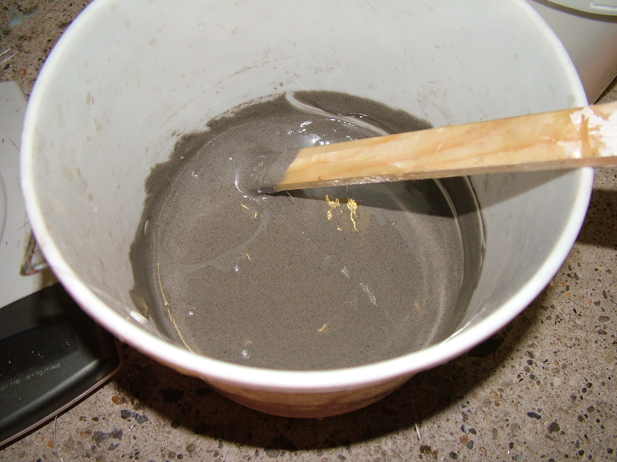

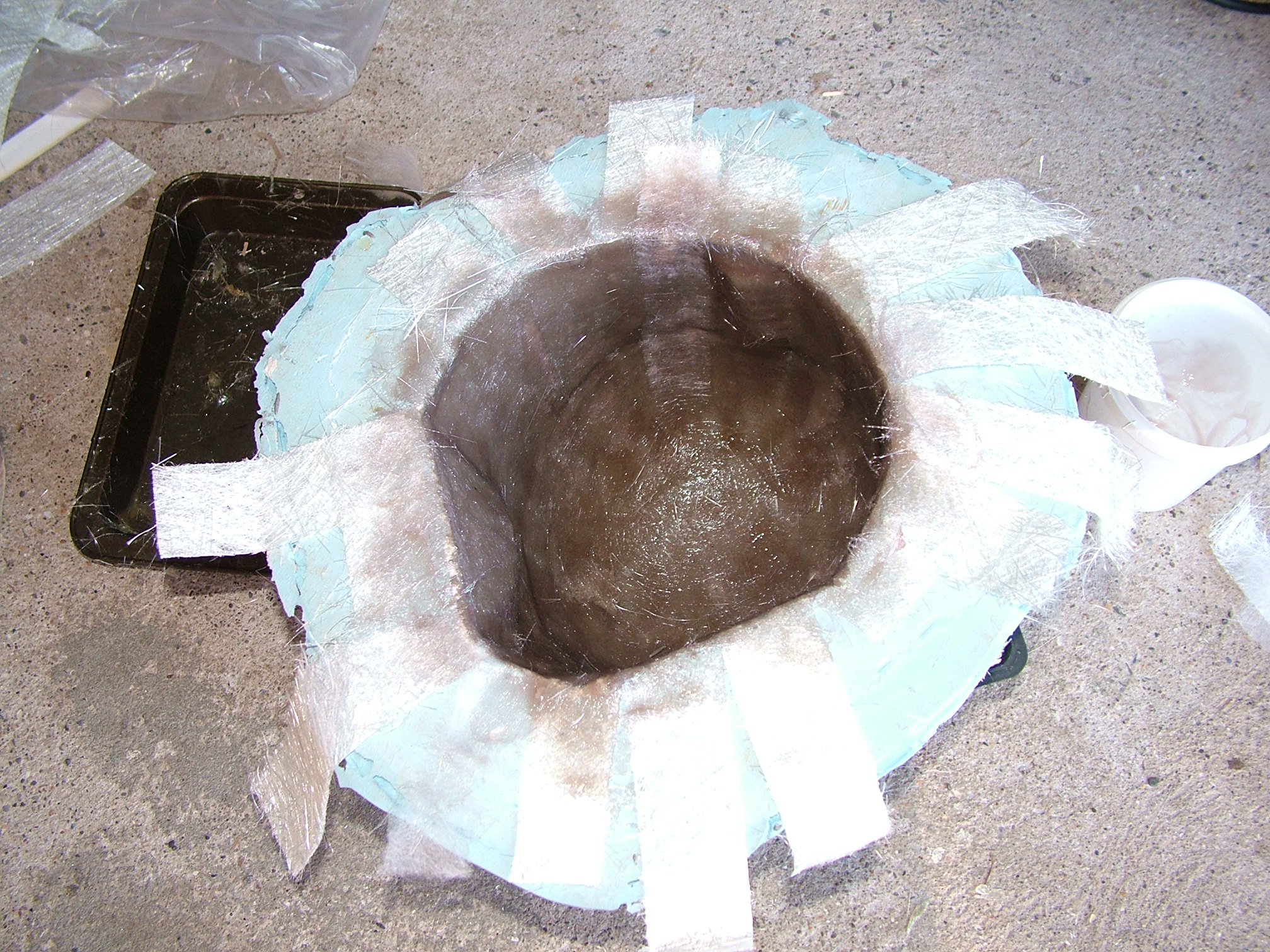

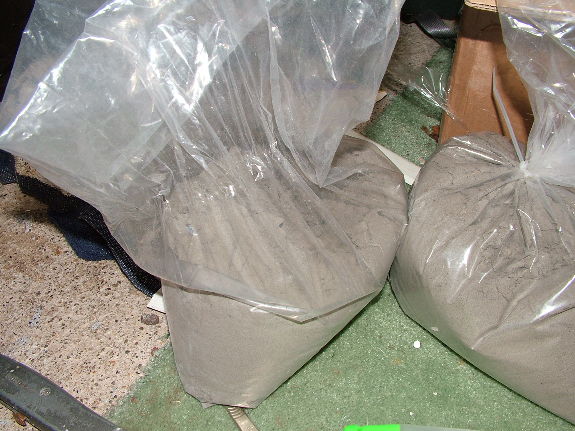

For the next layer I used a filled styrene resin. I mixed the resin with 'fillite' which is alumina-silicate powder. Cheap and light, it makes the resin go a long way. Brush on a couple of layers of this. Only the first layer is shown here. The second layer smoothed it over a bit better. I then finished with a layer of resin and matting.
There was then a lot of crossing of fingers!!!!!

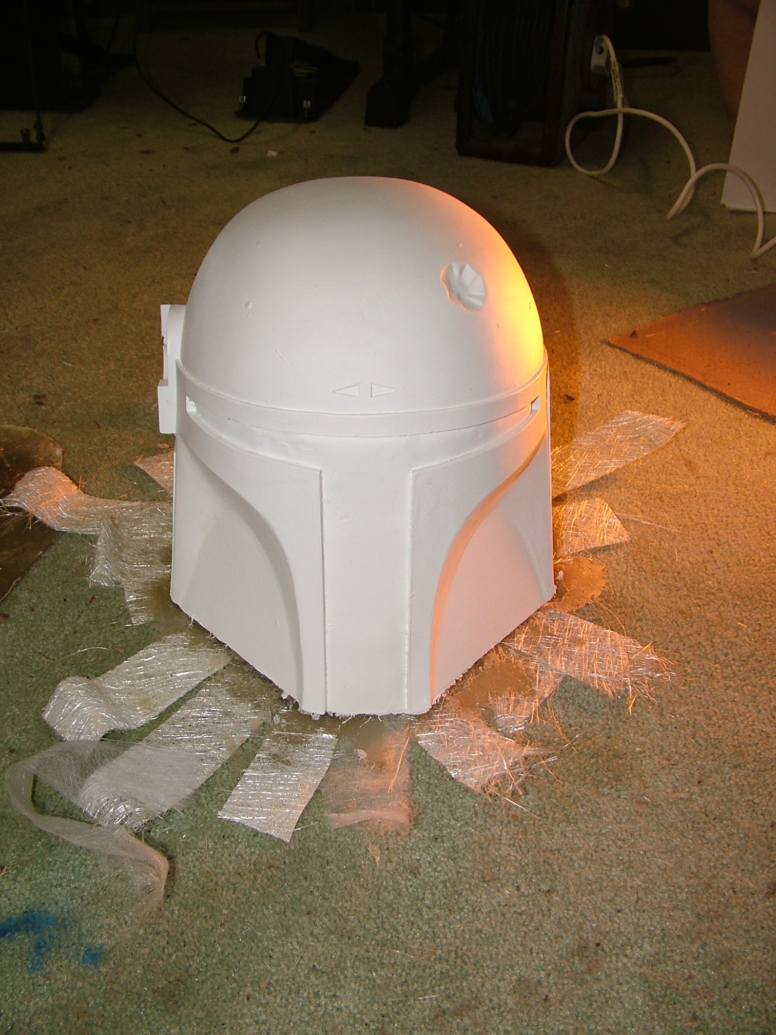

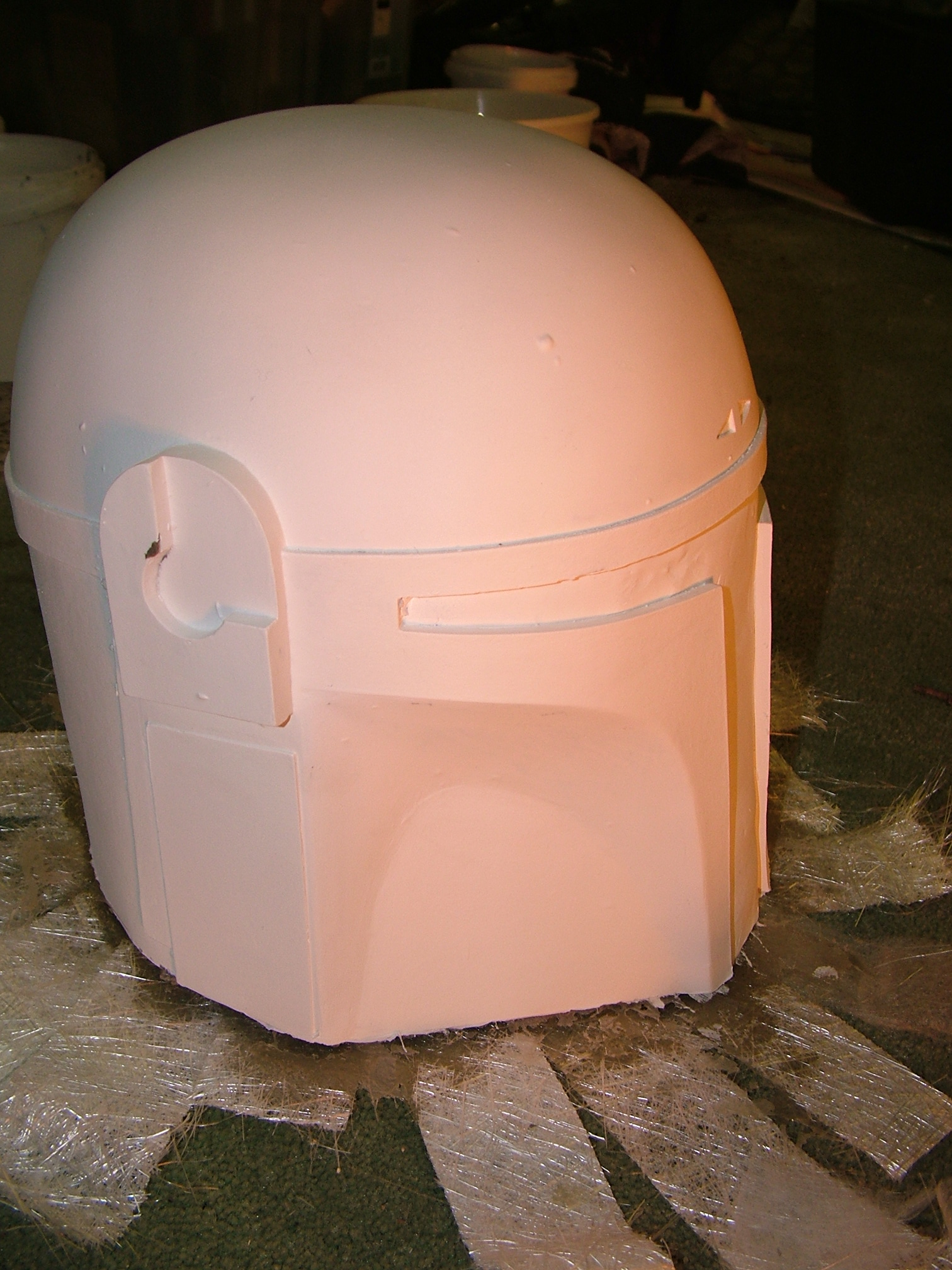

To say I was pleased is an understatement.:thumbsup:

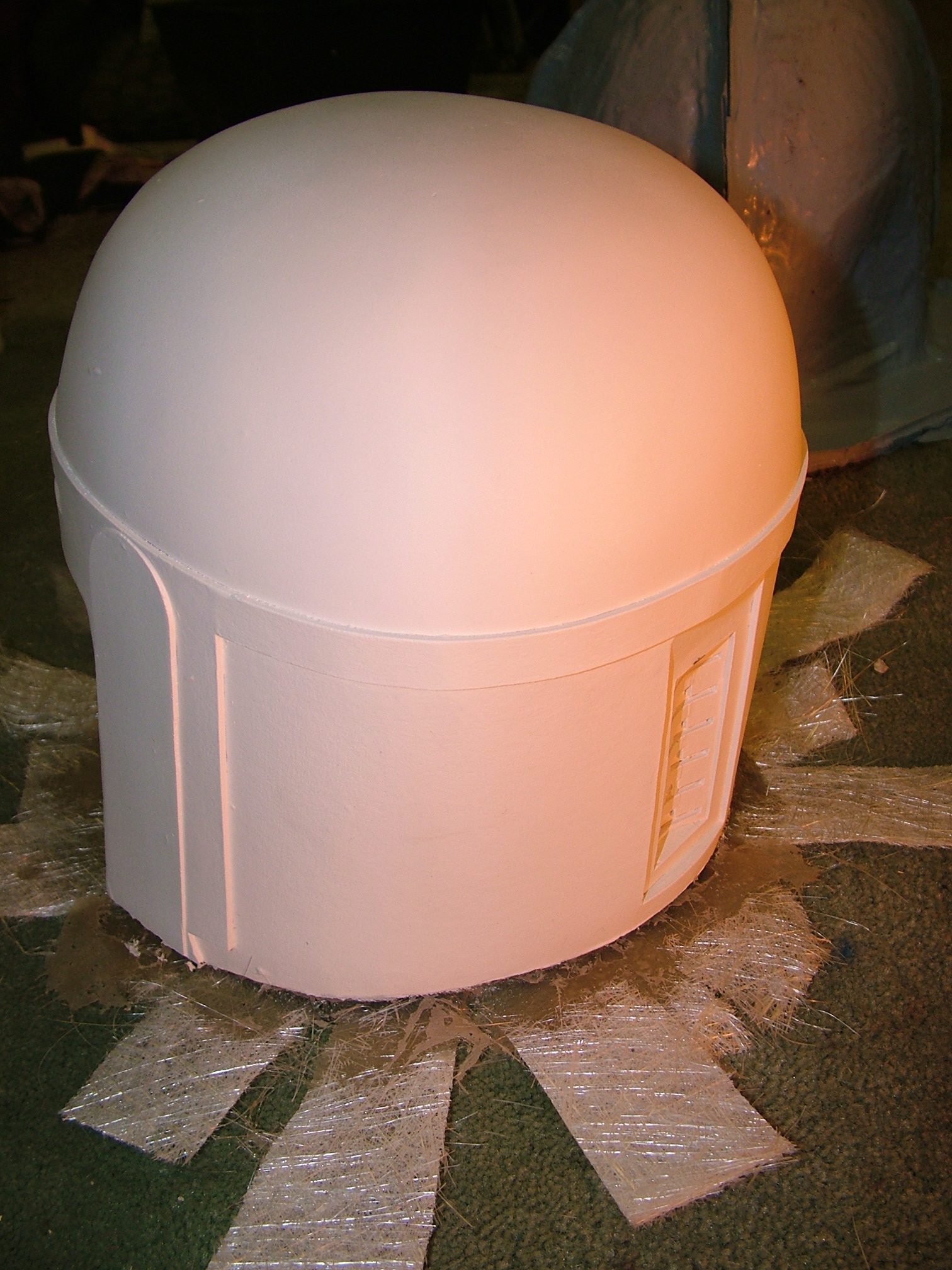

A couple of airblows and the tusks will need adjusting a bit, but overall very happy. Earpieces are coming on. Moulds are pretty much done. Will upload some pics soon. I am off for a very relieved, well-deserved drink. :cheers

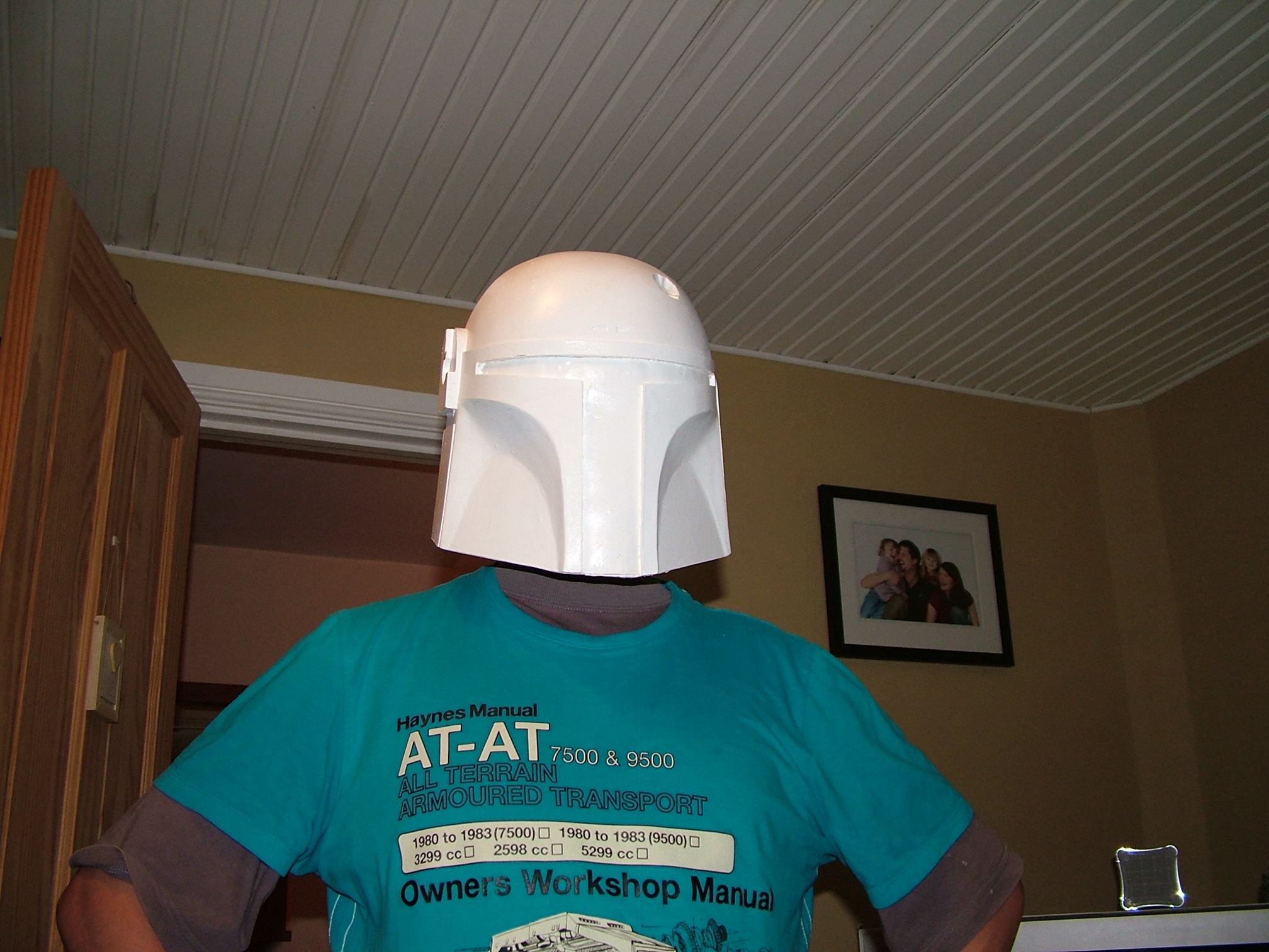

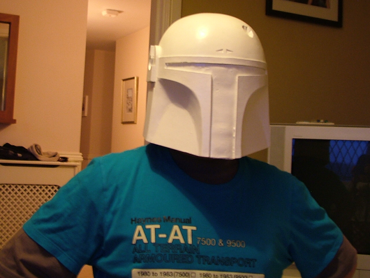

With the cold at the moment I don't think there's any danger of me doing any painting. Just doing some adjusting on the lid in the relative warmth of the garage. I still plan to do a run on these early in the new year, but I'm going to get some painting and tweaking done to this one first to ensure all the bits fit together ok and people will be happy with what I send them. The right side has warped slightly so I'm just sanding it out a bit. Can't tell unless you look really closely though so I'm still happy.
