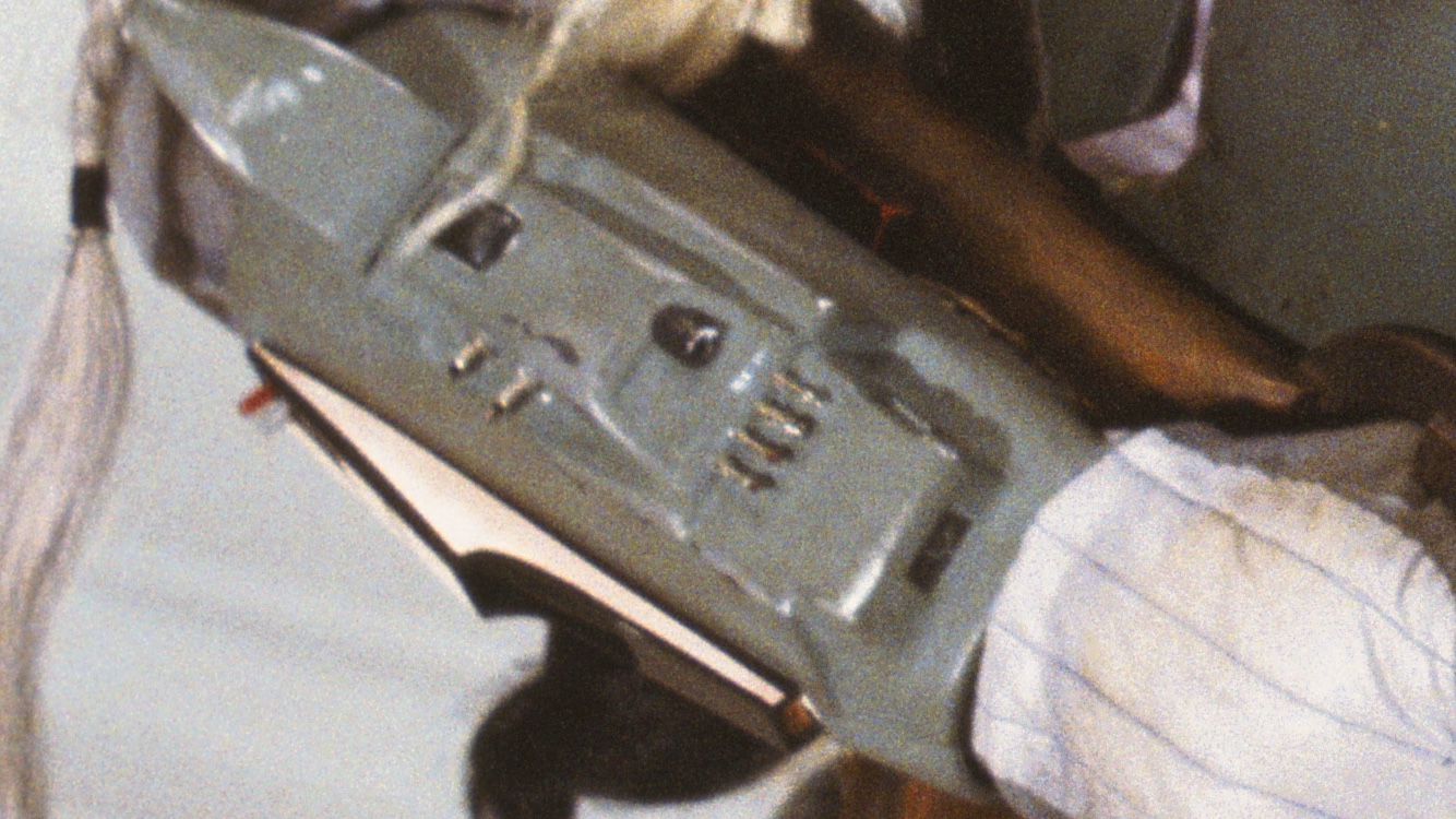

Gauntlets...
1. silver for the flamethrower assembly pieces, minus the obvious black and red parts, white and red for the wires. i used to think the keys were white but there are definitive reference photos that i think tell otherwise.
2. correct! 2,3 and 4 can all be confirmed by the image below...
3. red and silver (dental files #35 and #45)
4. none as it isn't visible in reference photos.
5. darkish red, almost marion. like the red used on the mythosaur skull. i use a tuscan red.
ps. the black on the whipcord housing is definitely a gloss finish, not matte like the black 33. you can see a reflection of light towards the middle of the piece that would not be there with a matte finish...
also there is a small copper/bronze insert at the front of the whipcord housing that in some shots almost looks like a light inside the housing.
http://www.thedentedhelmet.com/f20/2nd-gauntlet-light-53459/
