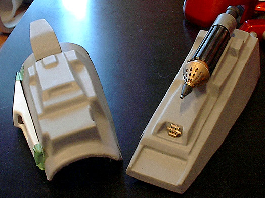

With a TON of photos from the reference CD pinned up on my workshop wall (a la A Beautiful Mind), I started with the rough dimensions of the main features, on the left one using the rocket as a scale.
Using some sculpting tools I cleaned it up and got it looking pretty close to a gauntlet. After smoothing out as much as possible (not easy to do with plasticine), I vacuformed over my sculpt in really thin styrene. I filled that styrene pull with Hydrocal. Now that I have a nice hard version, I can smooth it out using sandpaper, a dremel, files, exacto knife, etc.
After a few weeks of this, I finally go to the point where I was happy with them. I pulled the left one in .06 to capture as much detail (I'll get some done in FG later as per the originals), and the right one in .08. I made the side piece of the right gauntlet using sintra and a pen, and vacuformed over that. I made the gauntlet connector from sintra, making sure the end was wide enough to fit my hose. Once it was all smoothed up, I filled it with fibreglass resin and covered my hose with vaseline (mind OUT of the gutter!). I stuck the hose in the connector and let it dry, when I popped it out I had a solid connector, with a little resin rod formed on the inside that lets me plug the hose in securely
