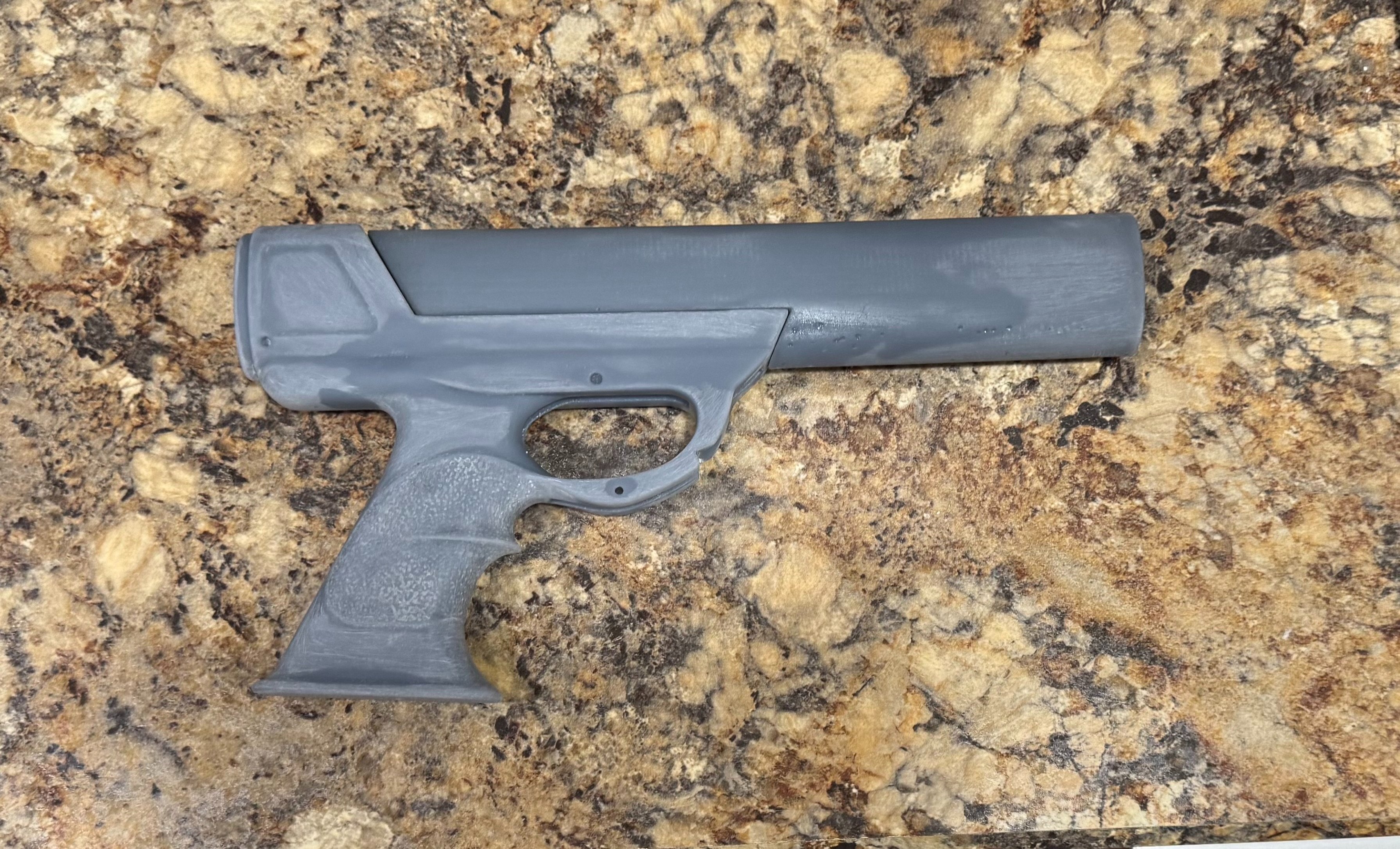

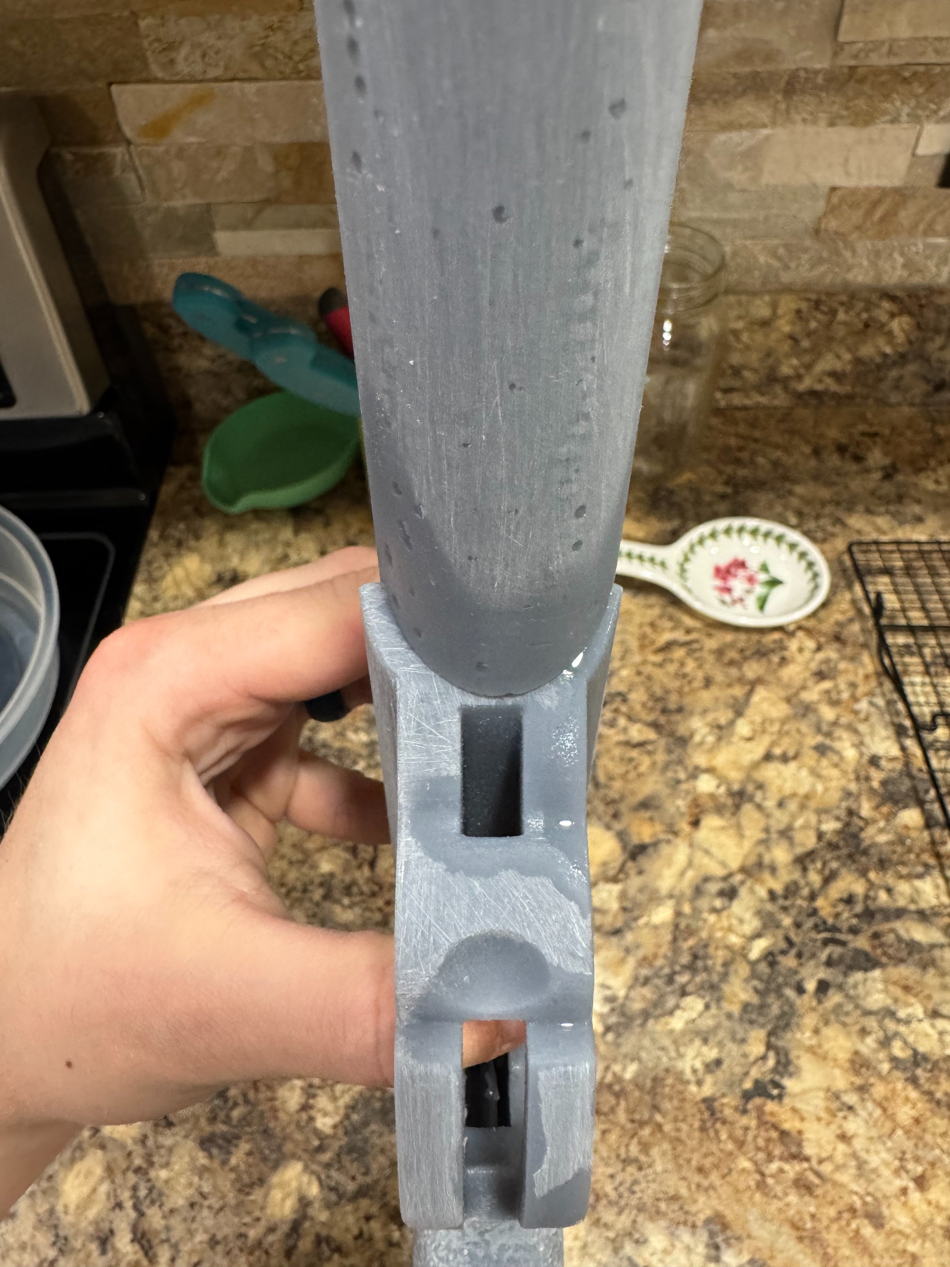

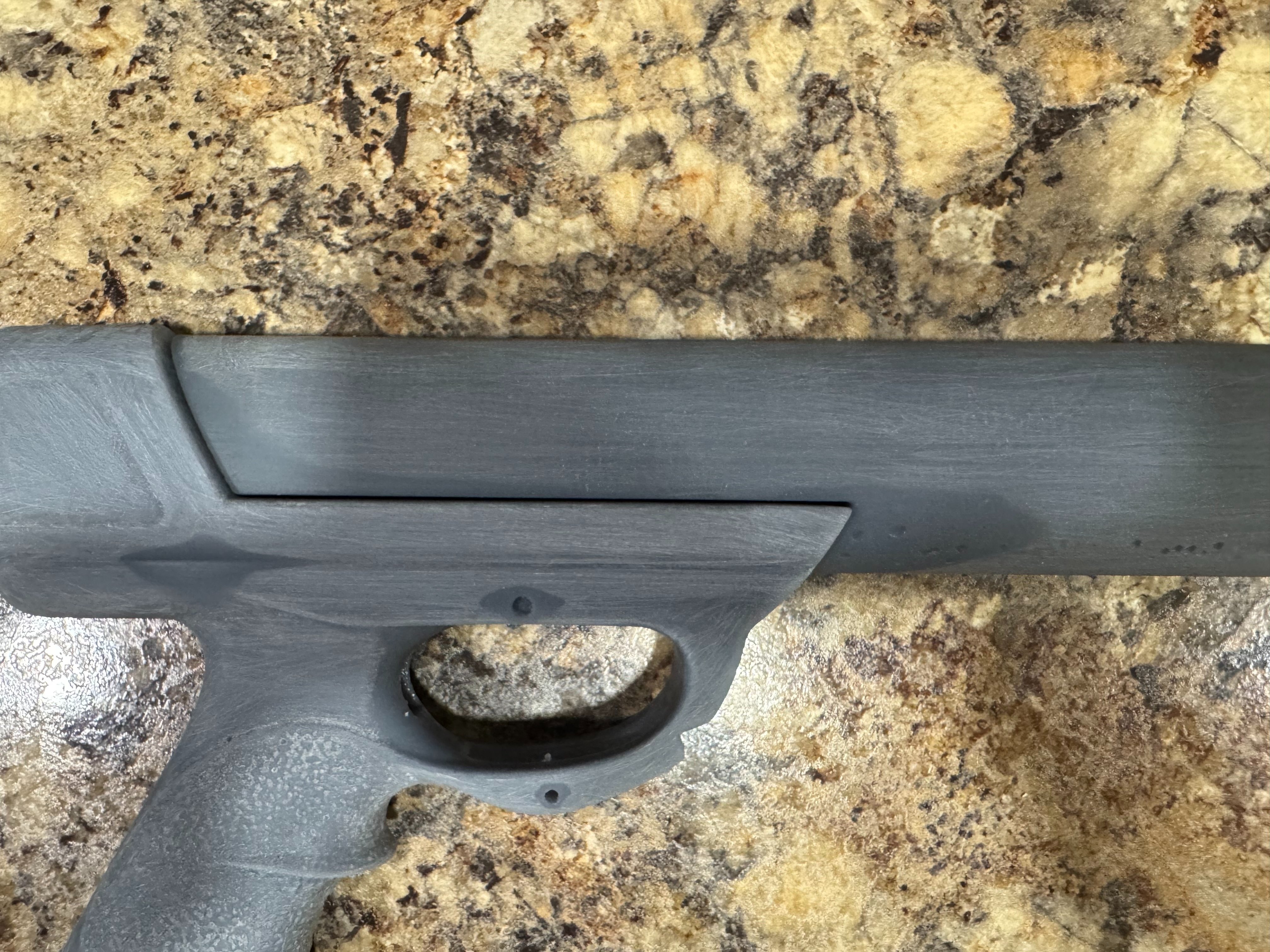

For starters, I'm going to resin print the sidearm with a mix of ABS-like and tenacious resin (Tenacious should hopefully reduce the brittleness of the prints). This will accurately capture the texture of the grip and all the metal details of the barrel. I might FDM print some of the longer sections. We'll see. The jetpack was the other part I opted to print. The main body will printed out of ABS and some of the detail pieces/thrusters/rocket will be resin printed with the same mixture I'm using for the sidearm. The Bambu has already produced some great pieces for the jetpack, so I might change my mind with how much of the jetpack is FDM as opposed to resin. The keys will definitely be resin. All the "metal" parts will be substituted for the real metal parts I purchased from QuestDesignCanada

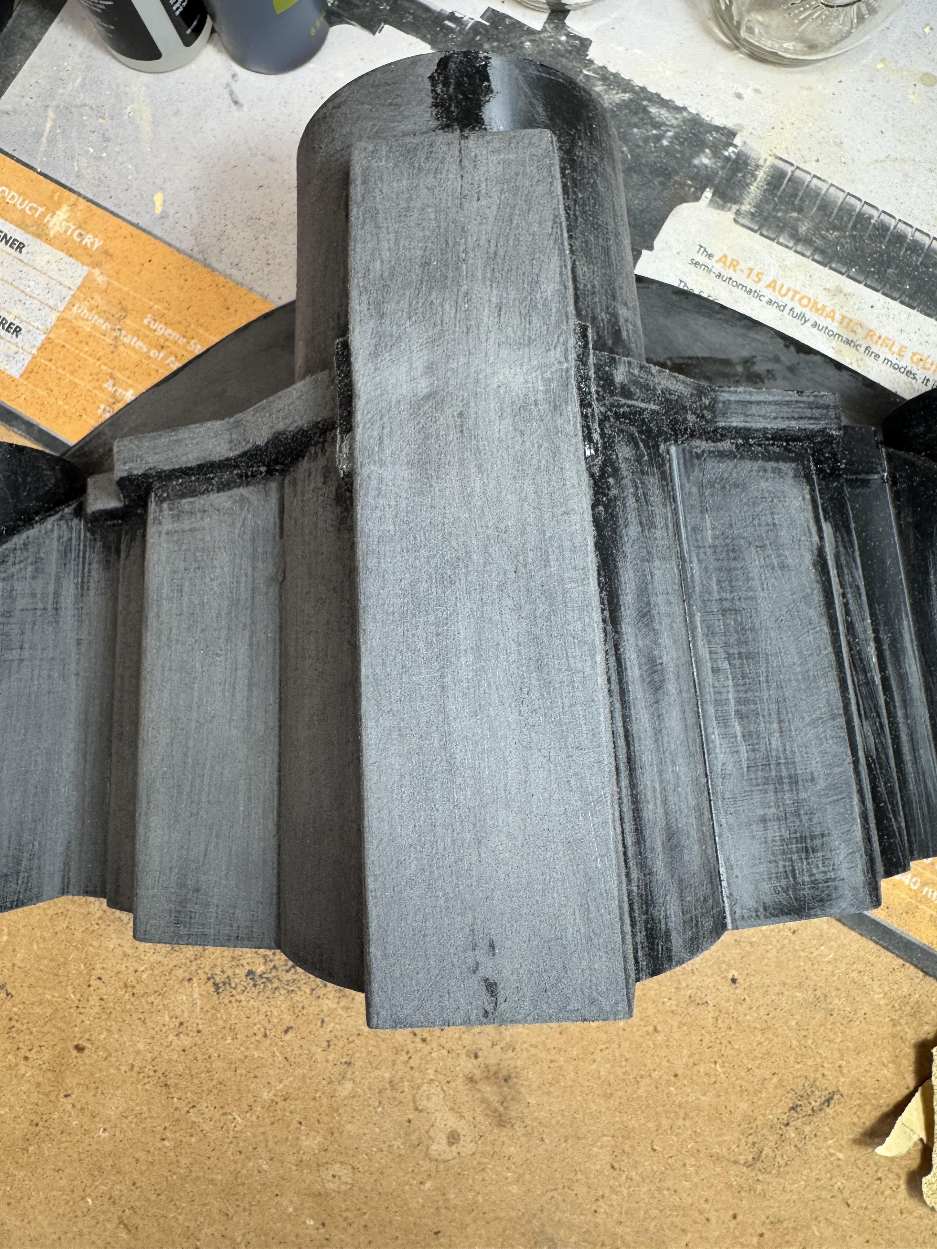

Here is a cool time lapse of 1 of the 4 main jetpack sections. They are on average 18 hour prints using about half a roll of ABS:
Currently I've printed 2/4 of the sections. Unfortunately the minute jetpack files have some bugs, but nothing too major. Just some small areas that will require some fillling. Here is one section with a rough pass of sanding:
Here are the two top sections glued together with ABS glue and the seams filled with an ABS slurry mixture. Areas with heavy layer lines are also coated to aide in future sanding flush:
And finally the interior coated with Z-poxy finishing resin. I use this stuff to pore fill guitar bodies, but I figured it'd work well to add some strength to the interior of the jetpack. I'm planning to repeat all the above steps of the bottom half of the jetpack then join both assemblies together:
It's magical watching the seams start to dissapear when they're sanded back.

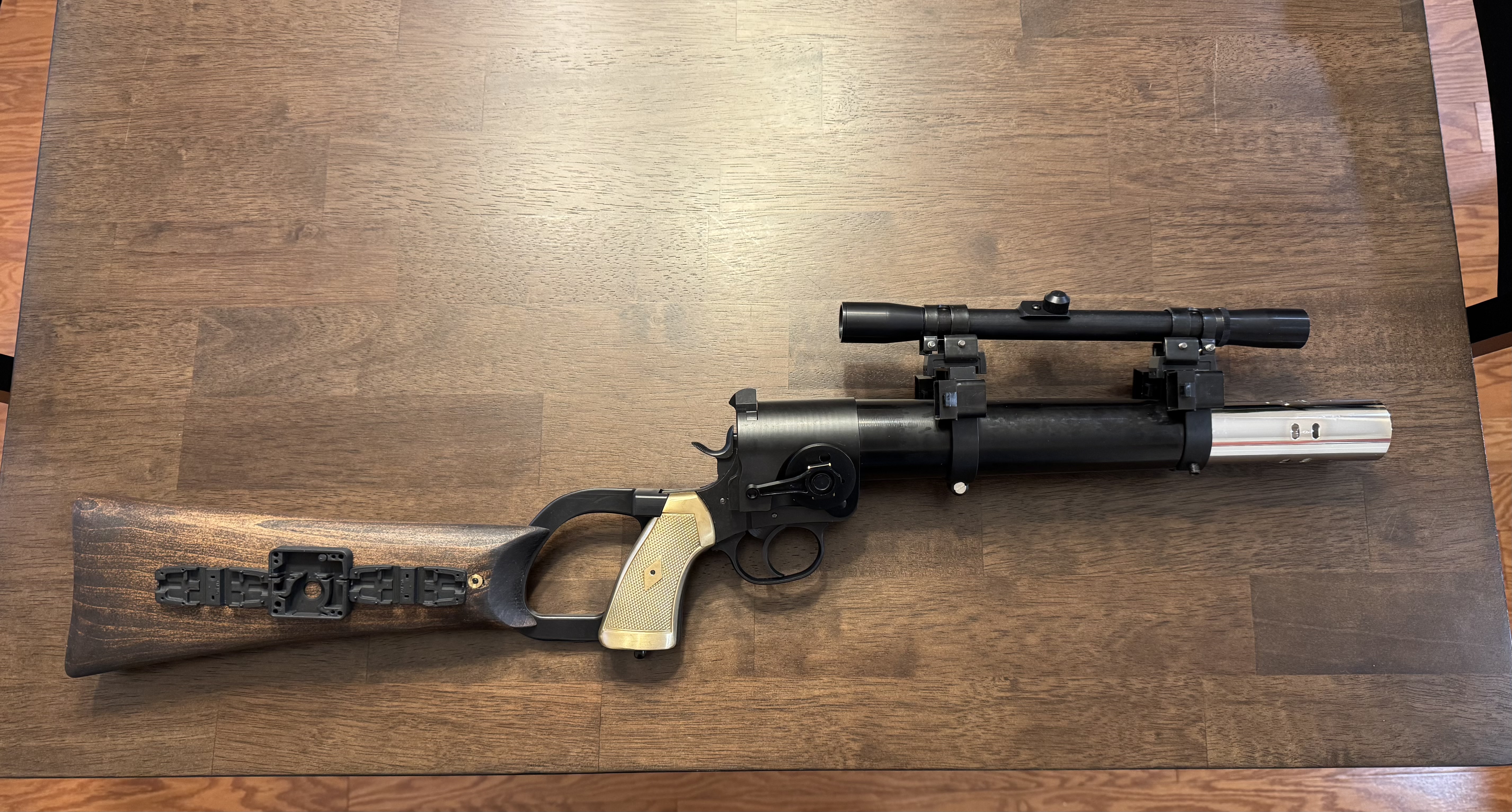

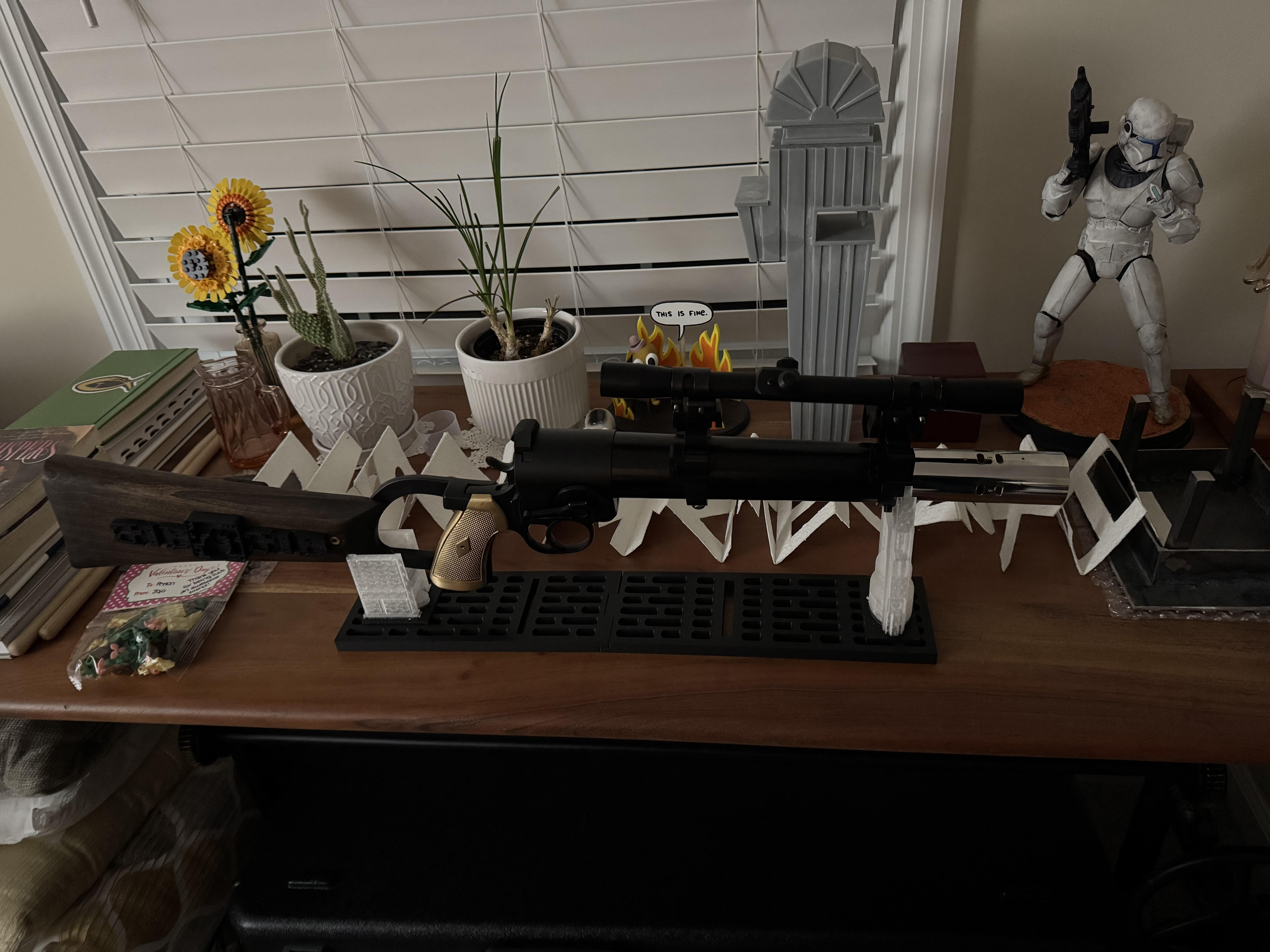

The field marshal EE3 came today. I had to leave work early today as it required a signature when it was delivered. I was 1 minute too late for the delivery as I didn't expect UPS to actually be on time with their estimated window. However, when I pulled into my driveway I saw the delivery truck at my next store neighbors. I bolted out of my car and was able to explain the situation to the driver. Phew!

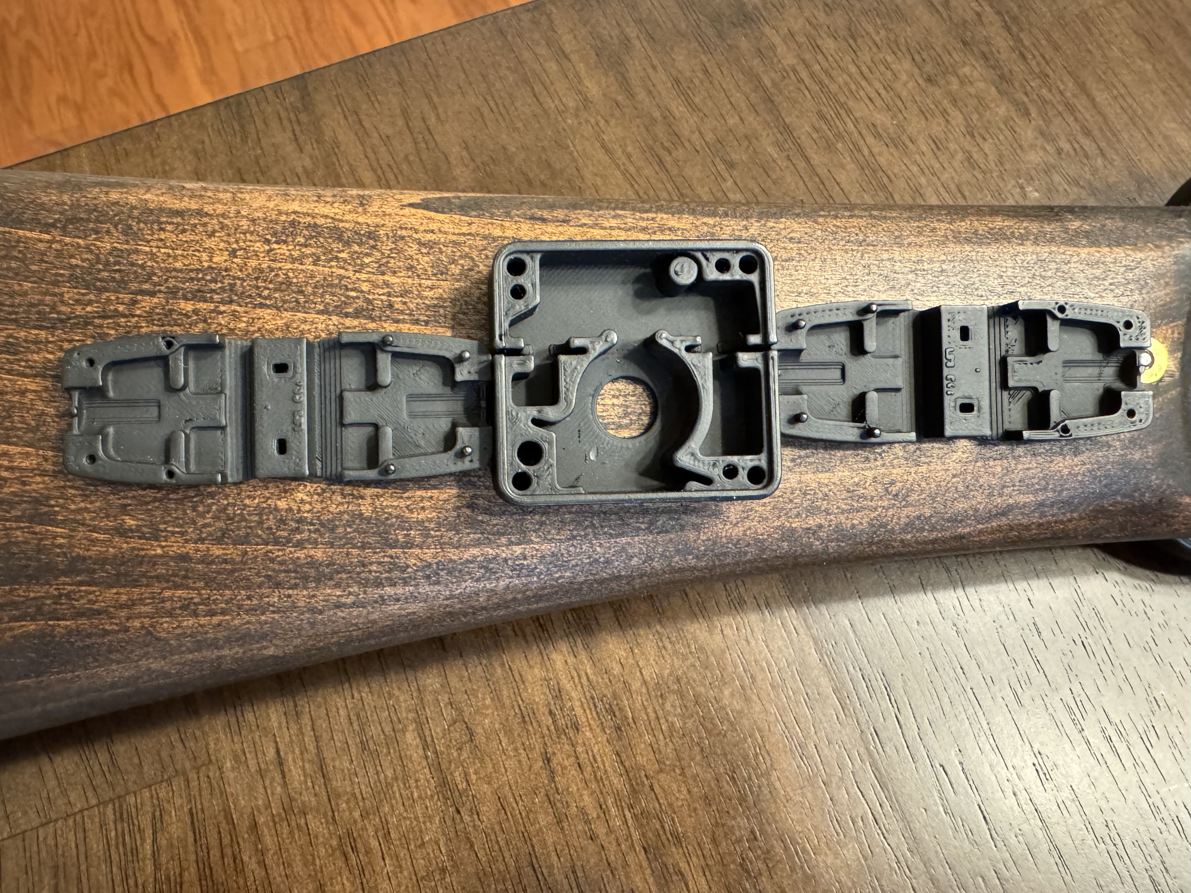

It's a beautiful piece. Very happy with it and excited to start weathering it. It's going to feel weird putting the chip in the stock on a prop this expensive. I do have one complaint with this piece. All the greeblies on the stock are 3D printed, which is fine, but they have very obvious visible layer lines (See below). I've gone ahead and ordered replacements for the greeblies from Neo fett. Oh well I still love the rest of the rifle.

Thanks! It's actually surprisingly light since it's machined out of aluminum. It only weighs 5LBs.
