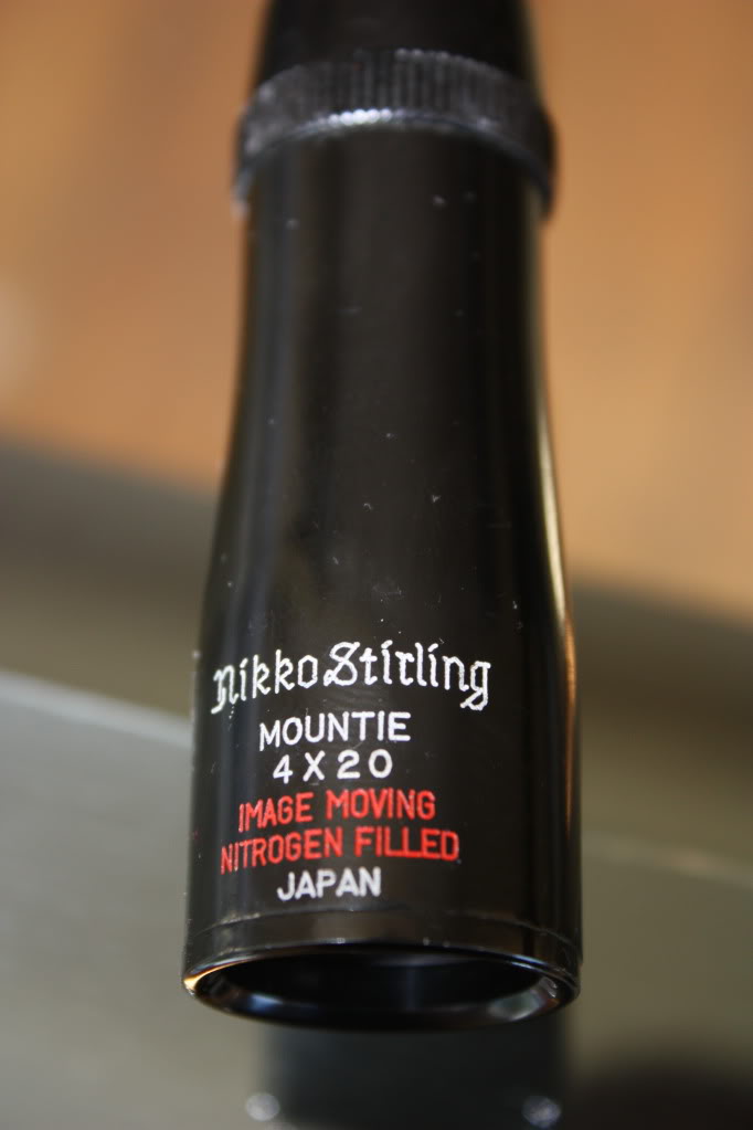

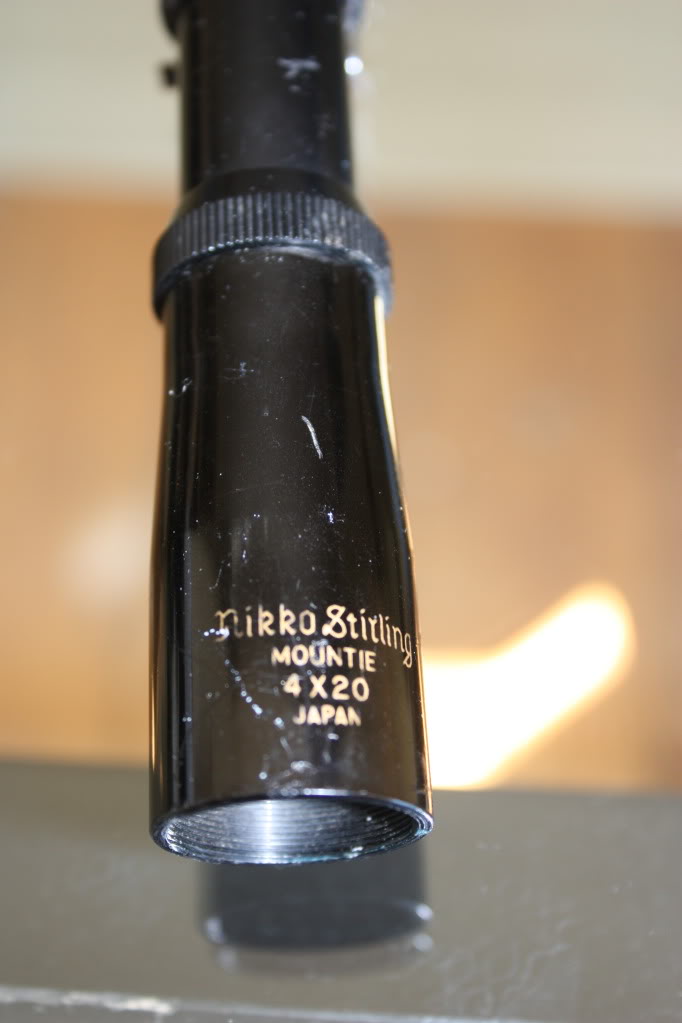

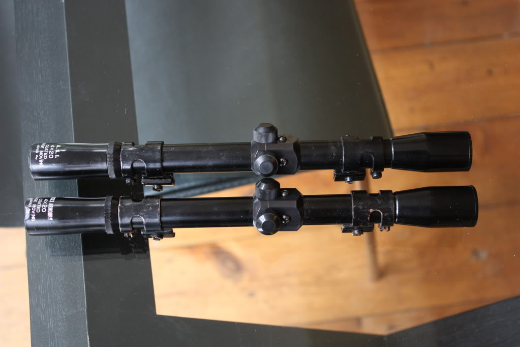

Nikko Stirling Mountie 4x20 – 1
Nikko Stirling Mountie 4x20 – 2
Apart from the obvious difference of the branding the scopes themselves are also different in a couple of subtle ways. More on that in a moment.

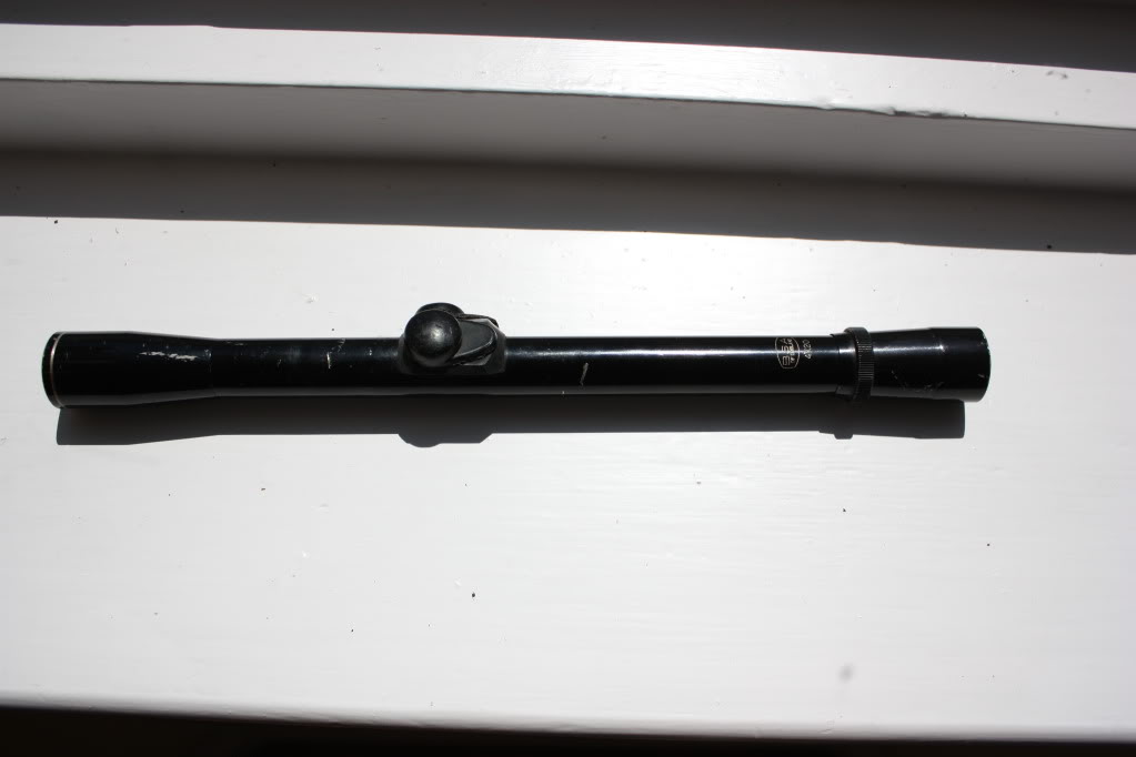

BSA 4x20 Scope (1950s)

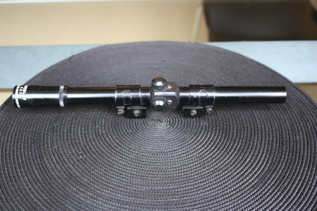

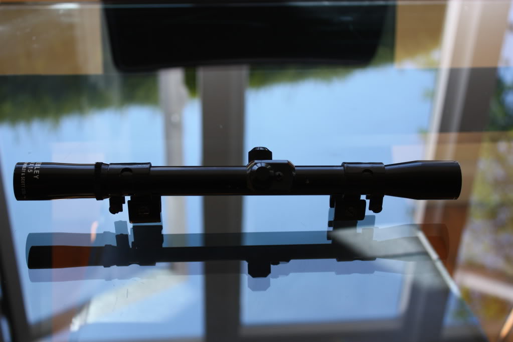

and a Webley and Scott 4x15. Sorry no picture available as it would involve taking my Frankenscope apart in order to rebuild it.
************************************************************EDIT 20/07/2012****************************************

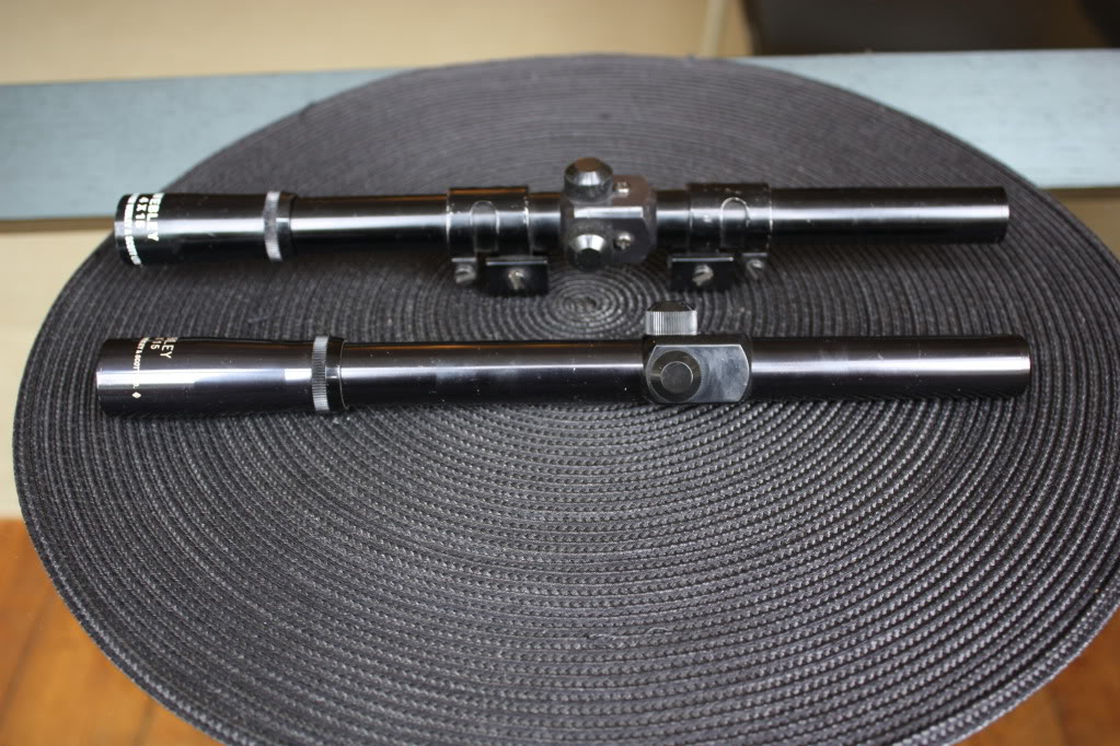

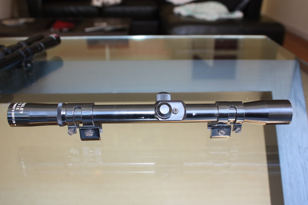

Here is a picture of a Webley 4 x 15 almost identical to the one I used to build the Frankenscope. The only difference that I can see being the screw heads on the windage blocks; they are better than the ones I used on my original Frankenscope, they are rounder and more domed. The ones on the windage block from my first Webley 4 x 15 were much flatter (see below).

I don’t necessarily know which of the Nikko Stirling Mounties is older so I refer to them as “1” and “2” respectively as that is the order in which they were purchased.
So, the main tube body of the scope is from Nikko Stirling 1. The tube on Nikko Stirling 2 is not identical. The Nikko 2 tube is longer by roughly ¼ inch. Enough of a difference to be noticeable to the naked eye when constructed. This is not due just to the difference in overall length of the scope but because it puts out the position of the windage blocks a fraction which makes the overall dimension changes more noticeable. When I tried using the Nikko 2 I could not match the dimensions posted in the picture by Sidewinder.

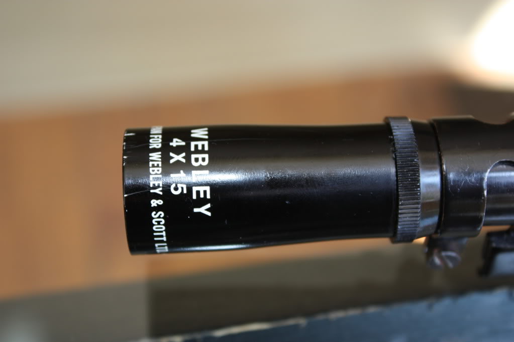

The Labelled eyepiece with the brand name (the one that points to the front on the ESB blaster) is from the Webley 4x15.
Ditto with the knurled ring, the 4x15 from Webley.

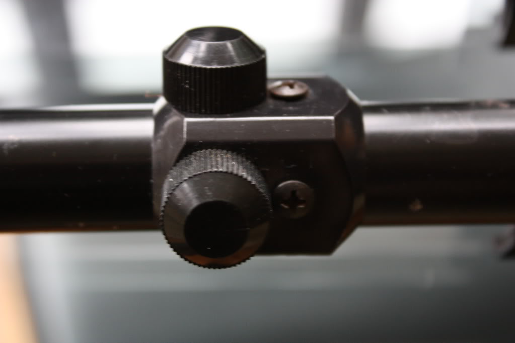

The Windage block and elevation caps are from the Webley 4x15 also.
The unbranded eyepiece is from the Nikko Stirling Mountie – 2.

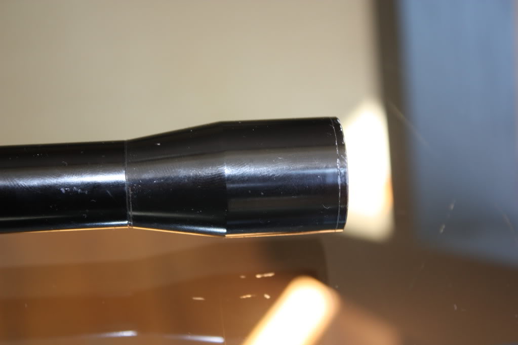

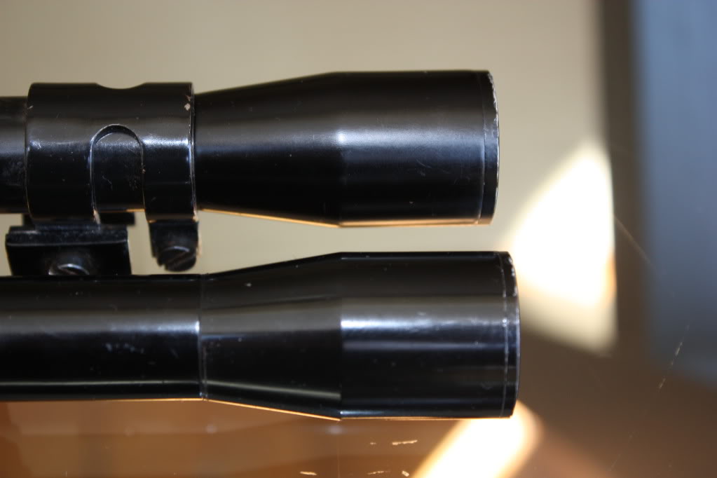

I had previously used the eyepiece from Nikko 1 but it’s dimensions did not quite please me. It appears fractionally shorter overall but more noticeable is the point at which the eyepiece tapers; the definition is sharper on the Nikko 1. The Nikko 2 has a much softer taper and this appeared closer to me.
Nikko 1 Eyepiece (rejected).
Comparison of Nikko Eyepieces. Nikko 2 is the preferred one at the top.

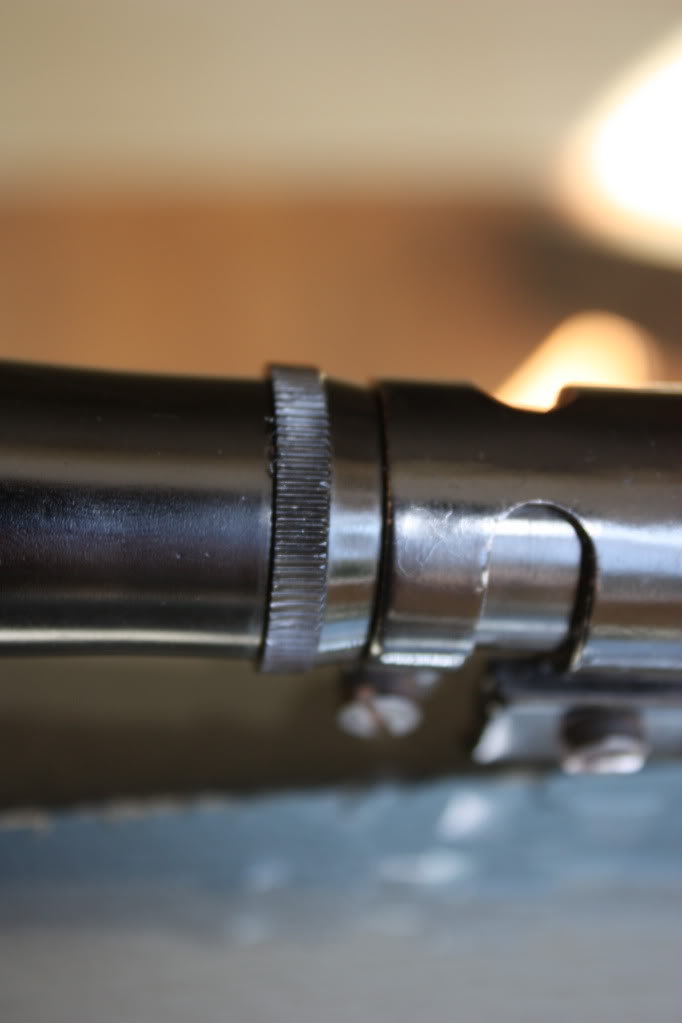

Scope mounts with correct hero rings and tall feet were from the BSA 4x20 from the 50’s. Here's a close up of the branding:

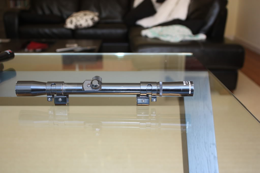

Here is the completed scope:

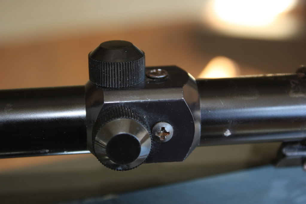

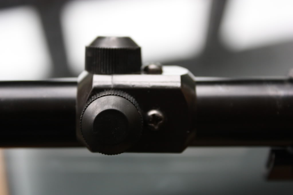

One area where I'm still not quite happy is the screws on the windage block; to me they appear slightly too flat and should have more of a dome shape to them, to be more rounded. I do have set that have the right shape on the screw head but to do not fit the screw holes. I had considered starting to chop bits up and securing them in place but reconsidered as i felt it defeated the point of the whole exercise. Overall I'm very happy with the results. The final used pieces were not the only scopes I looked at and compared just the pieces I chose finally. To simplify things I believe that you can get most of the way there with:

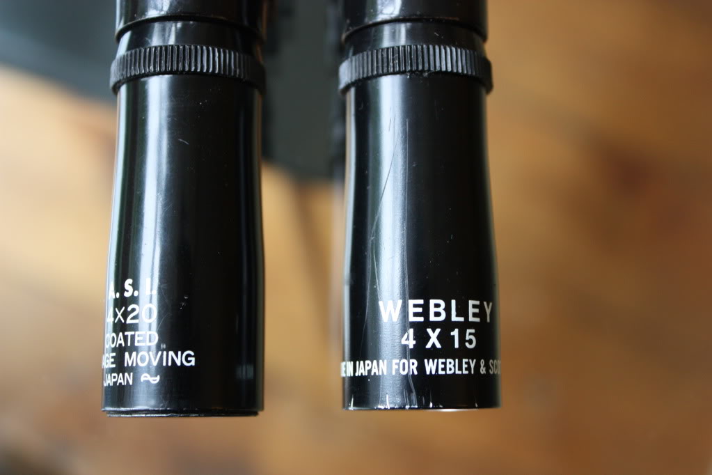

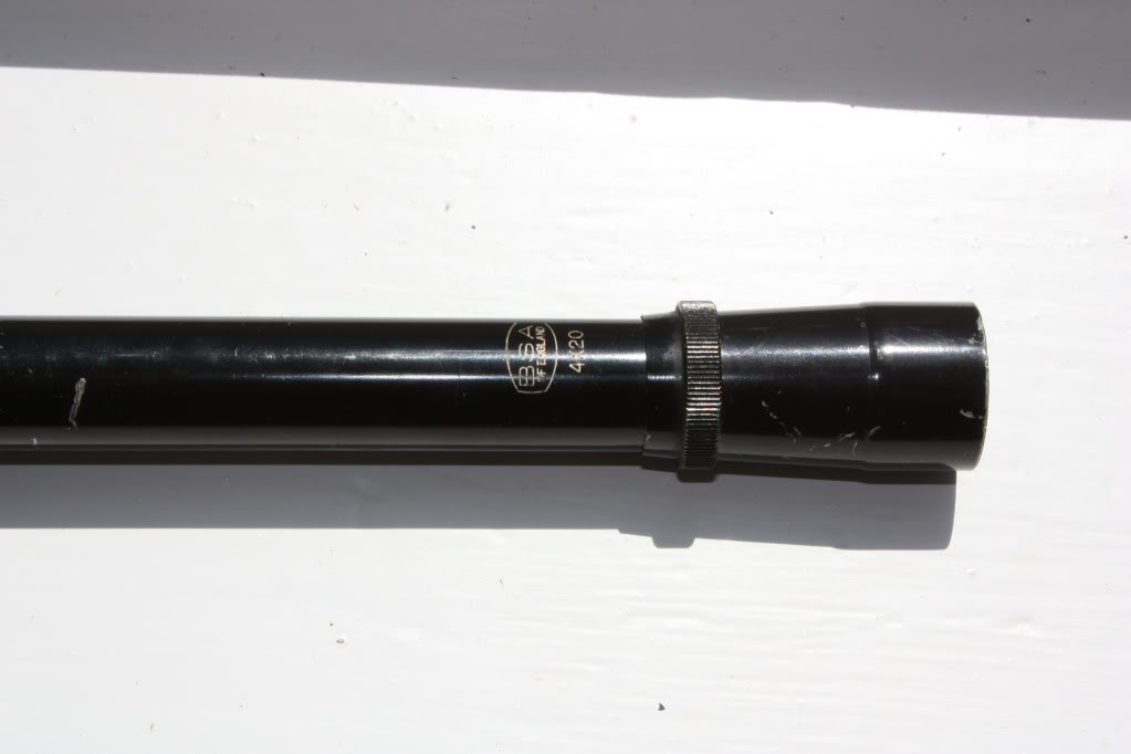

First is a comparison of the ASI and Webley 4x15 Branded eyepieces. They are identical (except for the branding of course).

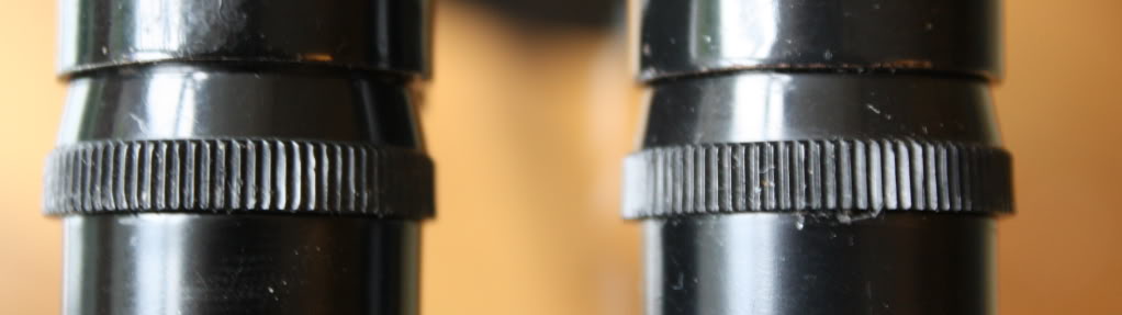

Knurled rings. ASI on the left. Webley 4x15 on the right. Identical.

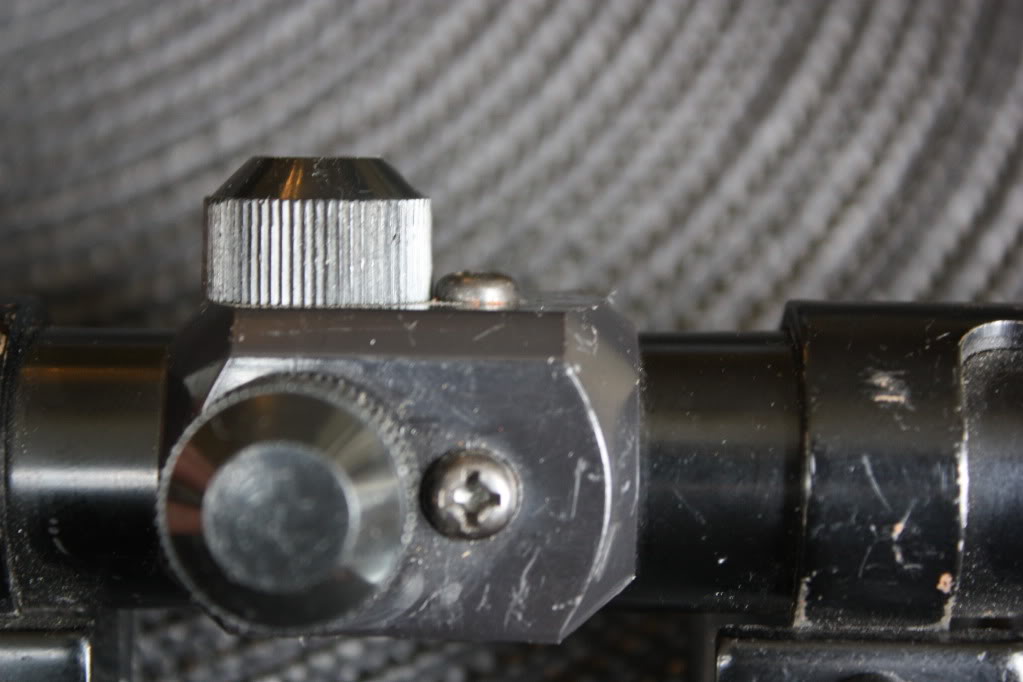

Here's the windage block and elevation caps on the Webley 4x15. It is the same as the ASI 4x20 with the exception of the screws that attach it to the tube of the scope. The Frankenscope (top) features screws which are too flat. The ASI screws are rounder than the Webley. I had thought this would be the case as noted in a previous post.

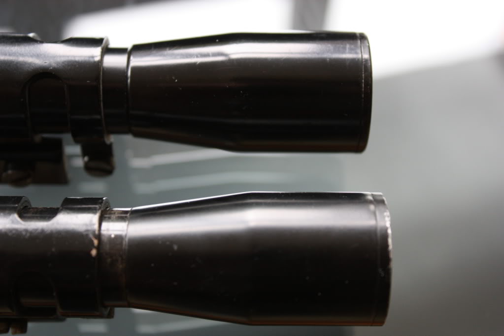

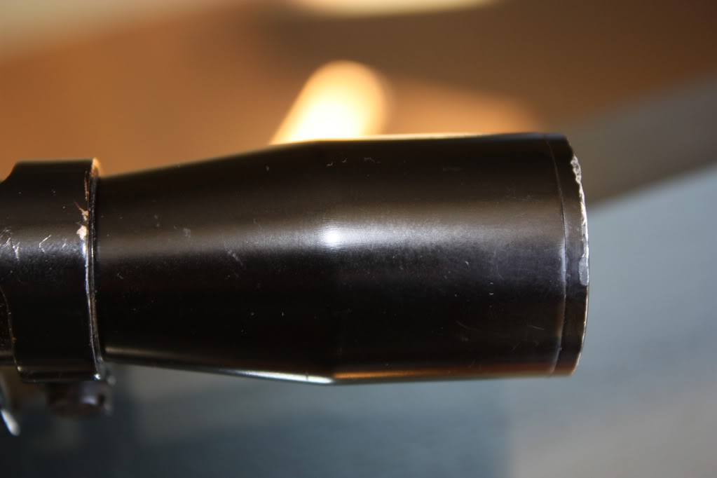

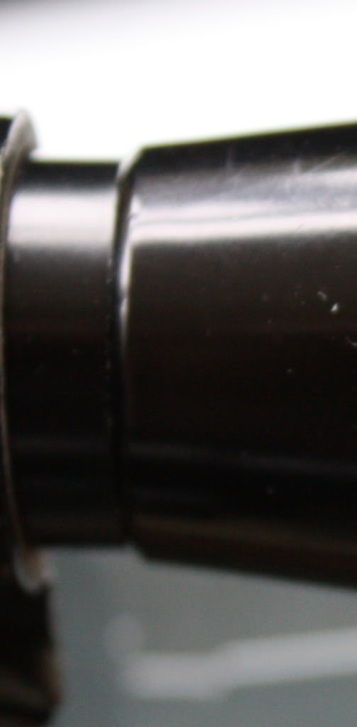

A comparison of the unbranded eyepieces. My Frankescope uses the unbranded eyepiece from the Nikko Stirling Mountie 4x20. The overall shape is fairly good but not exact. One feature I hadn't known about was the the ASI unbranded eyepiece has an extra piece of detail, almost like a lip where the eyepiece attaches to the tube. On the Nikko the eyepiece tapers straight to the tube and sits flush without an extra stage. I've tried to do a close of what I mean up but it's a bit blurry.
Extra lip on ASI.

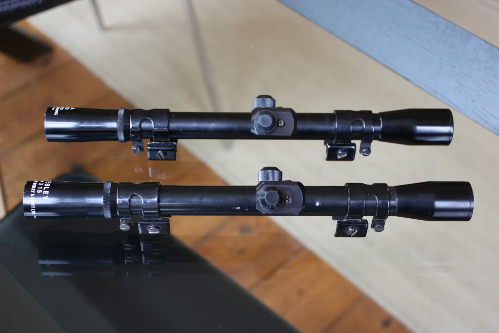

Here is an overall comparison of the two.
So, I still think it's a real viable alternative to the ASI by means of part bashing. Secondly (and I realise many of you will be aware of this already) there are of course other scopes that share the same dimensions as the ASI and only have different branding. I have acquired one of these and so this is also a viable alterantive and no doubt preferable to a frankenscope for many. If you can find one of course, I'm not sure these are very common either.

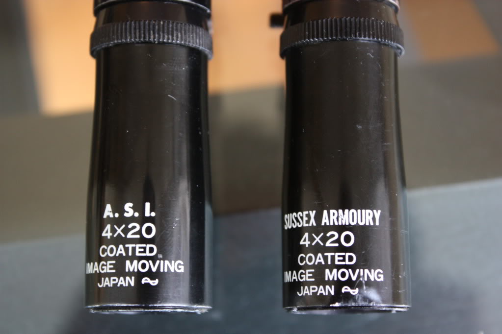

The Sussex armoury 4x20.
With the exception of the brand name this is absolutely identical to the ASI 4x20 in every single facet. I have not troubled with the same number of comparisons of the different parts. Please take my word, it is identical. Mine has a little dink in the eyepiece but it's barely noticable and of course it shares the wavy line with the straight line through/infinity symbol that's a major factor in the search.
A comparison of the Sussex Armoury 4x20 and the ASI 4x20. ASI on the top. There the same, including the extra lip on the unbranded eyepiece.

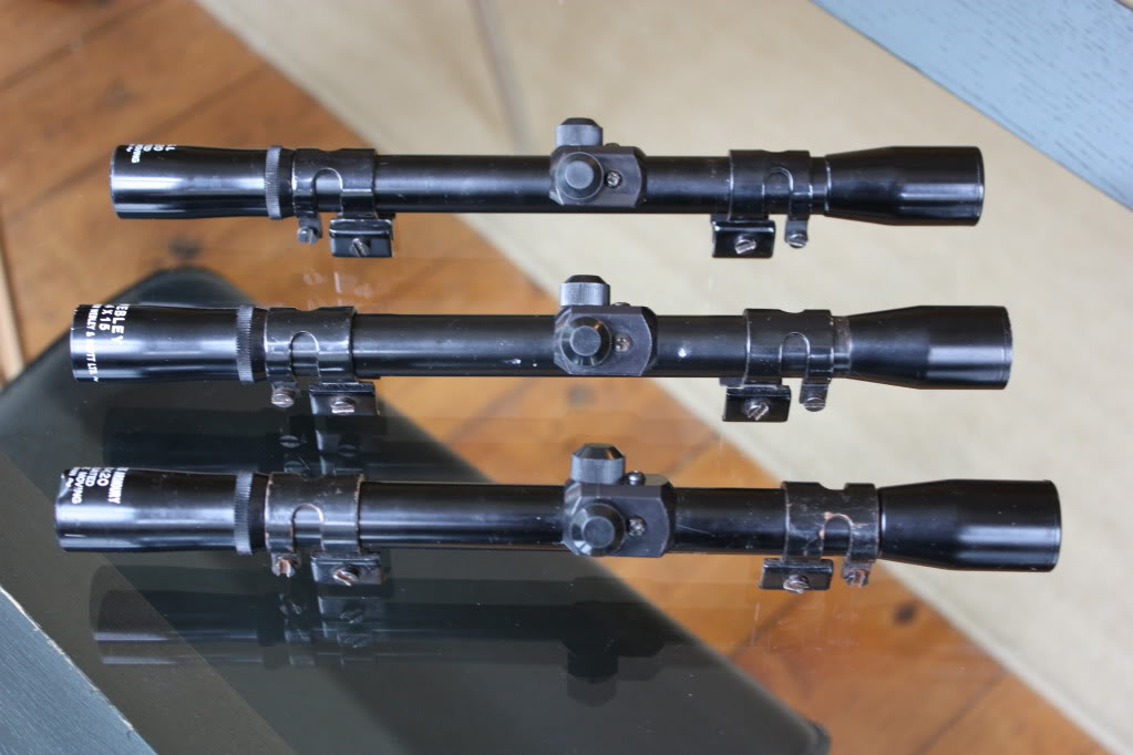

Here are all three compared. ASI on top. Frankescope in the middle. Sussex Armoury on the bottom.

Not all Sussex Armoury scopes are correct either.
Look for the squiggly line symbol (sideways backwards S with a line through it).
Check the adjustment knobs, the knob base, eyepiece, knurled ring etc.

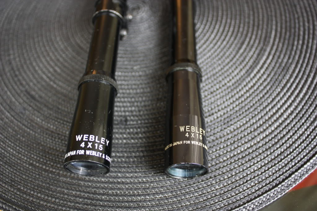

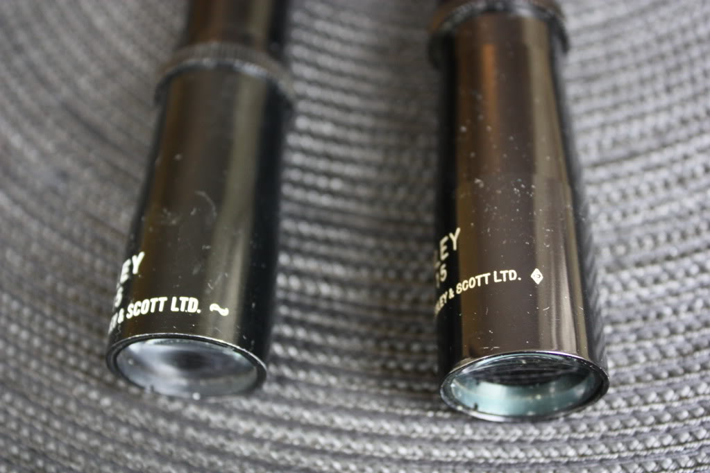

I got another Webley 4x15 recently, it was almost identical to the one I used in my original Frankescope build. The only difference being that the scre heads on the windage blocks were rounder and more domed, just like the one on the ASI 4x20 scope and the Sussex Armoury 4 x 20 Scope. I have updated my first post with some more pictures.
Also, here are some pictures of the two types of Webley 4 x 15 that I have bought to acquire these scope rings and tall feet. I have bougth three Webley 4 x 15 in the last six months or so. All had the correct rings and tall feet as well as the one that I let slip away on 24/06/2012 (above). That makes four sets of the correct feet and rings on the same scope in six months. I definitely recommend that anyone that needs the correct rings and feet goes for the Webley 4 x 15. Happy hunting.
The Webley I got this week. Almost identical (actually slightly better) than the one I used in Frankenscope.
A comparison with the other type of Webley 4 x 15 I bought. The scope rings removed to be put on the Sussex Armoury. Note that this is vastly differen to the other Webley and not much use for a Frankenscope. The only other part that is the same is the knurled ring. The windage black is different and although the dust caps on the elevation screws look correct they are marginally bigger than those used on the other Webley and the ASI and Sussex. They do not secure to the ASI or Sussex elevation screws. I have tried them. They are too big!
Eyepiece comparison.
Different manufacturer symbols. The one we want is on the left. Incidently, I have seen ASI 4 x 20 scopes with the symbol on the right.
