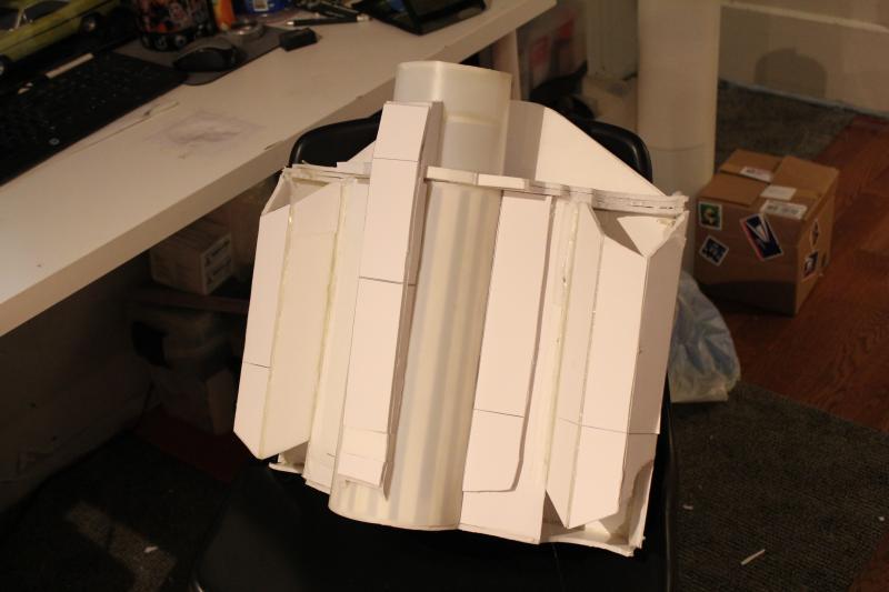

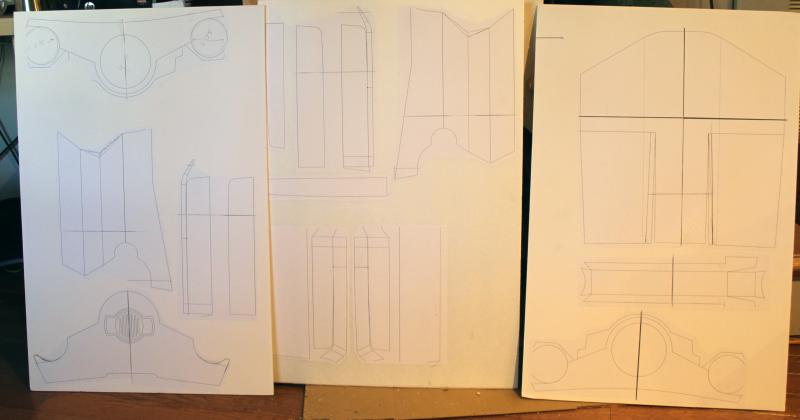

Ok here are the main body templates glued onto the foamboard with a few "fixes". I actually did a couple more after i took the pics lol.
Again, i cant thank WOF enough for these templates. Id have no clue where to start if it wasnt for him.
Also thanks to Matty Matt for his tips with his build. Its one of the best ive seen!

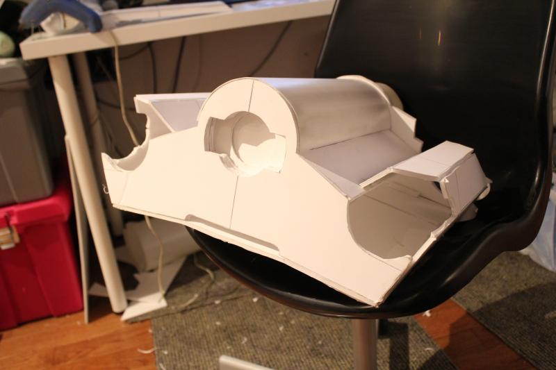

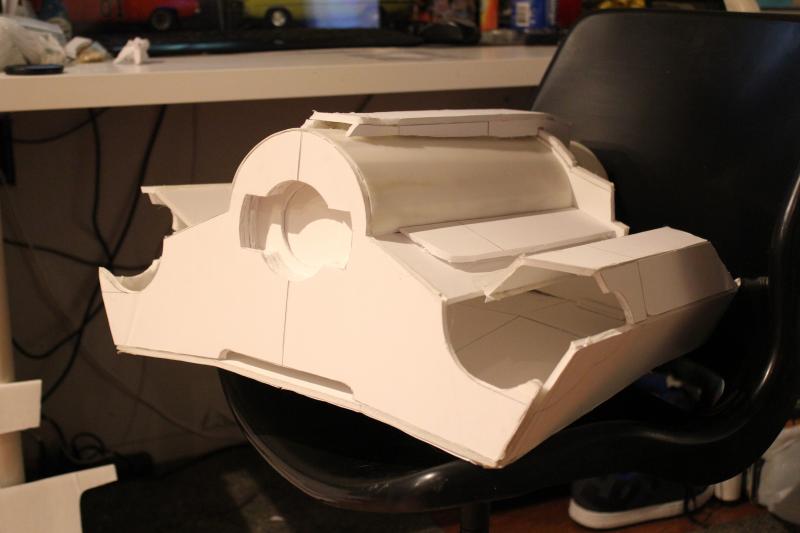

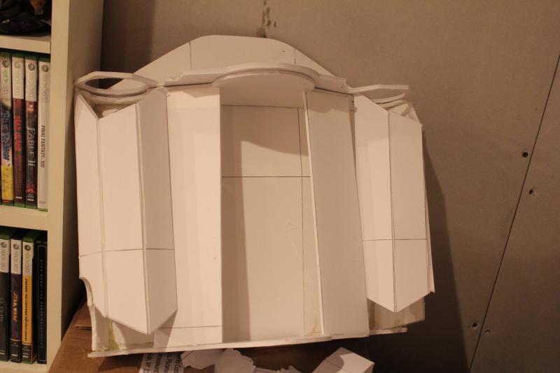

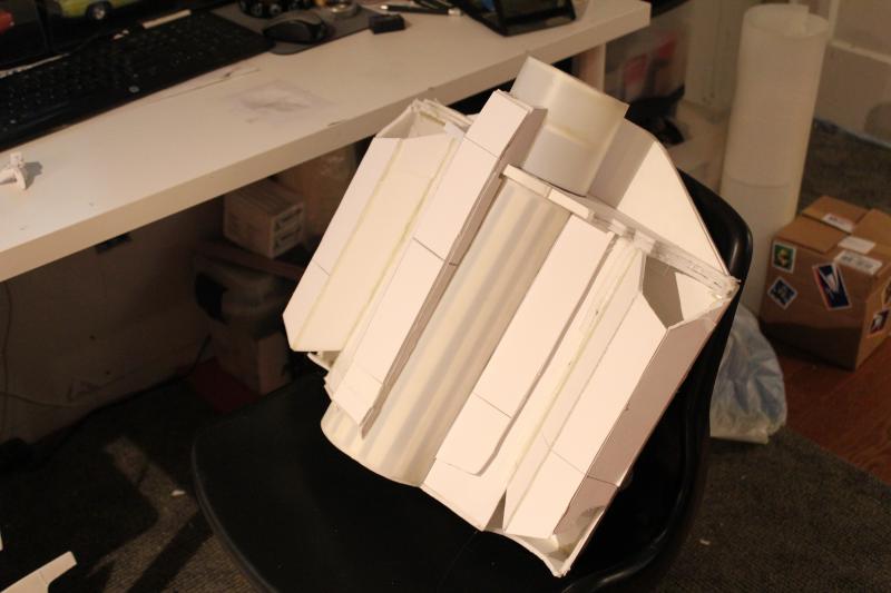

Ok so got some mor done today. Had a little mishap when i realized i wanted to move some stuff around on it, but not a big deal it can all be fixed. This is all just foam core board, some plastic stuff i found in the house, and hot glue. There is no filler/spackle/bondo on any of it yet :)
Still some things i want to fix up and finish, but the main body is almost done :)

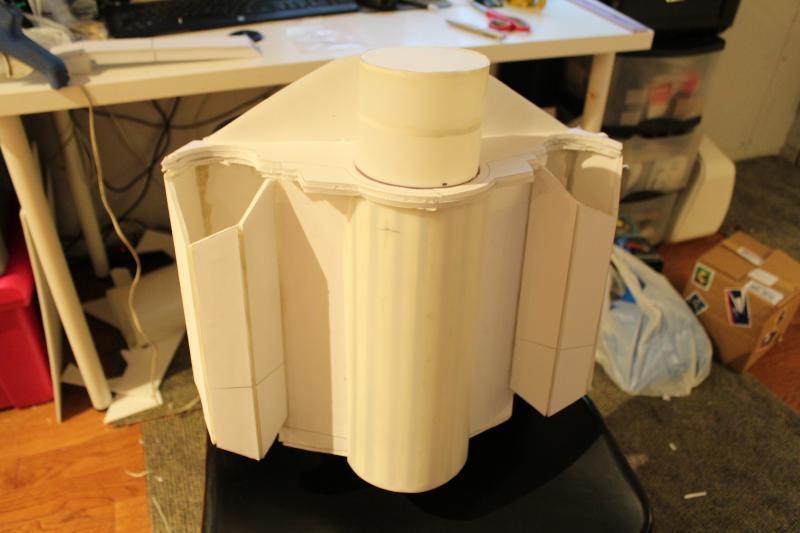

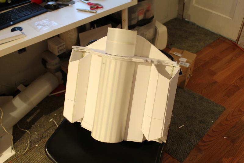

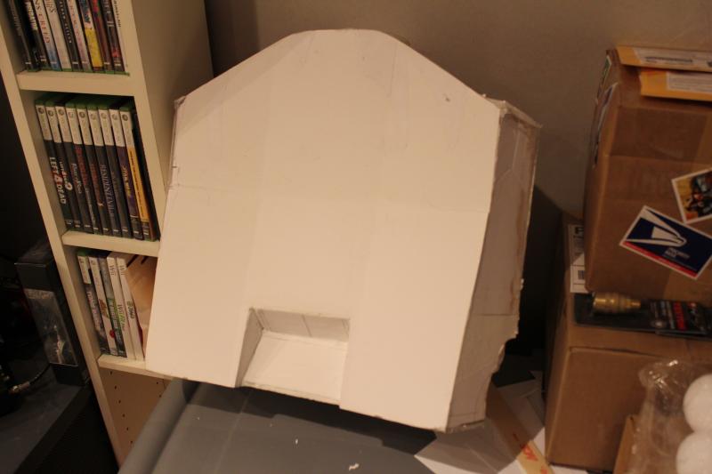

Ok so heres where im at now. There is only so much i can do working with the templates to correct some accuracy details. So there is a good chance i will end up taking a mold off this when its done cast one, and then tweak it further and take a new mold. Then i will be done...i hope lol. Im not going for absolute accuracy here with the first go, and honestly if im happy with it and it looks nice i wont likely mess with it much.
thank you sir :)

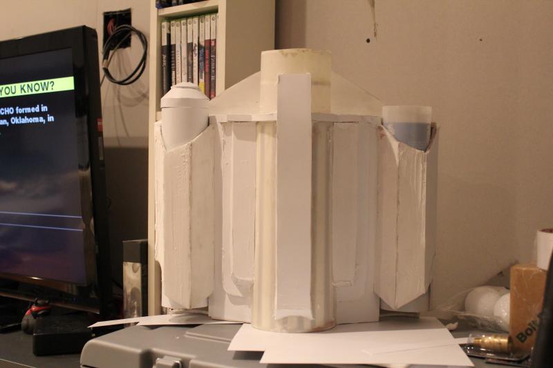

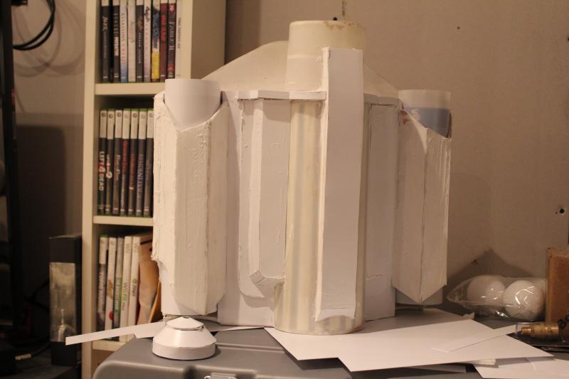

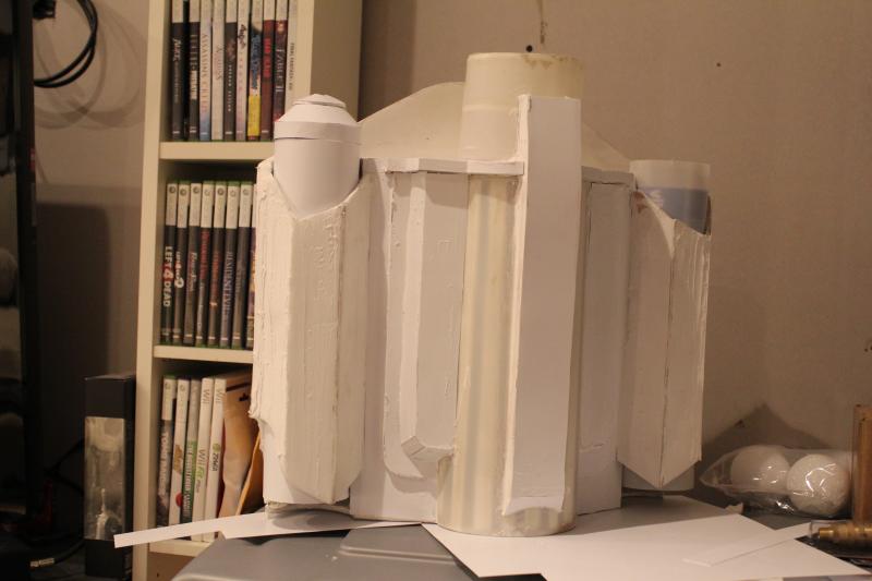

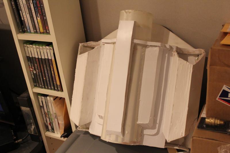

Ok so heres where im at now. The fuel tanks are vitamin water bottles wrapped in .020 styrene. they are technically less than 1/8th of an inch too big, but its negligible i think. (i also have this plastic thats very similar but transluscent that i used on the center area, and the right side fuel tank).
I made one top cap with the styrene, using the upscaled WOF templates. Its going to need to be fixed up a little bit. But thats fine as i'll be making a mold of it anyways as i'd like it to be a separate piece anyways.

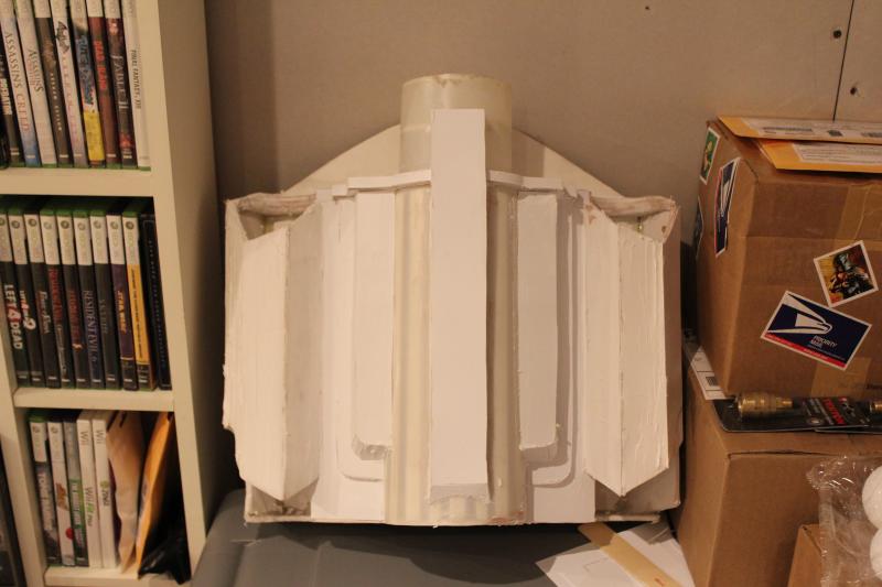

Previously the center raised are was extended about and inch so it ends closer to the bottom. I had forgot to mention that. Ive also been using Rafal's measurements he had posted a while back. So far im pretty on point sizer wise. The pack is just about 16.5" wide.
I also added the correct inset on the back for the greeblies if i choose to add them :)

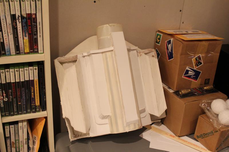

Im using lightweight spakle to fill the seams and also to coat where the couple of pieces of crap foamboard i had decided to wrinkle and shed its paper coating lol. This stuff is MUCH easier to sand than bondo
So far im pretty happy with this. Much happier than attempt #1 lol.
