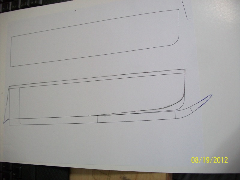

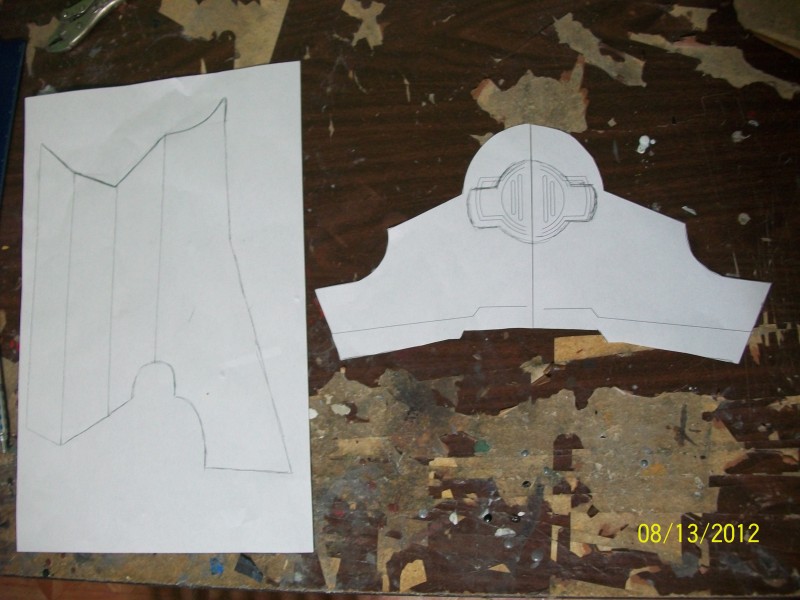

Well...i decided to do something a bit different here with this. Using WOF templates as a guide, ( Studio Scale 15” Jet Pack Patterns ) i am making my own templates by modding Alans to be even more accurate. Im using the reference pictures of the pre-pro pack, and some basic reference from my MOW pack in combination, to get proper sizing.
This is what ive done so far tonight. Not much, but its a start. Once i get the top and back done, i will be able to build onto that.
of course this is a first draft so small tweaks will likely be made.
The bottom looked "thin" to me, (from back to front)compared to the reference pics, and my MOW pack. So i added depth to it, and adjusted the panels that go around the fuel tubes accordingly. i also adjusted some of the angles of the panels to closer match the reference pics.

Im priniting the templates out as i need them from photoshop at 63%. which, i know, makes no sence, but its actually bigger. (if i print it to fit the 8.5X11 paper, at normal scale, its 58% or so, and that gives me the 15" pack). So this should give me a pack closer to the correct size...around 16-16.5" wide. The templates get cut off a bit, but i can figure out what gets cut off.

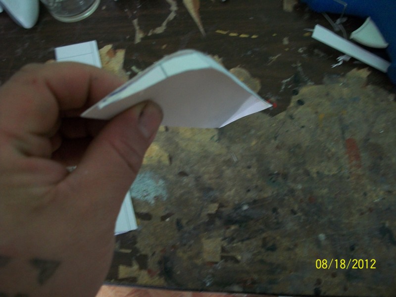

Well i spent a good 4hrs on this today, and have decided to scrap what i have done. Nothing lined up correctly. Im thinking i should build it as the templates are, just a little bigger, and then mod that.....so back to the drawing board.
yep I know that feeling after all the hours I spent doing mine, and it turned out just a tad to small and things were not lining up, still might turn mine into a wall display as its went to far to scrap it, but I will use my MOW jp as a guide for the next one I build, when I find more time one day, hope the next one works for you DVH good luck.:)

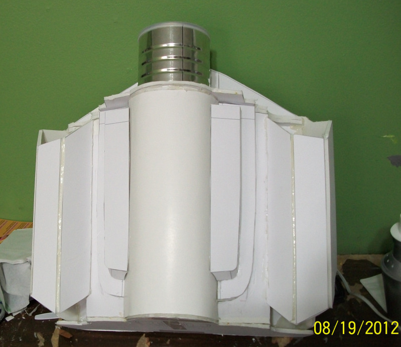

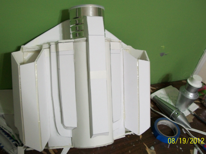

Ok so today i did some more work on this..

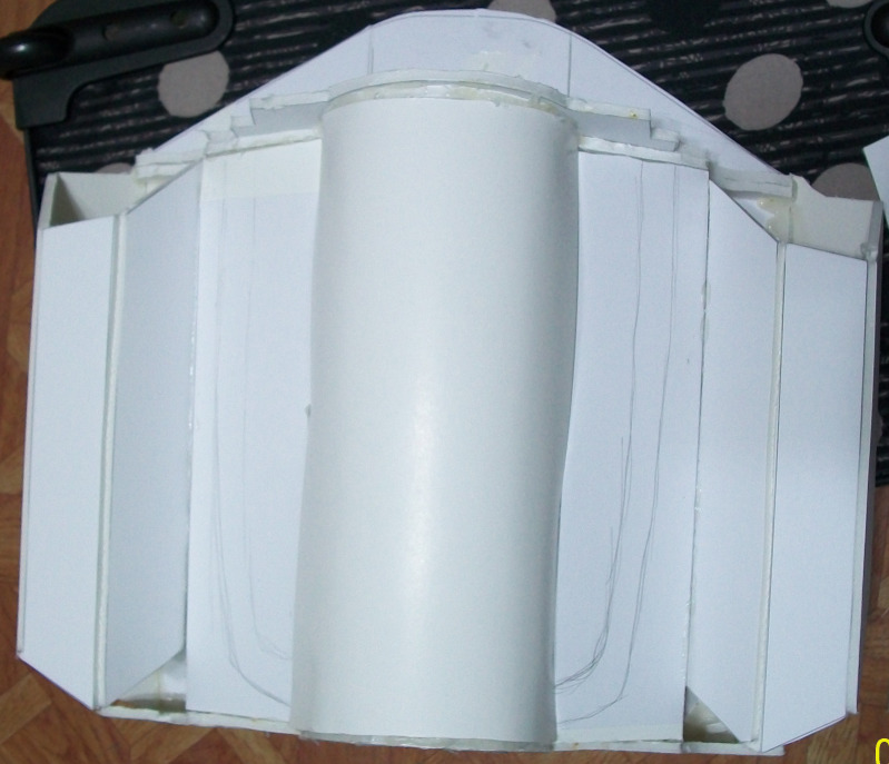

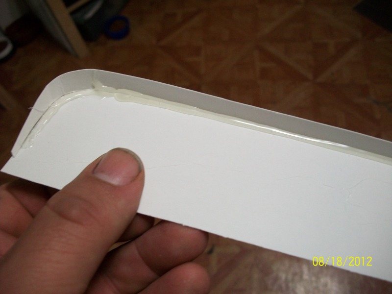

I did the detail "slats" Again, printed through photoshop at 63%. Mounted them on posterboard. In the reference pic, the bottom "slats" seemed to have a slight inward "bow" to them, so i altered the template accordingly.
Then assembled them with hot glue.
I then did the second layer "slat/box". I had to position them a bit lower than they would normally sit, to get them to the proper height from the bottom, going by the reference pics. Here they are both attached with hotglue. I also added a coffee can to the top, turns out it was only a hair narrowere than needed, which worked perfect since i was going to bondo over it.
Added the center strip, done the same way, with posterboard, and hot glue.
I then went in and extended the depth of the bottom to match the photos, and my MOW pack. I went a little overboard on the inset panel, so that will be fixed, but the basic shapes are there now.

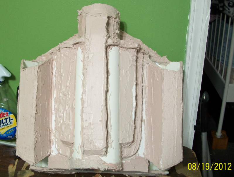

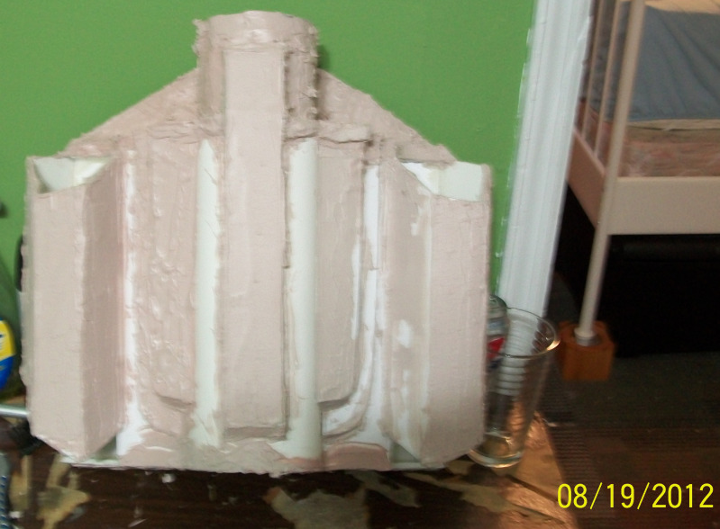

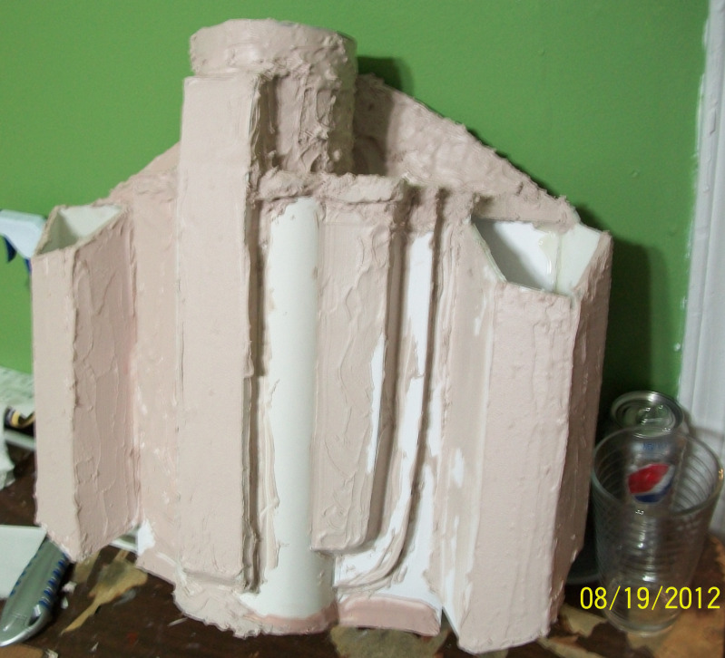

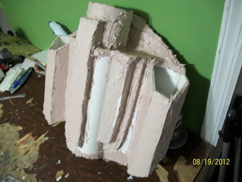

I then started to bondo the pack. Obviously it needs to be sanded and then re-bondo'd and fine tuned etc...but this is where im at now:
thats it until im back from C6!
Everyone waiting for items from me, i will get back to yours when i get back as well!
Wow thats alot of bondo there, think you over did it just a little? Looks like your having fun though
Not at all. I know, it looks rough but its not thick, except where the back curves into the top. It hasn't been sanded yet, obviously lol. Most of the sanding is done with a dremel so it takes me mere seconds to smooth it over. Just didnt wanna make a mess using the dremel 2 days before leaving for C6 lol. This is for a master to make a mold from so some extra bondo in some spots doesnt concern me, just the finished shape/finish.
..and yes..i AM having fun! :cheers
May want to use a mouse sander to keep a level surface....a dremel will sand in one small spot. I know what you mean thouogh on the curved part. LOTS of bondo there.
The "finger" attachment is AWESOME for this...when I built the 3/4 scale used the **** out of that thing...I actually BROKE one of the posts that hold it all together...need to order the part to fix it, or buy a new sander.
