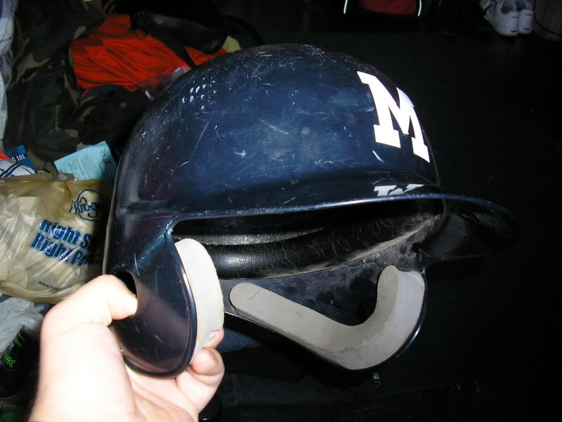

However, I was at a rummage sale today, and check out what I got for a dollar:
What's your opinion, guys? Do you think it's the correct size for a Fett scratch-build?
