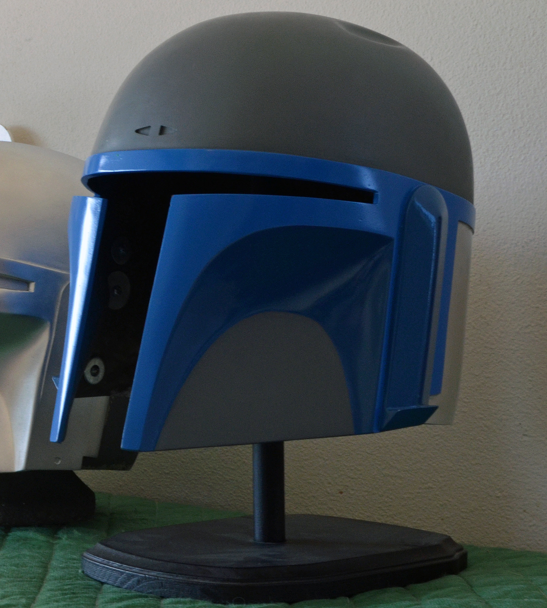

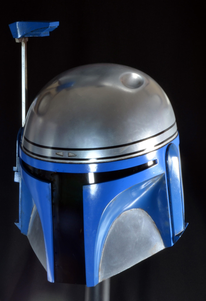

Here is a paint up of a BKBT dented Jango helmet casted by Cruzer. Posting this thread more as a "pay it foreword" than a showing of my paint work. I've gather up the "know how" here on the TDH from current and members who have moved on. Want to share this with all members especially the new guys.
I choose the dented Jango lid cause you don't see them that often these days.
(Gonna jump to the meat and potatoes of this thread) we all know of a good set of rattle can colors for the Jango helmet, which are Rust-Oleum "Royal Blue", Krylon "Ocean Blue" and Rub and Buff for the silver parts. Now I've come to find out that Krylon Ocean Blue is not available in the standard 12oz can but is available in the small 3oz cans.

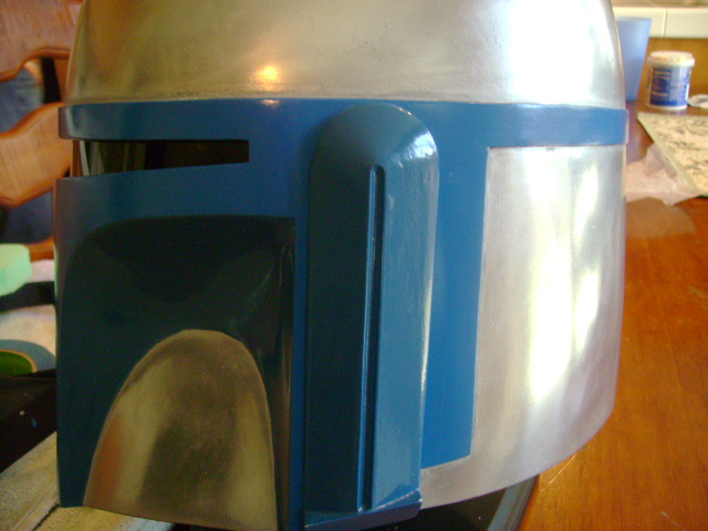

These photos are of the two colors used on the Jango lid. Ocean Blue (lighter blue) used on the upper parts. Royal Blue (darker blue) used on the lower parts, ears and range finder.

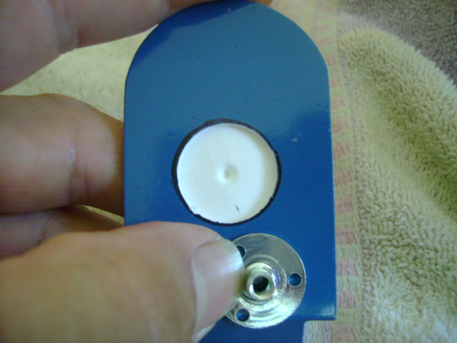

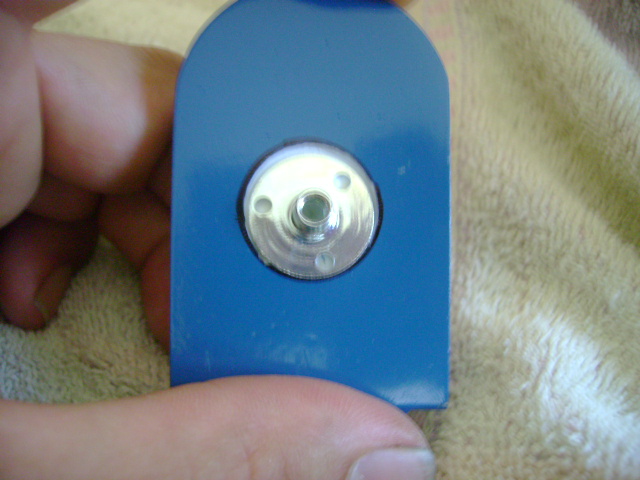

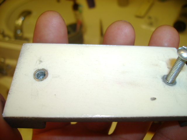

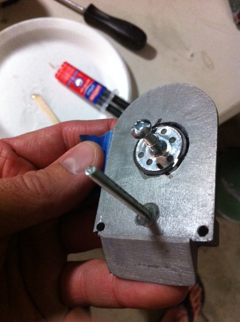

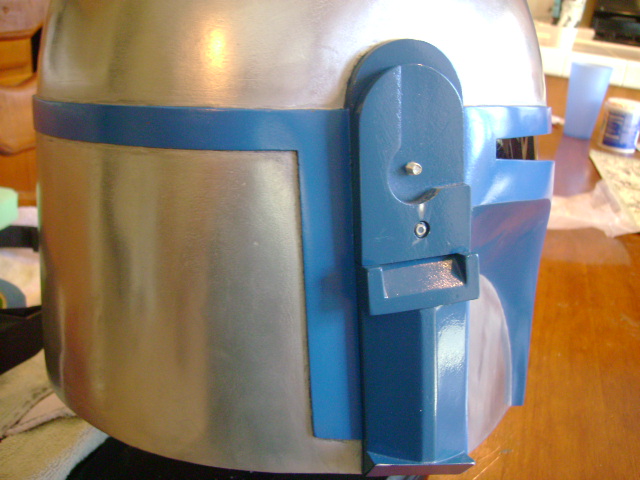

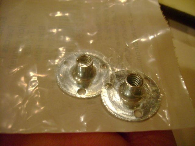

Before I move on to the silver part of the helmet I want to mention attaching ears to the helmet. Now at days some helmets are produced with ears already molded into the helmet. For those that are not is info is for you. In the photos you'll see different methods to attach ears and ear caps. "T" nuts, machine screws, and thread inserts all different methods to achieve the same thing.

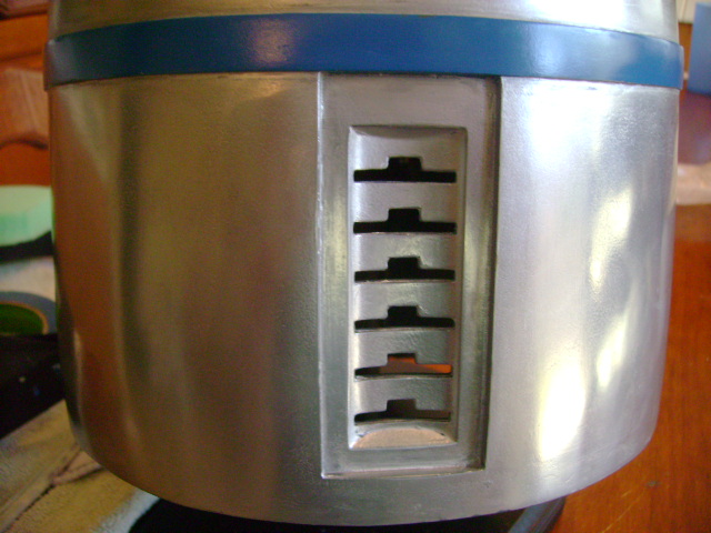

Moving onto the silver part. Now if you have a cold caster helmet this part dose not apply.
I have attached a link to a You tube video on how to use Rub n Buff.
How to make armor with Sintra, Rub & Buff, and weathering - YouTube
I did not make this video, but with this video, I learned how to use Rub n Buff. I do recommend a little practice on something other than your helmet first time around. When you're ready to Rub n Buff your helmet start with the back panels(for more practice).
