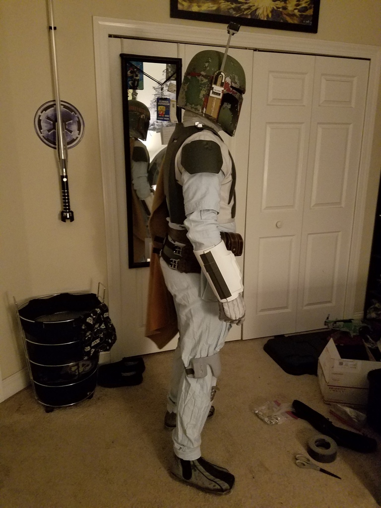

Hey TDH! I've been a lurker for a few years, and built a lot of custom mandos in that time. And decided to FINALLY put together the man himself. I've got a LOT of build pictures, so I'll be updating this thread over the next few days. But for now, here's an up to date picture, and a list of items I currently have!

Basically the same as me...well, I'm a little beefier at the moment. Gives me a good idea of how I'll look as I have pretty much all the same major components.
Awesome! I can't wait to see for sure!

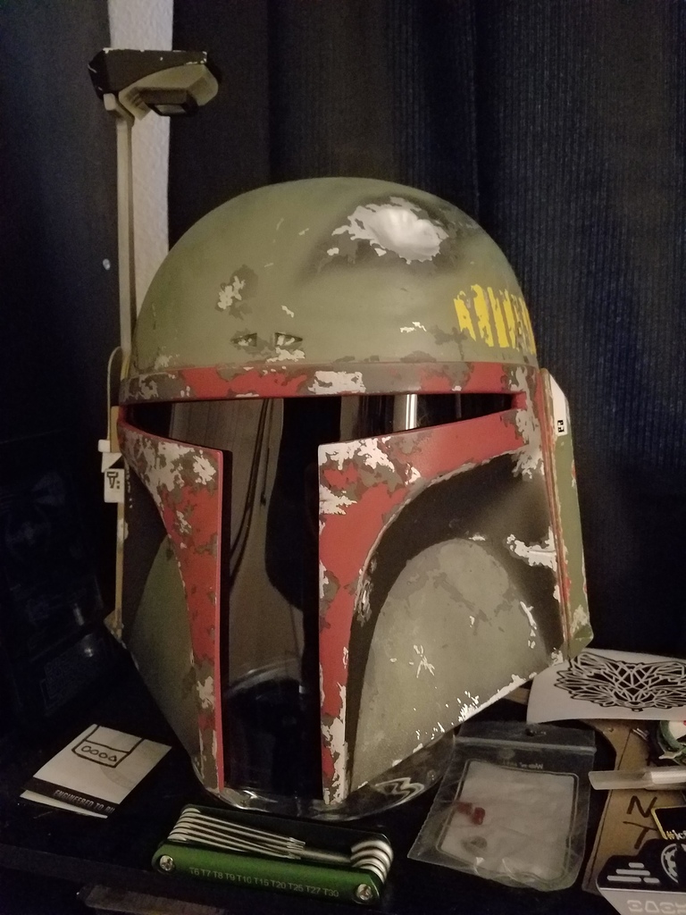

Alright. So to start, I did my helmet assembly. I also did a cheek brace from some metal I had lying around.
Bondo, two coats of filler primer, and a nice coat of dark primer later!
Just gonna fast forward to a finished helmet picture to save time.

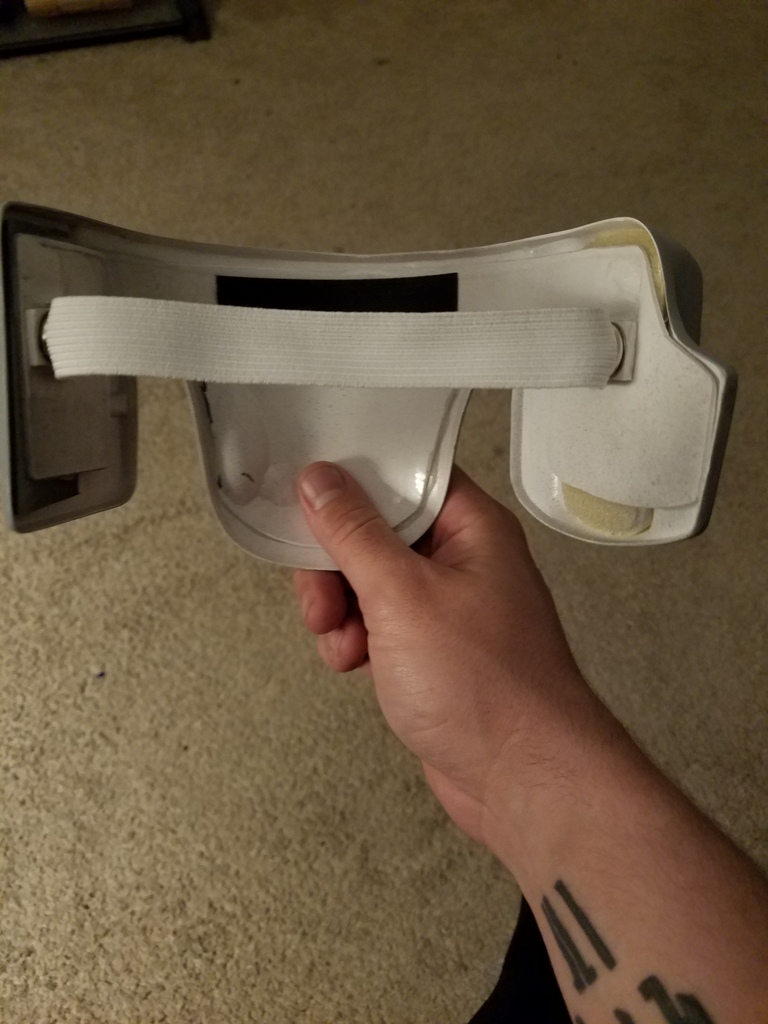

Now for my plates, I wanted to be a perfectionist, and make sure that each plate was the same thickness. So I trimmed all of the edges off of my plates, and added my own using 3mm sintra.
I'm using fettastic's clutch back method for attachment. Once I re-lined the plates, I did a test run to see how nice they looked on a vest. The end result was VERY satisfying for sure.

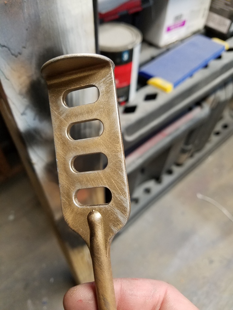

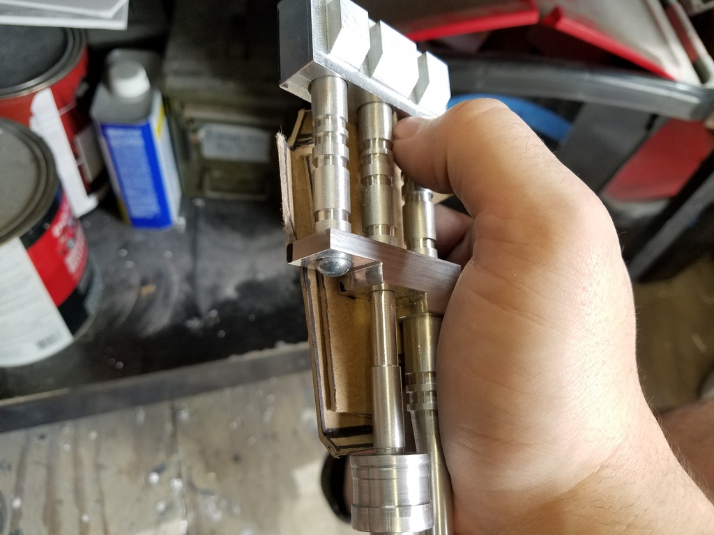

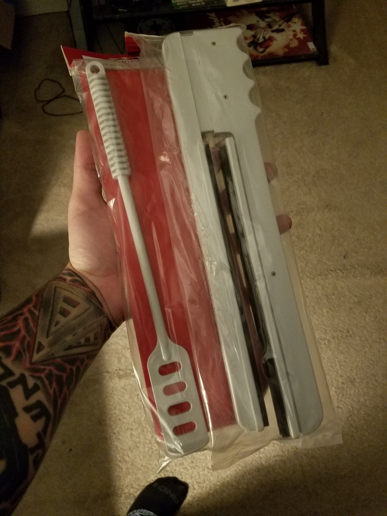

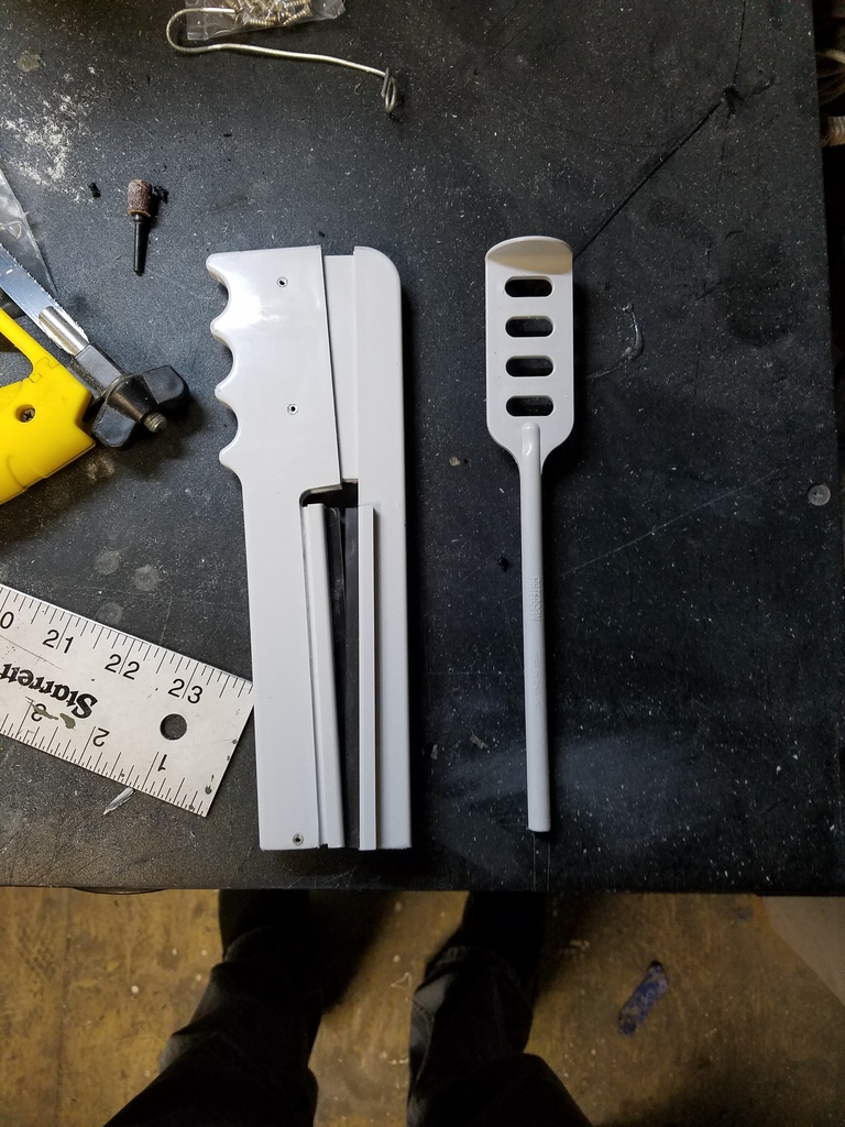

Onto shin tools! Fettastic gave me a quick rundown on how he painted his, and I went to work.

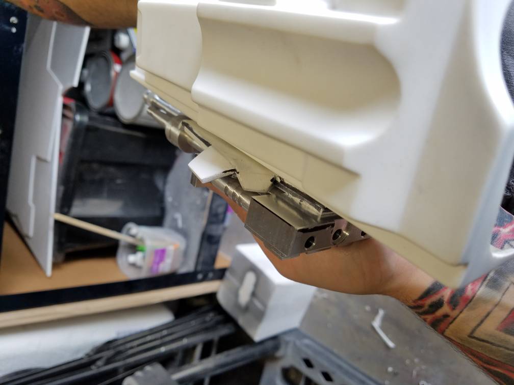

So. I love my combatbaby flamethrower. But I wasn't a fan of the backing plate. So I looked at pictures of the RKD kit, and replicated one to match my combat kit.

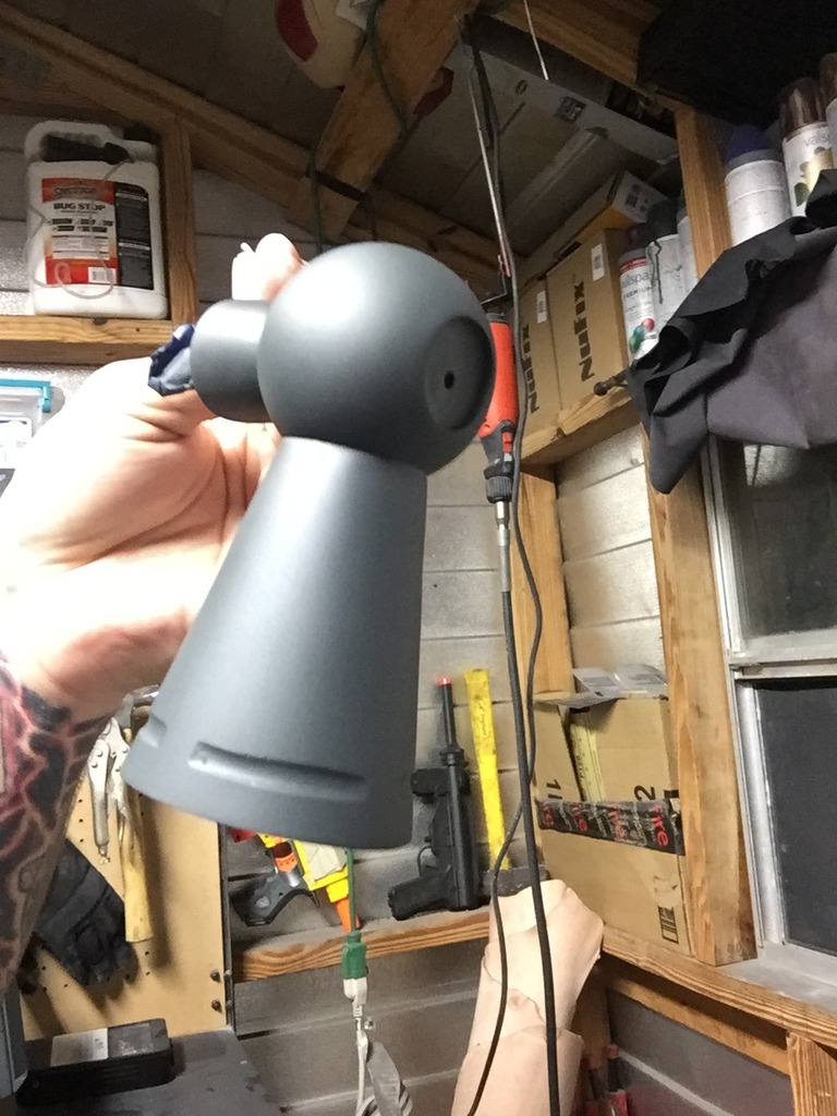

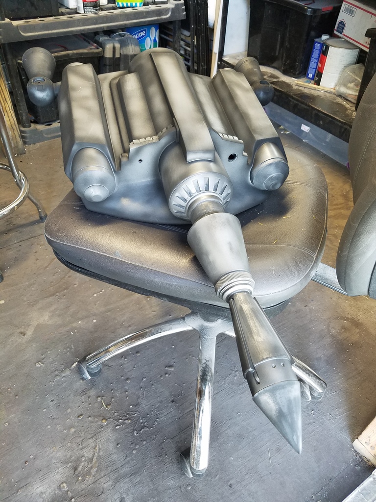

I actually started with the jetpack first. I ordered an MOW kit. I don't have many pictures of the early beginnings of the build, since my camera broke LITERALLY the day my jetpack kit came in.
I mounted the rocket and thrusters with wingnuts and some threaded rod.

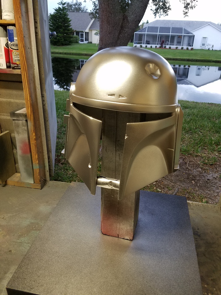

Soon after the jetpack, I got my hands on an animefan budget kit. These kits are STUNNING.

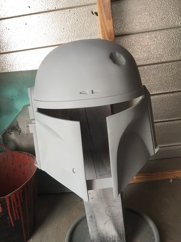

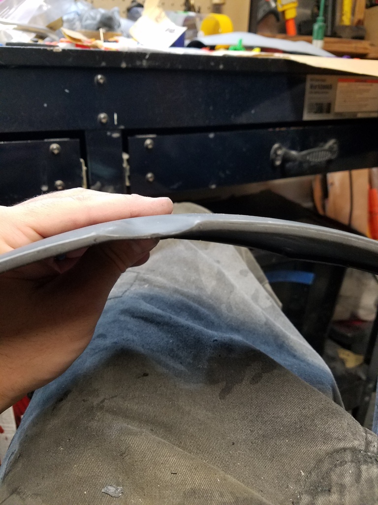

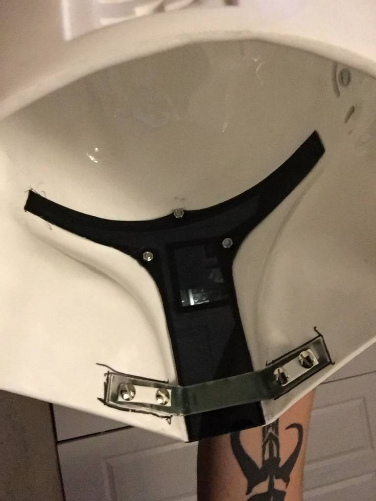

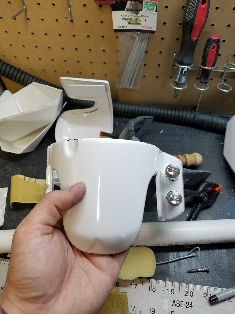

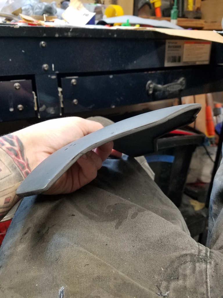

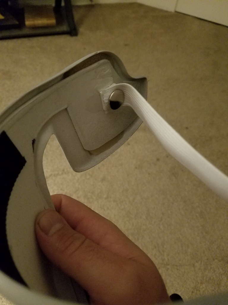

I did a recessed bolt mount on the visor, and I also did recessed Chicago screws on the cheek brace. The brace itself was made from some light gauge steel I had in my little workshop.

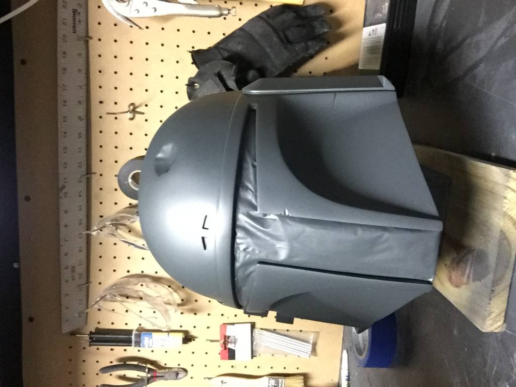

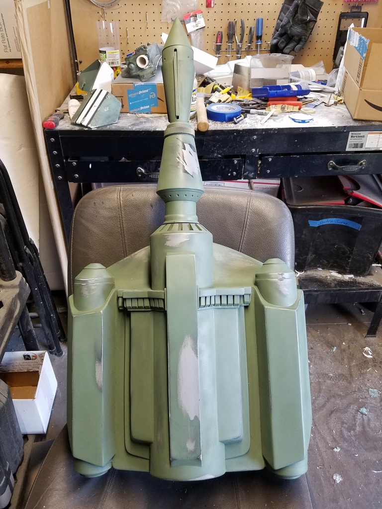

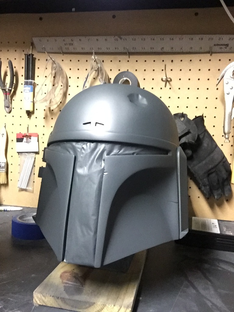

Sanded the whole helmet down with 180 grit, and laid down a coat of filler primer. I also added the physical damage to the appropriate areas. I decided to skip the crack in the right inner cheek. Figured it was gonna be too tricky to properly replicate something that almost nobody would see.

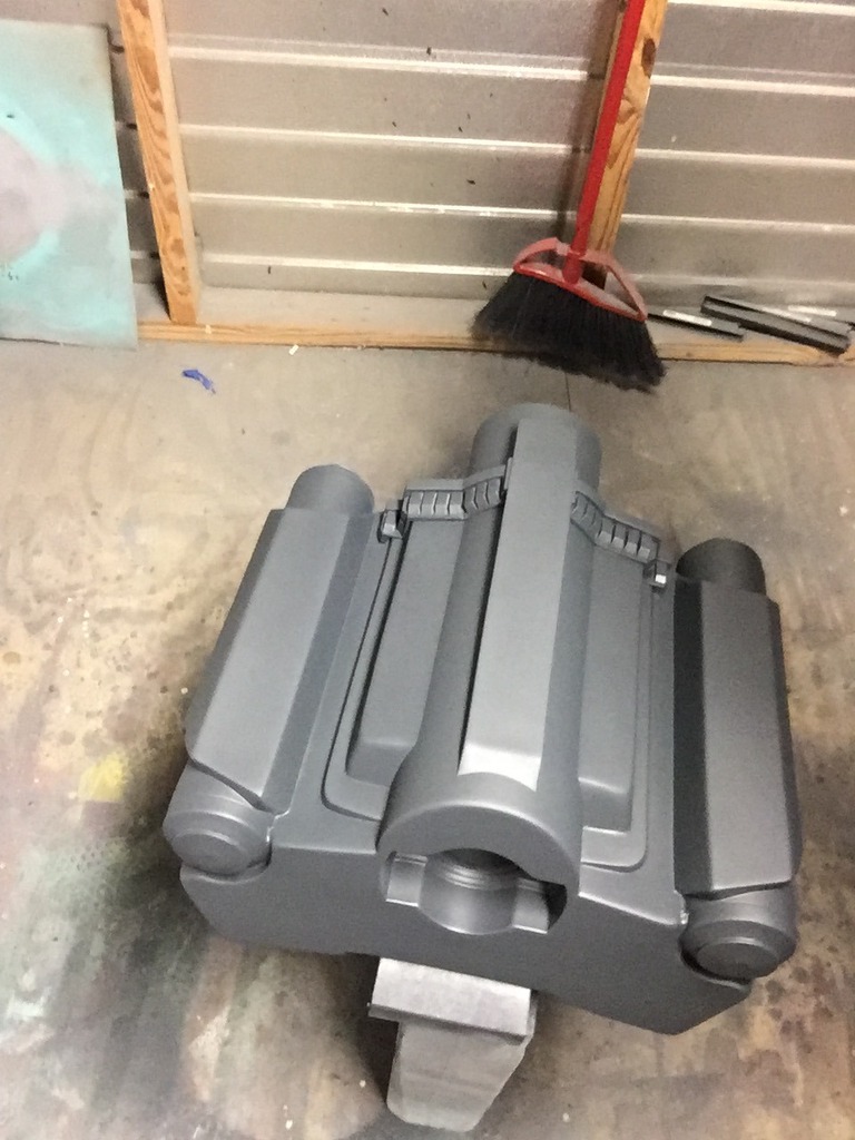

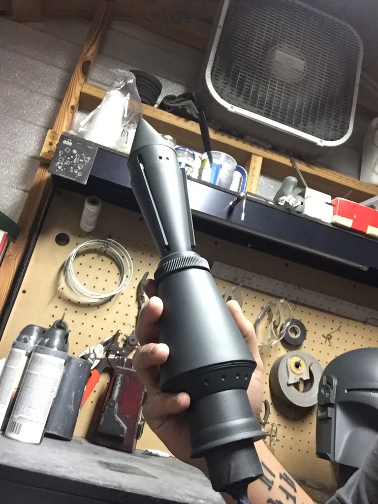

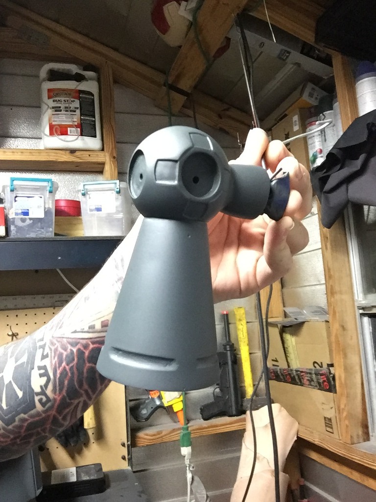

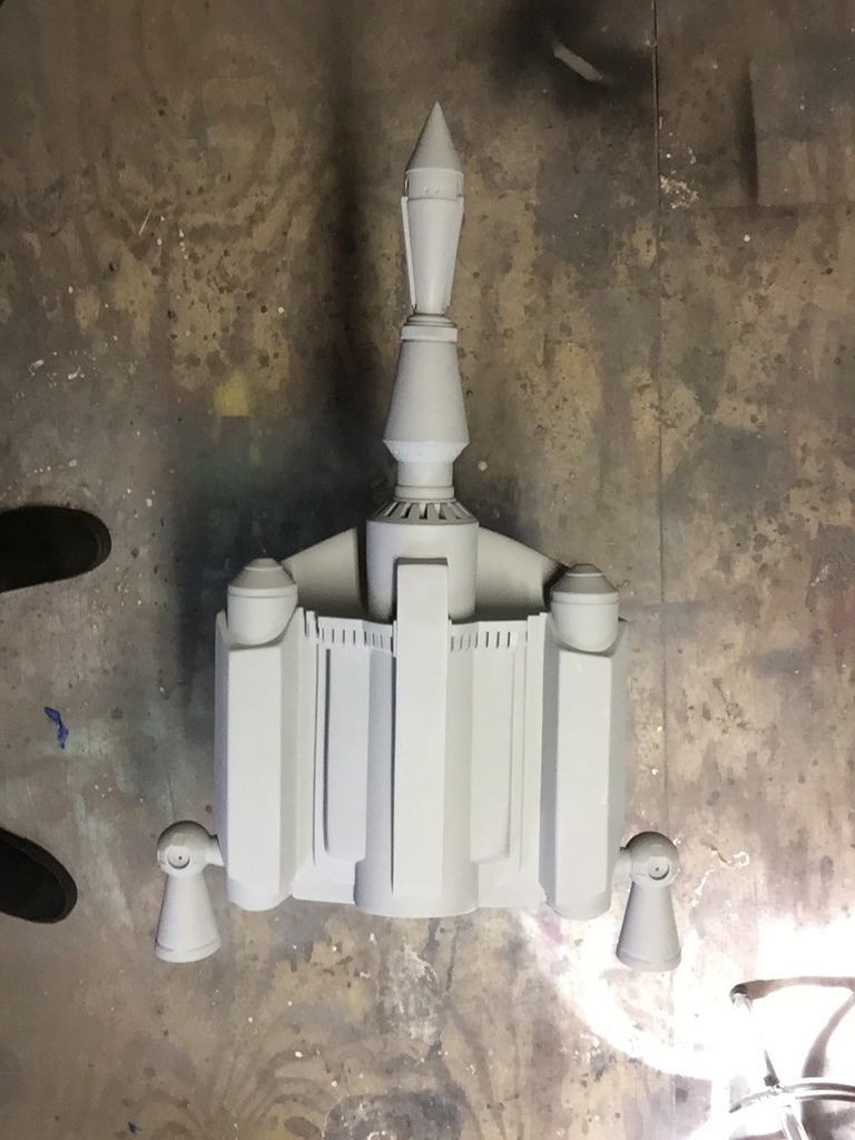

Assembled the jetpack after all the individual pieces cured. I gave them all the same treatment as the helmet.
Once the filler primer was cured, I put on a nice coat of a dark gray paint&primer on both the helmet and the jetpack parts.

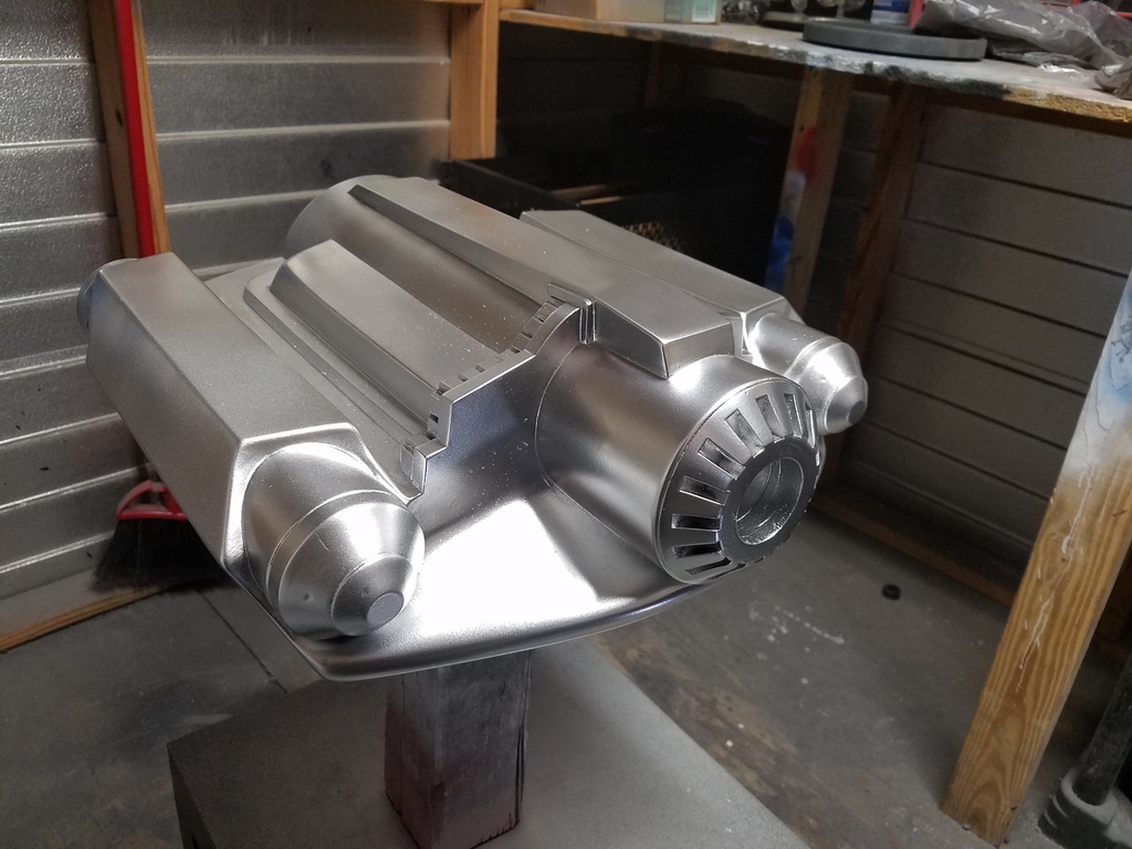

I let the dark gray cure for about a week. It was good after two days, BUT I didn't actually get around to spraying the silver until a week later.

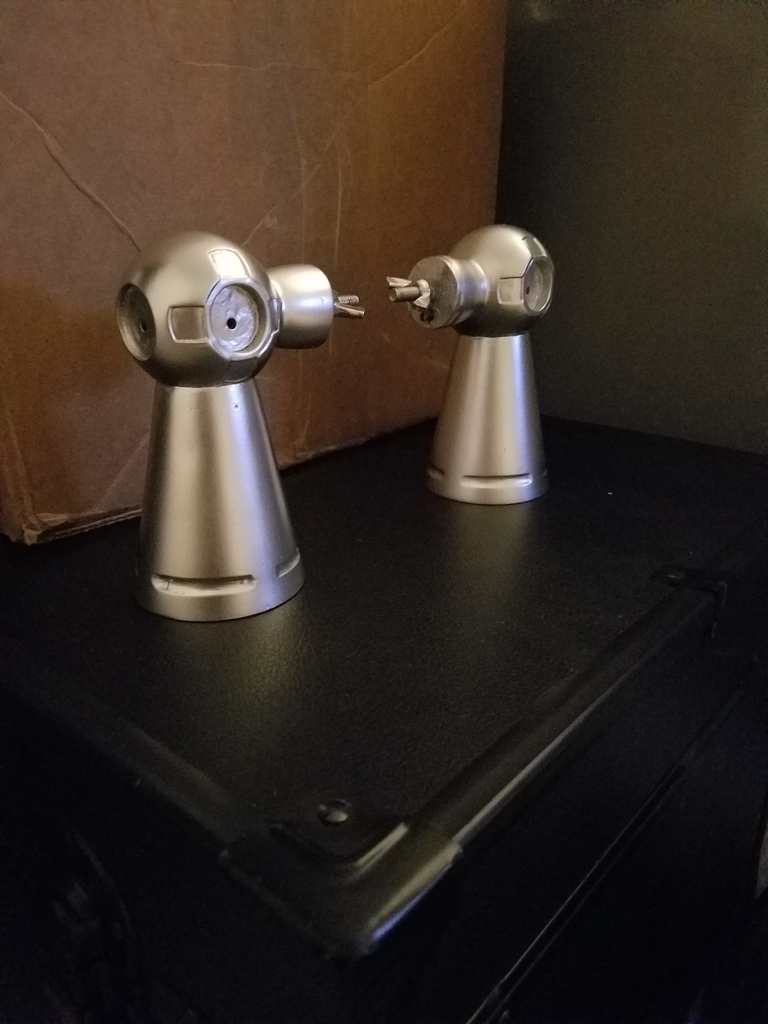

Also. Shiny thrusters.

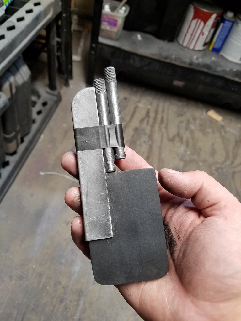

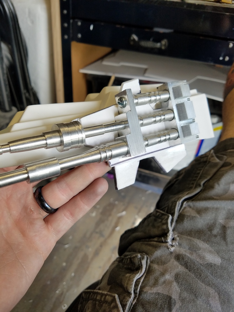

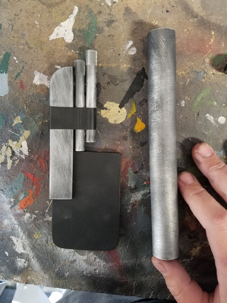

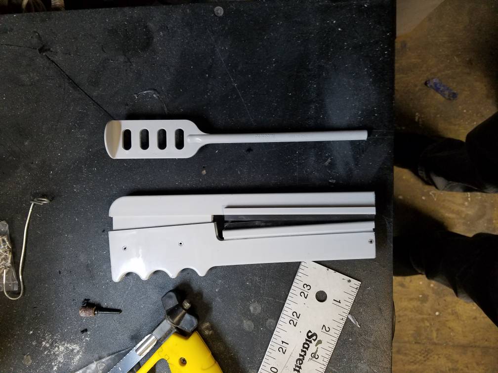

While the jetpack and all the other stuff was curing, I got to work on my shin tools. I went with an original stirrer and squeegee. The stylus brush rods are resin cast from originals, that I got from Molonlabe.
Fettastic helped me out, and gave me some tips on how to paint my shin tools. I used the testors silver enamel in the aerosol can for the base "metal" layer on the tools.
Now, wanting a bit more of a uniform edge on my plates. I trimmed all of the edges off the plates, and re-lined each one with a layer of 3mm sintra.
The end result is a nice, even seal between the plate and the vest, as shown in this little test I did on an old TK409 vest.

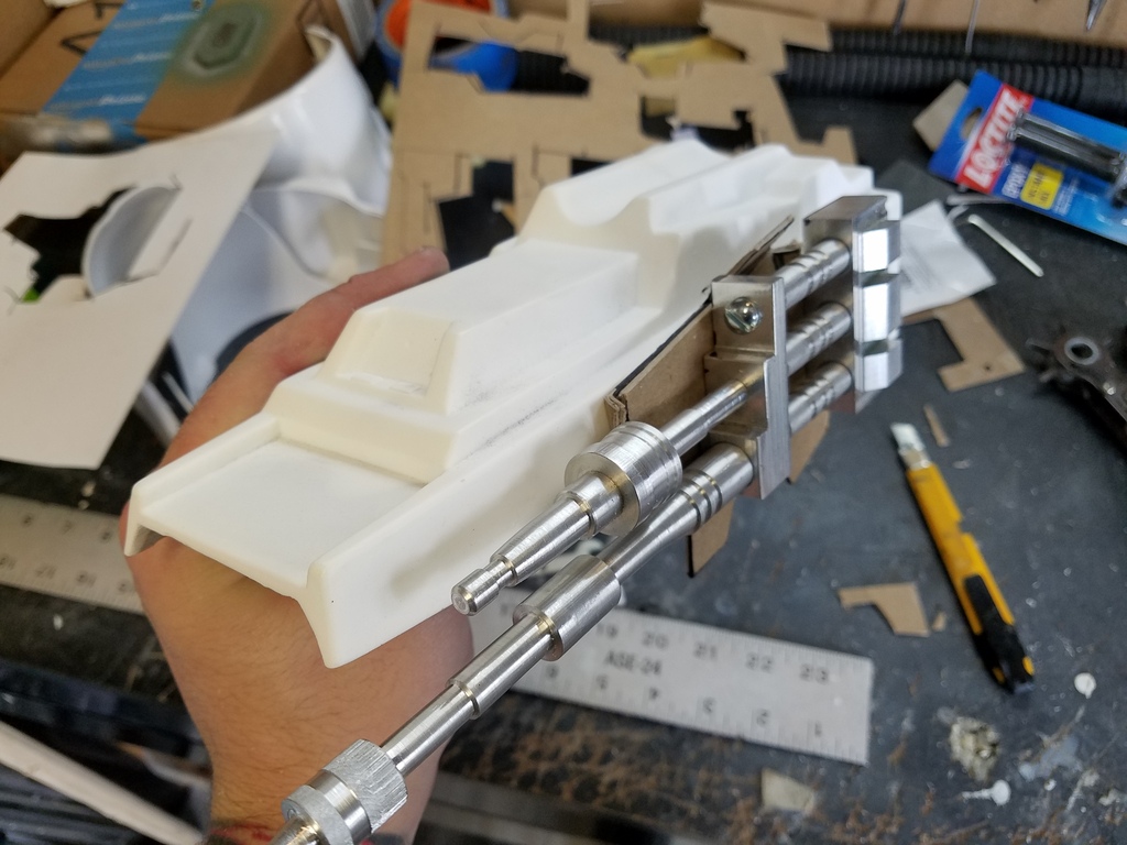

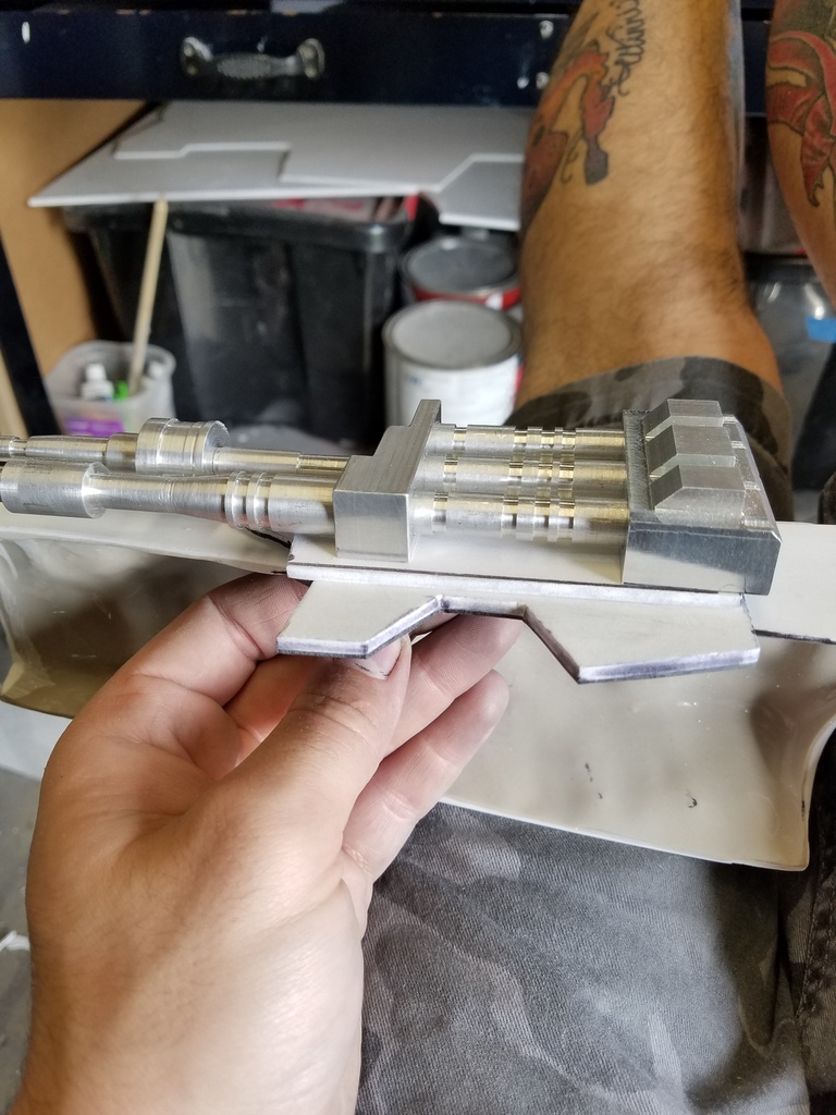

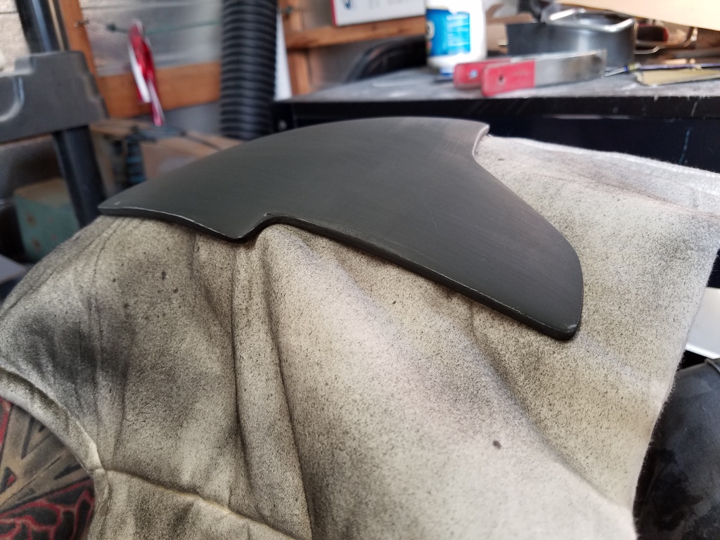

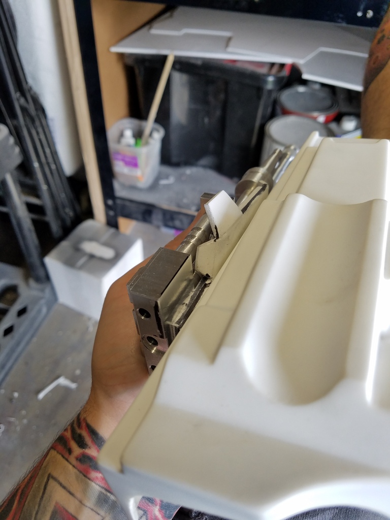

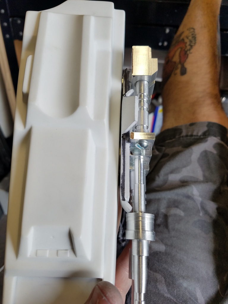

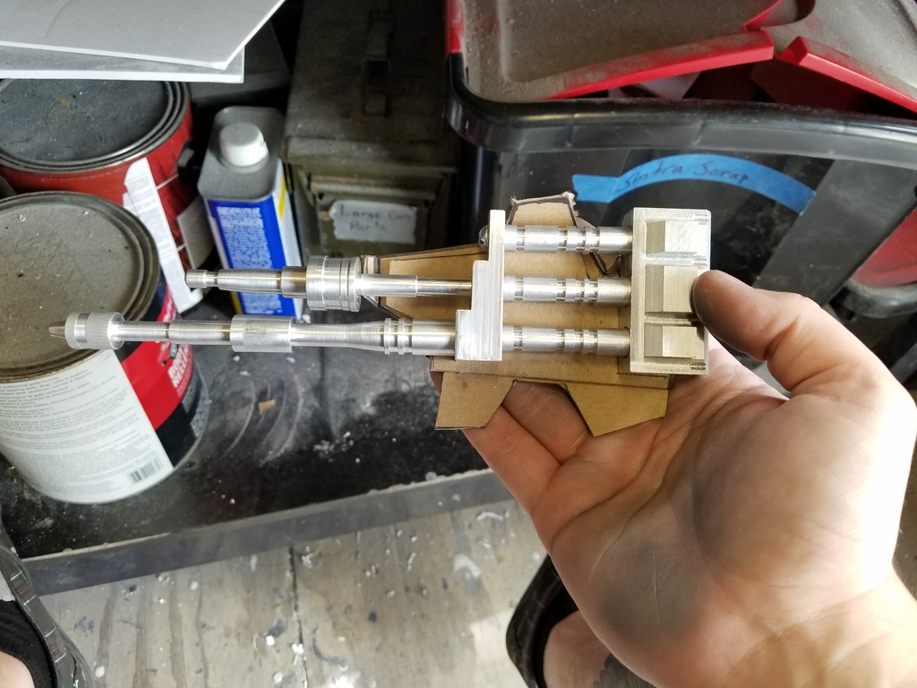

Now onto flamethrower work. I have a combat baby kit, and I love it to death. But I wasn't the biggest fan of the backing plate. I love RKD's backing plate on his kit, so I figured I would draft up and make my own, that way I could have the best of both worlds.
Once I was happy with my cardboard templates, I transferred it all over to 3mm sintra

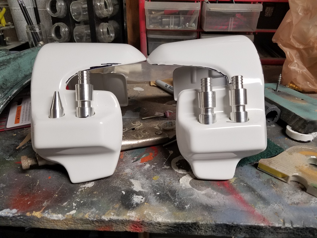

After that was taken care of, I worked on my knees for a bit. Metal darts and knee kit by RKD.

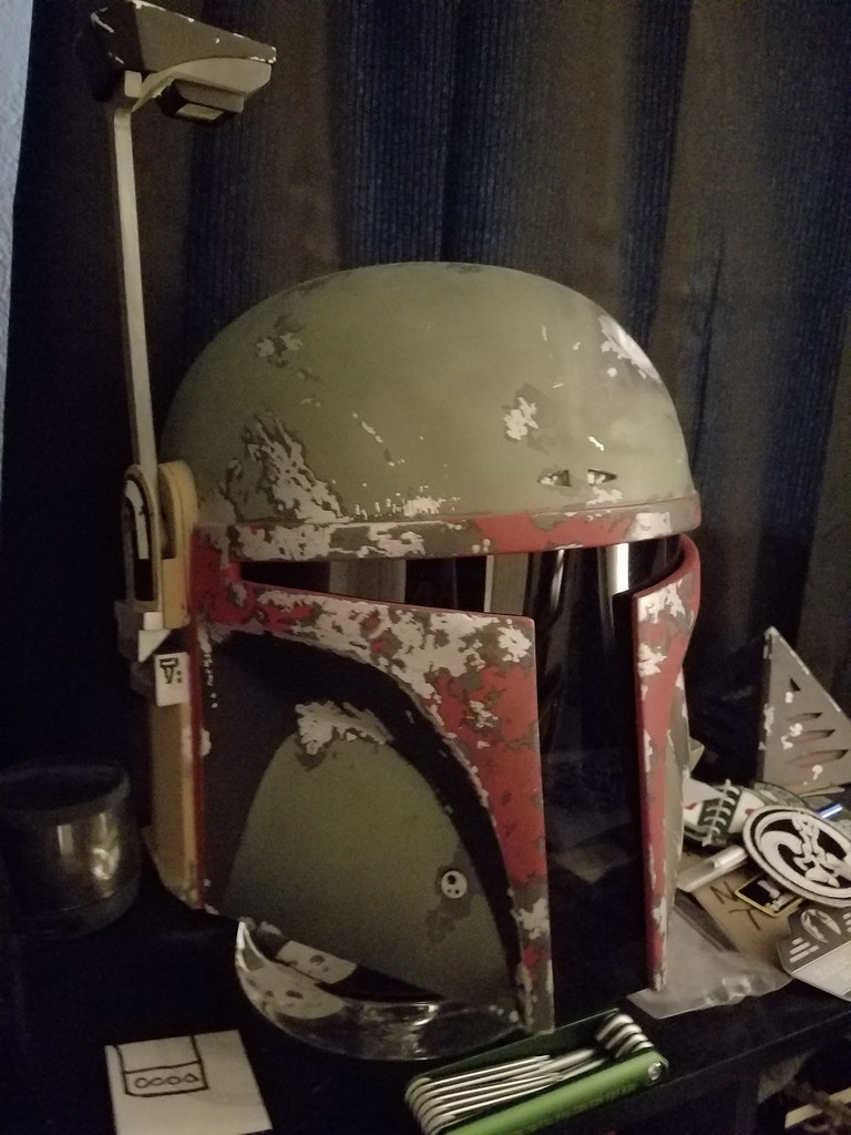

Also. I finished painting the helmet. Still gotta do some touchups on the back panel.
I'll get some better pictures once I touch up the back panel.

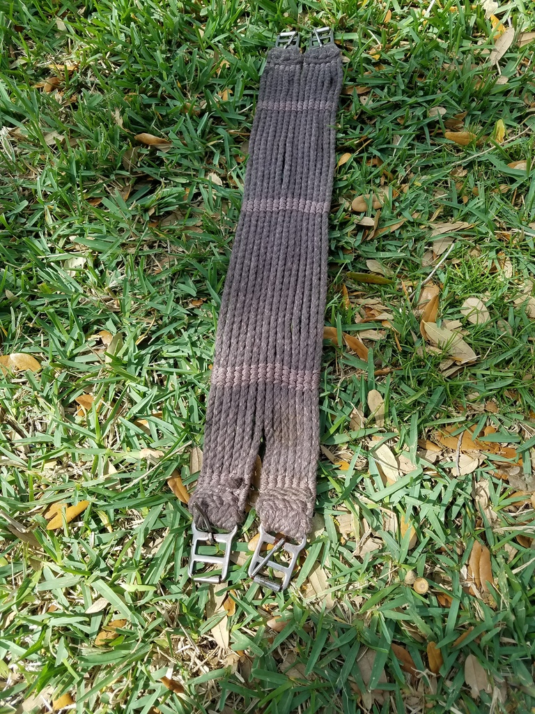

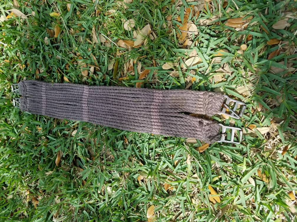

The girth belt I ordered on Amazon came in natural white only, so I dyed it using some minwax woodstain. I wanted a brown, that had some red undertones.

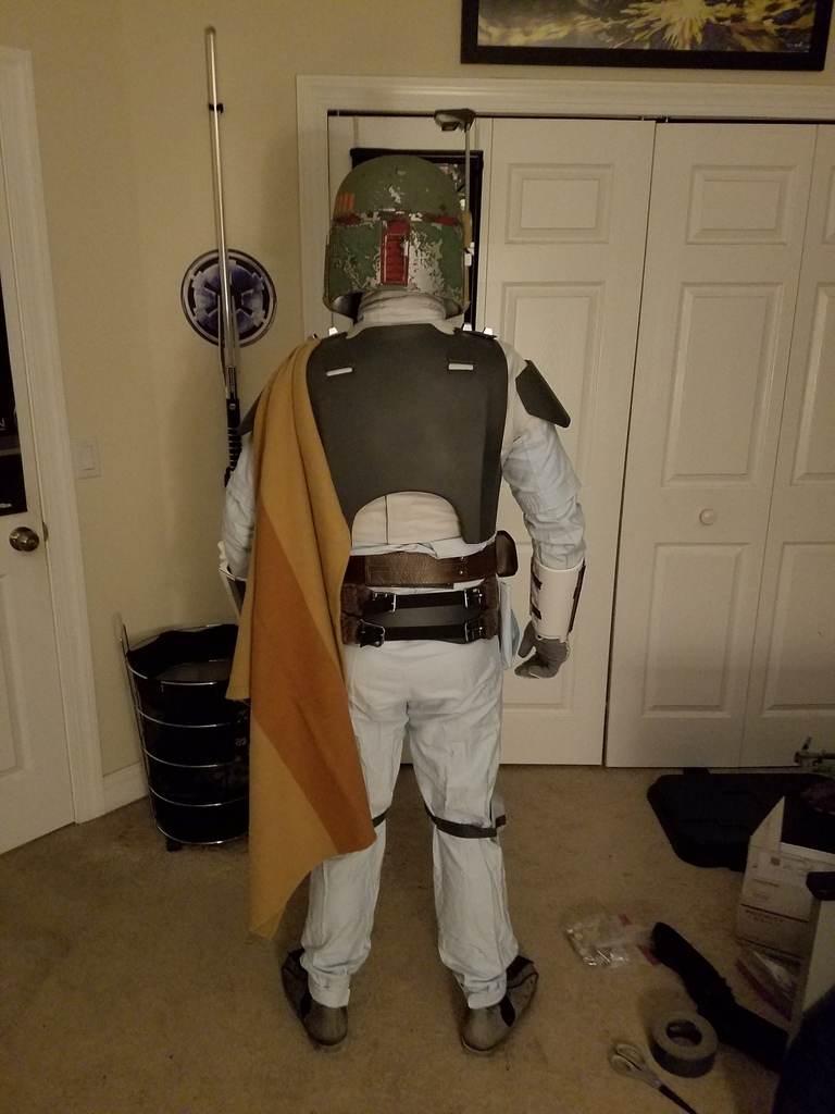

Then soon after that was done, my Arkady order arrived! So of course, I had to do a test fitting.
I'm gonna stitch in a small magnet, and a corresponding metal plate so I can clip my cape in place.

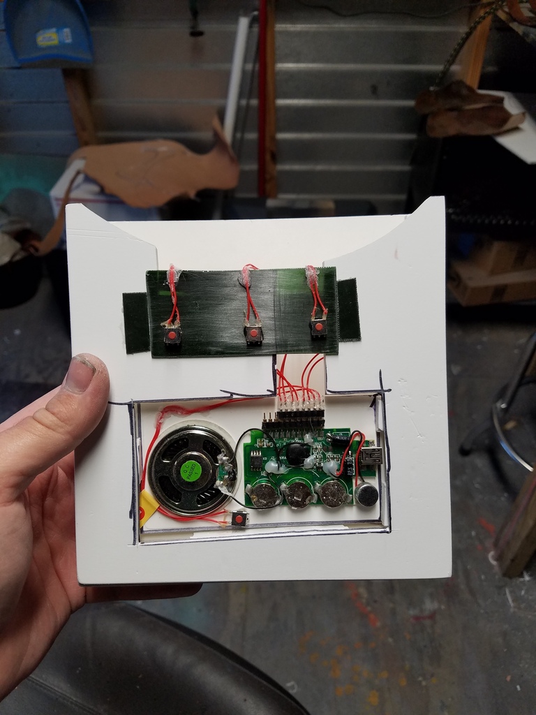

I finished a box instert for the belt pouches that actually has a small sound card in there. I have a sound bit from Twelve Parsec Stare, and some song clips from the Trigun movie soundtrack.
I made sure to make it all removable for battery replacement, or for recording different sounds.
Can't even see the buttons once it's in the pouch.

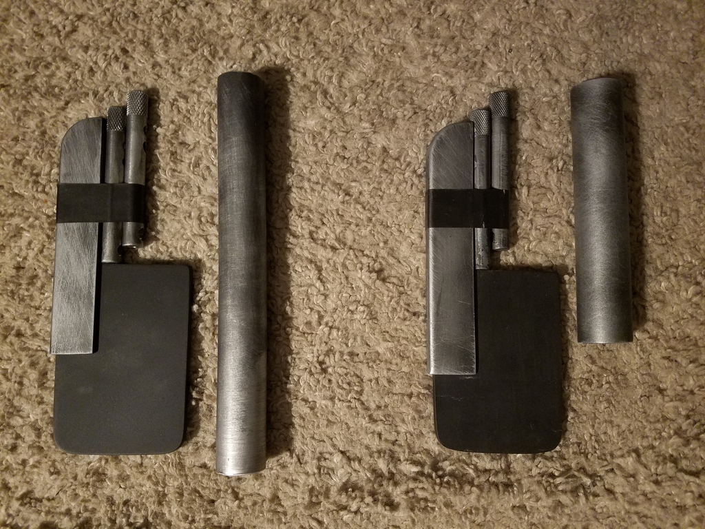

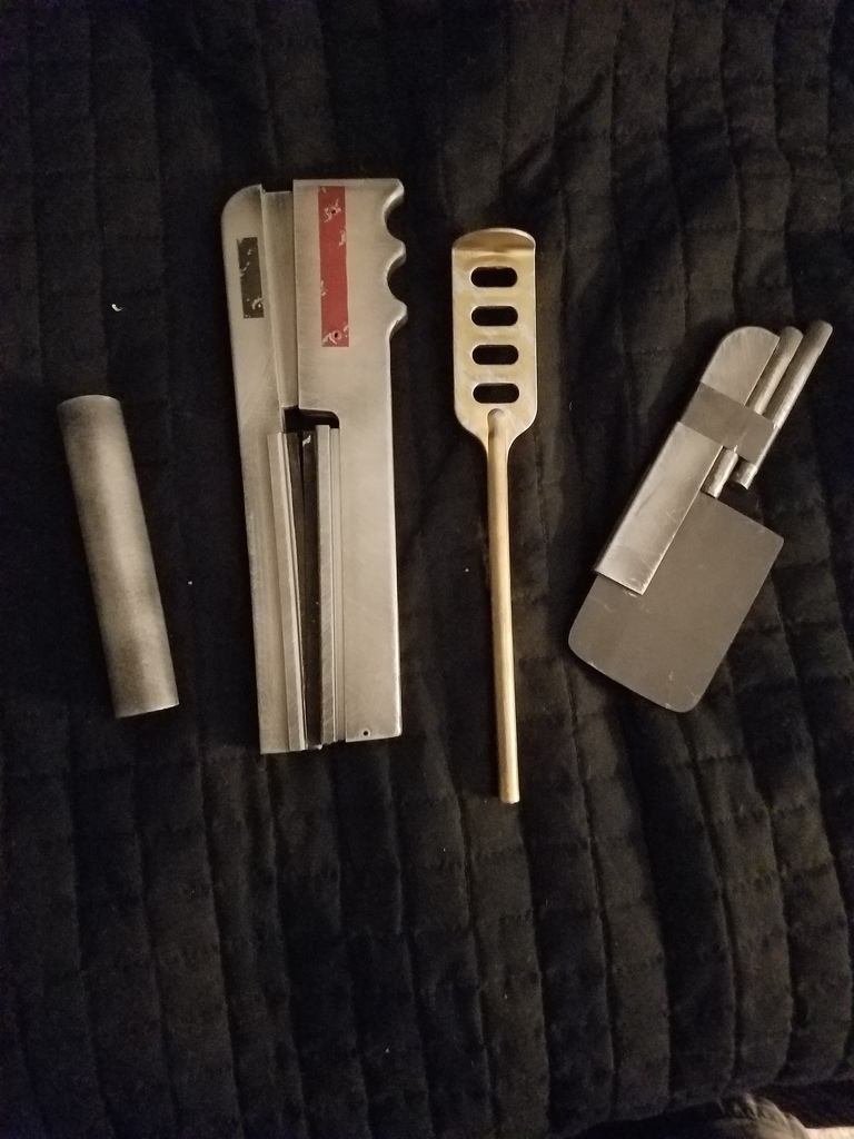

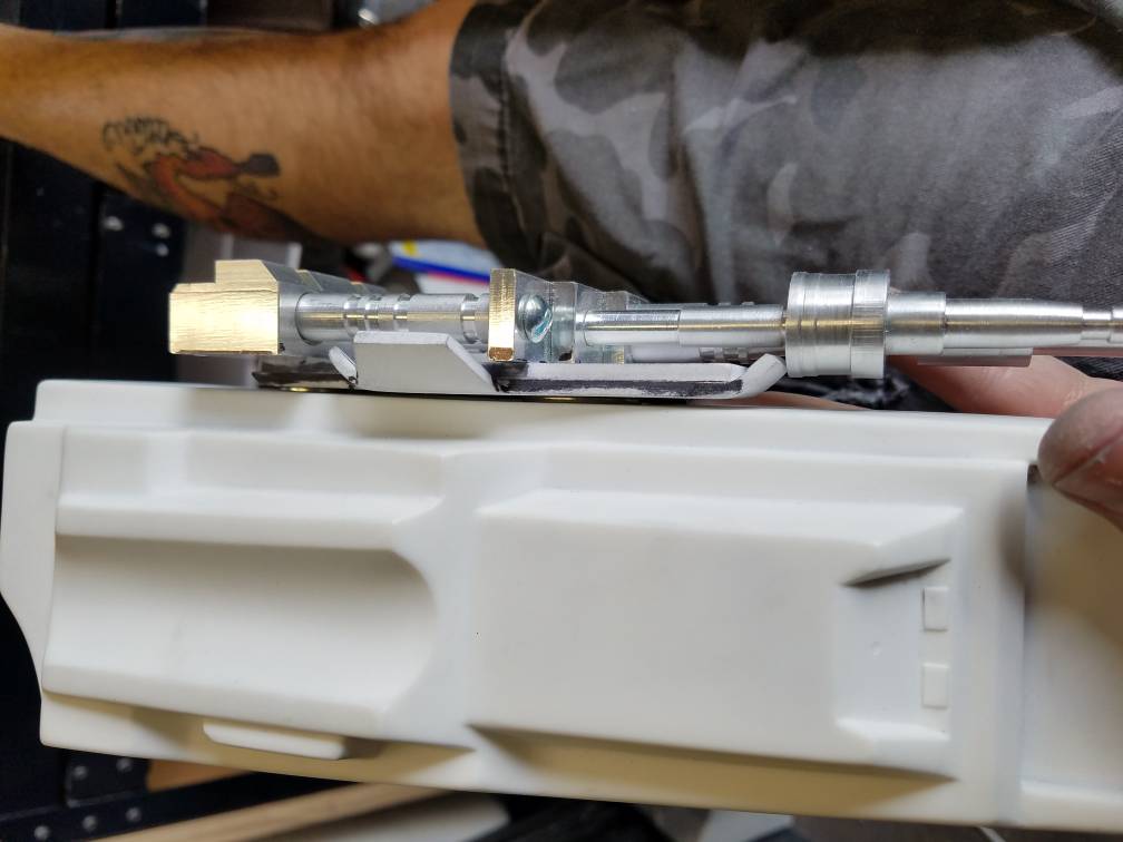

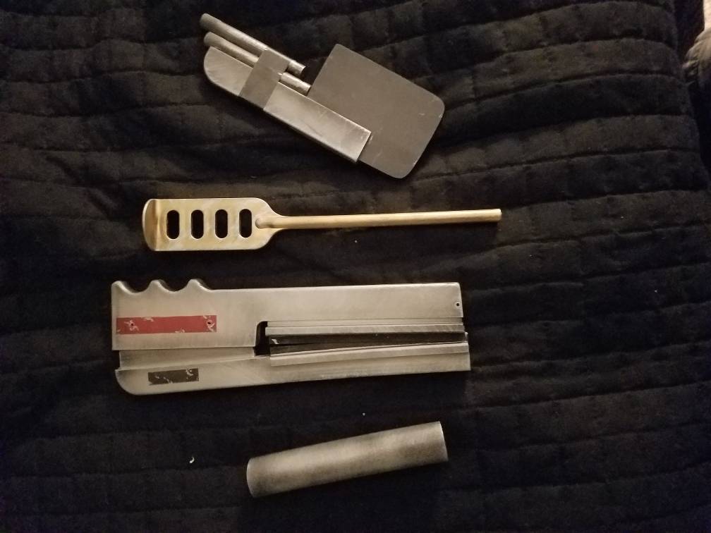

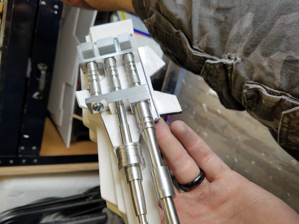

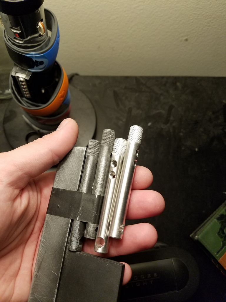

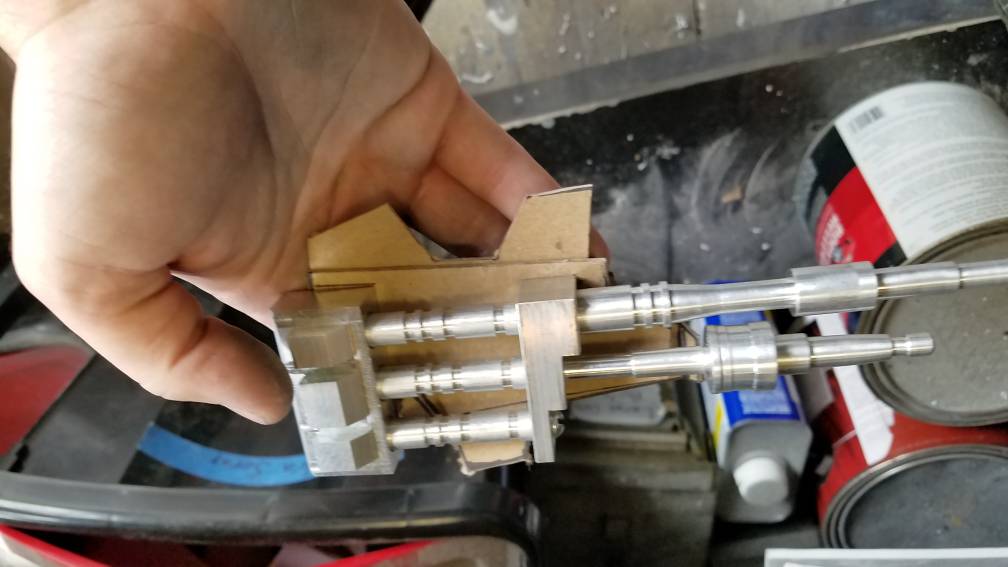

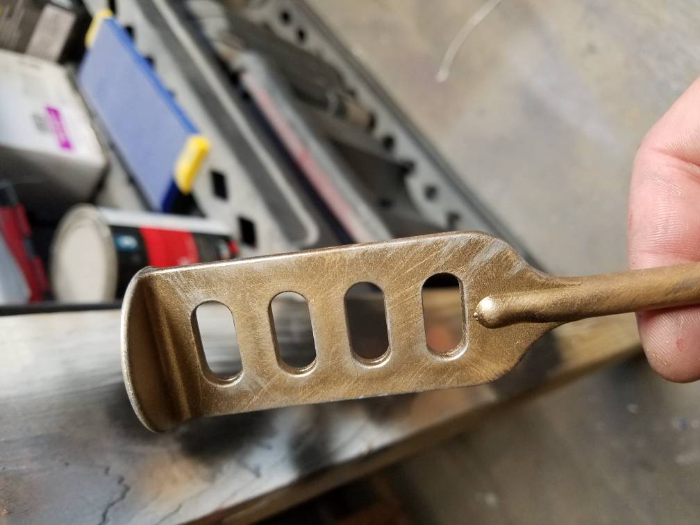

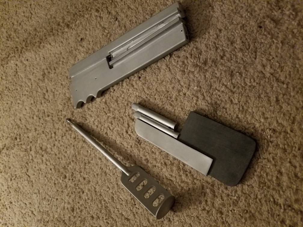

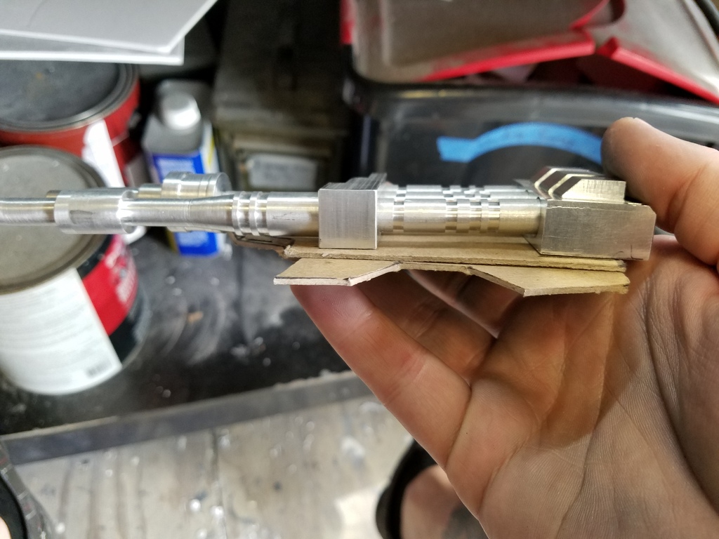

Updates!* So I got my hands on a set of Mojo Fett stylus rods, so obviously I got to work on making my new shin tool
Here it is, all finished up
And a quick comparison between my new tools and my old ones.* The old set is all plastic.* The new set has a metal tube, and the metal stylus rods.

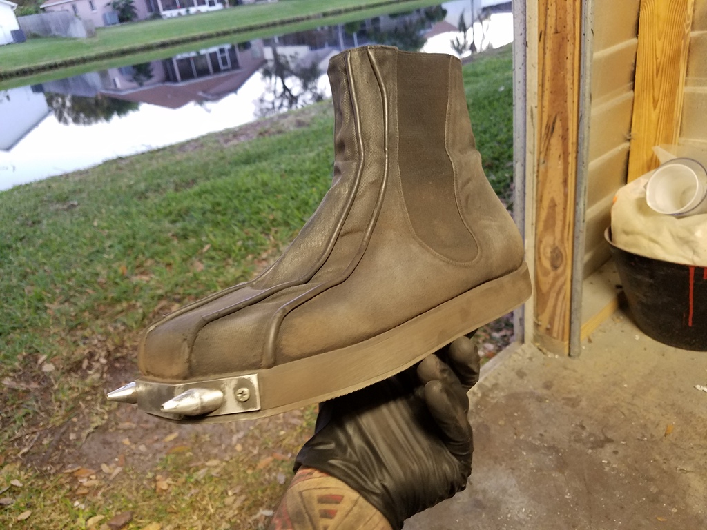

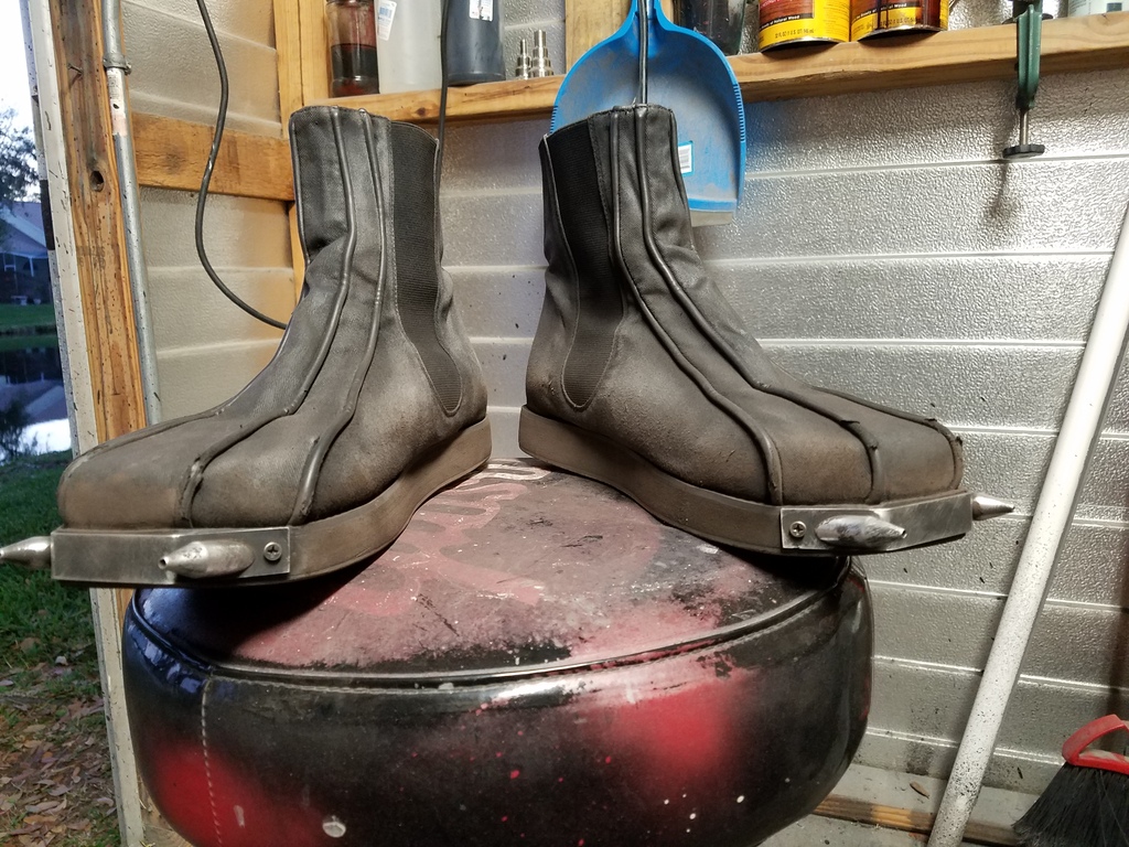

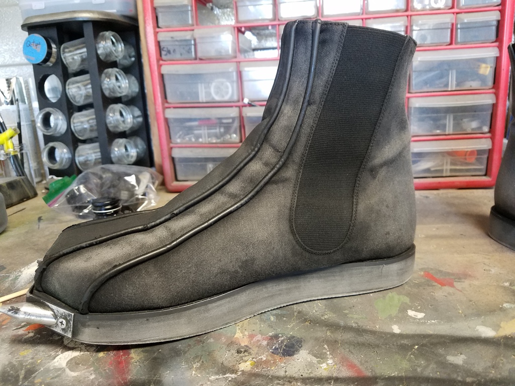

Plus, my toe spikes arrived!

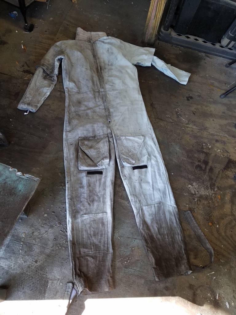

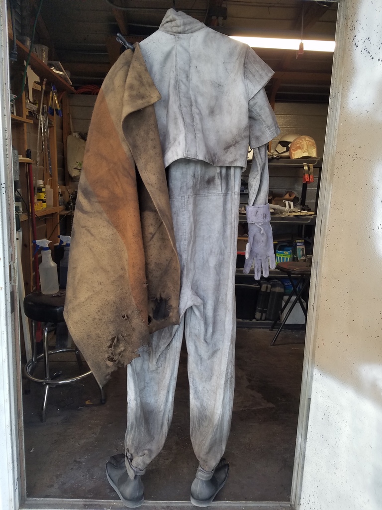

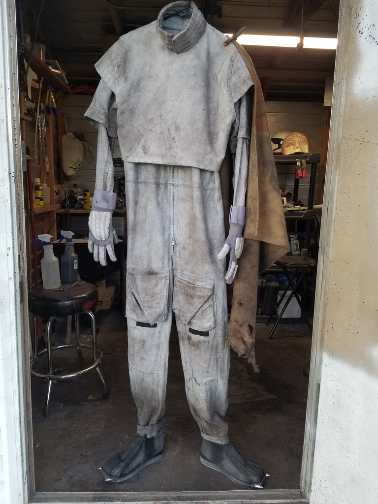

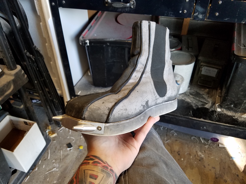

Obviously, my boots needed to be weathered, along with all my other soft goods.* So I Worked on that today!
I've scotchgarded everything to keep my weathering from rubbing off on literally everything I touch.

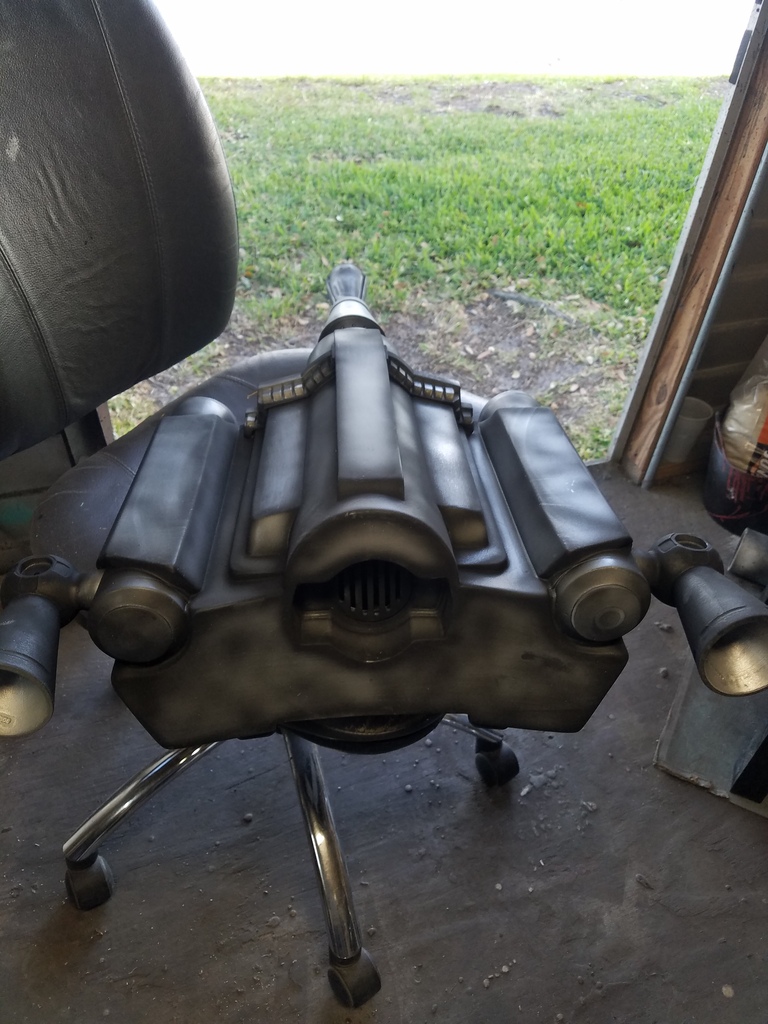

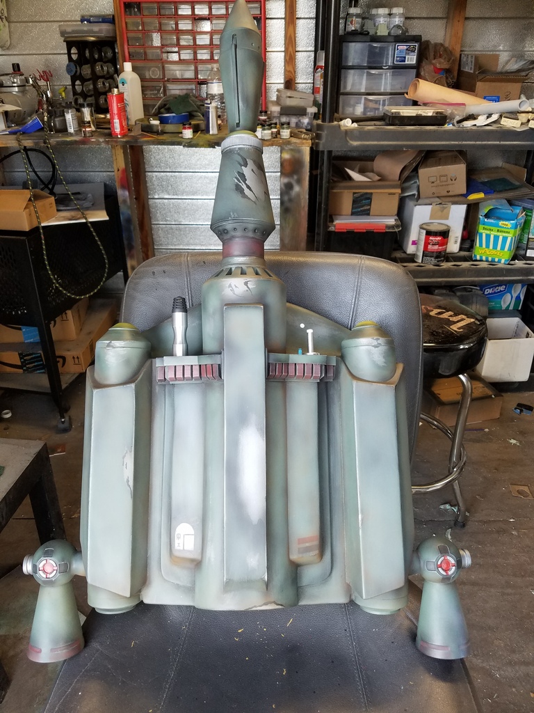

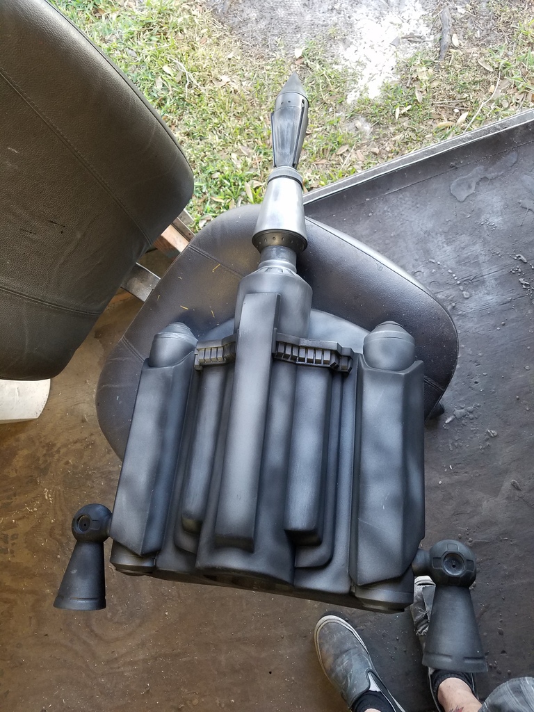

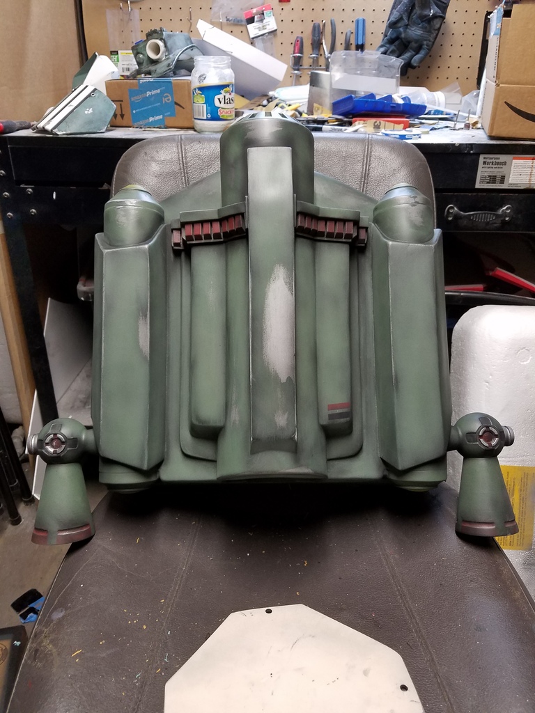

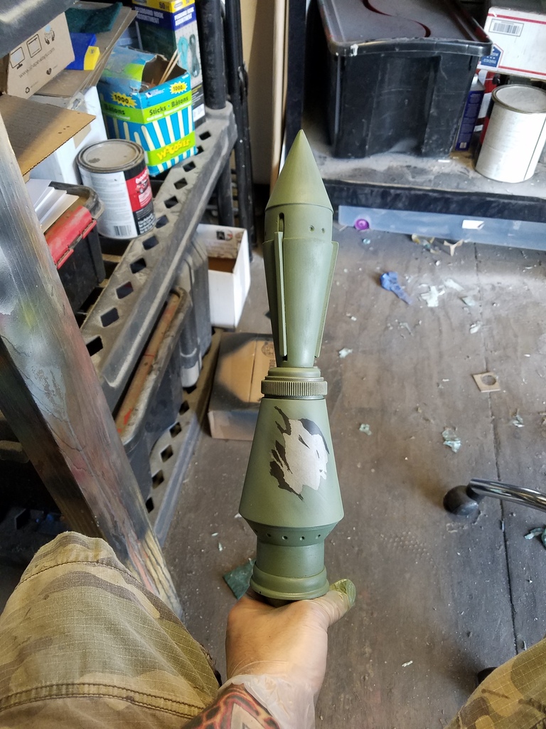

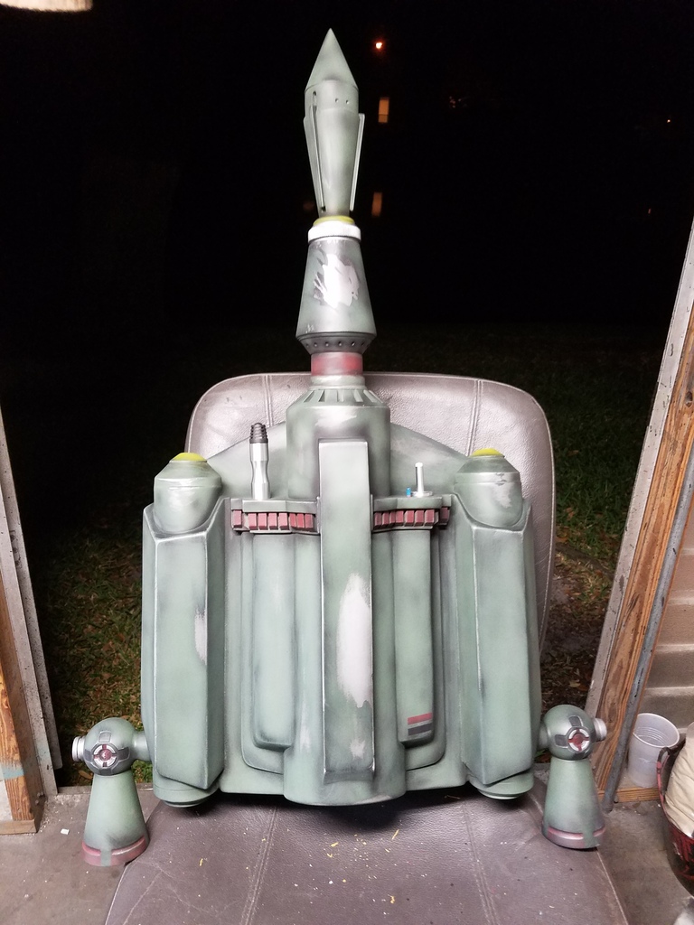

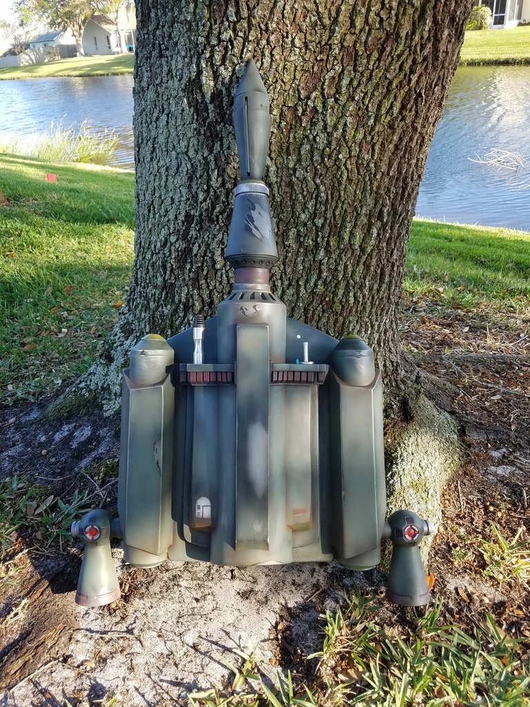

But first, the JETPACK IS DONE (minus some small topical scratches, but I'm waiting for the silver I ordered to come in)
It looks weird, but I put down a scattered layer of black, so I could get some very subtle color variations across the jetpack

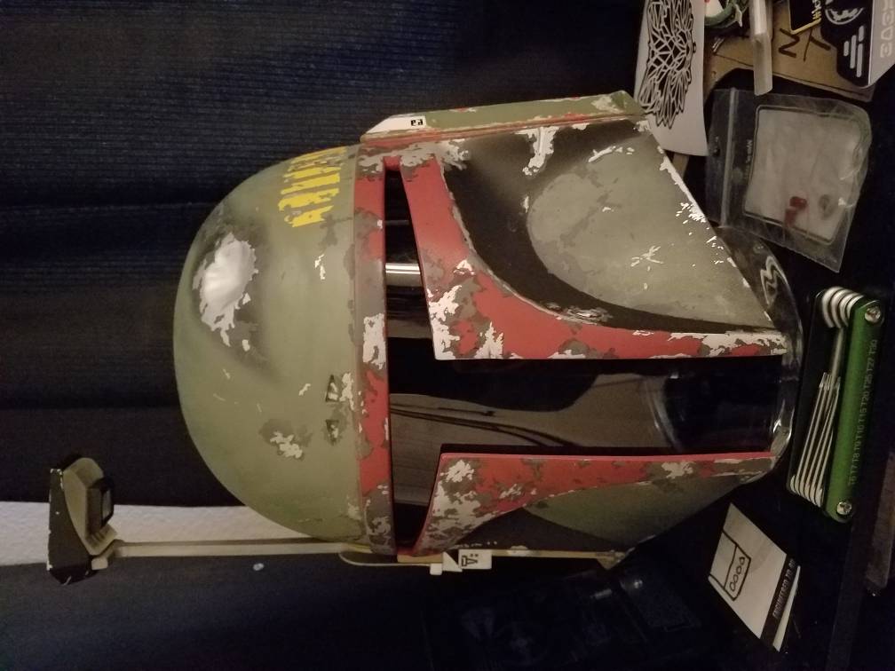

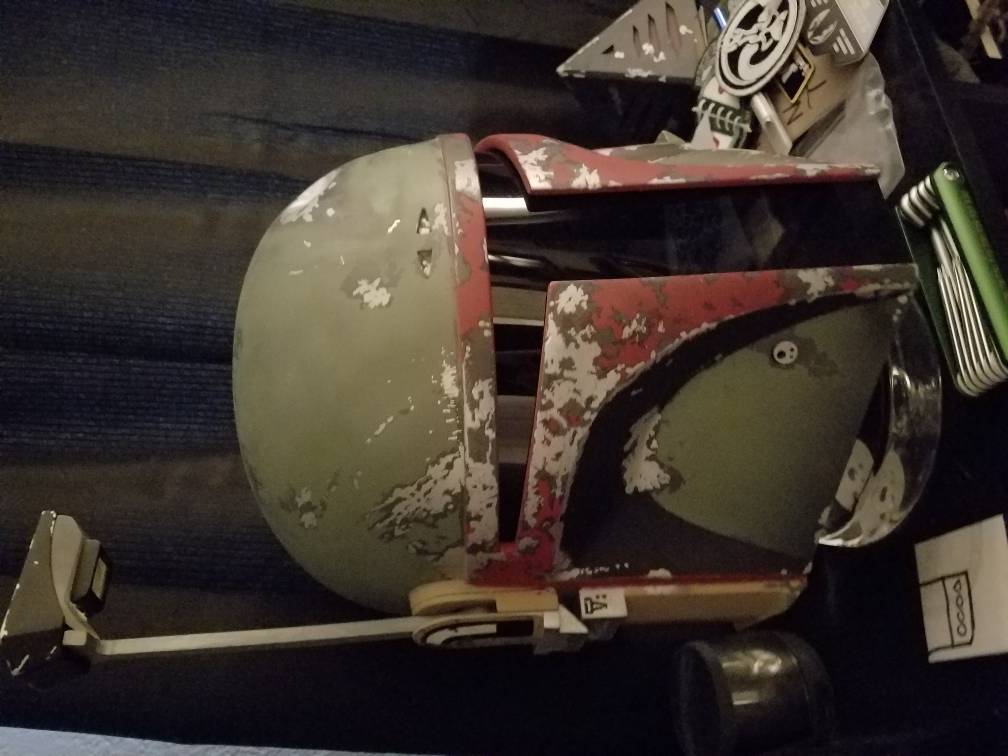

Yesterday my Model Master Grun RLM62 came in, so I got to work on some real paint!
I used scotchbrite abrasive pads to remove the paint and expose some of the silver
After I hand painted the piano keys and misted a bit of black
Today after a nice tip from bcurtis about adding some brown weathering, and adding the white dot and symbol using my DVH stencils.
Definitely super happy with the end result on this paintup. Big thanks to fettastic for his killer paintup thread and MLS for all the guidance.
