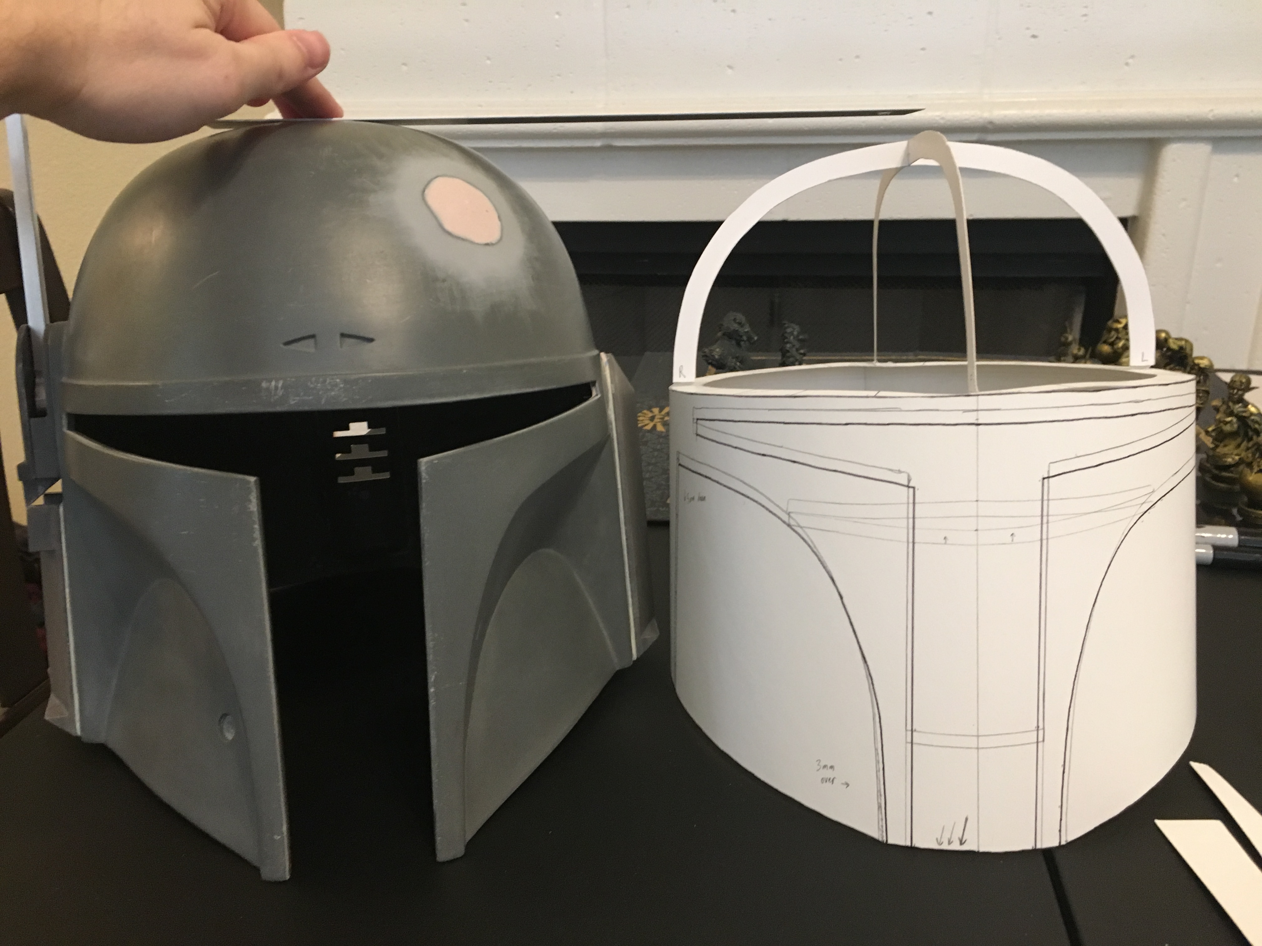

Just to give a general idea of the slight size difference with the templates wrapped around to preview the shape. The gray helmet cast on the left was made by ToEleven who made his Boba bucket using the RWH files to their full size.
From what I recall the RWH templates used in full might be somewhat close in size to the GMH albeit perhaps a tad wider. So my intention with this build was to go a little smaller than the GMH.

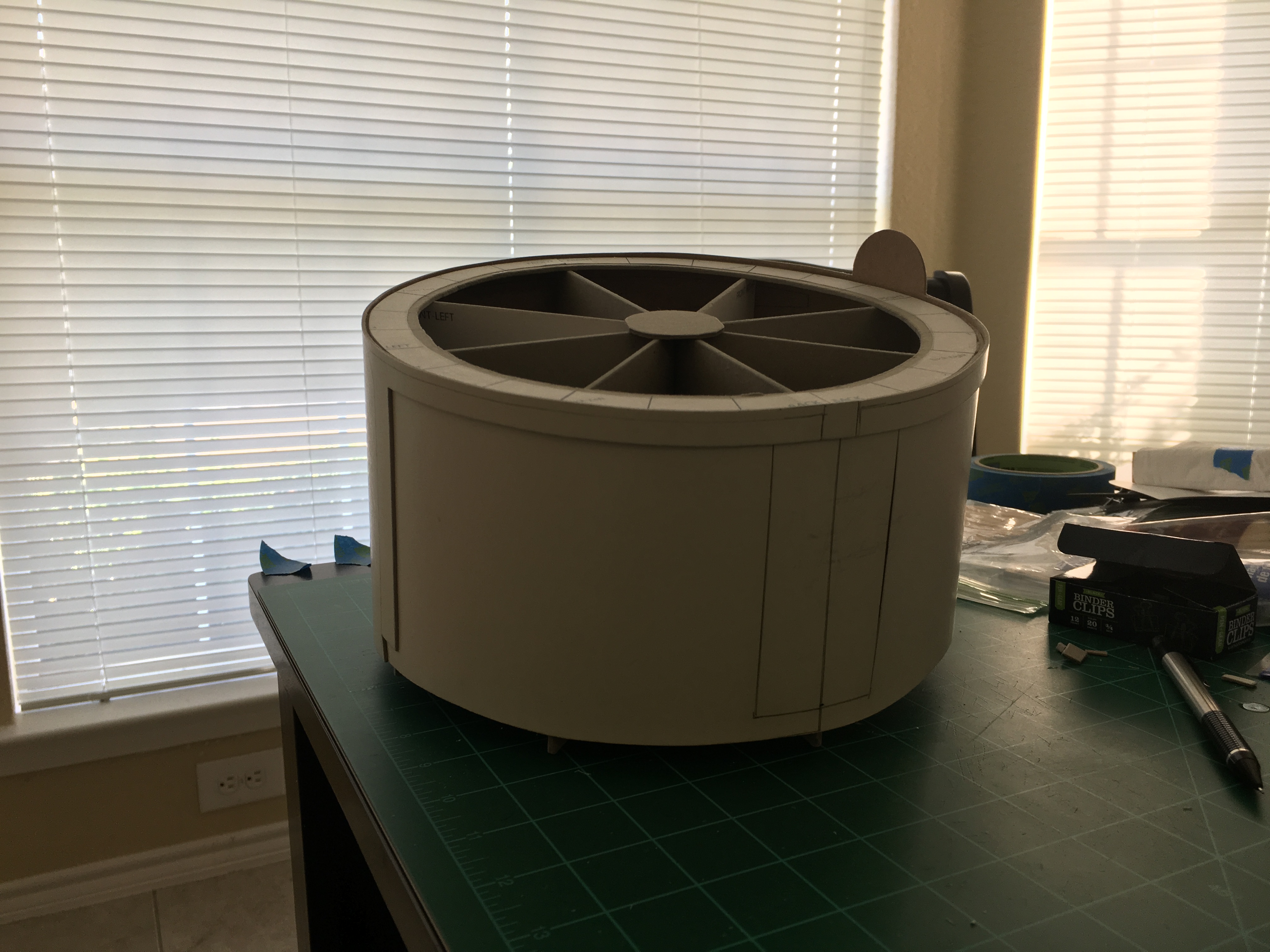

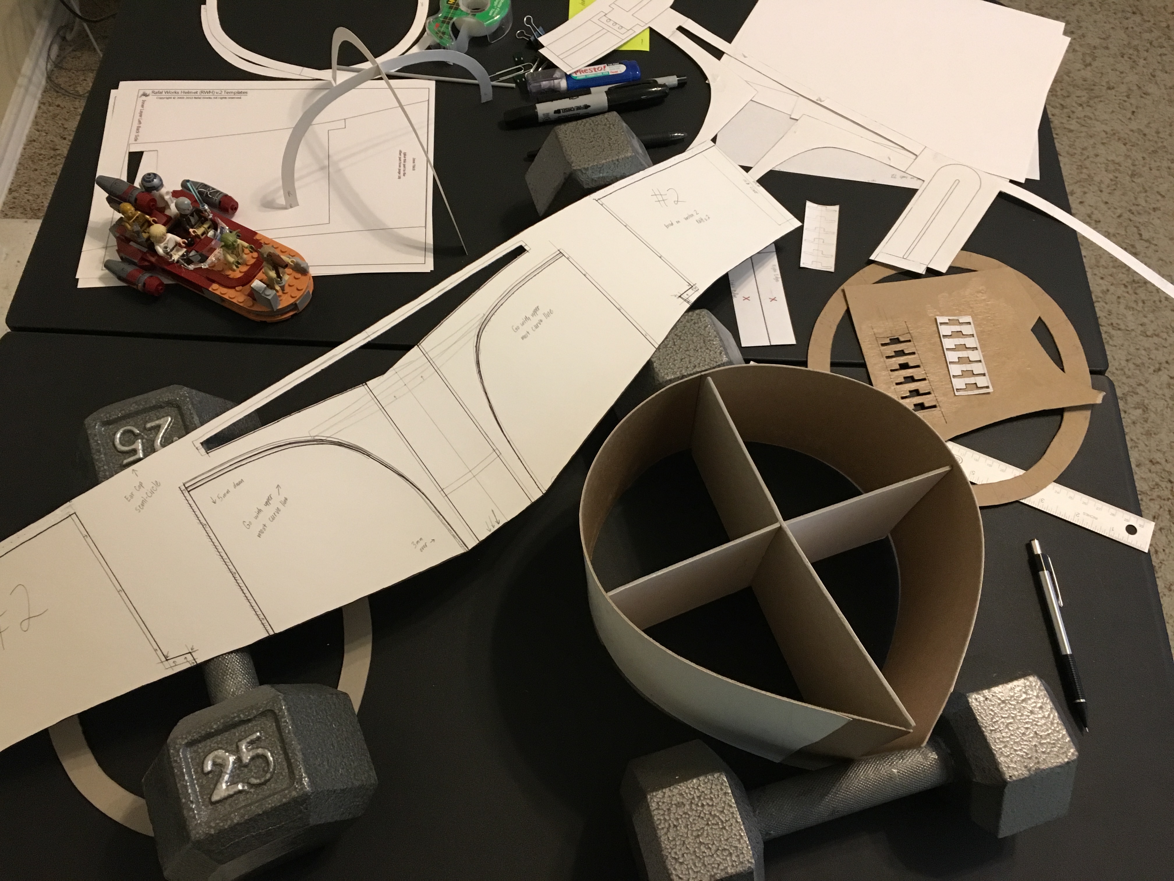

So after assembling the supports in place along with the trimmed off dome ring, it was time to wrap the inner layer around the "wheel" support structure. Since I was using 1mm matte board as my template layer with poster board glued to it, I actually wrapped the whole layer around in increments. Part of the reason why I didn't wrap everything around all at once was to avoid creating creases in my build around the supports. I didn't picture it at the time, but I used hex dumbbells with a sheet of foam in between points of contact to brace the build in a diagonal fashion as I glued each portion a section at a time, adjusting as needed. Slow and steady and all that. In the end, it worked out pretty well! The support along the bottom of the chin stuck out further than I would've liked, but nothing too bad. I had also done a light bit of pre-cutting along where the keyslot portion will go in the back before wrapping it around.
Next, I had the outer layer mandibles prepped in a similar fashion using 1mm matte board with poster board atop it and had all my markings in place. I did start a little pre-cutting along the T-visor areas as well as the cheeks with about a half inch left connected at the bottom to help keep the overall shape intact while it was wrapped around the inner layer (as shown).
The supports and dome ring were cut out of 2mm matte board to give it more structual rigidity.

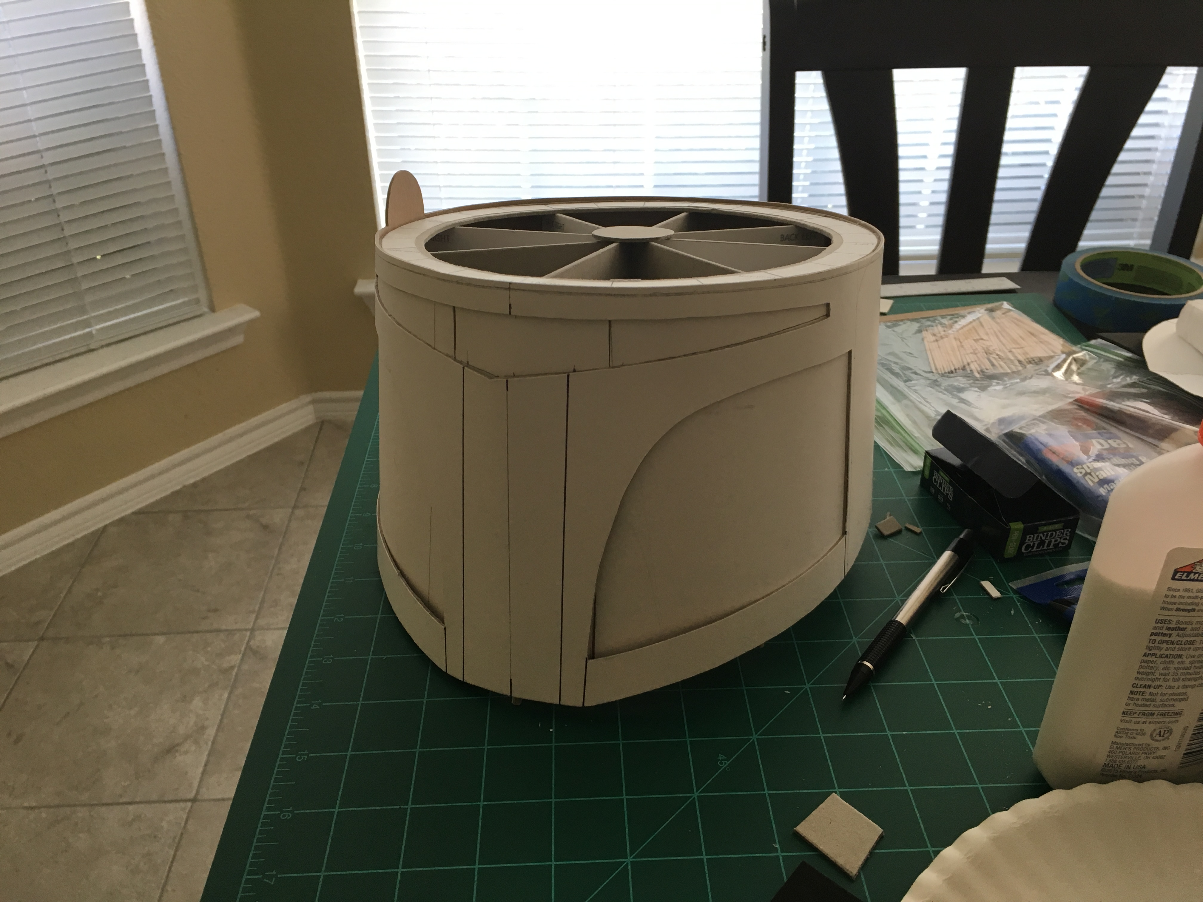

The mandibles were wrapped around the inner layer in a similar fashion in single increments using hex dumbbells and foam sheets, as well as a couple of 8-inch wooden supports about half an inch wide in between small clamps along where the mandibles connected. Again, it was all slow going, but it, too, went on fairly well with no creases. I only had to fill in a small portion to connect the rear band. All in all, it also went on fairly well and the placement of the ear sections was about how I liked it!
