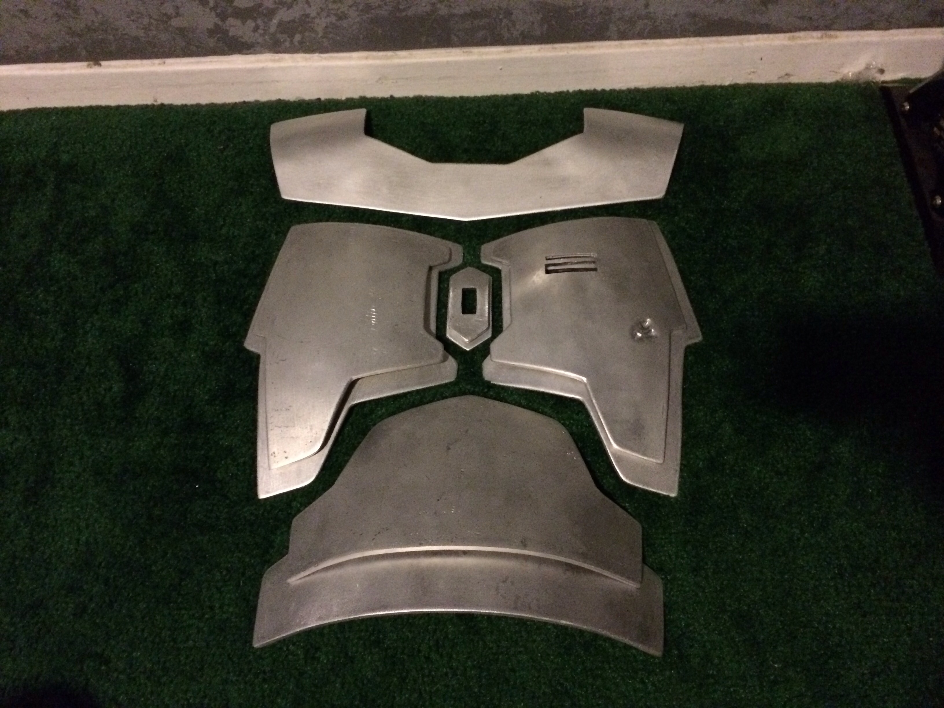

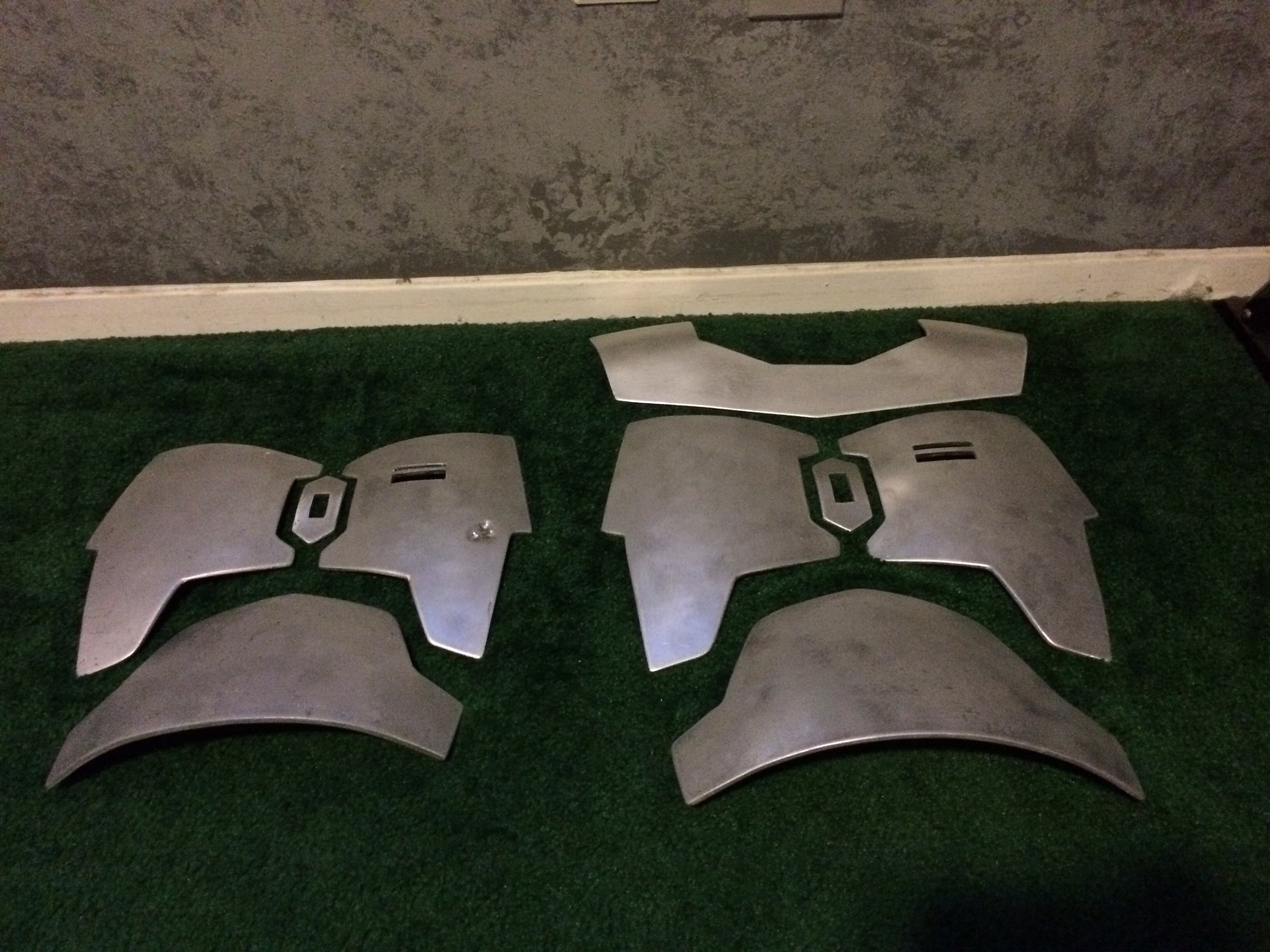

Costume build from start to finish using cyberpyrots cold forged solid aluminum armor
It looks pretty much perfect from pictures and accuracy wise. I work with 6061 at work so was just curious about the difference in working the 5057.
Sent from my SM-G925V
oops i meant 5052
5052 Aluminum
5052 is the alloy most suited to forming operations, with good workability and higher strength than that of the 1100 or 3003 alloys that are commercially available.5052 is not heat-treatable, but is stronger than most of the 5xxx series of alloys. It has very good corrosion resistance, and can be easily welded. 5052 is not a good choice for extensive machining operations, as it has only a fair machinability rating.
Thats good to know. After seeing these I was thinking about taking a crack at it myself rather than the usual abs. Looks really good for sure. Definitely appealing as far as paint wise.
let me know if you need help or pointers.. Once you have your own set and feel the thickness you will get satisfaction that you have created something truly awesome. Good luck you can do it. don't give up if you get into a pinch let me know..
Oh and don't use 6061 you will be beating on it for days it is really hard.

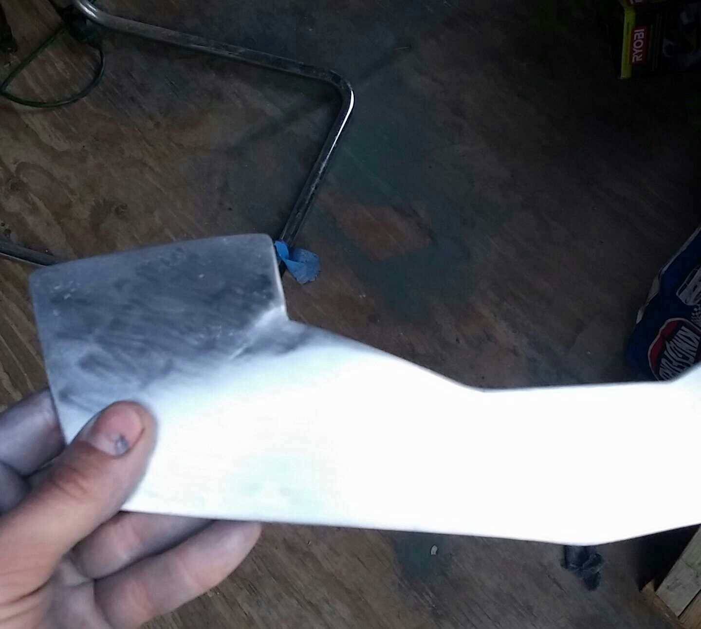

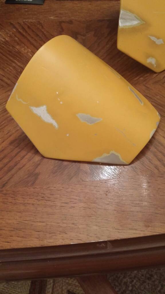

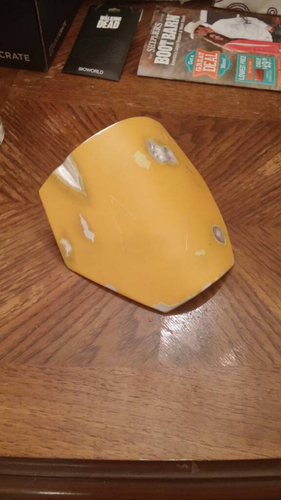

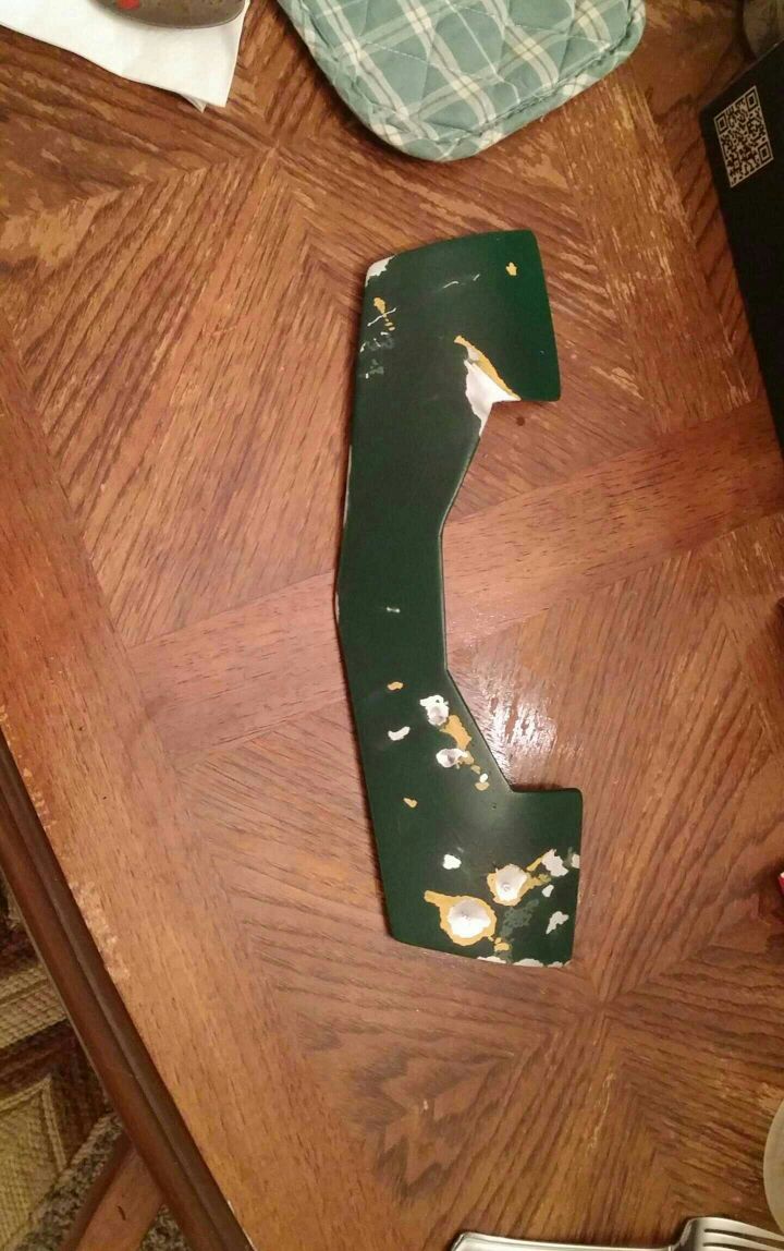

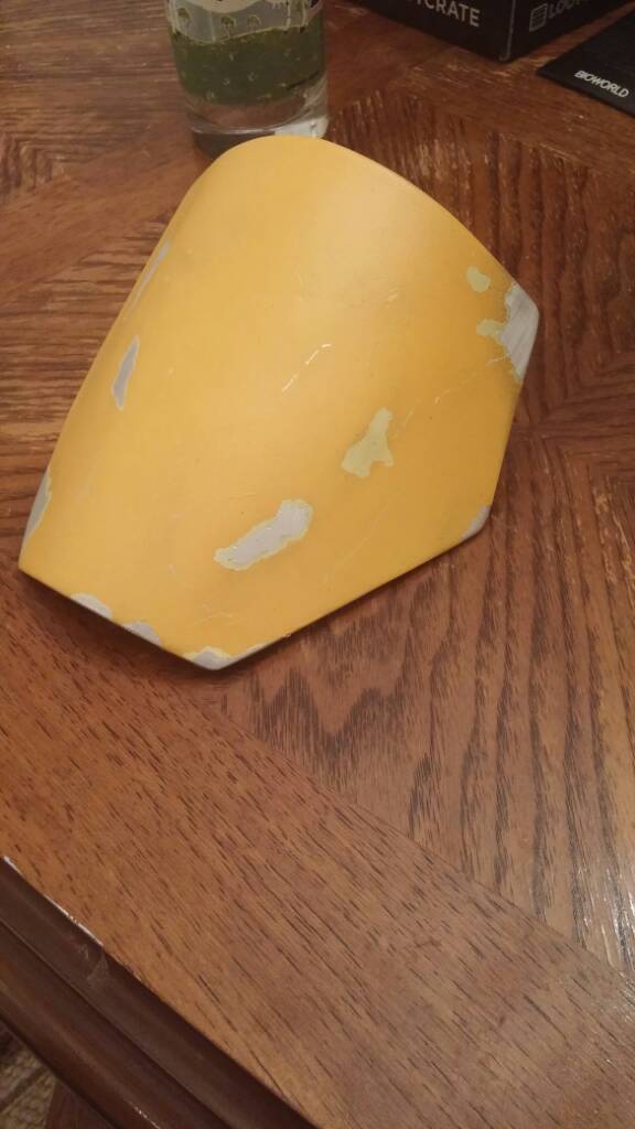

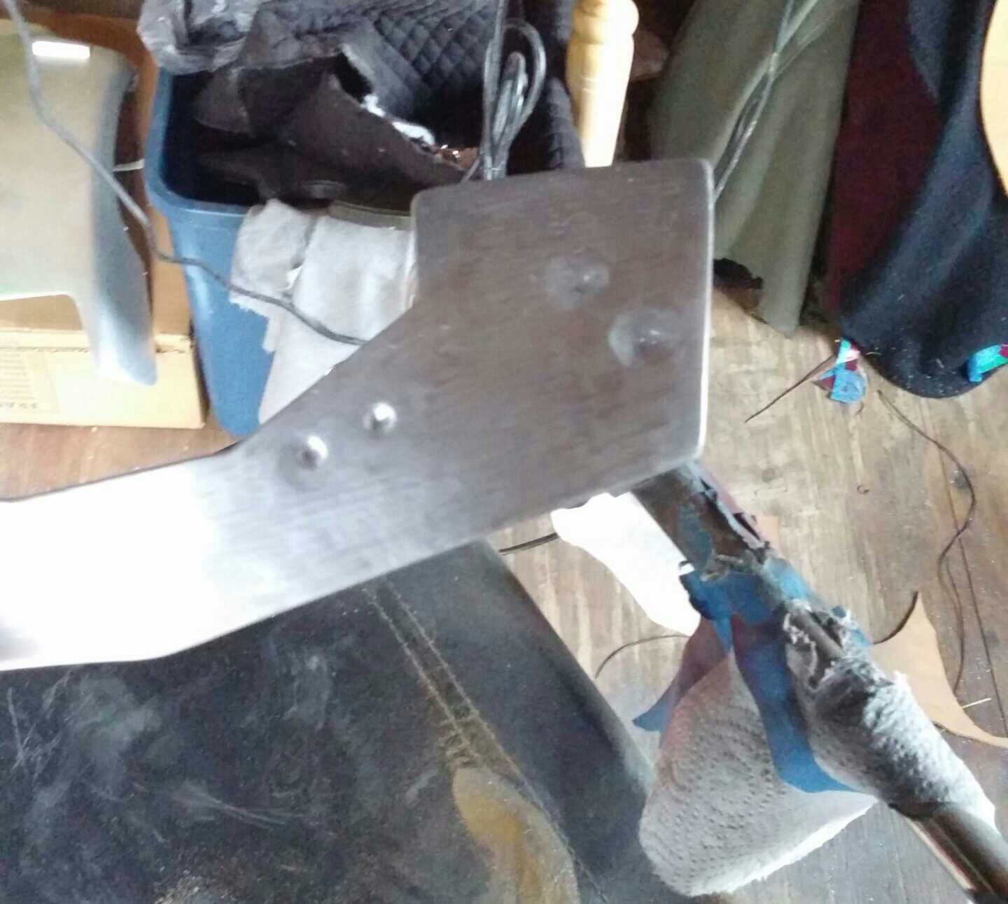

Finished the center emblem today.
Got to work drilling and dremmeling on cyberpyrots collar piece today
adding all the dents and whatnot
I cant wait to see how the cod and knees turn out. This thread is making it pretty hard to wait to see the finished product.

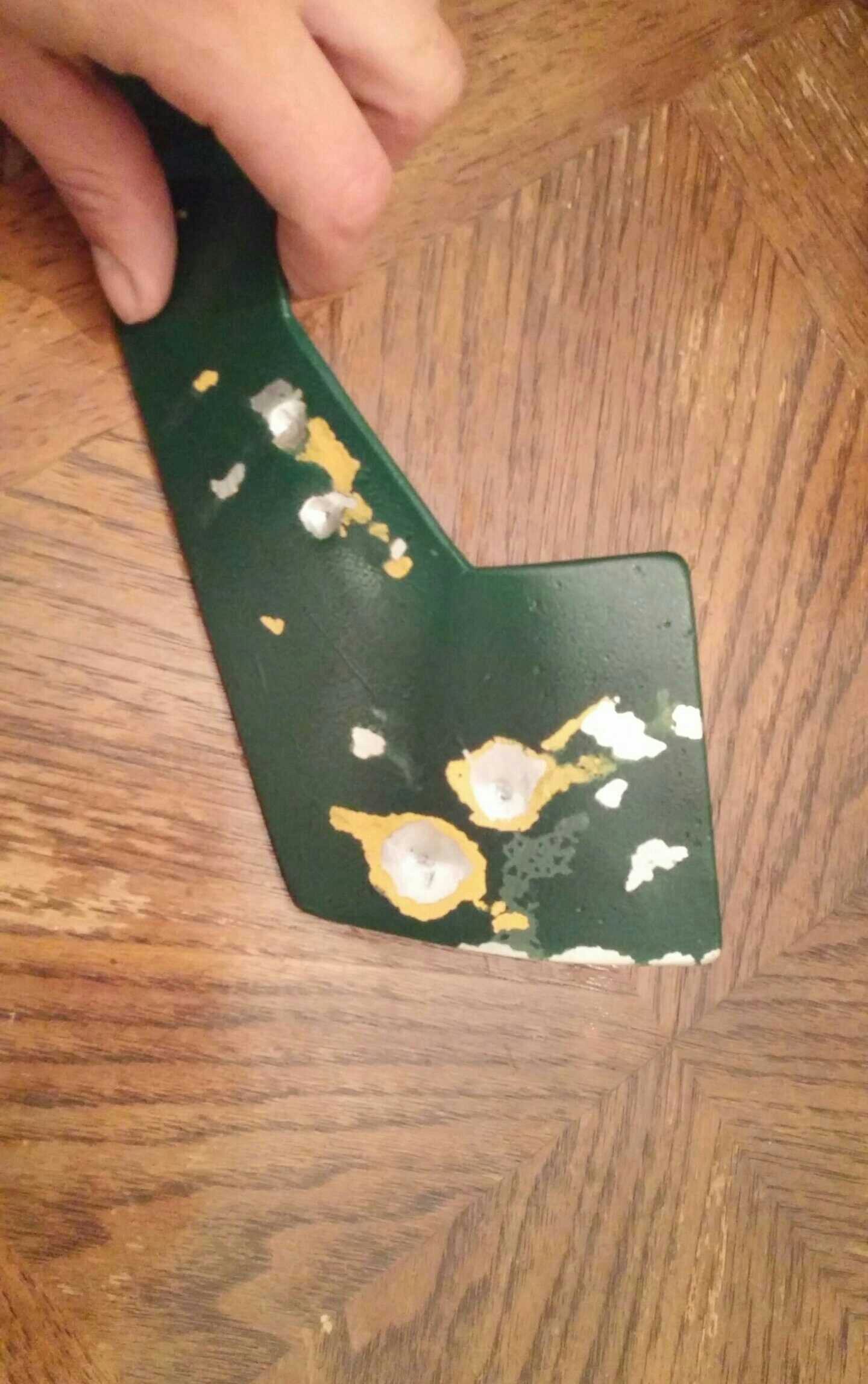

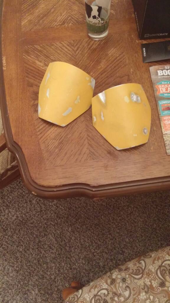

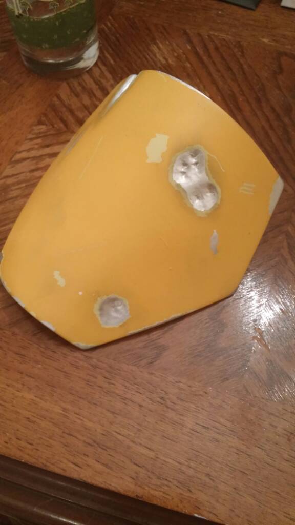

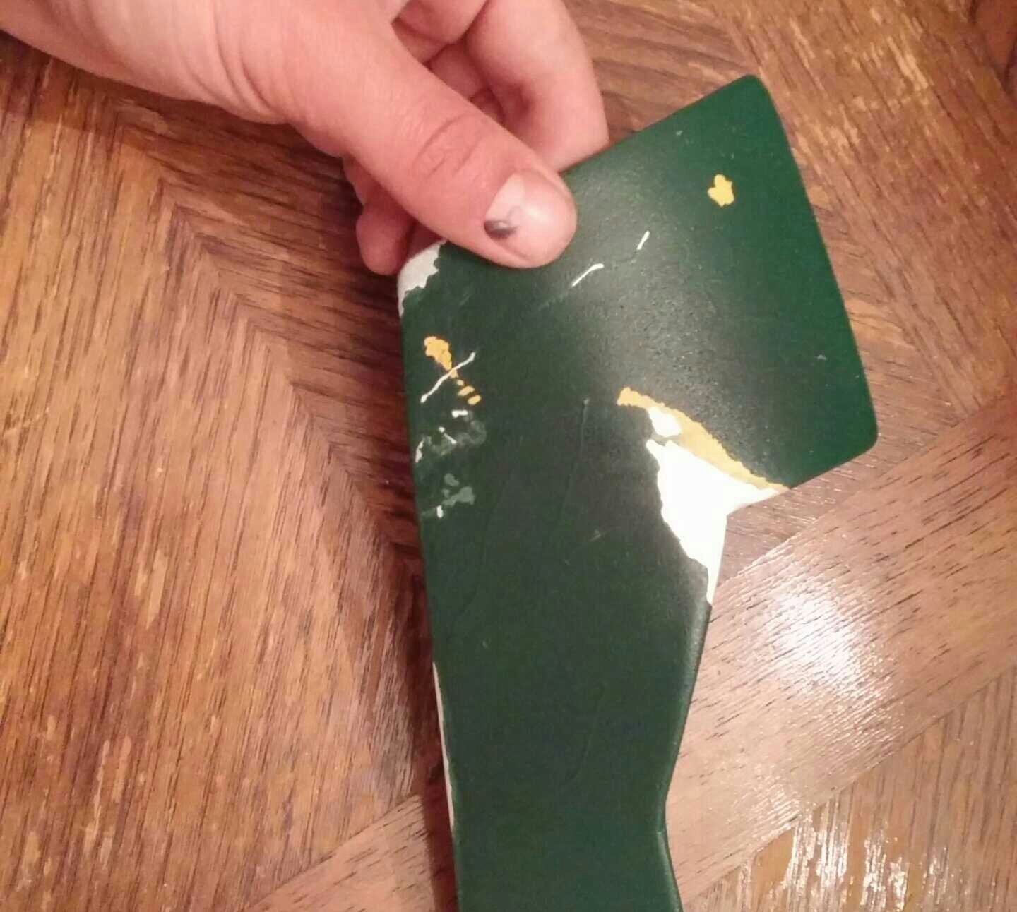

Thanks drax I'm getting started tomorrow adding damage and paint to the chest pieces I'll keep y'all posted! Ooh and cyberpyrot is starting on the cod piece as well.
