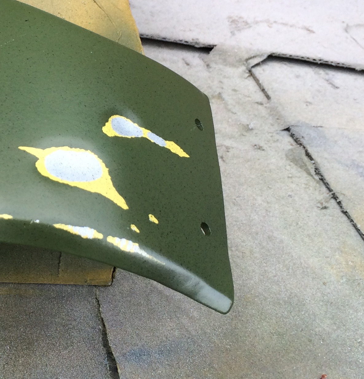

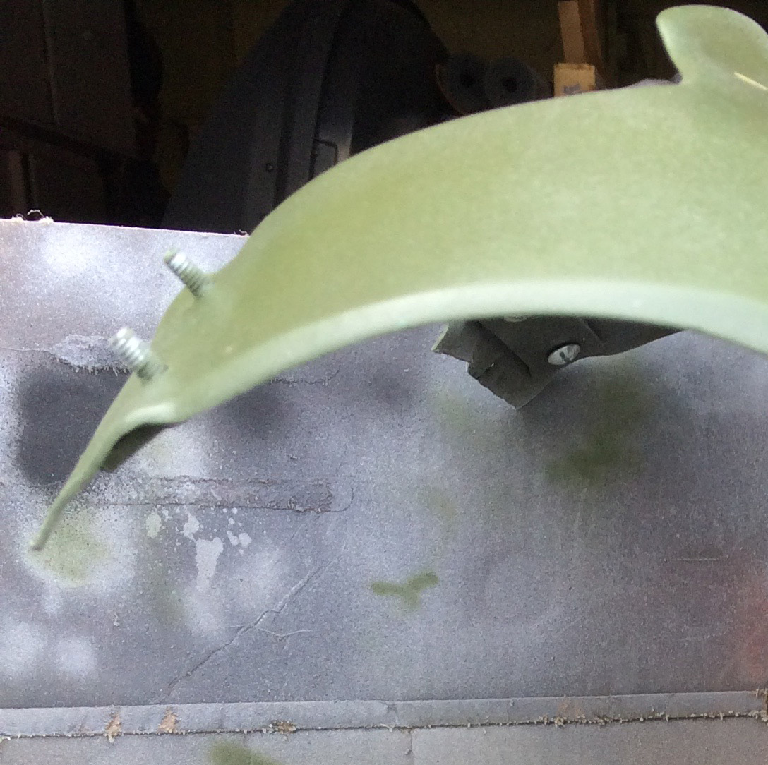

The back armor should have two studs/bolts extending upwards around the top shoulder area , both left and right.
The collar/neck peice has holes which the these back studs enter through (from below).
The aluminum keys then thread onto the studs, and lock it all together.
IDK if you could tell from L3's response, but there's overlap -- bolts from the back through holes in the collar:

Knowing there is overlap is a huge help. You can't really see an overlap in why pictures. Thank you for the pics. Do you know if anyone sells the studs that go on to the top of the shoulder?
