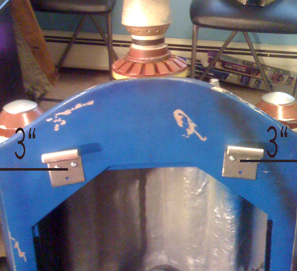

On my pack I have the hooks set 3 inches in from the outside of the pack.

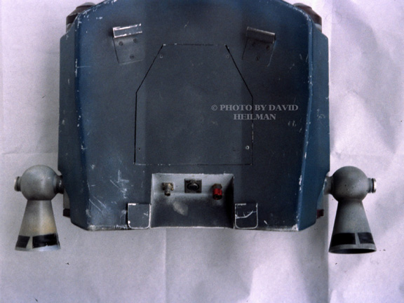

Yeah the 'ctrs' of the hooks seem to be around 3" in from the back plate edge and placed turned outward as seen in the pic.
For the hooks, it will depend on your backplate. I had my backplate on a mannequin and put some duct tape on each hook where it would attach to the jet pack.
Then I held the jet pack so it was centered on the backplate with the top of the backplate of the jet pack (the blue curved area that would actually contact the back) just about an inch to an inch and a half below the top of the neck on the backplate per reference photos. Then I placed the hooks themselves so the tops were parallel to the backplate slots and about a half inch to 1 inch below them. That way, when the rectangle rings are attached, there is just the right amount of sag. The duct tape will hold them in place once you get them in the right position, then I drilled my holes right through the holes in the hooks. Used a piece of flashing with the same holes as a backplate inside and #8 bolts, nuts, and washers to hold it all on.

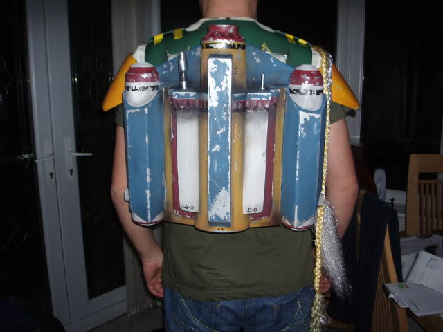

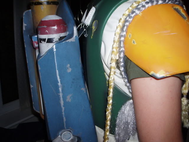

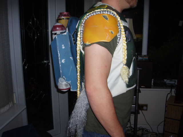

I have now adjusted the straps so a smaller amount of strap shows and the pack sits a little higher!
Cheers guys!

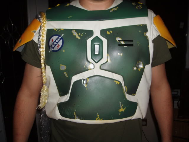

I marked the hook placement from the back plate. It was about that. I also had to place them below the top shelf of the pack - obviously! I am gonna wait re the collar studs until I have them in hand, as i don't want to get it wrong.
I think that is all i am missing. Will finish the black braid and then tidy them up to the correct length and shape - found hair spray works well.
