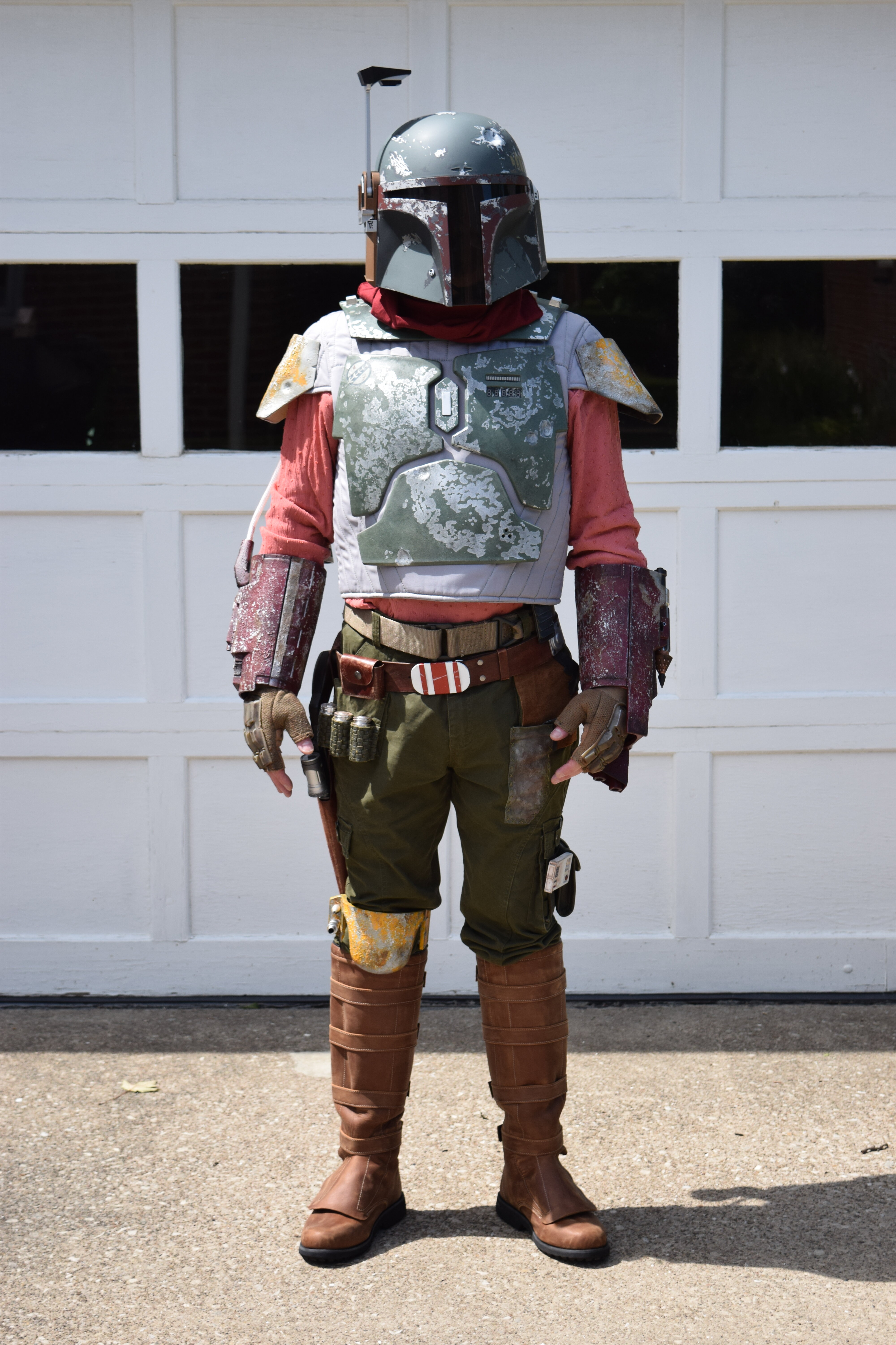

First test fit for this costume. The jetpack weight is giving me some issues with pulling around the neck and pulling the vest in the back. But otherwise, I am pleased with the progress so far.
I have tried two setups so far. One is a harness from Man of War that I use for a Jango Fett setup. It works great on that. But the back armor and connection points on the Cobb pack are causing it to hang differently. I had to run the strapping differently from the pack to the harness. I also tried modifying a weight belt harness and that has been a dismal failure. That wants to pull up under the arms and cuts the blood flow off.

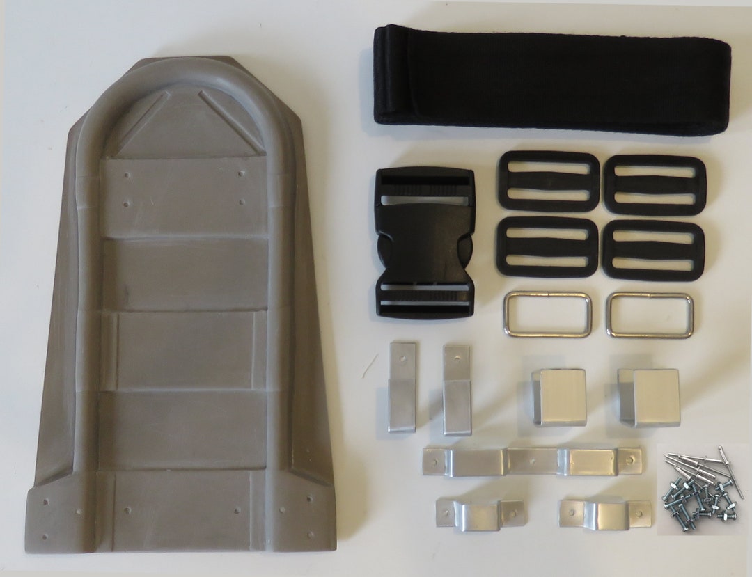

Sorry for the long delay in updating what I settled on for attaching the jet pack. I was definitely over thinking the jetpack attachment. After a number of attempts with harnesses I finally just sewed heavy duty Velcro to the back of the vest and glued the reverse on the inside of the back armor plate. I use a slide on method with the jetpack to catch a hook on the back of the plate and a tab of Velcro to keep it in place. So far it is working well and easy to get on and off by myself for trooping with it.
It is a 3d printed piece that is in the shape of a U. It has a 3-inch tongue on the inside of the pack that is held in place by 3 bolts. The outside part of the U is just the inch ledge you see in the picture to catch the edge of the hole in the back of the jetpack.
