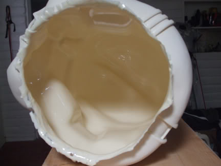

I was handed a mold and told I could make couple Clone Helmets so I did, (I had to hand roll the molds instead of rotocasting ) And I think I did A pretty good job of it , the interiors are smooth as glass although the castings have a few dimples on the outside there not to bad , I'm saying their made from MR parts judging by the size .

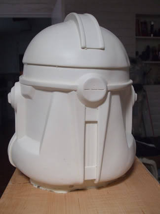

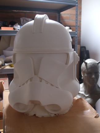

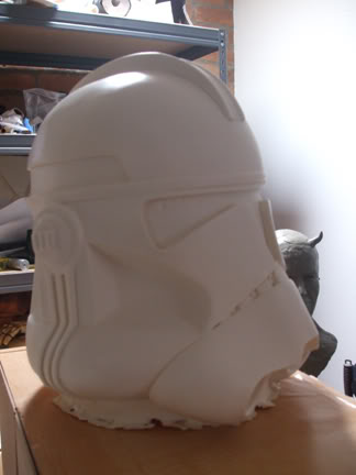

Here's some pics of the Clone Helmet

I put my two Helmets on the scale and got an average weight of 2.5 pounds without fiberglass renforcement but I tend to over build sometimes for my own costume pieces, I'm sure I can get the weight down. Iv'e got use of the Molds for awhile and permission to do a Run , I was looking to Price them at $125.00 + shipping but looking at the interest so far The Price for TDH Family Members will be lower around $95.00 + shipping for a slush cast.

Keep in mind the mold has some pops and bubbles so there will be some minor clean up to the castings but still a pretty nice Helmet.
Mine two are strong and a little thick but thanks for raising a question , How lite or thin do you want your Helmet to be and do you plan on renforcing it with fiberglass when you get it? I did mine a little thicker so that the resin would take hold of the sharper edges I didn't plan on Glassing these two , If I do Glass one for myself I'll go Two coats on the casting resin one layer Fiberglass cloth and maybe a small amount of resin after that to smooth the interior.
