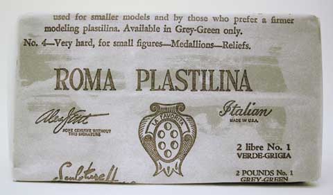

What the Professionals use for prosthetics and sometimes masks is called Roma Plastilina, it's a Oil-based clay that doesn't dry out, but it doesn't set-up against GI-1000 Silicone because it has Sulphur in it.
It is carried at many art stores and looks like this:
Other artists prefer to use clay without Sulphur in it called Chavant which Rob Bottin's FX Crew sculpted Robocop out of because it can be smoothed-out and polished, they even use it for sculpting Car designs out of:

You can also use a Roma Plastilina NSP (which stands for Non-Sulphur Plastilina) it's very similar to Chavant.
