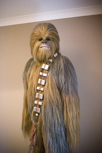

Chewbacca
just had to add what an I N C R E D I B L E job you have done, this is a work of art it looks like the real thing, you have everything is spot on I always liked the walking carpet...............I want one :D !!!!

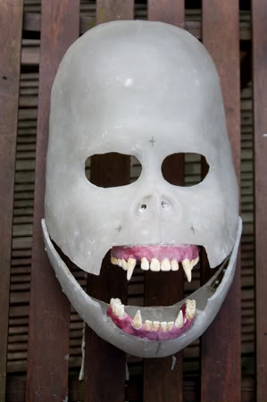

Just a few more pics!
Fibreglass underskull
The mask was cast in platsil gel 10, really great stuff, takes hair punching really well.
Things to do:
1. Add some highlights to the mask, shorten brow hair
2. Add some more brown to the waist
3. On the next mask, add some deadner to the platsil around the lips to make them softer for lip snarl
4. Paint lips with brown/maroon acrylic ink or silicone pigment (was just using lipstick :lol:)
5. Matt the overall costume down to stop the hair flowing while walking, trim upper arms slightly
The mask was a hell of a lot more intense work than I thought it would be, the next one will be easier, think I've weeded out most of the mistakes!
WOW! Truly incredible work. I can't even imagine the hard work & time you have put into creating Chewie. PM sent .....
