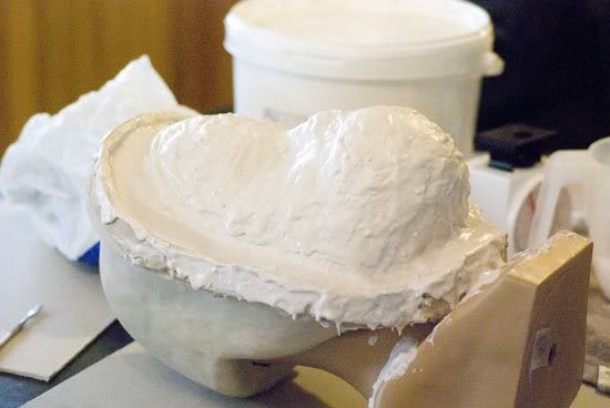

Sculpt all greased up ready for moulding!
Jesmonite mould, approx 3 layers!

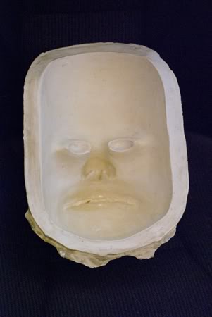

Negative, looking positive!

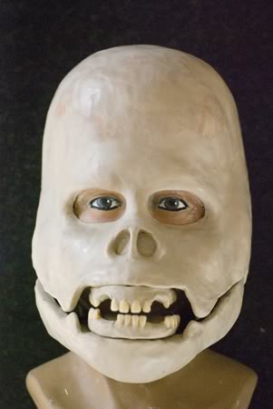

The next step was to remove a layer approx 5mm from the sculpt and carve out the underskull.
Rough and ready but will be smoothed out before moulding.
I then cast a temp gelatin skin to act as a guide for building up support.
Just waiting on RTV silicone before I mould the skull.
LOOKS GREAT!! But instead of taking off 5mm. of clay for the underskull cant you just add 5mm. of clay to the negative mold, smooth it out, and then pour plaster into it?
Yes you can, that's the way Daniel Tirinnanzi does it for his amazing animatronic gorilla head that was used in the Cadburys commercial.
http://www.youtube.com/watch?v=I96tKcfADWQ
But I decided to do it this way, didn't take too long and will be as effective!
