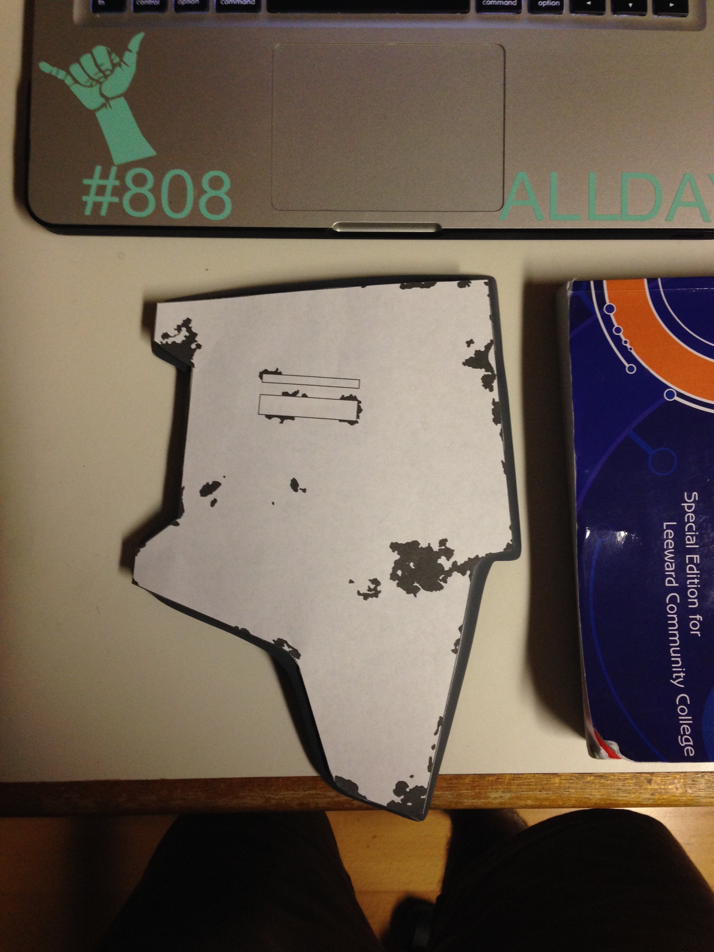

According to those measurements this is what i got on my RKD armor. Look accurate?
Sorry couldn't figure out how to rotate...
Thanks for the encouragement! And one more question, this may seem like a no brainer but.... here it goes... When i use your stencils, I've tried placing the large sized WOF's on my chest pieces. It seems a little small. Supposedly RKD's armor is based off of WOF's large templates. So I'm assuming i should just adjust its size a tad bigger? Thanks again! Im also really grateful for these stencils. Making my build so much easier and less stressful!
Looking at that image, it doesn't seems to be a big difference (the difference is from the chest plate's rim thickness), so I would suggest to use the stencil as it is. But if you want, you can cut the stencil in several pieces and fit the pieces to the outer contour and the chest slots.
