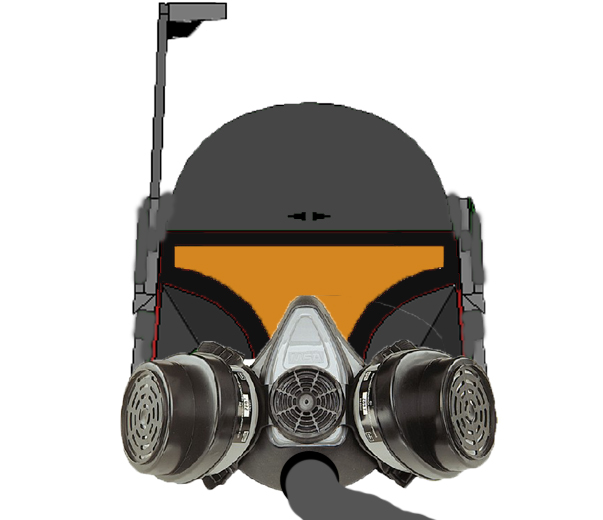

Here is what I am looking for... Basically I want to add a resperator and them have a tube come out the bottom of resperator. I know it is not perfect but I like the way it looks and will do a custom paint job on the resperator. Where can I get a orange faceguard?
gonna have to make it yourself out of Lexan sheet or a clear faceshield and automotive tint.
There's a guy on ebay that sells alot of tints by the foot, for somewhere around 1.65$ if I recall correctly.
