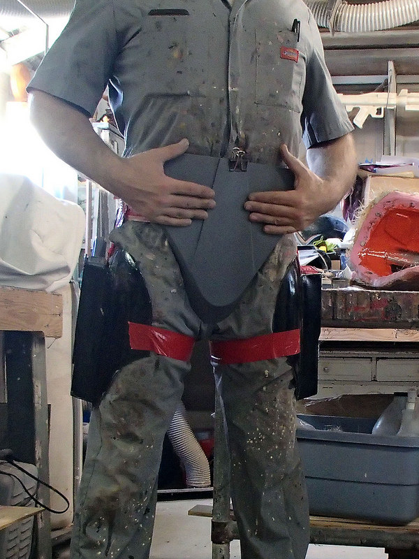

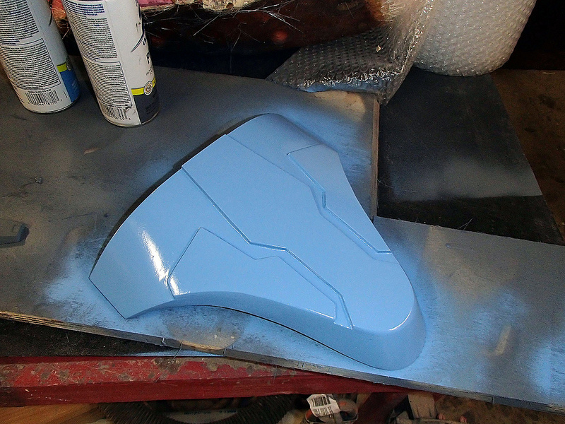

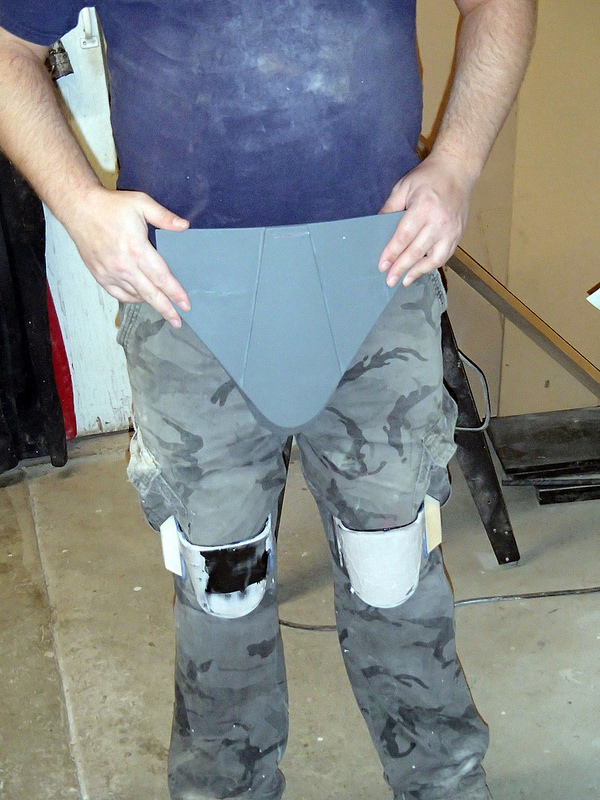

Matt got started on the codpiece prototype:
Here I am trying it on:
Here it is in primer:

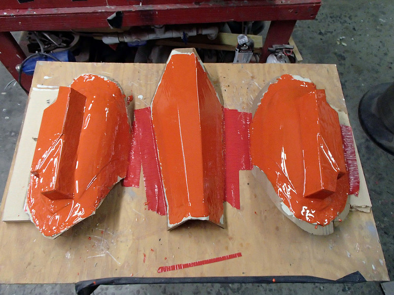

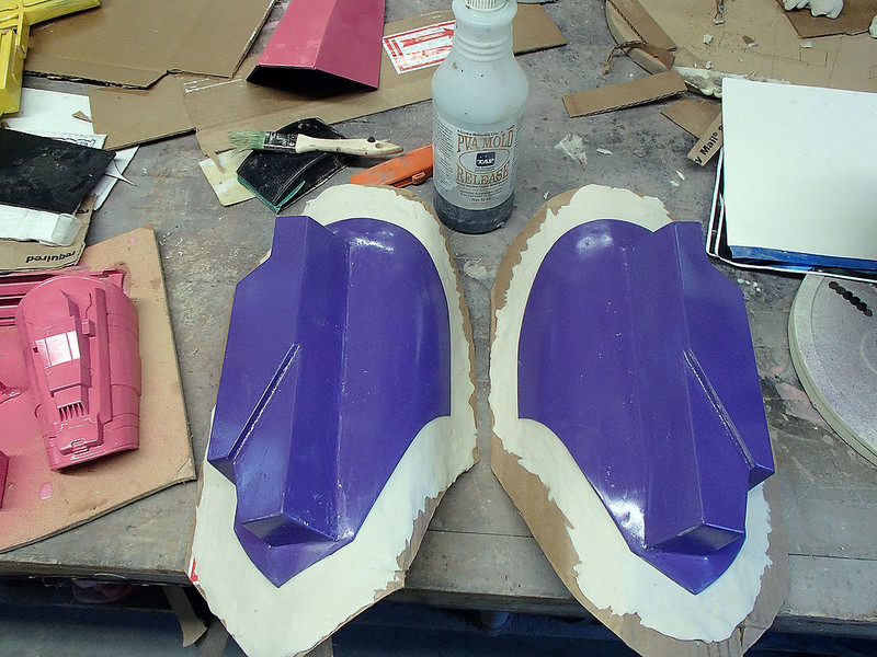

We also got the leg pieces set up for molding:
Then I gelcoated them:
Shiny:

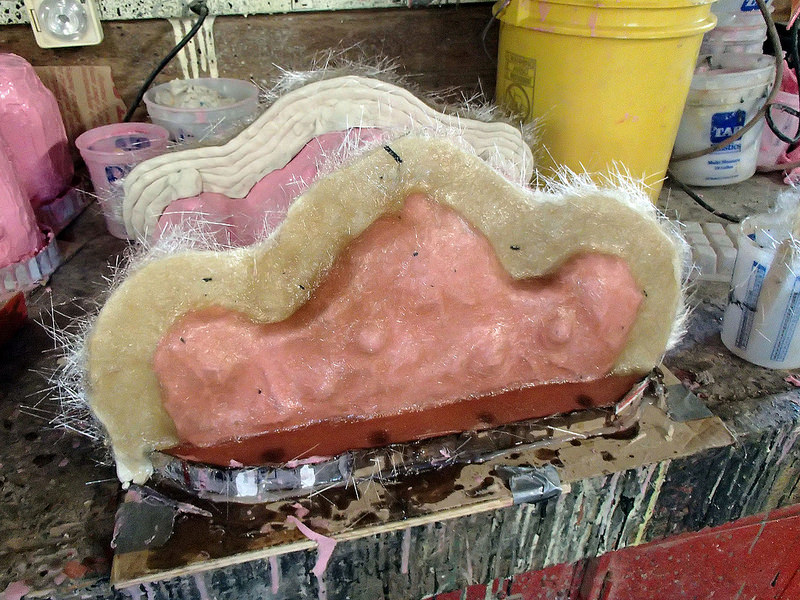

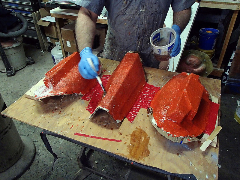

Once the gelcoat was set up, I laid up the fiberglass molds:
Which came out pretty good:
Removing the solid wood blocks that make up the holster area of the prototype proved to be a bit tricky:
But after drilling a hole to let air in, they popped right out. Then it was just a matter of polishing up the molds and applying mold release. Here they are sitting on the corner of the bench, ready for layup:

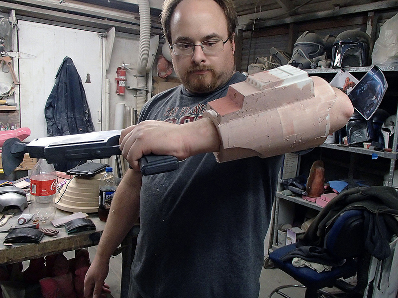

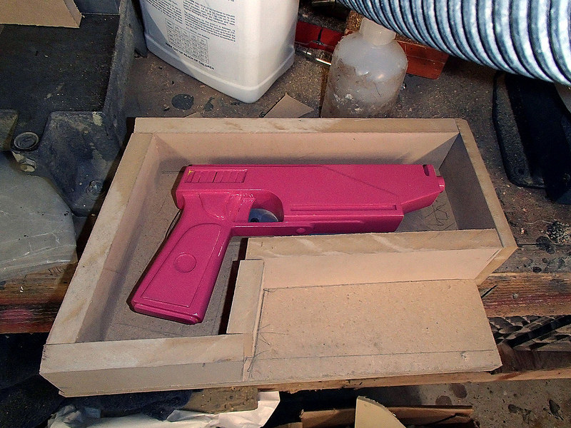

We also made a mold box for the blaster pistol:

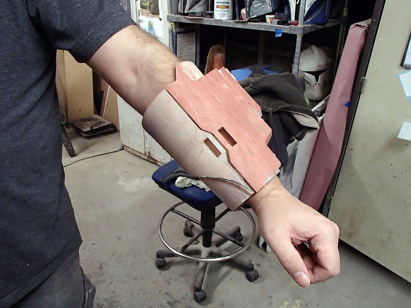

Here's the beginning of the mold on the gauntlet prototypes:

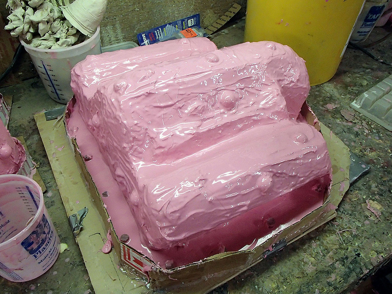

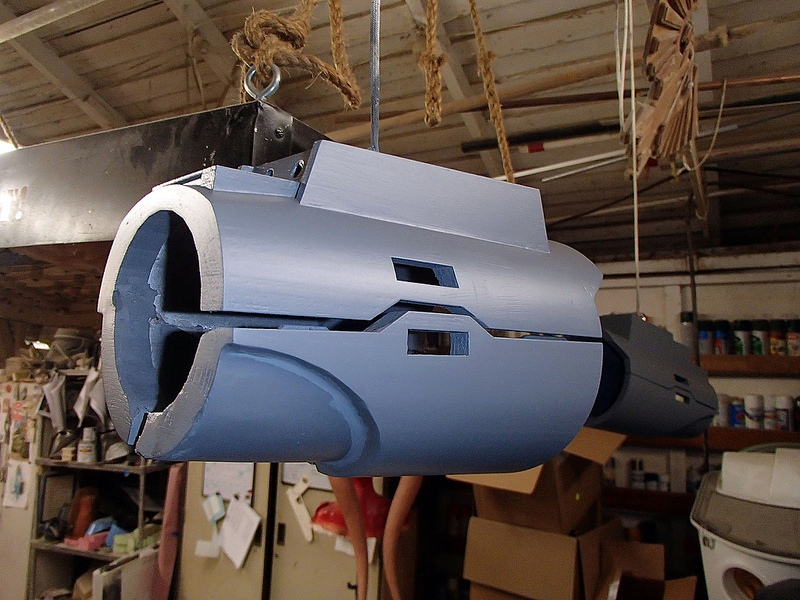

Finally, we managed to get the print coat poured on the jetpack body:
Today I'll be thickening it:

So we've started adding thickness to the jetpack mold:
The gauntlets too:

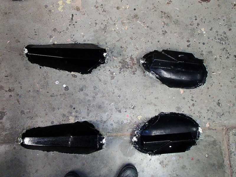

I managed to get the first copy of the shin out of the mold:
Then a full set of leg parts:

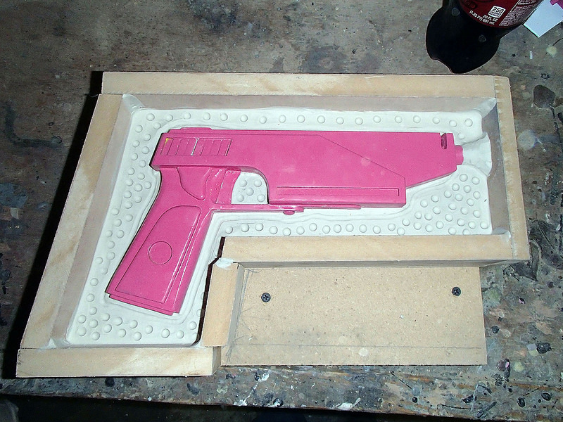

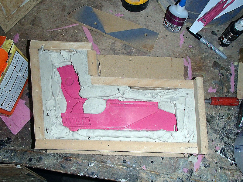

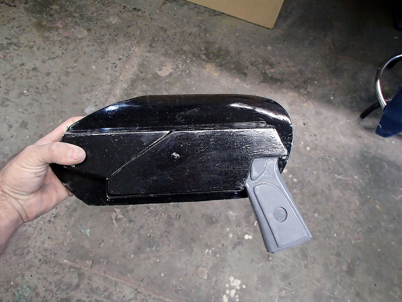

What's much more interesting, though, is the pistol progress. Last time I posted anything about it, it looked like this:

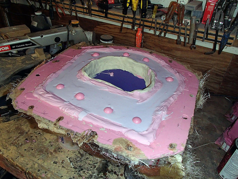

Once I'd built up a clay bed and sculpted in all of the registration keys, it looked like this:

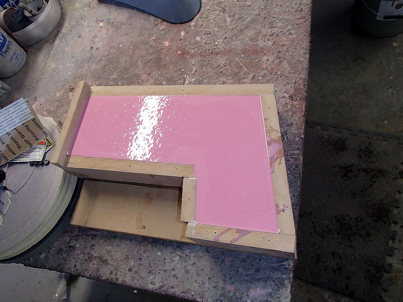

Then I poured in enough silicone to fill the mold box:
The next morning, I flipped the whole thing over, removed the bottom of the box, and here's what I found:

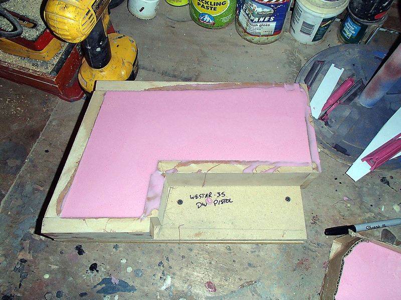

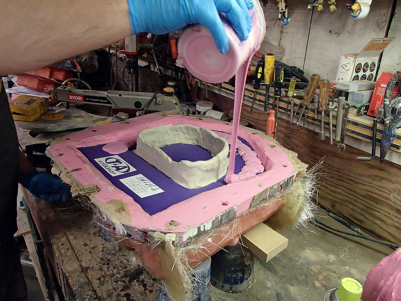

After removing the clay, I sprayed the exposed silicone with a copious amount of mold release:
Then I filled the box with silicone again:

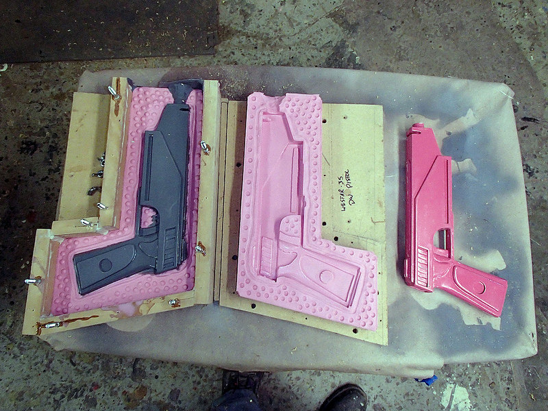

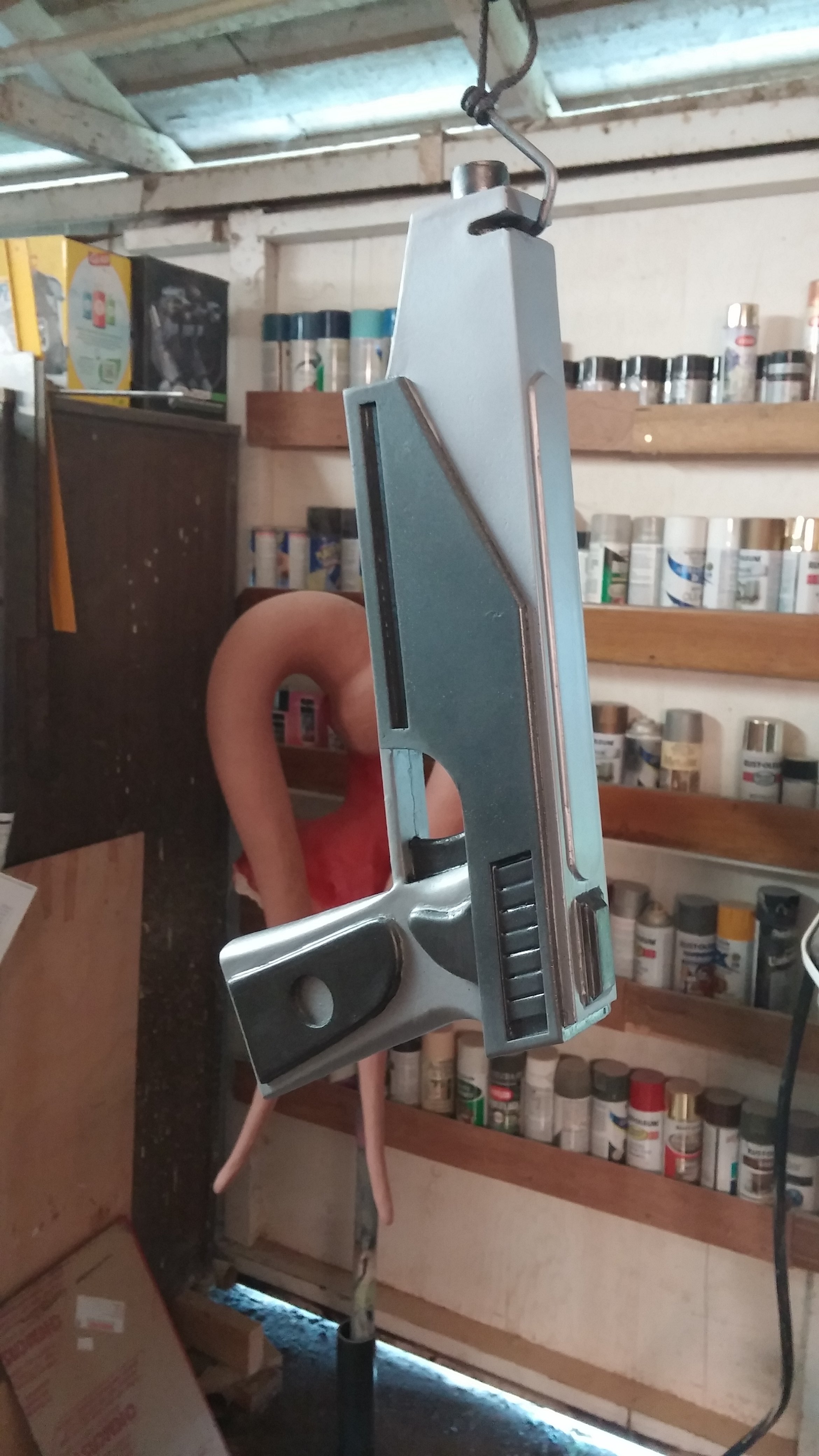

The next morning, I pulled the mold apart, removed the prototype, put the mold back together, and poured the first casting. Here it is when I was pulling it out:
And the second one:
They're a perfect fit for the holster:
Which is a perfect fit for me:

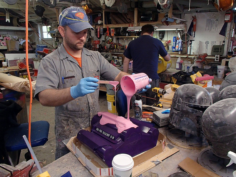

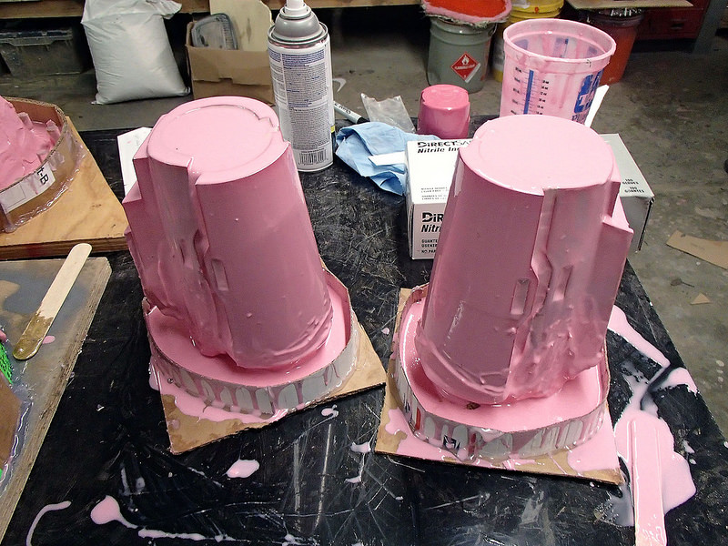

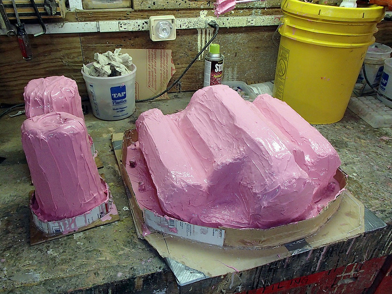

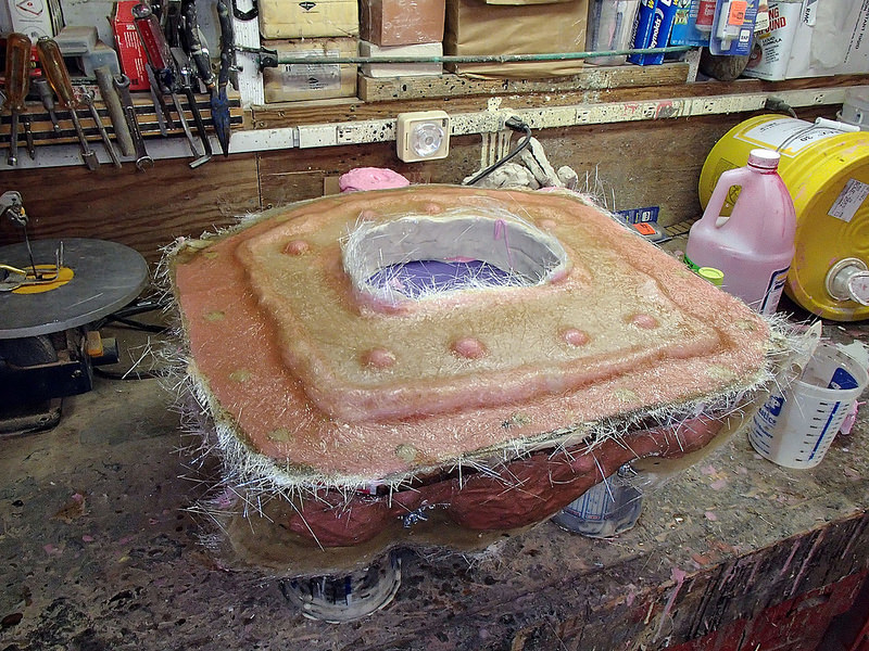

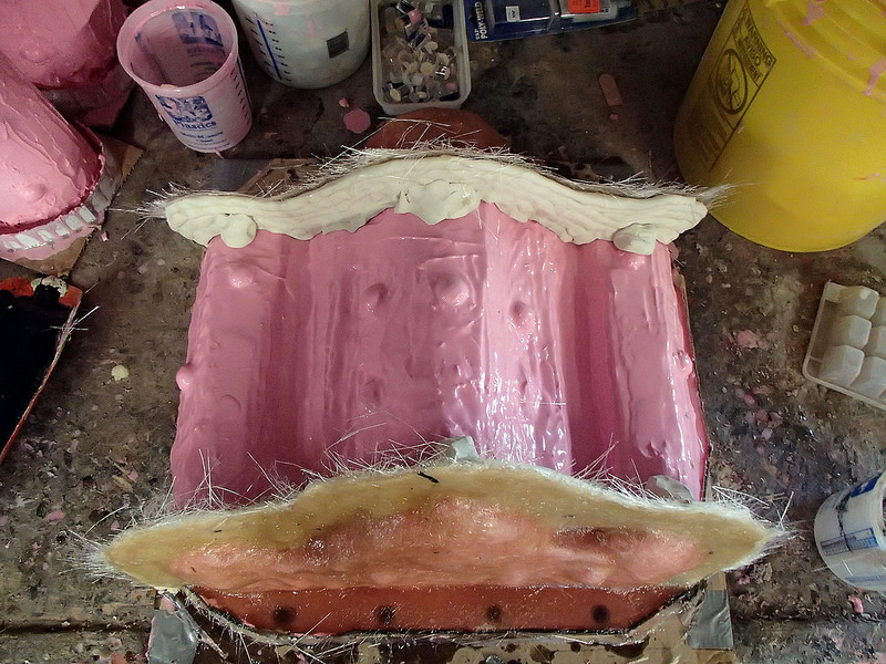

Finished thickening the silicone jacket for the jetpack the other day:

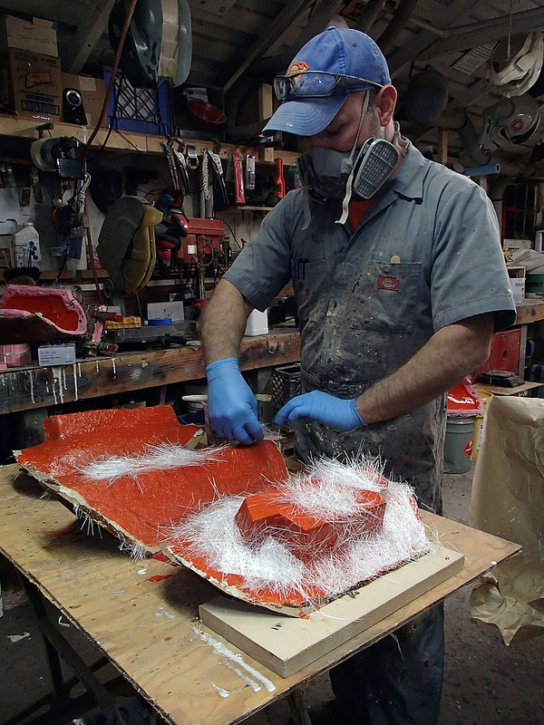

Today I'm making the mothermold:
The end result will be a four-part mothermold (top, bottom, left, and right) so I've started with the top and bottom:
Once I've laid up the left and right sides, I'll be flipping the whole thing over to make the last piece of the mold. That'll be the part that mounts to the backplate.

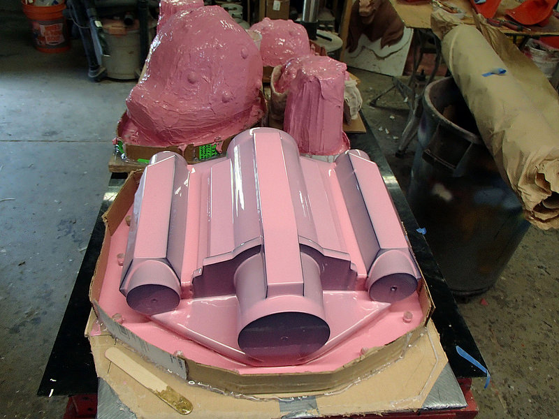

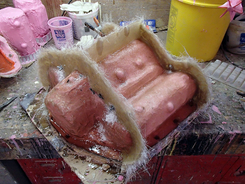

In any case, I've finished the mothermold for the outside of the jetpack:
Then I flipped the whole thing over and started a rubber jacket mold for the inside:
I wasn't able to be in the shop yesterday, so Matt finished the inner rubber portion while I was out:

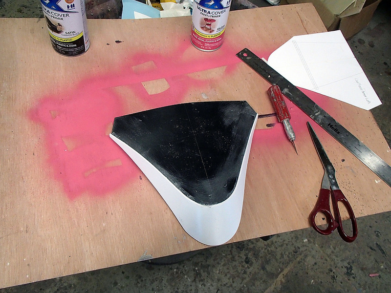

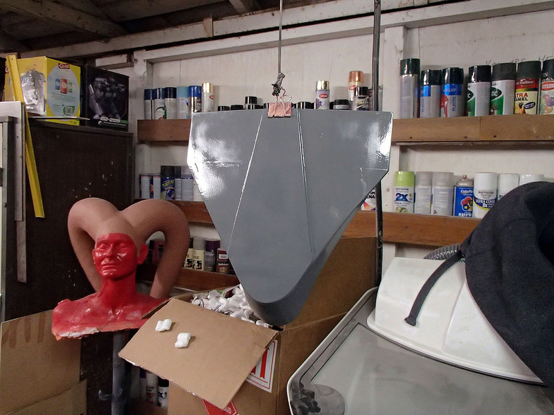

He also finalized the female version of the codpiece:
Yes, I know the female version isn't supposed to have a codpiece, but after looking at all of the references with the three plates glued onto the undersuit, we decided that they looked silly and impractical. So we're keeping the visual elements of the three plates, but transferring them to an actual armored plate for the sake of making them blend with the male versions better.

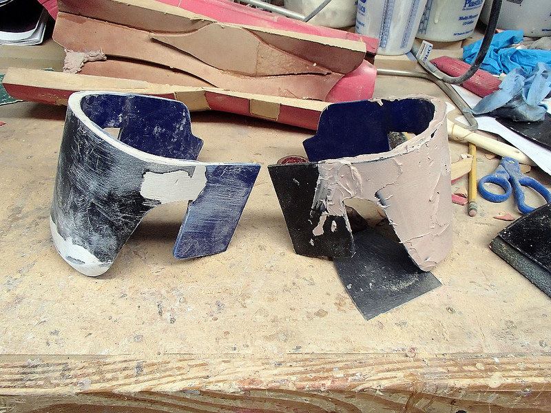

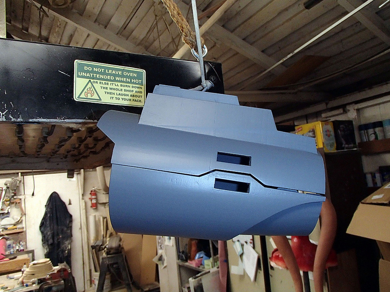

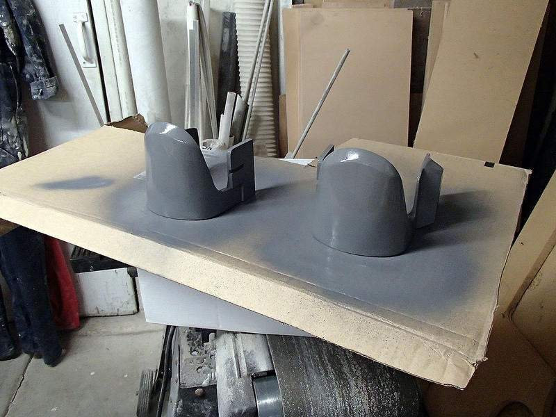

In another departure from the animated style, we decided that the gauntlets were a little too cartoony. So we ended up hacking apart the 3D printed pair from April Storm's files and reshaping them a bit:
Yesterday Matt got them all smoothed out and primed:
Now they just need a coat of glossy paint and they'll be ready to mold.

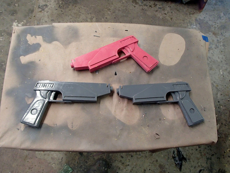

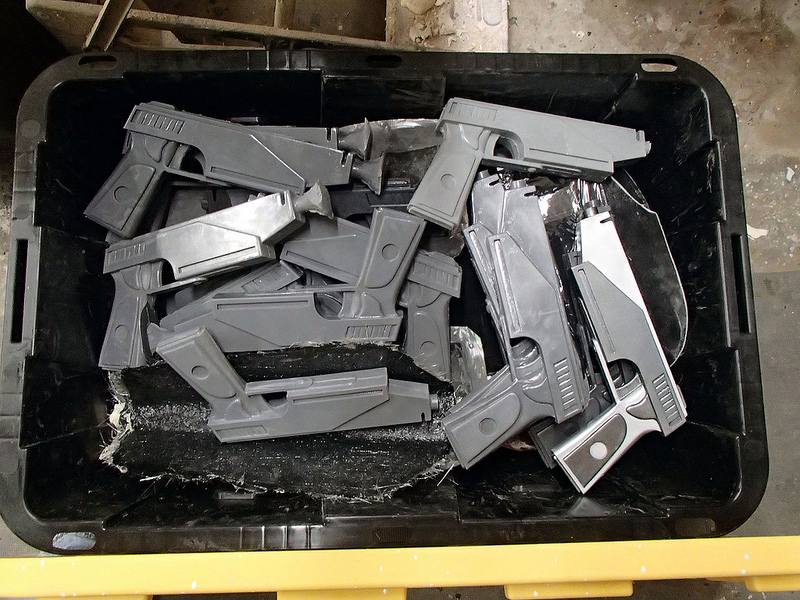

Other than that, we've just been casting a whole mess of pistols:
If everything goes according to plan, we'll need at least 34 of them.

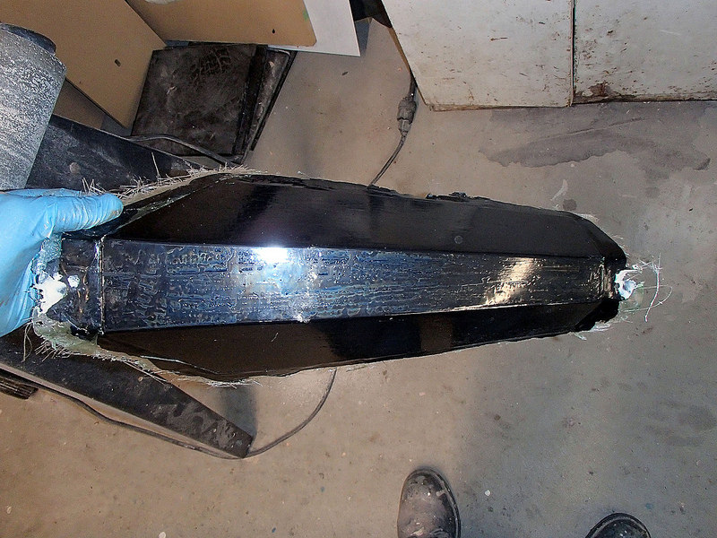

Oh, and I also finished the mothermold for the jetpack body:
So I should have the first one of those cast today sometime while Matt gets the nosecones printed out. With any luck, we'll actually have the first complete set of costume parts sometime this weekend.
