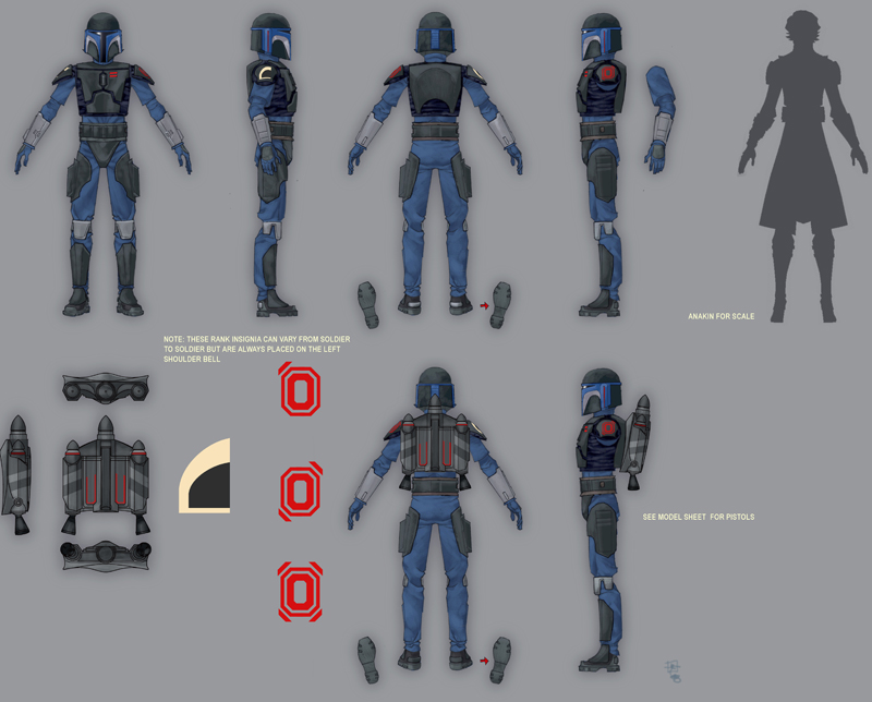

When we were discussing the jetpack design, this is the main image we kept referring back to:
Again, we're tweaking the design where needed in order to match the film style props better. We'll also end up with a variety of different tank toppers to add some distinction between them.

In regards to the jetpack, I still think it is really important to remember that we are going for a movie style Death Watch. The computer generated characters and armor are very stylized and there is no reason to believe that these are not the same jet packs.
And Wookieepedia says it's the same one, so it's got to be that way.... Right?

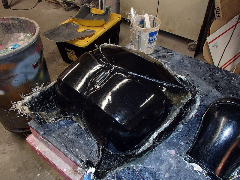

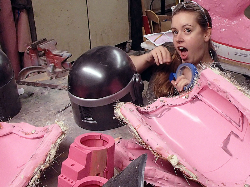

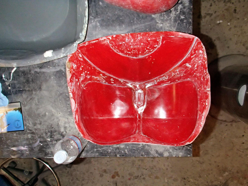

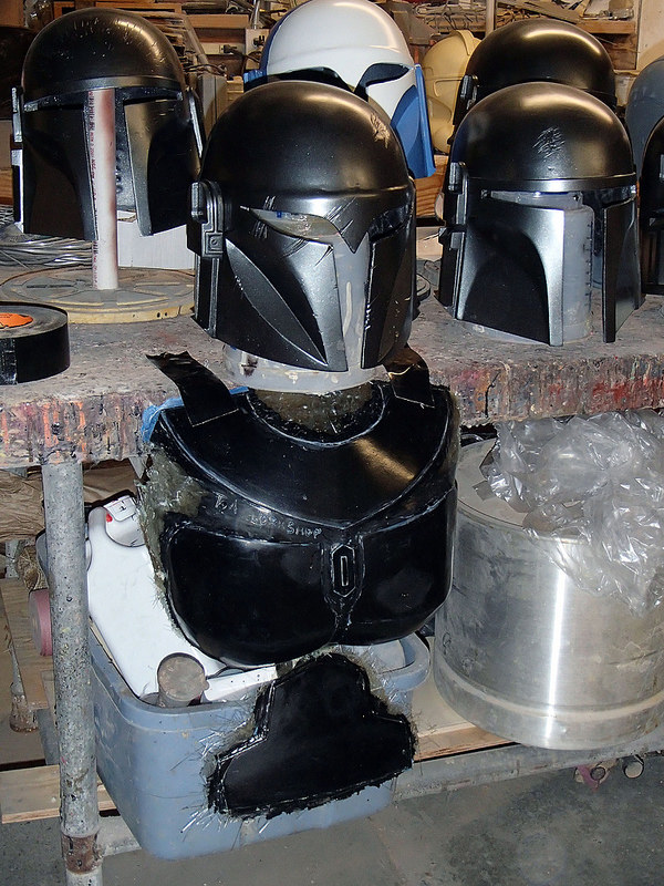

I went ahead and pulled the mold for the Nite Owl chest armor:
After polishing it up and adding a mold release agent, I laid up the first set of parts:
They came out pretty good:
And with a bit of trimming, they'll look great with the helmets:

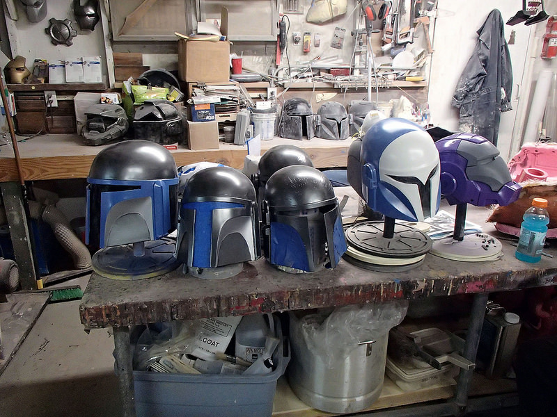

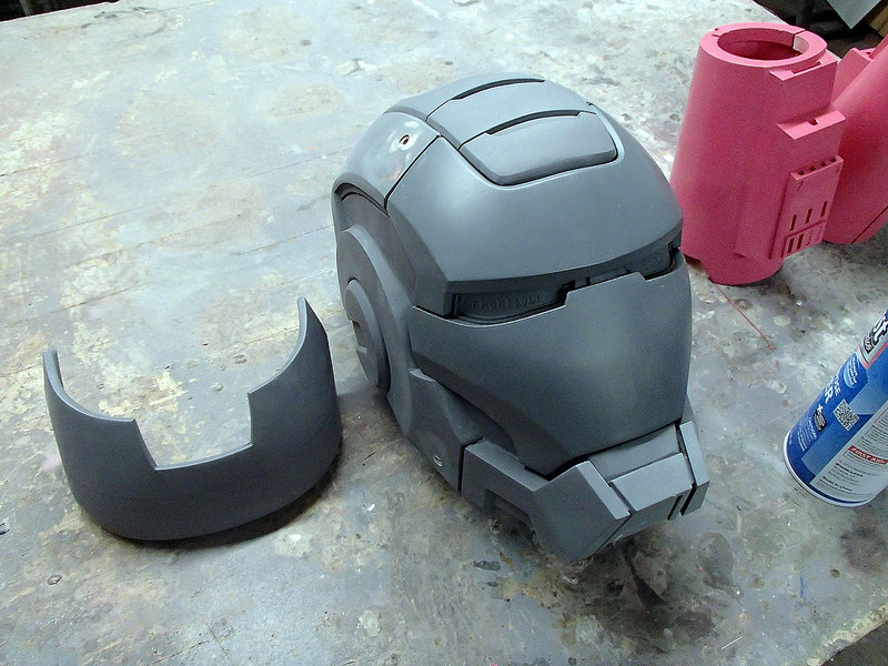

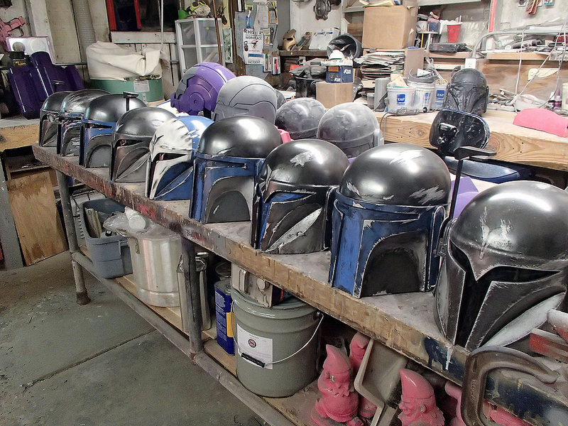

Speaking of helmets, we've got some:

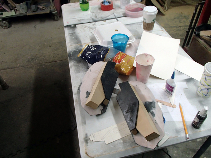

Matt finally got started on the thigh plates:
They're basically just some 1/8" Sintra heated and shaped and layered with Bondo to give them a bit more shape:

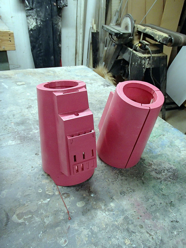

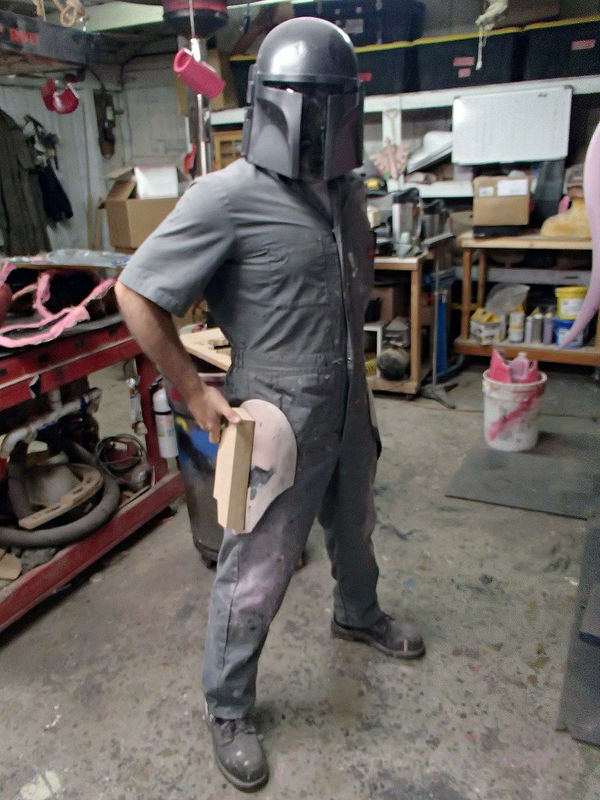

3/4" MDF was used to build up the shape of the pistol holsters. Here I am trying them on:
In yet another departure from the cartoon appearance, we decided to alter the shape of the holster to make it fit the form of the pistol a bit better:

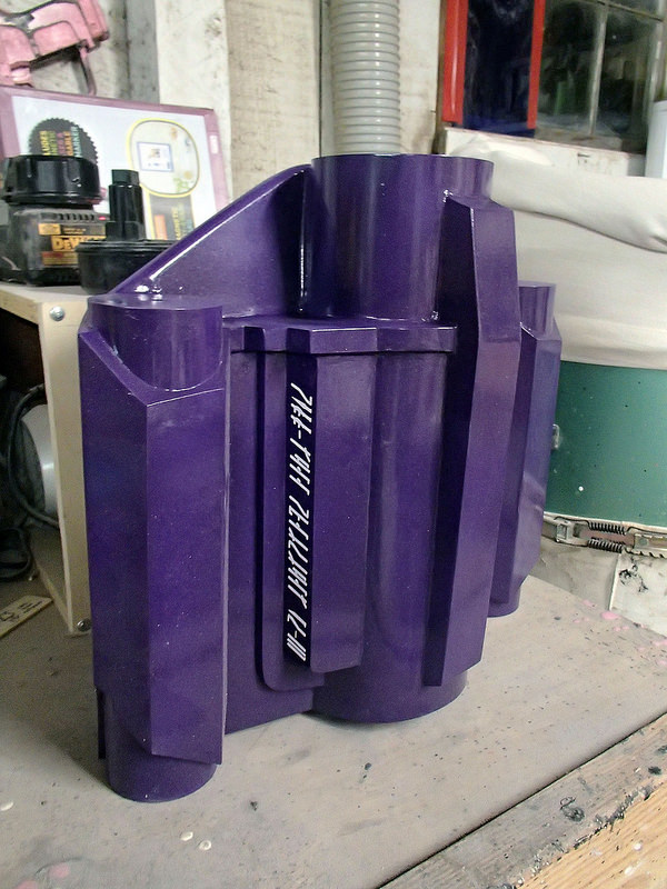

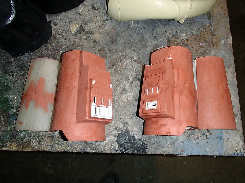

Tomorrow Matt should be able to finish the thigh prototypes and jetpack:

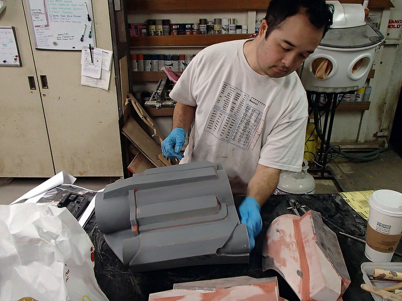

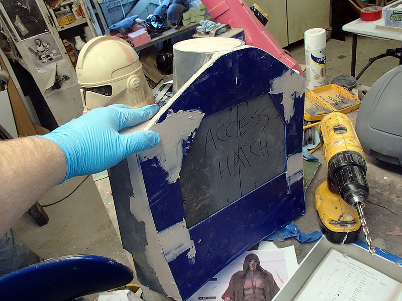

Speaking of jetpacks, Matt added the last layer to the inside:
While all of that was going on, I did the last bit of smoothing on the gauntlets:

Matt spent some quality time this weekend getting the thigh plates smoothed out:
Mark made progress on the jetpack too:

I sprayed the jetpack too, but I neglected to take any photos.

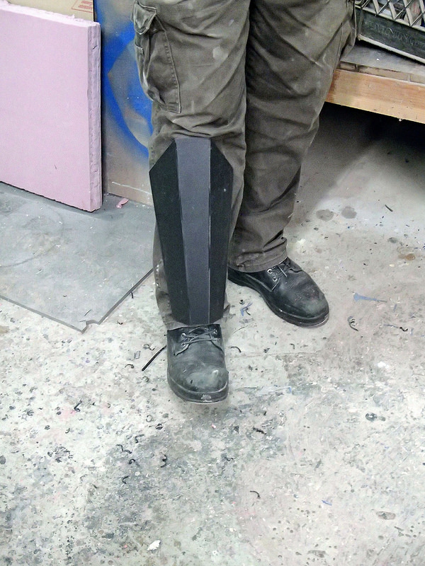

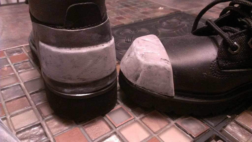

Next up, we'll be putting together the prototype for the shin armor and making forming bucks for the toes.

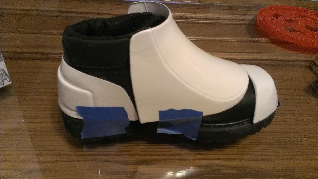

After a lot of discussion, we've decided to do away with the instep guards because they'll be impractical and prone to breakage. Instead, we'll probably go with Boba-style spats under the shin armor. More on that later.
We haven't sourced the boots yet, so I'm not sure exactly what they'll fit. That said, we'll be pulling them in some fairly thin ABS plastic, so they'll be able to flex a bit to fit.

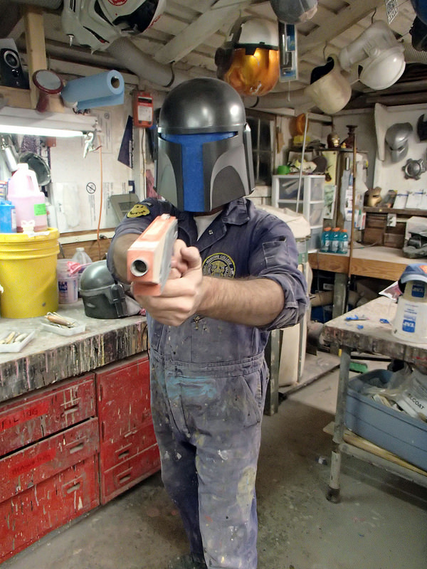

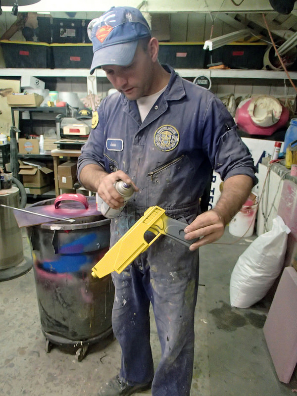

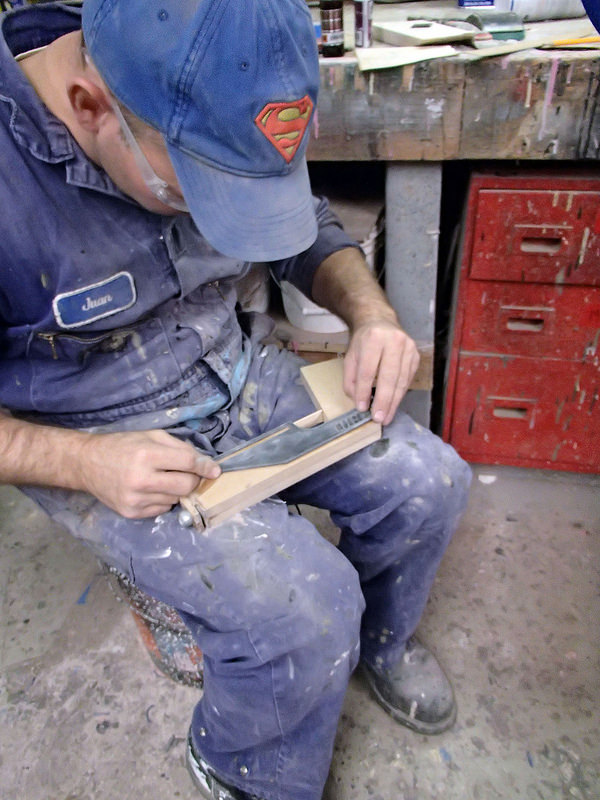

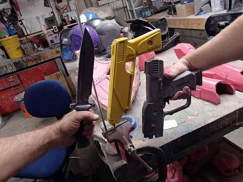

A couple of days ago, Matt went ahead and cut out a basic shape for the pistols:
So yesterday I sat down and started adding the few detail that it was supposed to get:
Even just adding the side panels was a huge improvement:

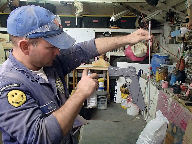

I also tuned up the handle a bit so it was prettier and more comfortable. Then spent way too much time goofing around:

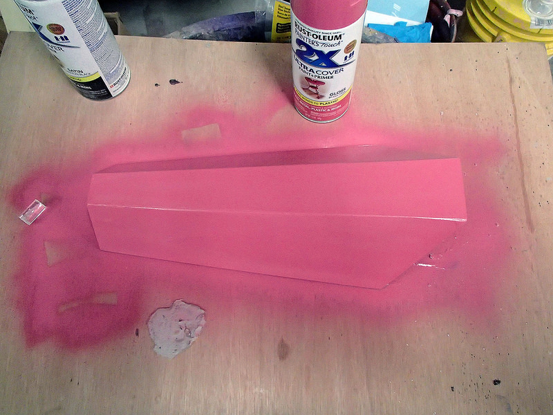

Once I was satisfied with the shape, I gave it a couple of coats of primer:
Then a glossy yellow coat:
Here it is with some other weapons I've recently cast:
It still needs a couple rounds of sanding and filling and smoothing, but it should be ready to mold as soon as my next shipment of silicone shows up.

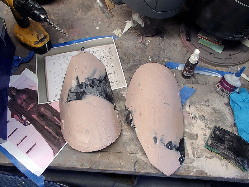

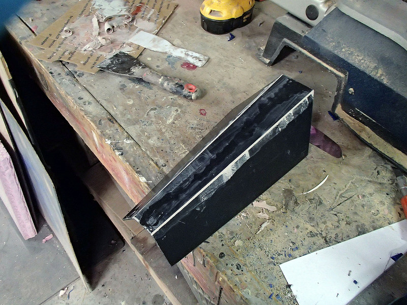

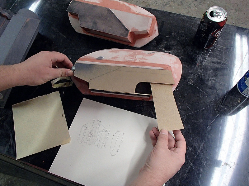

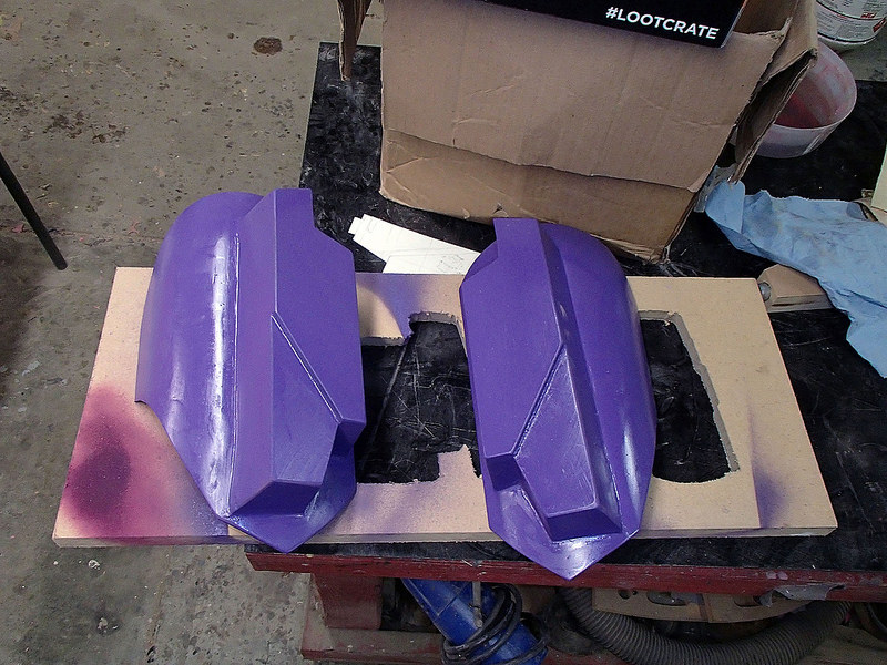

While I was messing around with that, Matt spent much of his time smoothing out the last few flaws on the surface of the jetpack body and the thigh holsters. Then he made the master for the shins:
I know what you're thinking. You're thinking, "Hey, you idiots, that shin guard is way too big and they're not supposed to be symmetrical on top."
Actually the plan is to make one mold and make a whole lot of copies of the largest size possible for this piece and then trim off the top or bottom based on the size we need for the individual wearer. So who's the idiot now?
Ahem.

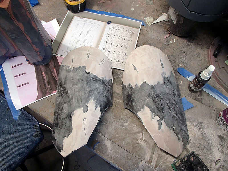

After a bit more smoothing and filling, here's what the shin prototype looks like right now:

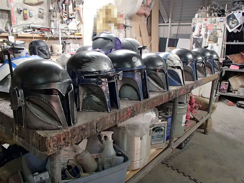

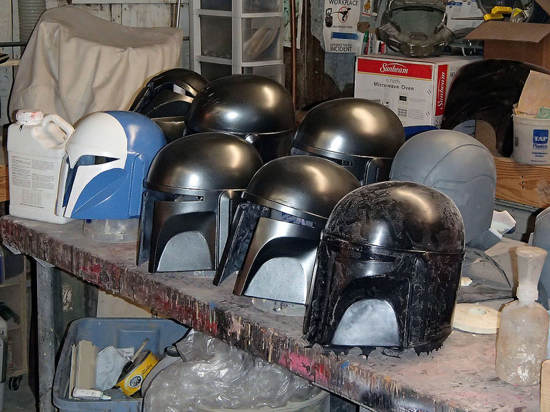

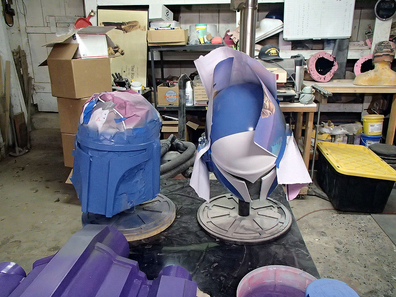

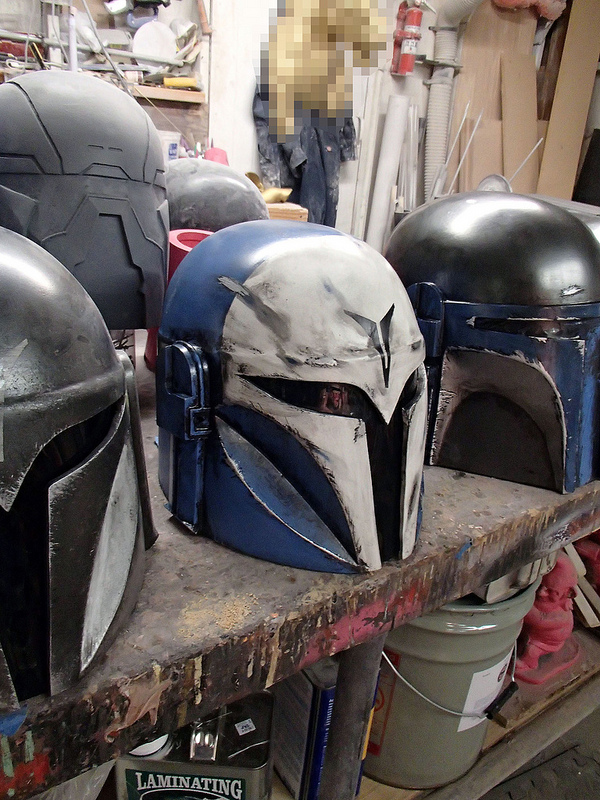

While Matt was doing that, my friend Kate was masking off the helmets that are in progress:
And adding the secondary colors:

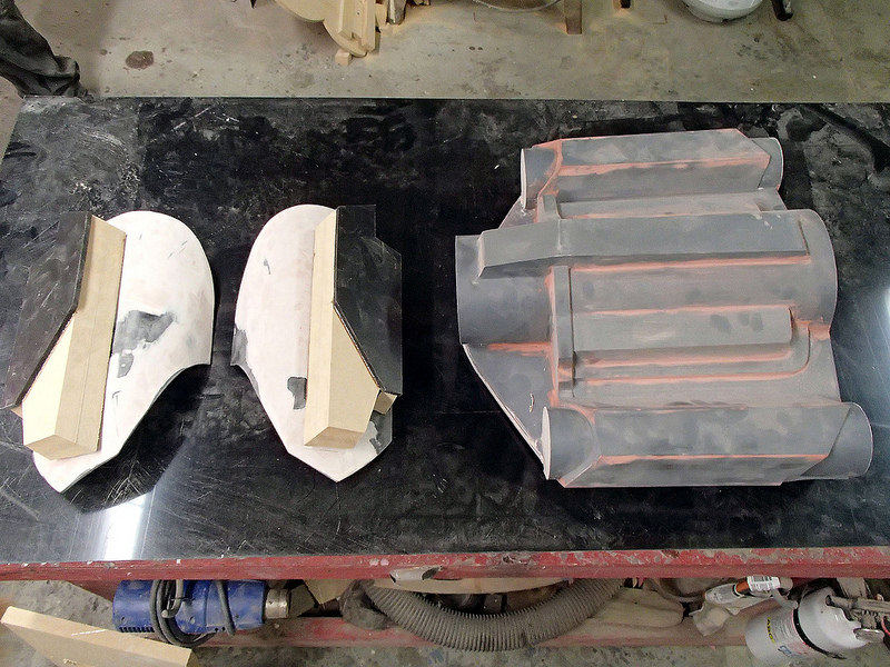

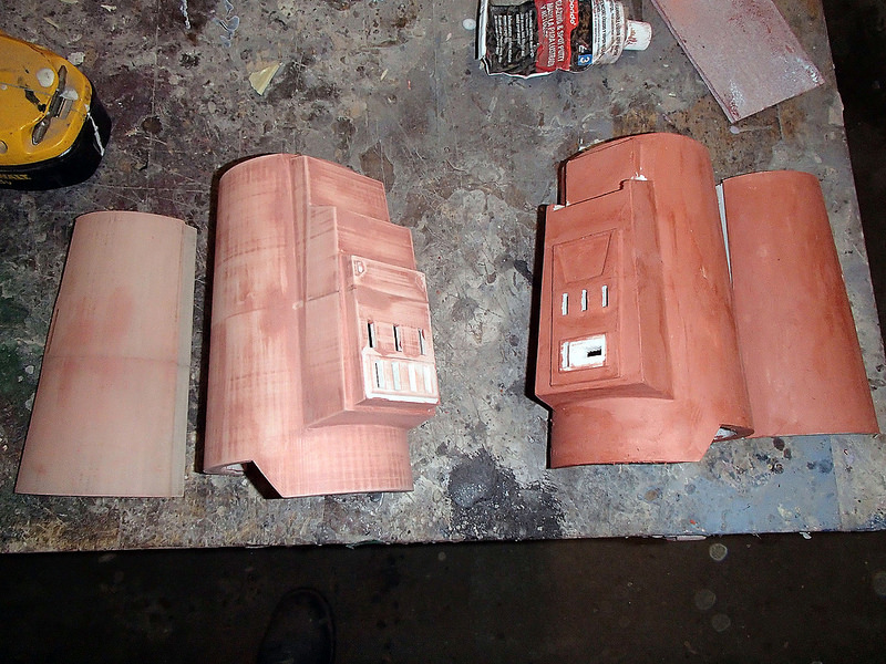

Shiny smooth jetpack prototype is now ready to mold:
Same goes for the shin plate:
