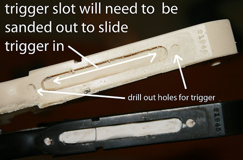

I wondered if it possible to post a snap of the hardware needed to assemble the kit into a "working" unit? Specifically meaning the screws that hold the Barrel onto the body, the trigger hardware and the grip/stock hardware. Also, do you have a picture of the the channel on the original gun body that is to be cleared out for the trigger to fit into.

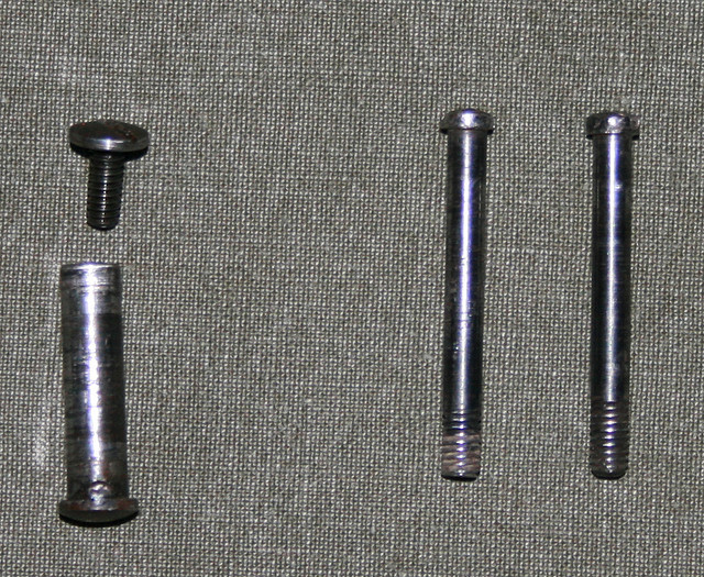

here is the first pic of the hardware. I seem to have missplaced the others. Once I locate them, I'll post the rest.
this is the screw for the barrel, (to allow it to pivot) and the two screws for the stock

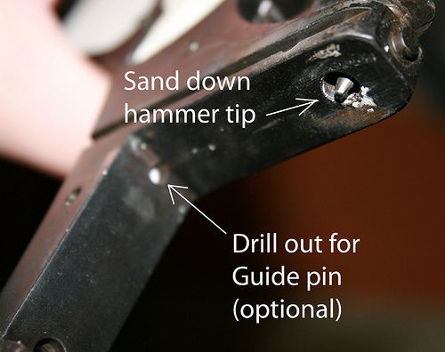

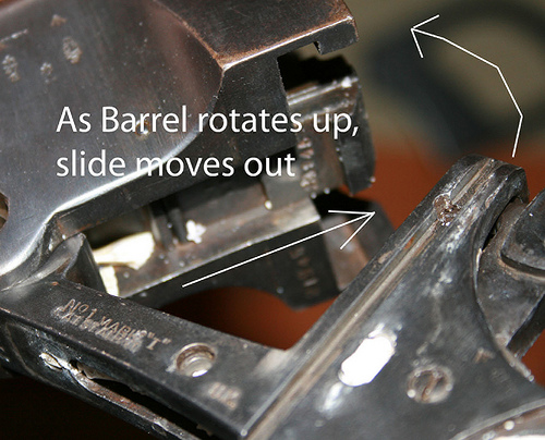

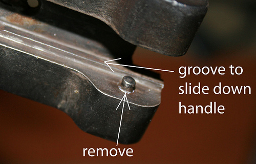

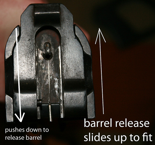

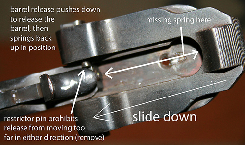

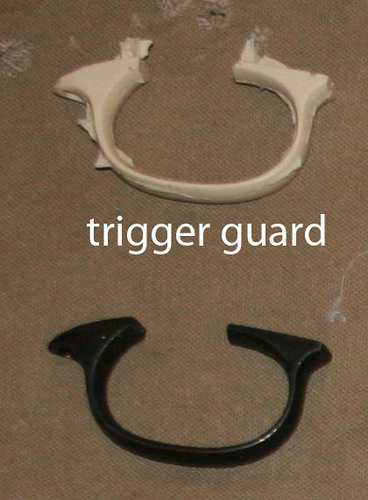

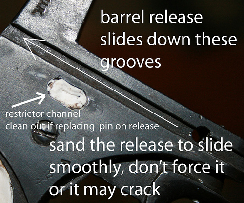

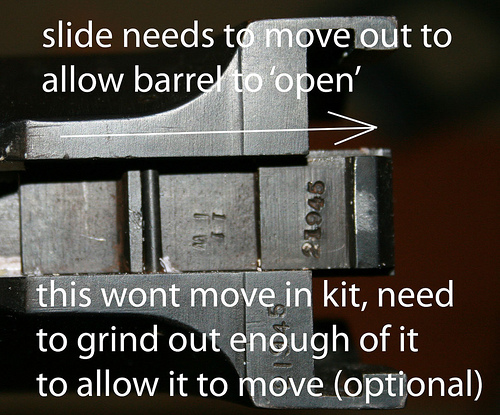

A quick photo tutorial on the basics for anyone thinking about making things move like a real Webley, or if you want to just glue/screw everything together. Hopefully everything is clear. I apologize for any speling errors.
Let me know of anything needs more info.

Here is the rest of the hardware. In order from left to right is, grip/bracket screw, trigger screw, and the two trigger guard screws. Then there is the spring that moves the barrel release up and down.
Just an FYI, the pics of the hardware is just to give an idea of what to get. You wont find anything identical at your local hardware store, but you could pretty much use anything you find. The hardware is threaded only at the end tip to allow parts to move.
