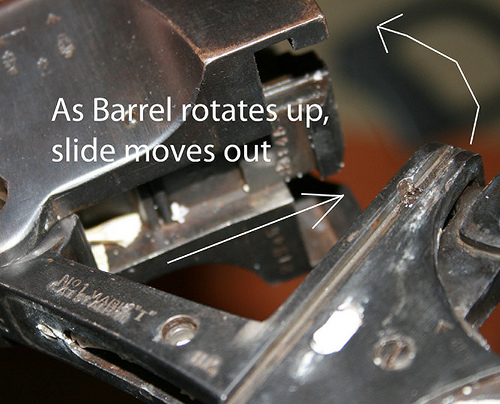

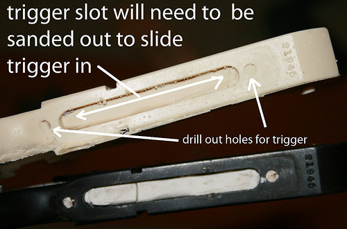

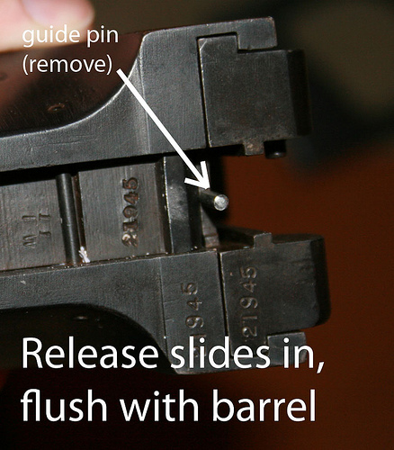

I was thinking about doing a photo tutorial on how to put it together, 'cause I know I am going to get tons of those kinds of requests.
For a list of the greeblies needed to complete a EE-3 blaster, can check out the Wiki.

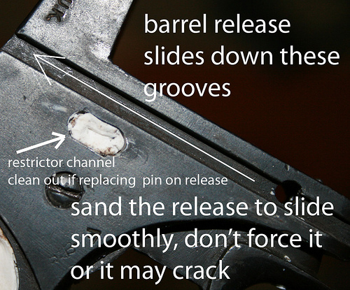

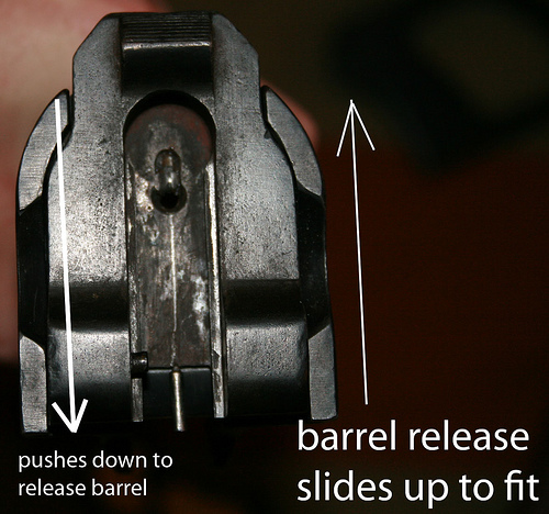

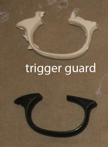

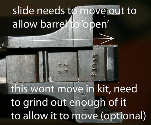

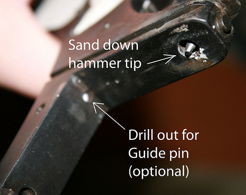

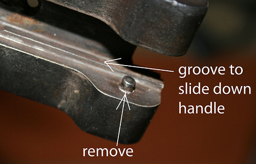

A quick photo tutorial on the basics for anyone thinking about making things move like a real Webley, or if you want to just glue/screw everything together. Hopefully everything is clear. I apologize for any speling errors.
Let me know of anything needs more info.
