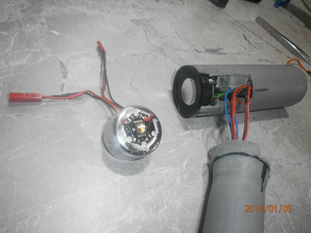

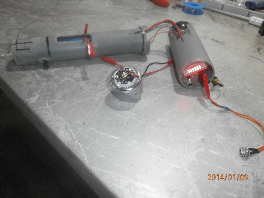

One the metal piece you see the High power LED
in the tube behind the speaker is the soundboard, recharge port , switches, rumble motor and the bargraph
the front pipe houses the AUX button, LED and the batterys

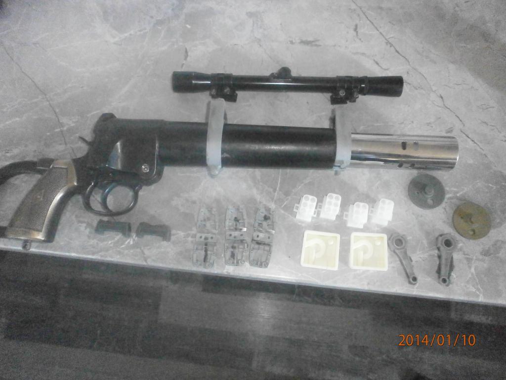

About the bronze webley, in fact it is hollow its no big deal to get all components in, but the real problem is the trigger.
You must cut off the static one and bore an opening to get an working replacement trigger in.
You can buy an full metal trigger like the one from the Indiana Jones Webley revolver, wich are very easy to get in US.
The metal gets very thin at this area but the bronze is very strong so you never bend or break it with pressure by hand.
Or you let it like it is and place an microswitch anywhere near the trigger. (never an option for me)
