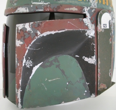

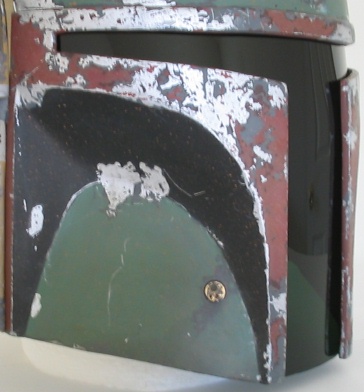

I used boxcar red and this is how mine turned out. You definitely had to get a bad batch or something.

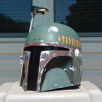

Here are some recent Pictures of WOMO's MSH2 with PACEMAKER RED custom mix......THANKS ALL..
Just my two $$:p

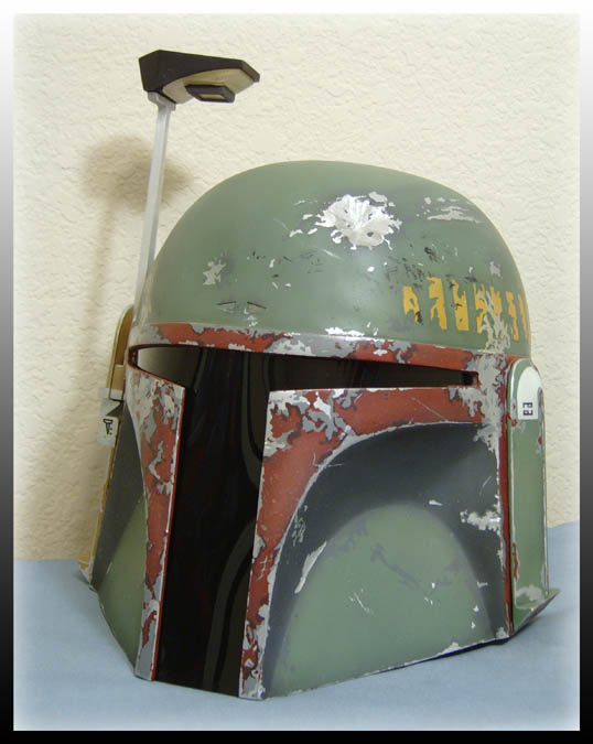

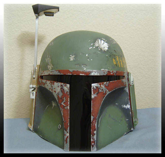

Here's a couple of pics I popped off. The end result is a blending of the colors rather than an in the face type contrast. I also used the "Dull cote" in layers also since if you use Dull cote last it makes the peice look very 2 dimensional. If done properly it will blend some while leaving other colors on the "surface"....it's more of a depth perception thing when viewing in person rather than in pics.
