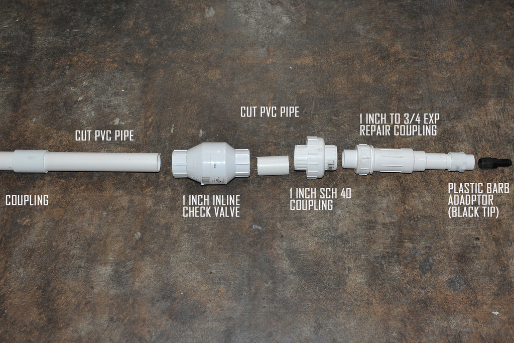

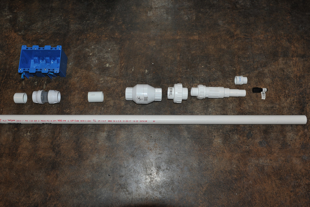

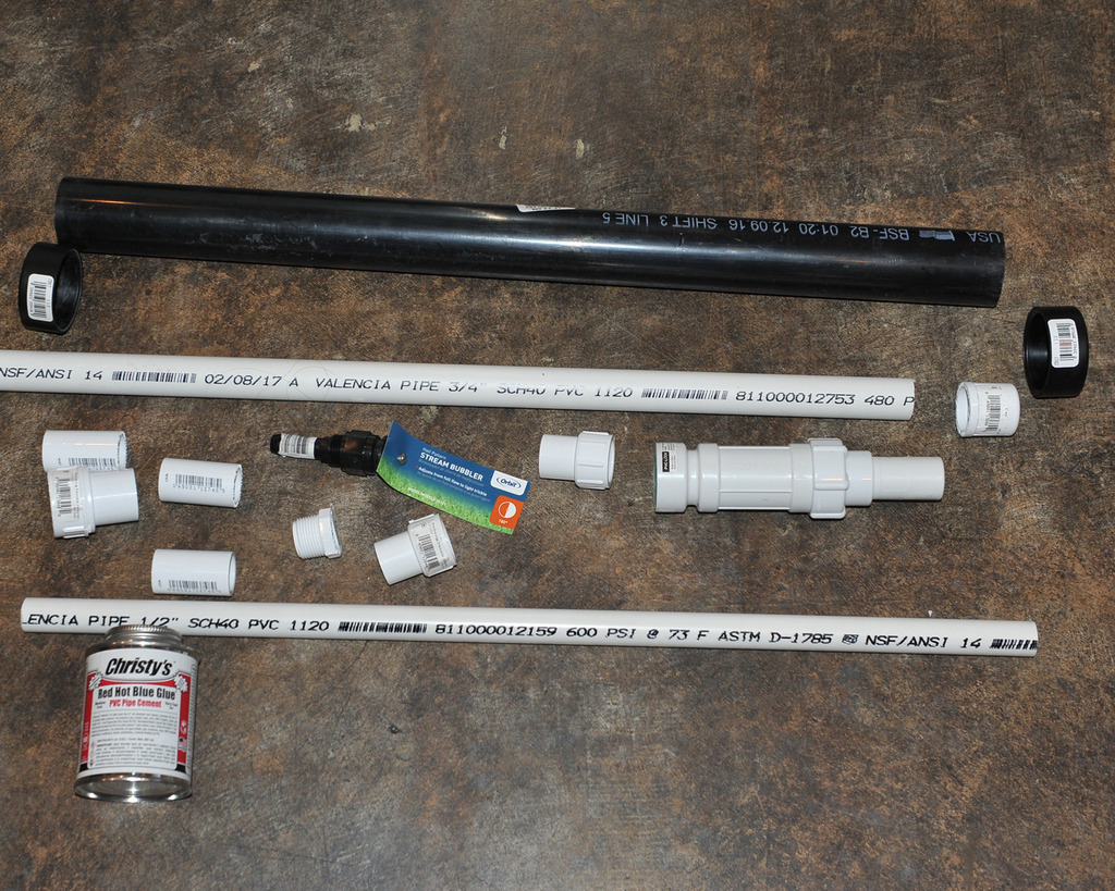

Using the images I grabbed a 10ft-1inch PVC pipe along with several coupling and adaptors that I thought could work.
Here is what I grabbed for $30.93

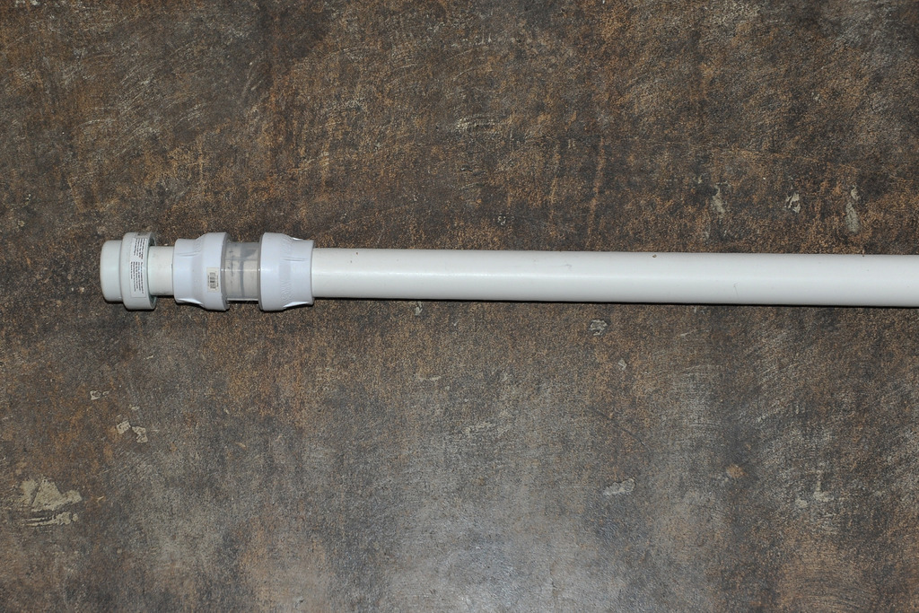

I decided to first begin with placing on the bottom footing and details of the staff. I used a 1 inch locking end cap and 1 inch PVC Union socket end to achieve this:

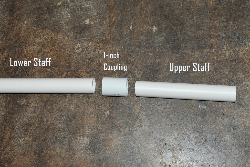

Since the staff is so long, one of the things I wanted to do was to have it separate in two piece and attach on/off for easier transport. I noticed in the reference photos, the staff is held onto around the chest area. Since my wife and I are the same height, I decided to cut it at my chest level and this will be the area I could place a coupling to connect the lower and upper parts of the staff. The connection coupling can then be covered by holding the staff in this area.

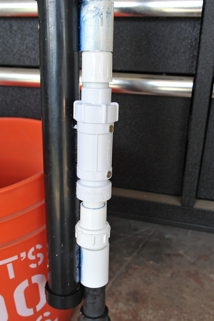

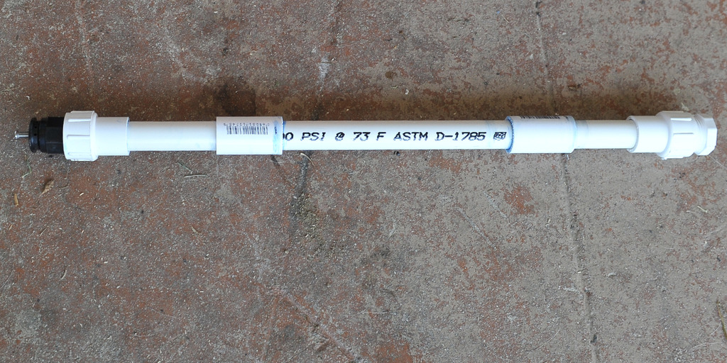

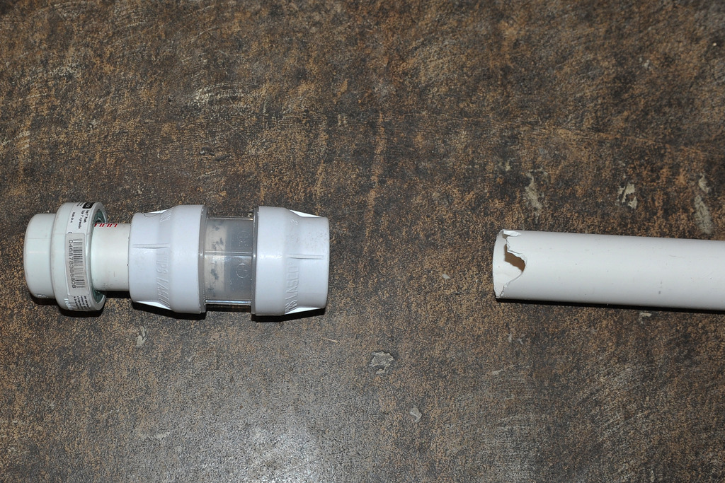

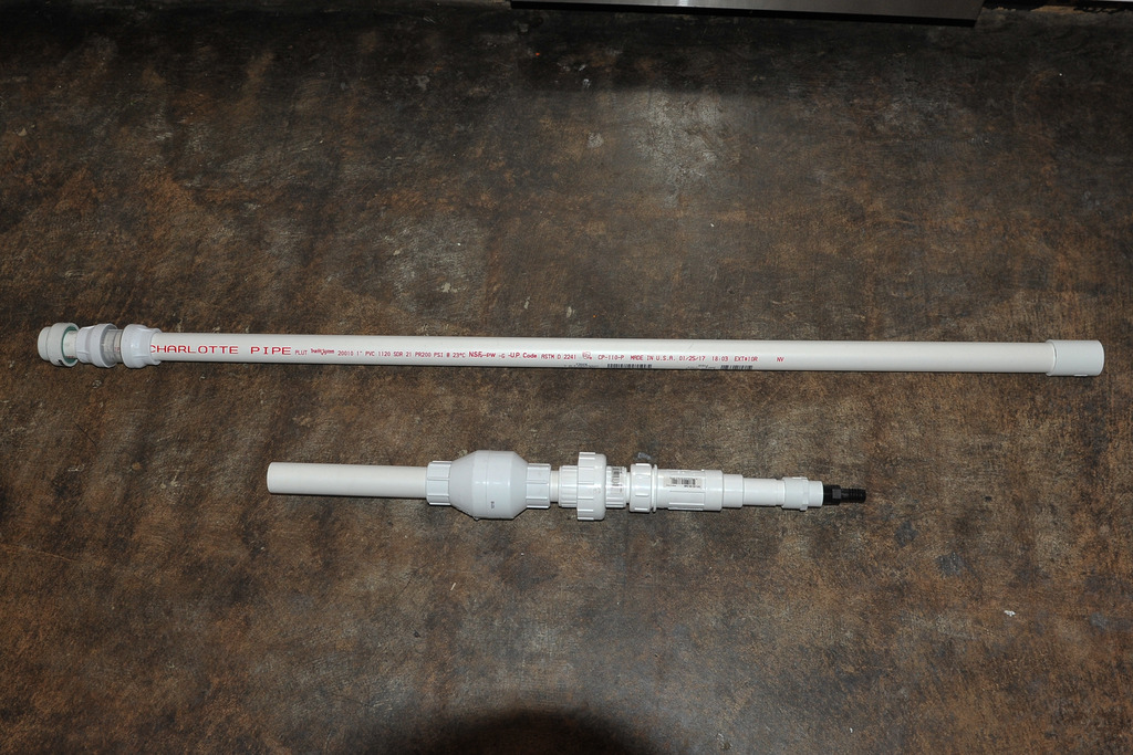

I spent a bit of time at Lowes looking at PVC fitting and I think these pieces are going to workout great for the top portion of the staff.

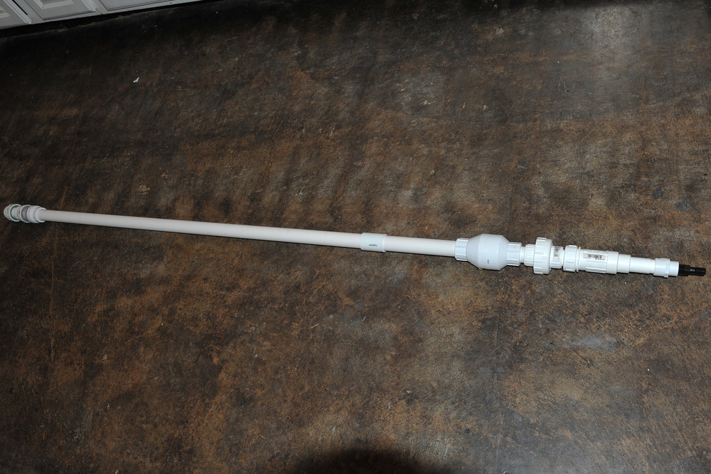

The length of the upper PVC tube that connect to the middle coupling and inline check valve is going to vary on ones height. I slowly trimmed this portion of the pipe until I got it at height that was visibly comparable to the reference photos:
So here is what I have so far. The upper staff needs some filling and detail fixing and the lower staff still needs some more tubing and boxing. But overall, I am happy with my start and that fact I can take it apart.

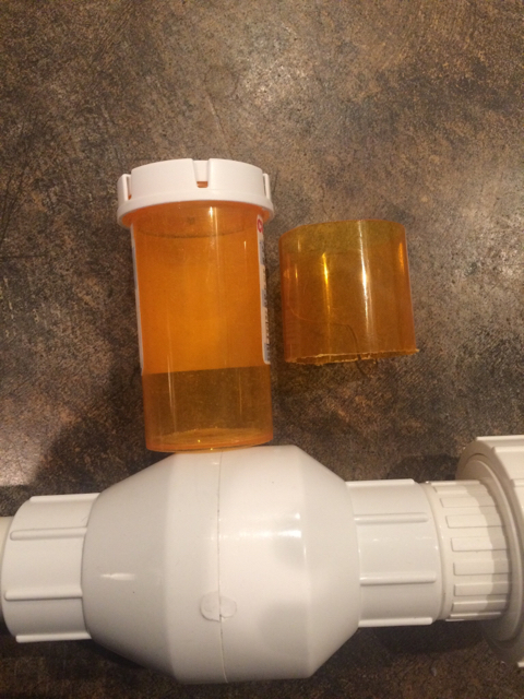

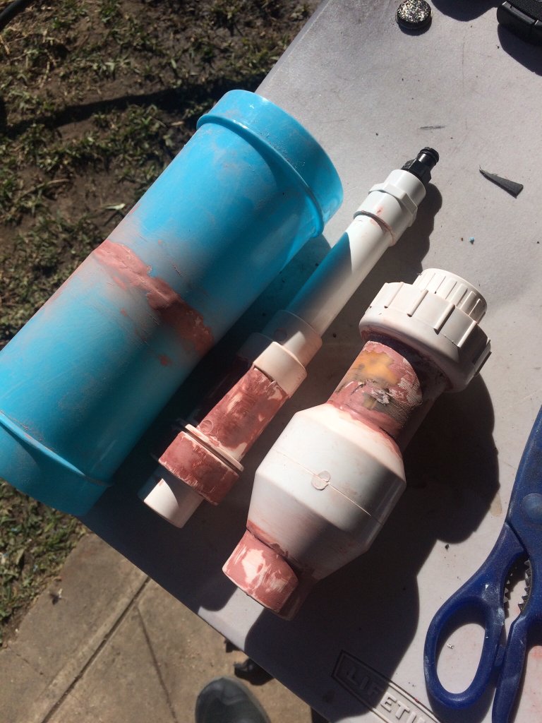

My build continued today with some clean up work by covering some unwanted seams using an old pill bottle and cutting it to fit over a gap and grinding down unwanted ribbing and lettering on the pvc.

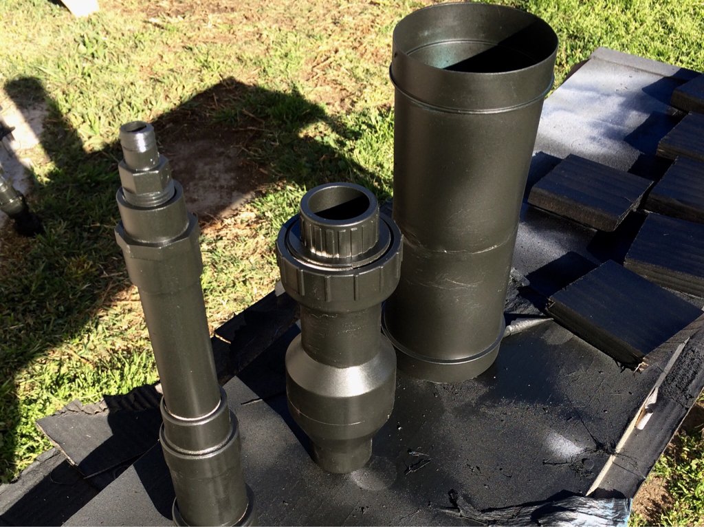

After sanding, spot filling areas and some more standing, here is what my pieces look like
I got a bit impatient and decided to give them a quick blast of black paint I had lying around and this is the out come.
And how it looks assembled side my side. I am happy so far with the progress and still going to add some more greeblies and clean up to make it a tad bit more accurate.
I think I am going to address the missing middle circular ribbing by using a bungee cord and some wrist bracelets to achieve that effect. We shall see

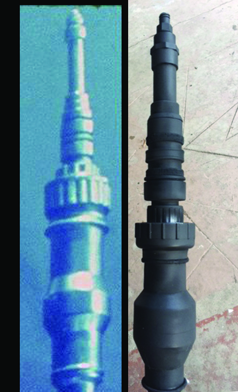

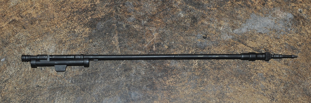

After doing some deeper research into the Boushh staff, it came to my attention that the tip of the staff is a C3P0 Leg Piston *mind blown*. But it really does not surprise me since nearly alot of parts are recycled to make others in the Star Wars Universe.
With that said. There was an option to buy a resin cast of this piston to be accurate. But I wanted to still keep this staff as a budget build. In order to get the added detail and bevels to replicate the leg piston. My wife offered me her hair bungees, ties and a few other item lying around the junk drawer. I just played around with the shapes, cut them to fit, found what I liked, glued them down and hit them with a primer coat of paint.
I am pretty satisfied with his look. Time to move onto the lower staff.

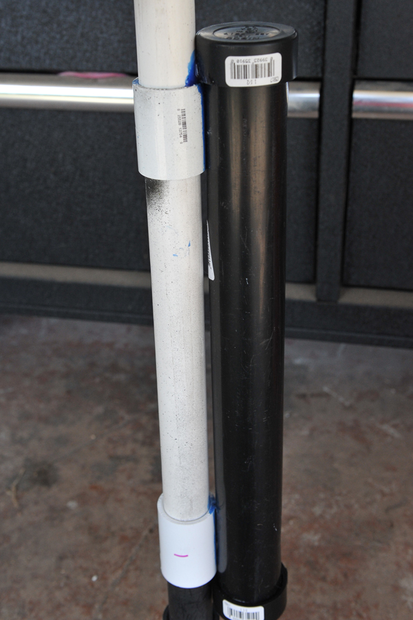

Hopefully, these parts will give me something resembling the bottom portion of Boushh's staff:

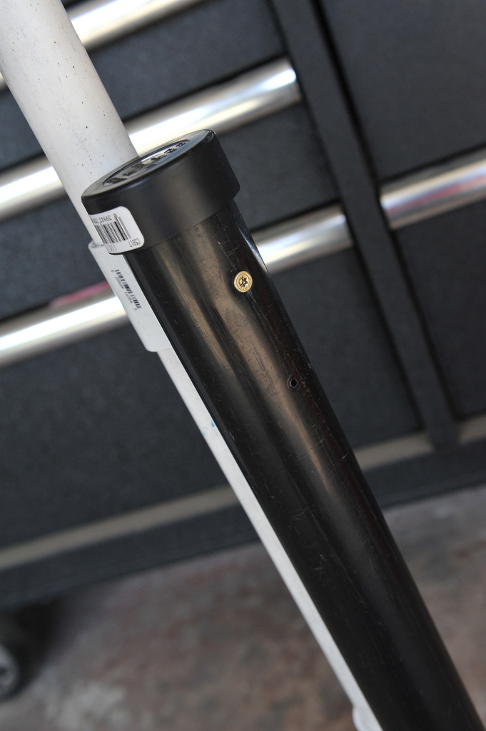

I started with making the thicker portion tube by grabbing 1.5 ABS Tubing with end caps. I cut it down to size and glued on the caps. I attached the tube to the bottom staff using pvc glue and 2 inch screws:
Next, was the smaller tube. For that I used the 3/4 inch pvc pipe, end cap, pvc lock inline, cut, glue and screwed into the 1.5 inch ABS tube.

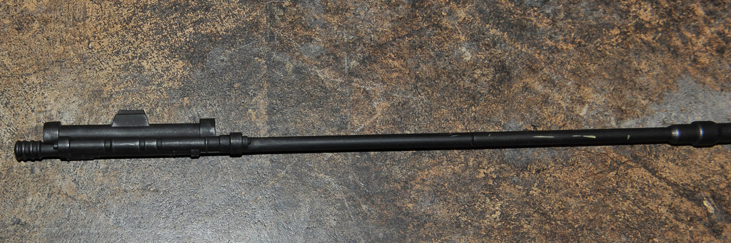

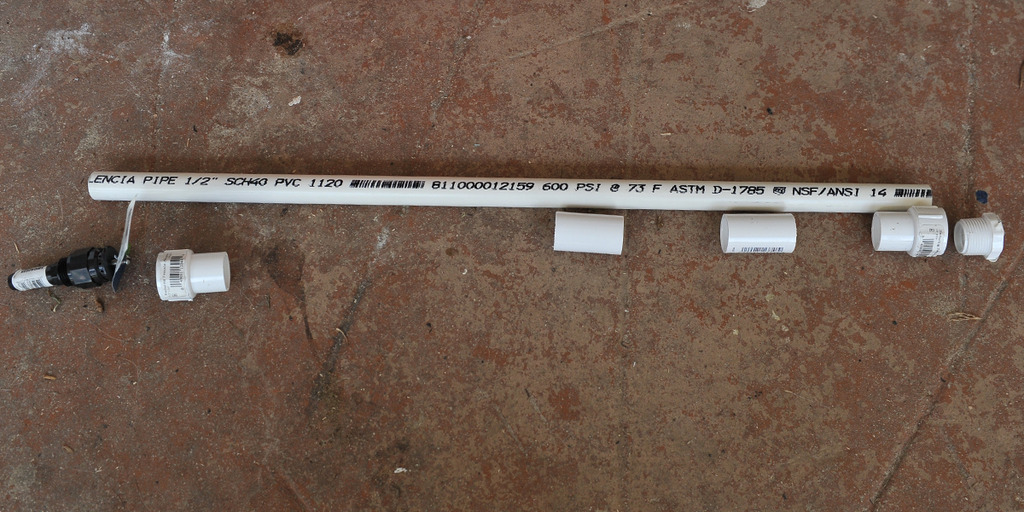

Lastly, for the thinner longer rod with attenna end, I went with using a sprinkler head with metal adjusting screw, 1/2 inch piping, couplings and a few reducing end caps. I used pvc glue and screws to attach this rod to the main staff.
I did a little filling of my mistake holes, some sanding and hit with a blast of primer paint:
I am missing a box like item one of the side tube, but overall for $64 of pvc piping material, I am extremely happy with the outcome so far. With this I will move forward with my final paint up.
