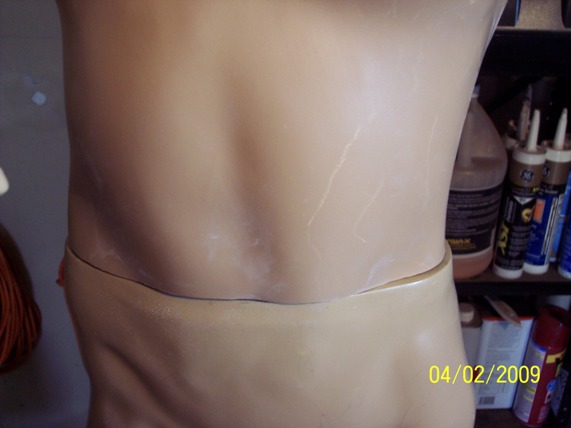

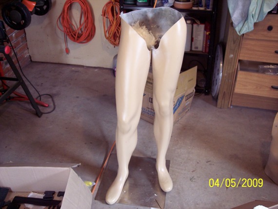

well, i first cut the torso to where i wanted it to match up with my height...i will fiberglass the torso to the legs eventually...
i then took MrG's advise on repositioning the right leg to give Boba a more "open" stance, and also to reposition the knob on the left calf to make the left leg stand more vertical...(y)

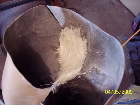

i cut the top of the legs off, and yes, i had to cut the groin area out as well to get the legs to position where i wanted them...:facepalm i will attempt to put that area back on later...(y) i show where i fiberglassed the right leg back onto the left leg...fiberglass cloth was also used with the 2 part epoxy...

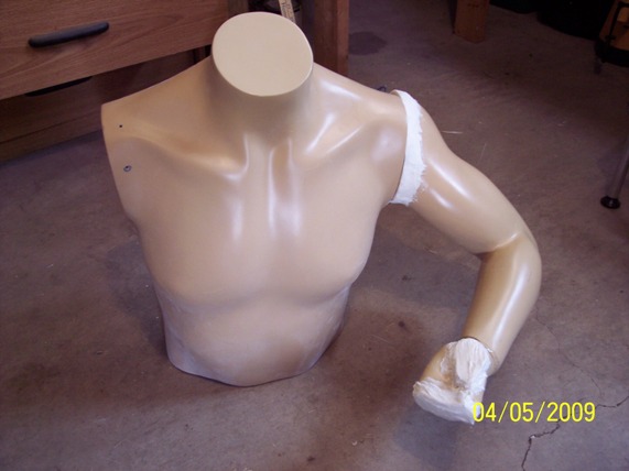

in this pic i show the left arm after cutting a wedge out that allows the arm and elbow to not stick out as far...i love my dremmel and Elmer's Fiberglass Repair Kit with the fiberglass cloth...works very well...i also kept the knob for the arm attachment and fiberglassed it to the arm where i cut also, so to allow the arms to be detachable...

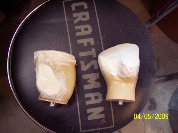

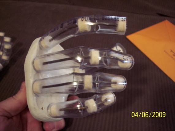

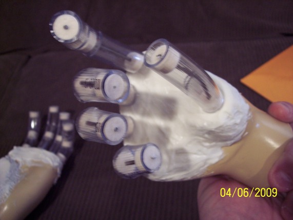

in this post i show how i did the hands...i first cut the fingers off, and then shoved some fiberglass cloth to help fill the inside so i didnt have to fill the whole hand with the epoxy resin...(y)

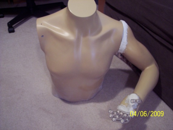

this next pic shows the left hand, where the barrell of the blaster will be resting...i drilled holes for the hanger wire, used as the base of the fingers, and it is also bendable...for the width of the fingers, i used 5/8" outer and 1/2" inner diameter plumbing tubing, and used MrG's method on giving the tubes some dexterity for bending them...the off-white circular pieces inside the tubing are Dremmel Cloth Polishing attachments, which just so happened to be 1/2" in width, so they perfectly fit inside the tubing, which allows the tubing to bend nicely with the hanger wire...(y)
this is the right hand in the next 2 pics, done the same as above...
left hand again...
and the left hand on the left arm attached to the torso...after attaching the knob back onto the arm, you will have to sand it down as to get that area flush to allow the knob to go into the torso...

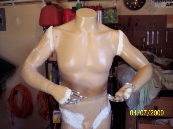

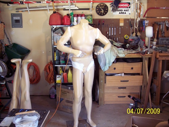

ok, got both arms on, with the hands as well...i also got the waist section partly fiberglassed onto the legs, to where i can put the torso on top to get a pic and an idea of how this pose is going to look...(y)
