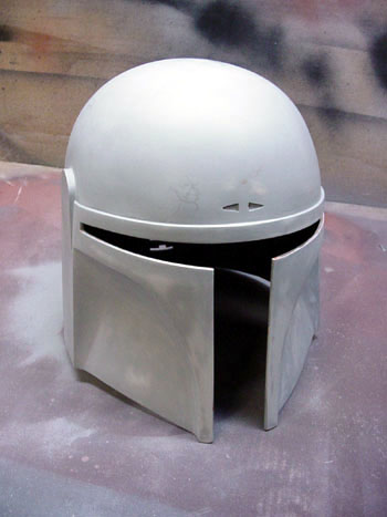

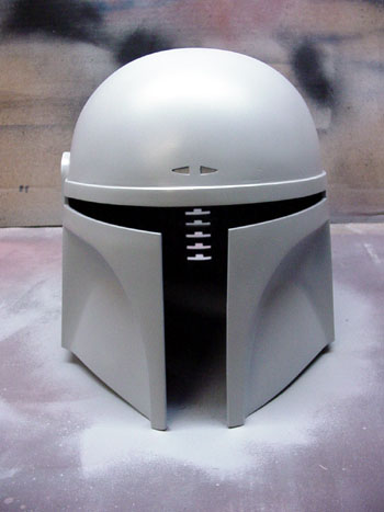

I thought I would start a new thread since my other one was sidetracked. I just want to chronicle the buildup & this is a good way to keep me on top of this project. Pic 1 shows the freshly dremmeled keyholes. Pic 2, the cut out visor, more wetsanding & spot filler. Pic 3, another coat of fresh primer. The left mandible warps in slightly beacause of the way it is sitting. This was square before I trimmed the fiberglass & I'll square it up again when I install the visor.

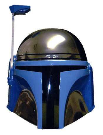

Well I haven't been able to work on my own bucket lately but Jonathan was kind enough to me this pic that I could use to show a finished helmet. This is #1 from the mold & the first one painted up. That is not real chrome but Alcad II paint. I am going to have to try this stuff out, looks fantastic!:thumbsup:
Wow! that looks great! I'm amazed that is paint. I'd like to know more about the Alcad II paint. Does it spray on like that or does it need to be polished and stuff? Is it easy to find/buy?
I can get it at my hobby store but I could see smaller stores not carrying it. You have to spray it over a black base coat & I think it gets buffed after. Maybe Jonathan will see this & chime in with his paint technique.

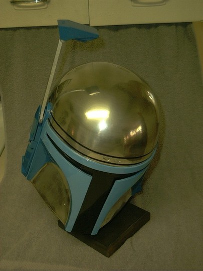

I just wanted to stop by and make comment and drop you all some pics of BKBTs amazing bucket! I must concur with SEEKER and Vince you'll just have to take a bow dude! This IS the definitive JANGO bucket ever on TDH IMHO!:thumbsup:
I too had to makes some adjustments ,but was not at all bothered by doing the work myself as most of us usually enjoy that to some degree! I wanted to share some thoughts and visuals of my buildup. hope thats cool Vince!
I dig this helmet for several reasons ,but the main one is that you can tell its from scratch and a high quality representation of Jango's bucket! Some have pointed out some discrepancies ,but once you hold one in your hands you come to realise that it is closer than you originally thought! (IMO of course!)
All the details are super Crisp and there are very few bubbles in BKBT's work! Best of all no seam line from the mold either! So clean up was very easy and quick!
The only draw back was a "small" warp in the left mandible and side! Once you cut the "T" out completely you'll begin to understand what I mean. Totally Fixable and not a problem once you install the Visor, but had me worried for just an instant!LOL
Once I had it all cut out and cleaned up my bondo to where I was pleased with it (yes I'm anal about my stuff too!LOL!!!TDH made me that way!:thumbsup: ) I primed it and painted the entire helmt Gloss Black! I then went in and masked and painted all the Blues!Once I was done with this, Off to the Auto detailer it went to be Clear coated! It was almost ashame(not really!LOL) to drop the chrome on it as it was as Glossy as my ROTJ Vader!
Took 20 minutes to mask the Blue areas and another 10 to drop on the Alclad and off to the dryer it went! Automotive pinstripes applied too!;)
Today I installed the visor (I fixed the Warp!)and began the weathering process to step 1!
I took a clean piece of red scotchbrite and lightly started to put swirles and etching in the chrome to simulate brushed metal! It turned out sweet real quick! and am about to begin the acrylic weathering step 2! More pics to come! For those of you who asked:
Here the info on the Alclad II:
While most members here use the "rub-n-buff" products, I was just not all that happy with the results I've had ,but this doesnt mean it does'nt work thats forsure! Seeker and Mirax both have extremely good presentation with theirs to just name a couple! Alclad gives me exactly what I expect though and I can work it to my advantage! Heres how:
1) Whatever your spraying this stuff onto (Airbrush or can!) it must be a high gloss BLACK finish to achieve the chromed appearance!
2) Spray this on in thin coats! It will go through the gun fast and to do a full helmt you will require a bottle and maybe a half!
3) Let dry for 10 minutes and wipe off overspray and allow to finish drying 24 hours before handling!
Now handling is a different story in its raw chrome state! Like real chrome, finger prints do take ,but with with alClad and any good paint our oily hands will damage the finish and upon use after use will look like worn metal!
Handle the bucket gently for the first few days OR you can opt to topcoat the alclad as well,but expect some of the reflectiveness to die down some!
Alclad makes many finishes!
ie: Chrome, Polished alluminum, steel, titanium, Stainless steel,etc!
I choose chrome becuase I weather it afterwards with some scotchbrite and acrylics/water!;)pics coming!

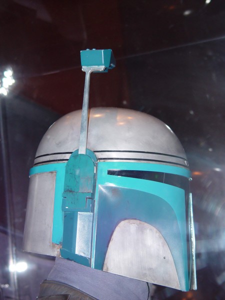

PPS: when watching movie footage of Jango in action I have always believed the top pinstripe from what i have seen...
is one continuous piece running over the top of the ear-piece rather than into it?...
It seems nearly all Jango's on TDH that I've looked at run the top pinstripe into the ear piece just like the bottom one...
Has anyone else ever thought/noticed this?...

As for your mention of the Jangos on AOTC!
Here is a pic of the real deal and it shows the pin stripes as they run into the earpiece! There are 4 or so stunt helmets throughout the movie that were used for alot of the action scenes which may have this detail your talking about ,but I've never noticed it before and thought I'd share the pic!

Ok, Jonathan has the paint covered, so I'll try to fill in the gaps when I get time. I have had a few questions about cutting the visor & keyholes. First, make some pencil lines to trim to. The visor is fairly deeply recessed so you should trim it so its sits only 1/8" back. Use a dremmel tool & a fiber reinforced cutoff wheel to do the cutting. The thin wheel will just explode & send shards flying everywhere so don't use that. Trim close to your lines & finish off with a file & sandpaper to make it smooth. The keyholes can again be cut with a dremmel tool & a spiral bit. Again, just get close to the edge & finish off with some small jeweller's files. I'll post some pics of the tools later & if anyone has some in progress shots of this procedure, feel free to post them.
