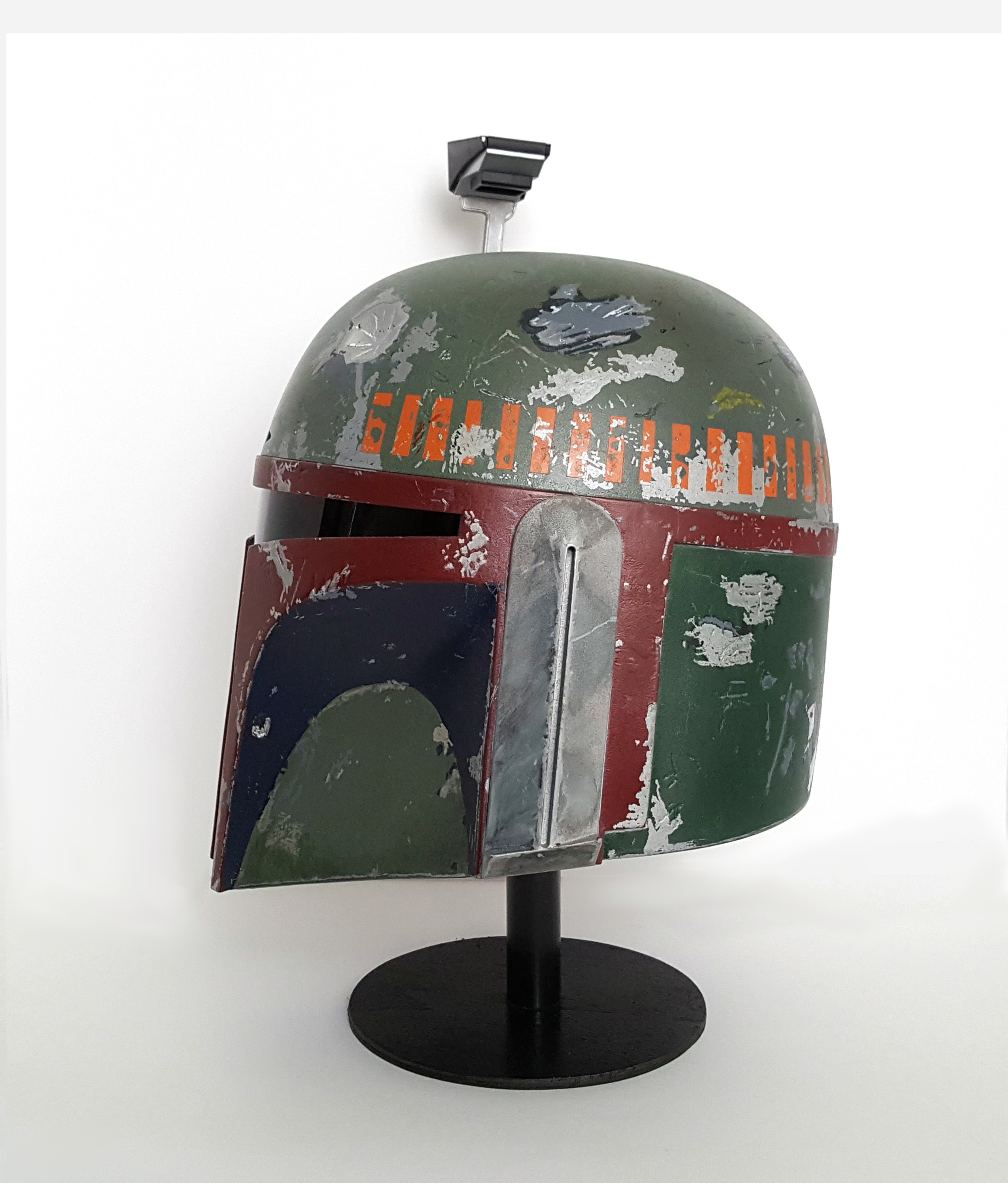

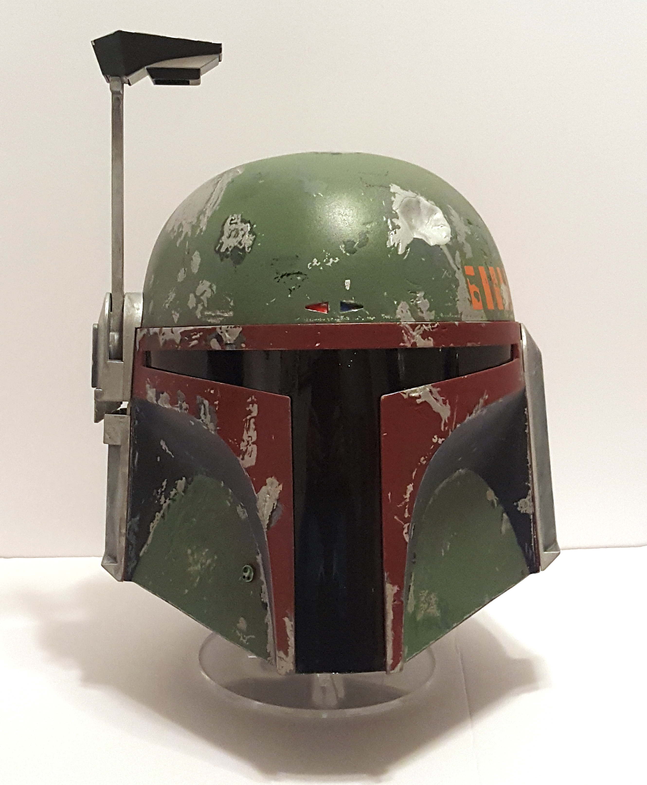

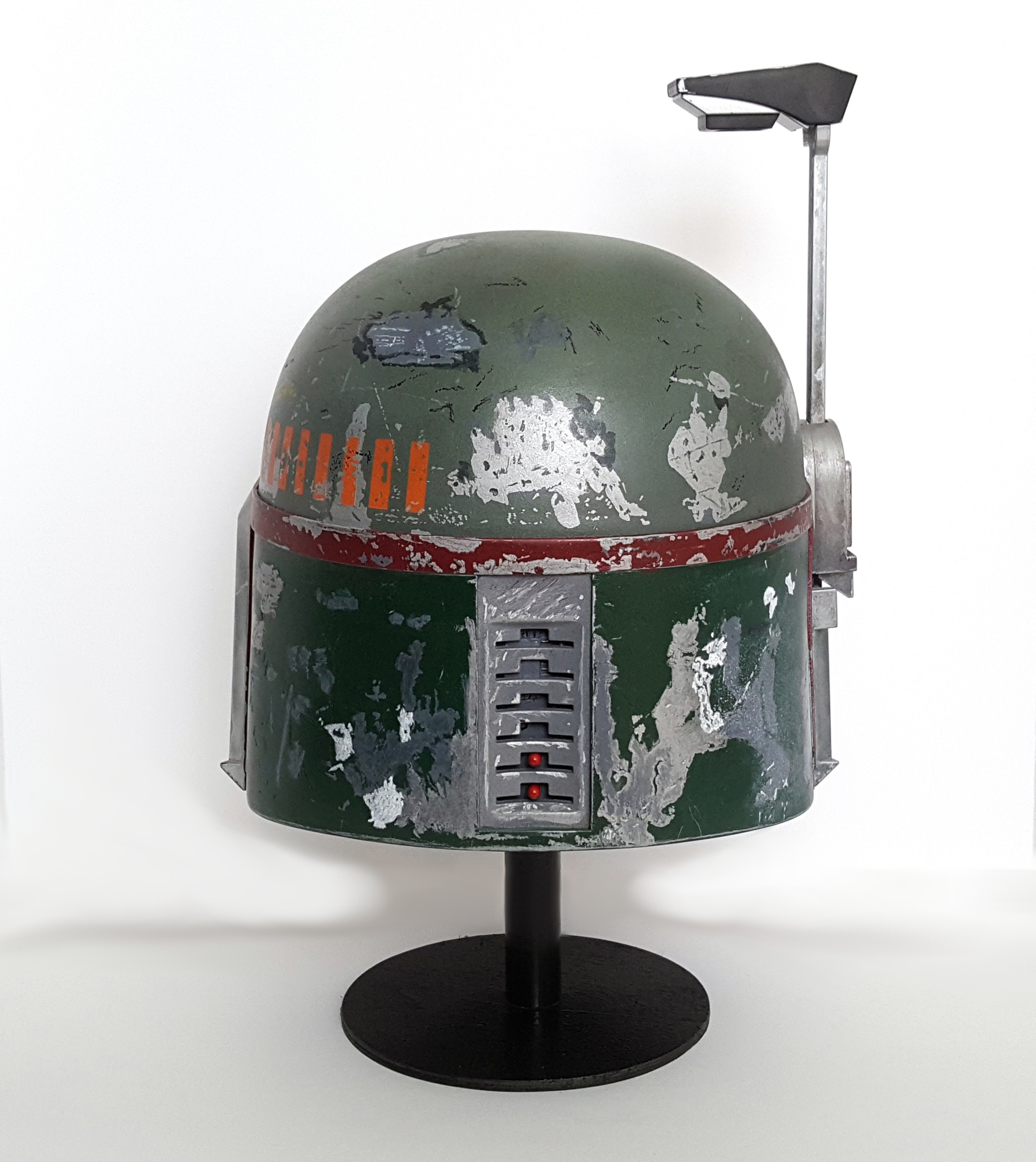

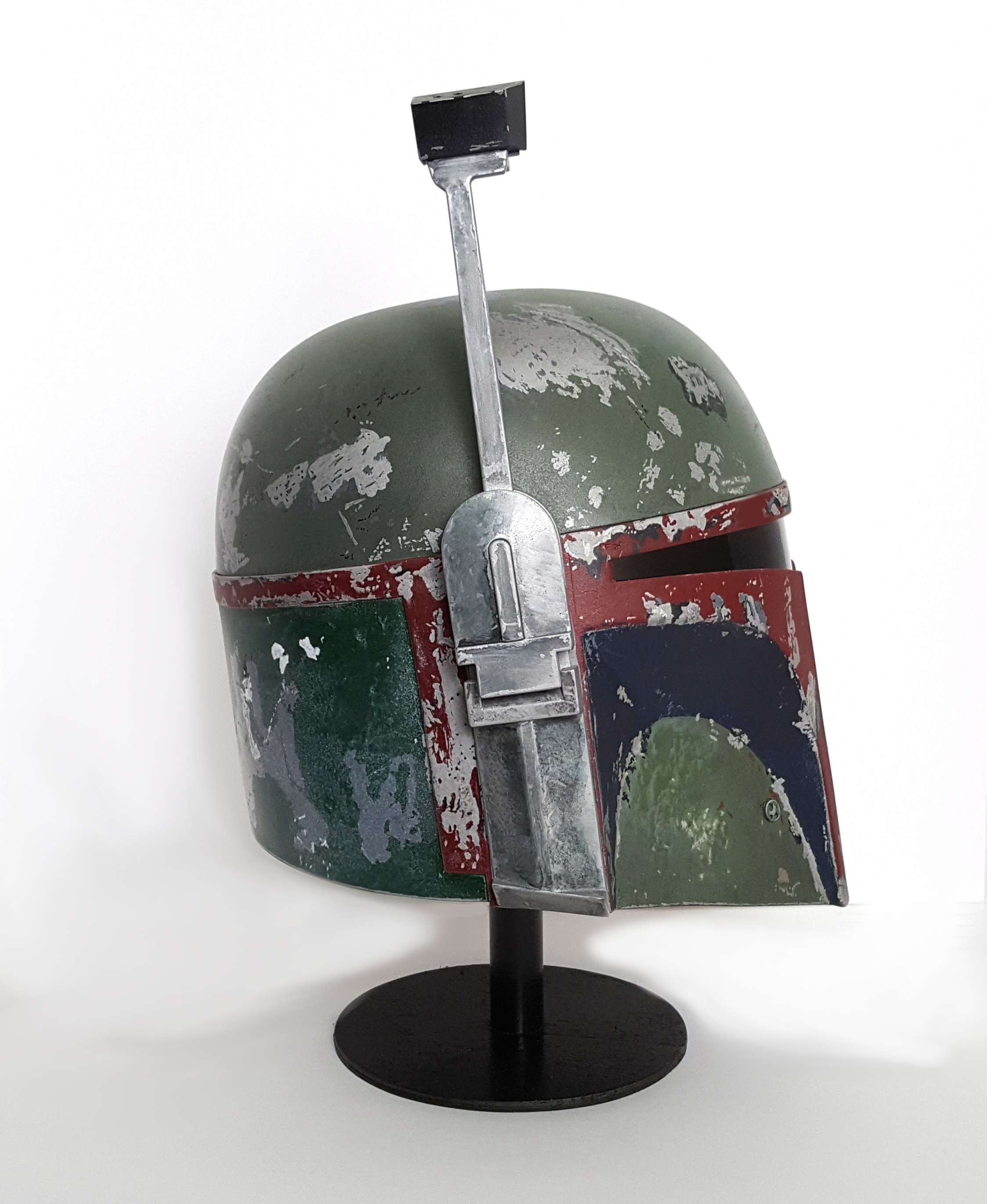

I am thinking about adding one more step to my ROTJ Hasbro Black Series conversion, and it occurred to me I've heard of people doing a kind of a "wash" to even out and slightly dull down the helmet to give it a worn look.
What is your best technique for this?
