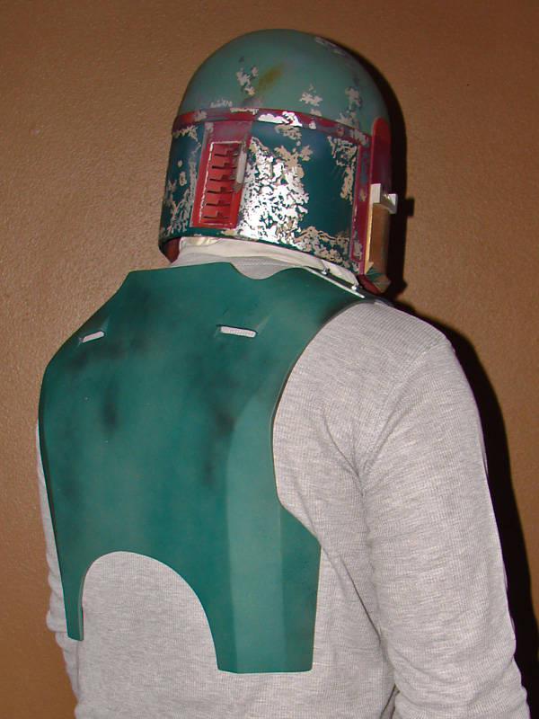

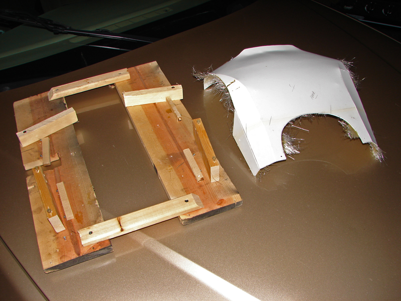

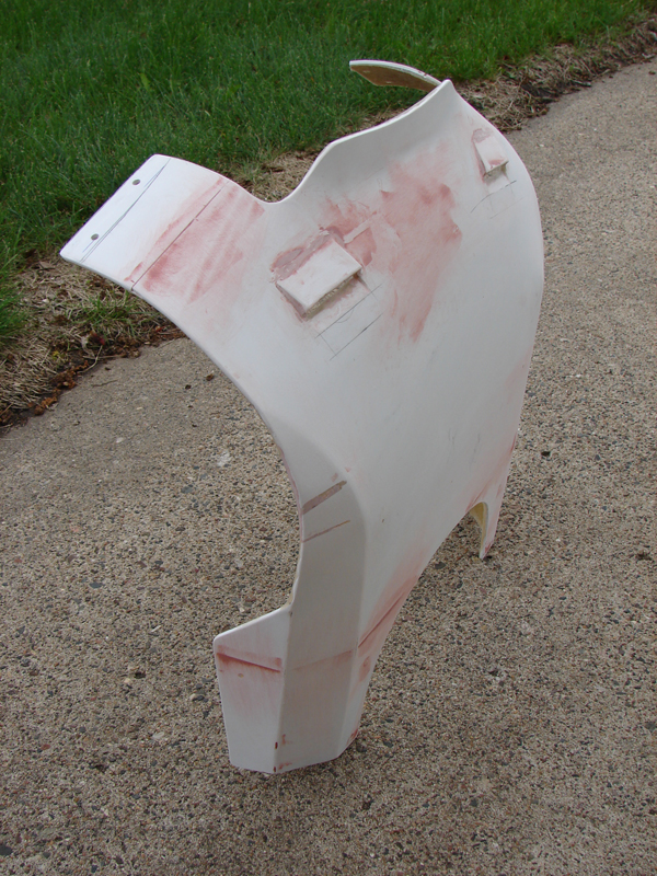

I used Rafal Fett's template. I had some nice sized, scrap, 3/32 of an inch thick styrene sheet I bought for little or nothing from a sign shop, but I had to join two pieces together. I used a wood burning tool to score the lines and make those bends. For the shoulders, I simply used a blow dryer. I then build a jig from scrap wood, screwed it down, and added shims and more heat to get the shape comfortable. I partially fiber glassed the inside, avoiding all the screws. When it was cured, I removed the screws and added the final fiberglass layer. It did not bond as well as expected, so I shot in super glue along the edges. It needed a little Bondo asd glazing putty. WOF's template in at least to inches longer and 2 inches wider at the bottom. I think Rafal Fett's is more accurateI will update as I go.Thanks Rafal Fett. The helmet is based on his templates too.

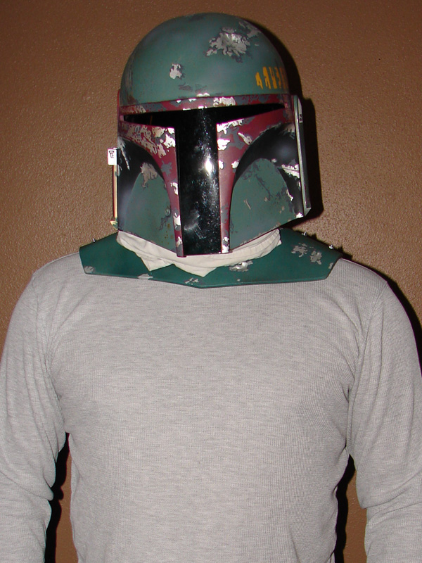

I understand! Could you post some images of a quick test fit with the back and collar plates?

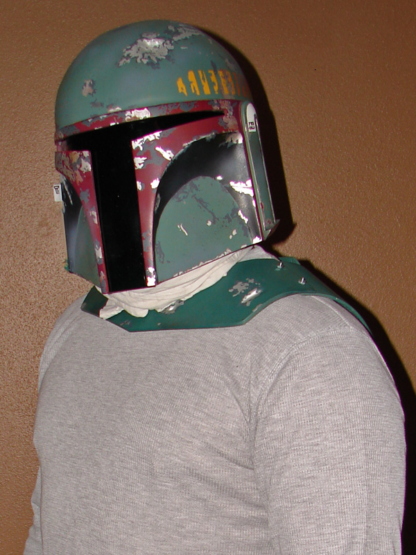

Thanks Jones. Rafal Fett, here is the requested test fit. I may have to make a more roomy collar. It was digging into my wind pipe. I wear a "boys husky" size. The shirt and neck seal are not part of my Boba Fett.
I have a similar body type to you had the same issue around the neck. Im pretty sure I used Rafal's templates also. I solved this by raising the position of the back armour just a bit and arching the shoulder tabs a little more forward. It raised the two vents a little higher but I have yet to cut those out so I can just reposition them later when I complete my jetpack. I know it might be redundant me saying this since you have already painted it. But anyway...I like your progress.
Well, it looks like I imagined: the collar is in the correct place, but the back plate is hanging too low, and this is the result of the 'extra' flaps added by you. The back plate neck area must sit above and not below the collar plate:

You might try to reshape the back plate shoulder flaps to their original form, but being this a risky step, it totally depends on you.
Rafal Fett:
I don't doubt you expertise and brilliant work. I may have some of the various curves off, but as I was shaping the back plate, I had to lower it, otherwise it was digging into the back of my neck. I actually added two extra inches to the tabs. I have a bigger build than a young Jeremy Bulloch. It may need some work, but am happy with it. Thank you again for sharing your templates.
