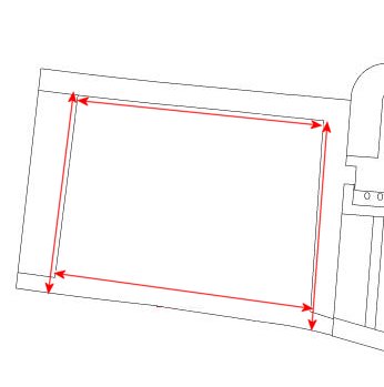

You might send me in PM the exact measurements of each side of the back plates and I will try to tweak it for you; I already did this for Hobbit's bobamaker helmet.
Remember to do the same measurements for the left side too.

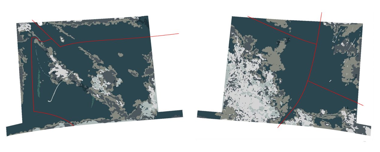

Here are the modified stencils (with color separation too) for the back plate area:
View attachment ESB Back Plates (Asok CC) A4.zip
Although the left side is almost a perfect fit, the right side is a bit off and you will need to cut the stencil in 2-3 pieces, like this:
If there are other problems, just let me know.
Have fun!

Thanks a lot! Remember that these files are in A4 format and you'll have an 1:1 result if you print it with the 'fit to page' option. If you use the US Letter format, you will have a different printing result; if that's the case, let me know and I will do a Letter format too.

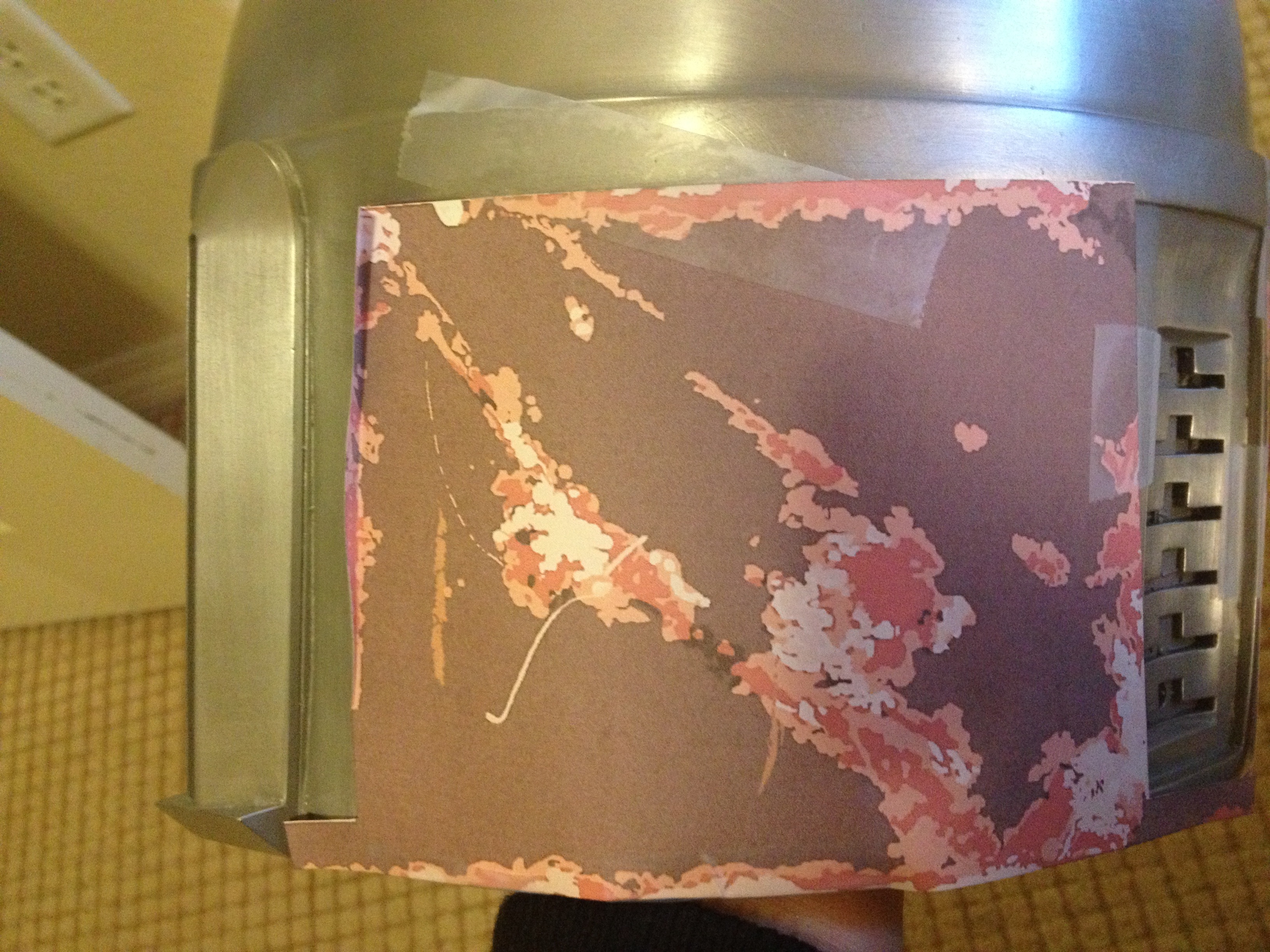

Raf, as per our discussion here is a pic of the template against the Asok CC.
I lined it up against the bottom for the pic. Please excuse the template color. Im out of color ink.

i was asking about that for fp's mr premium helmet sometime in 2011. i ended up stretching and skewing and free transforming the templates in photoshop, and by trial and error i eventually found the right size
