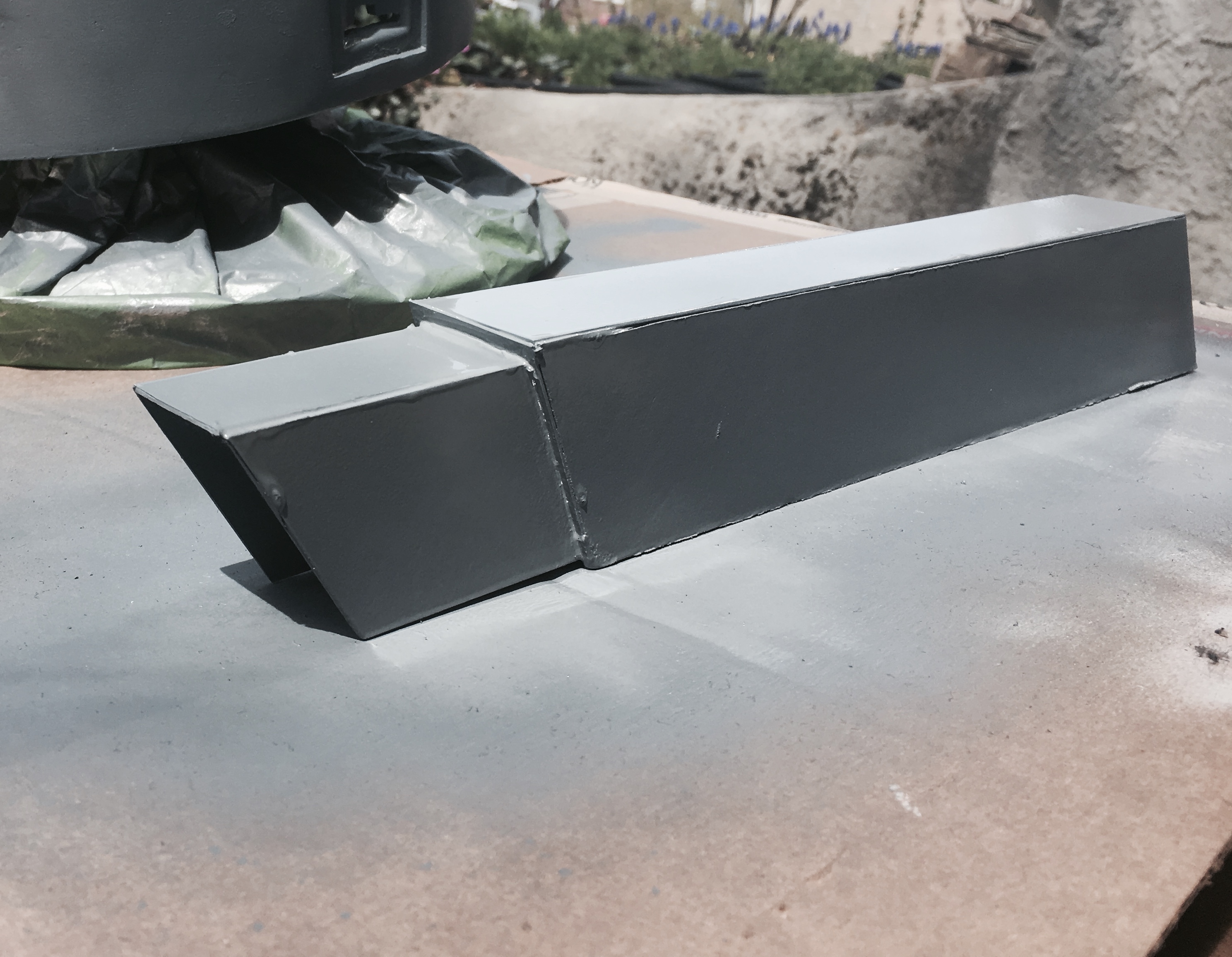

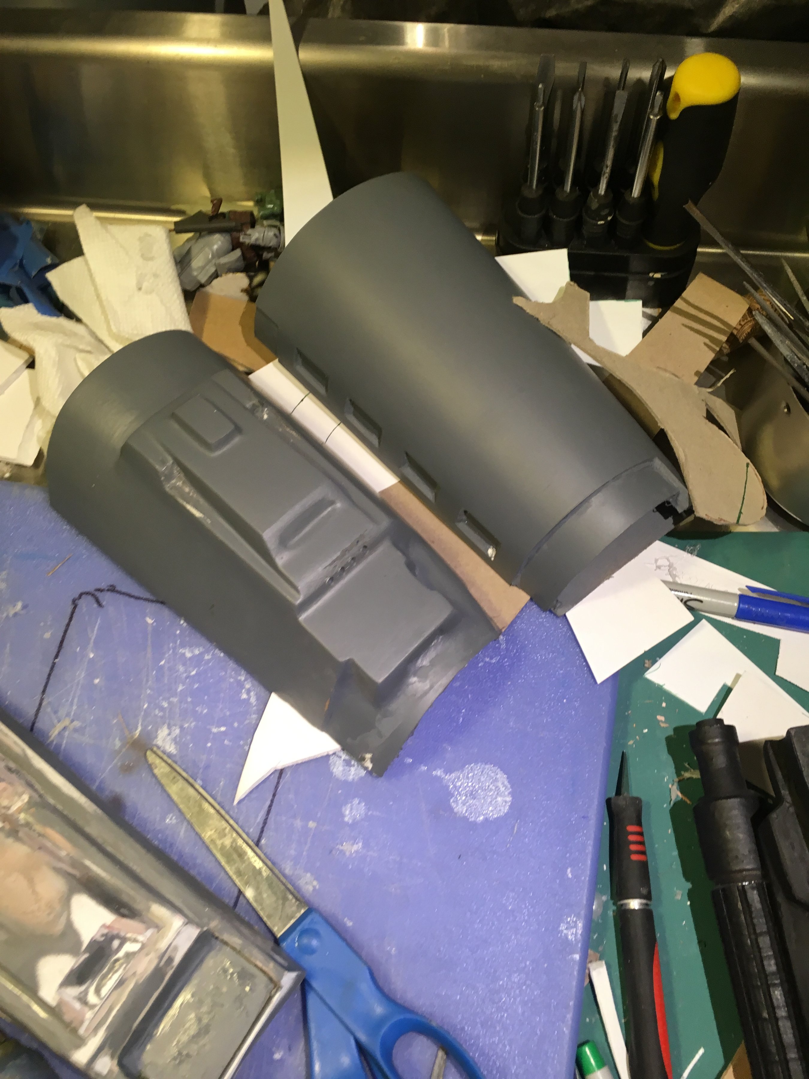

More progress photos!

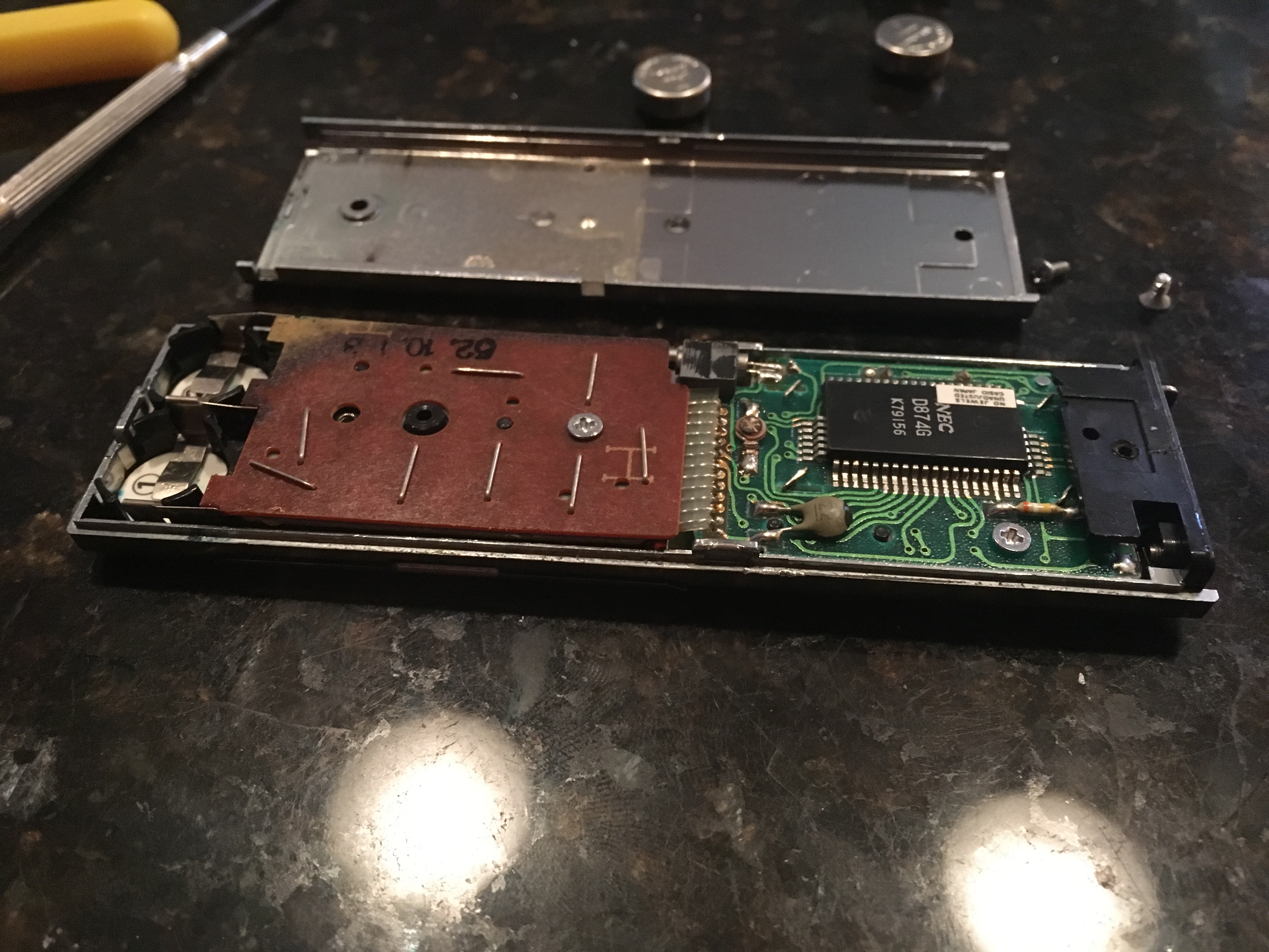

I managed to snag a Casio MQ-1 for this project! The trick to opening it up after unscrewing lies in this little plastic latch which basically just needs to be forced. No damage thankfully.
Here's the circuit-board used in the keyslots behind the helmet.

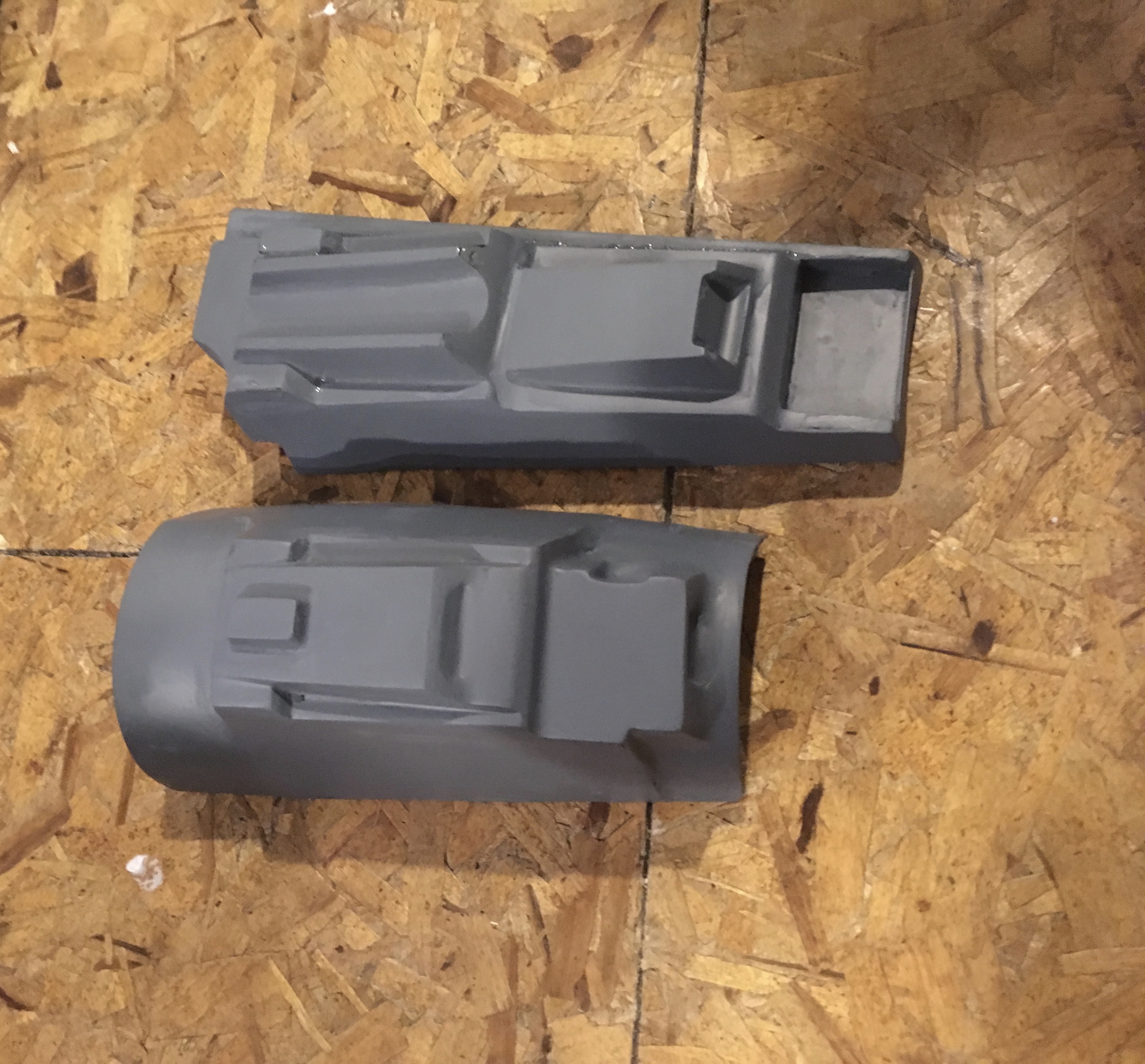

A comparison between the RafalFett 3D model of the keypad (from Shapeways) and the real deal.

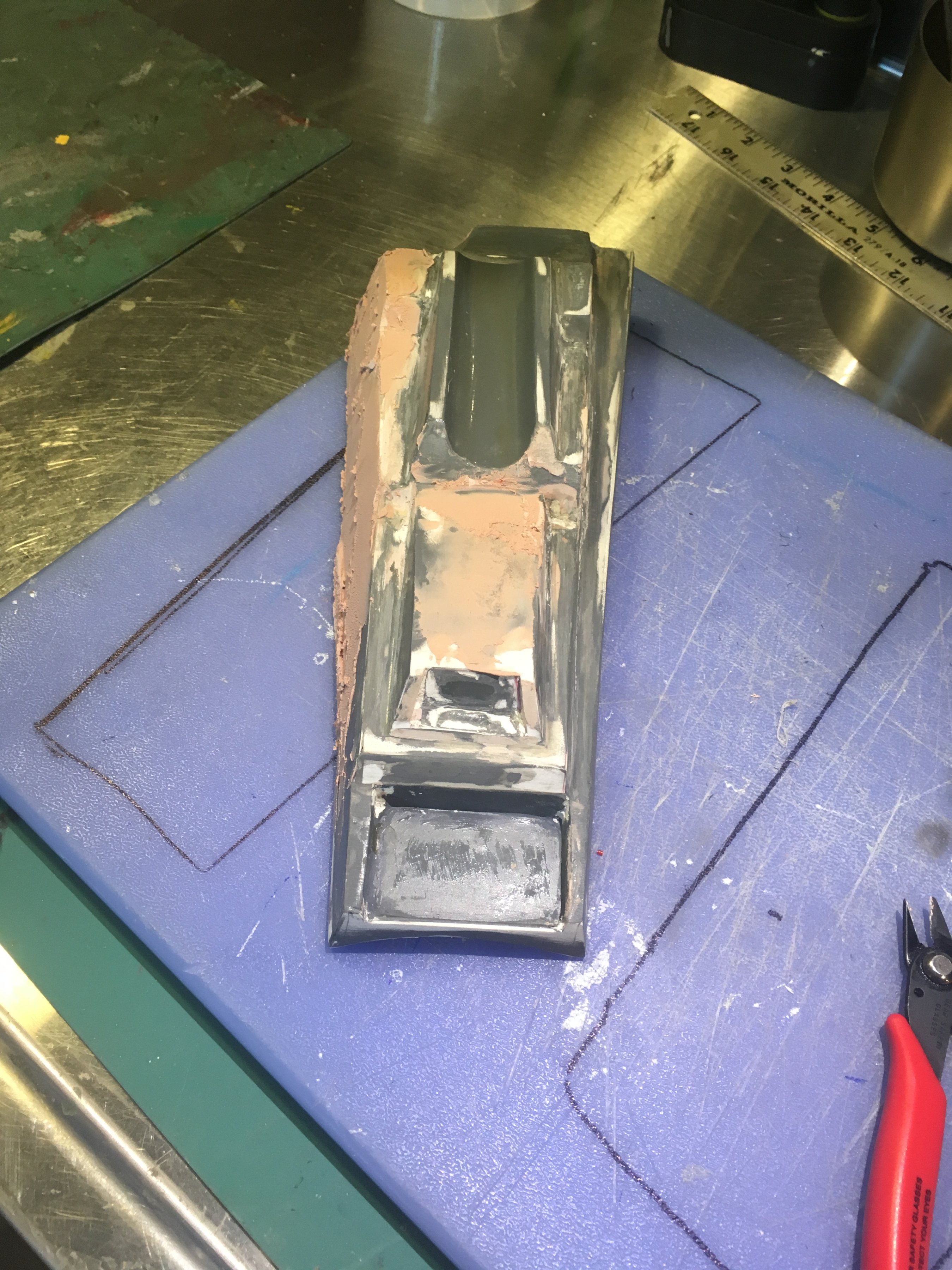

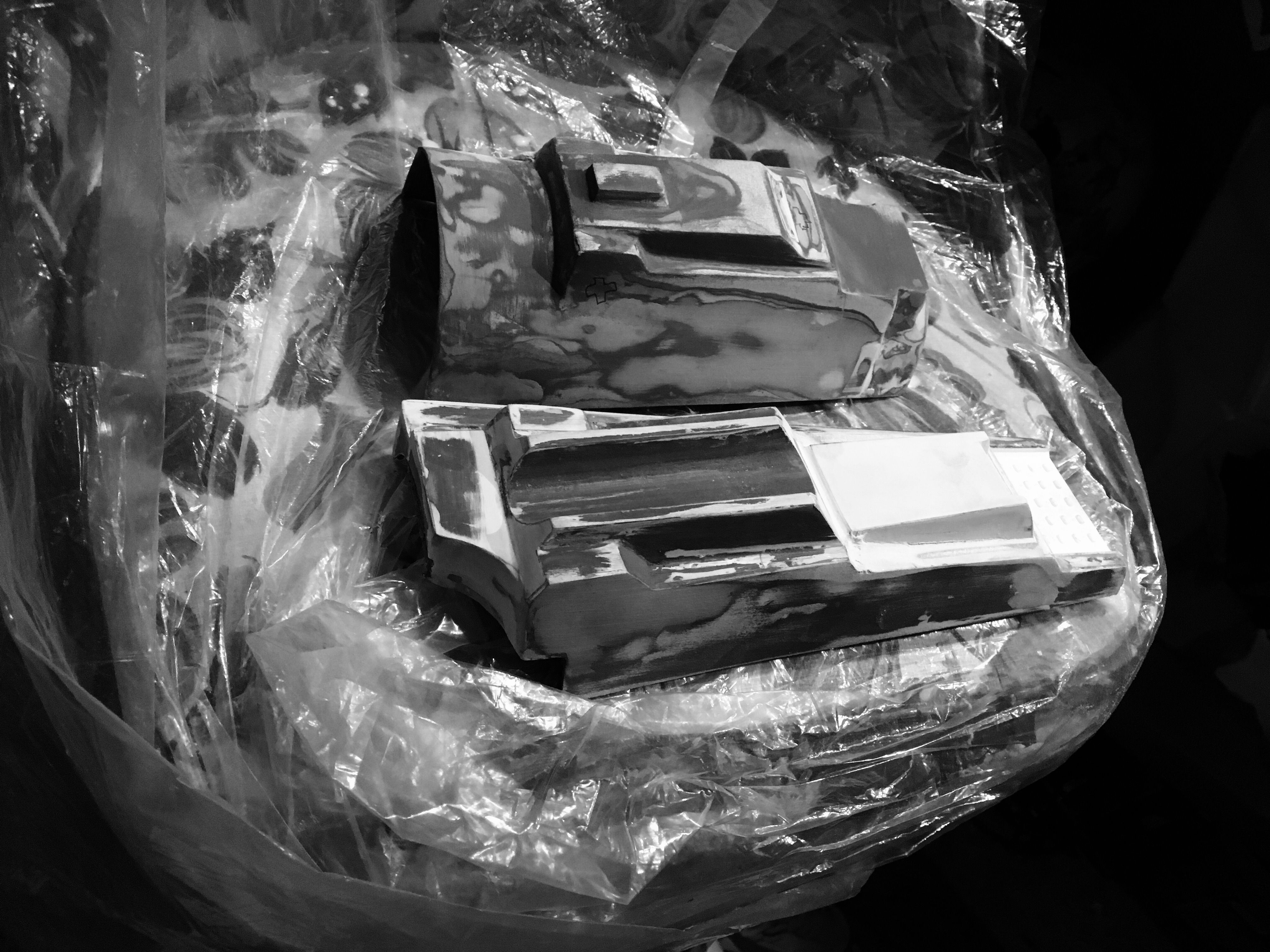

Mold making commenced and I soon had casts of both the MQ-1's face and the battery cover, which I'll be using on the left gauntlet master.

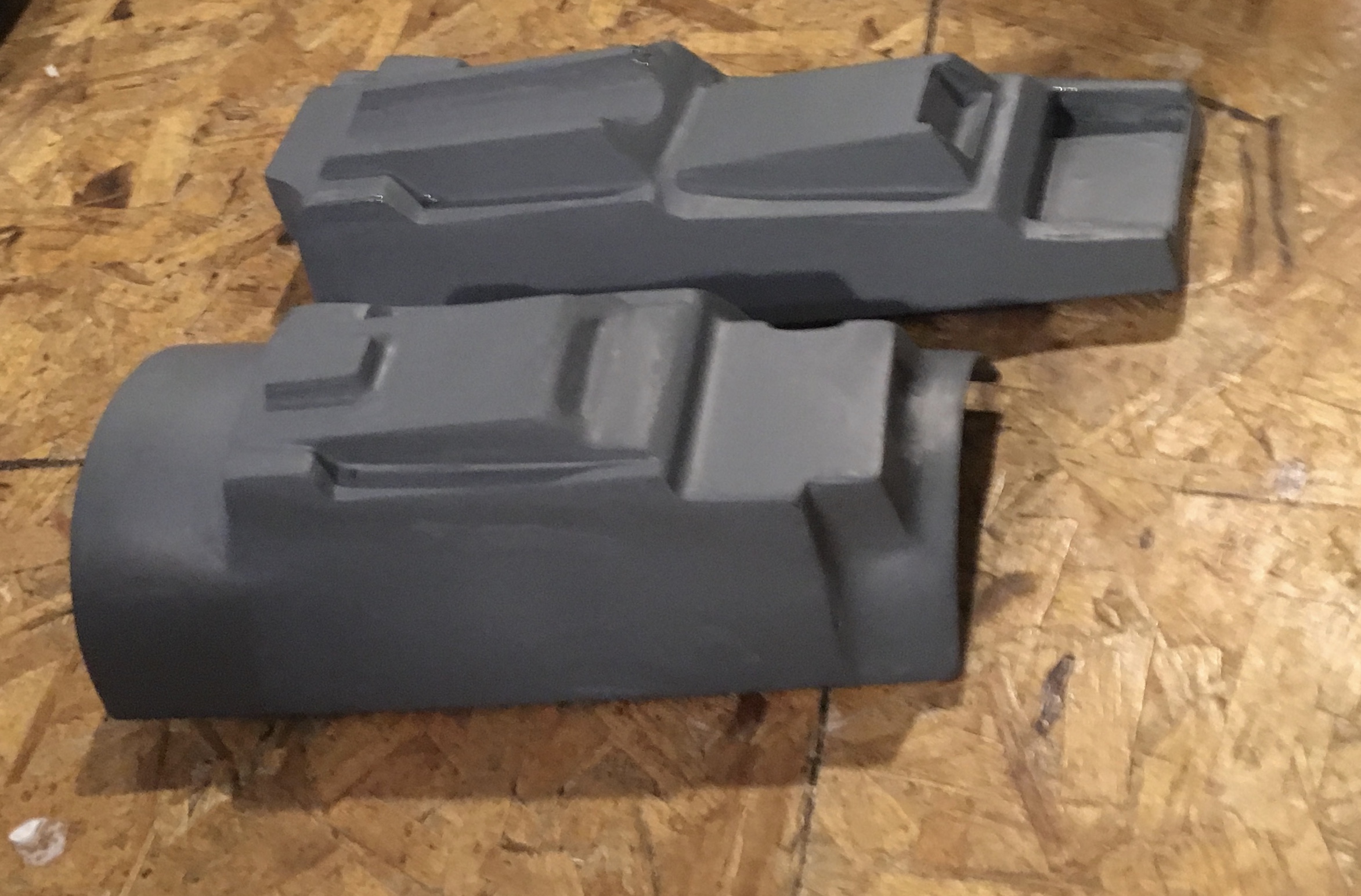

Looking great as everyone else has already stated! My only thing is this: are you going to turn this into a plug for a fiberglass mold, or a master for a silicone mold? Also what are you going to cast them in? This is a good time to get an idea of what your next step will be:)
Hey there! I'm planning to do a silicone mold, but do you mind explaining what the benefits of doing a fiberglass mold might be?
I only suggested it because this isn't an extremely inticate mold. Your best bet would still be the silicone mold just because of the small recessed areas at the front (the whole for the led, etc.). But I make fiberglass molds when I cast parts for motorcycles such as seats or covers for a hot surface. It's good for making carbon fiber parts, which I doubt you'll make carbon fiber gauntlets but HEY! You never know right?;)

Here ya go! Stuff isn't finished but it's getting close. I plan to offer these as either fully finished armor pieces or kits, but the material will be resin reinforced with fiberglass since I don't have a vacuforming table, as yet.

I think I've been trying to build these things using the wrong medium.
Honestly man I just go with what I have and what will deal with the beating. Cardboard and a mixture of sintra and styrene seems to be working for me, but I tried just styrene once and it failed miserably structurally.
