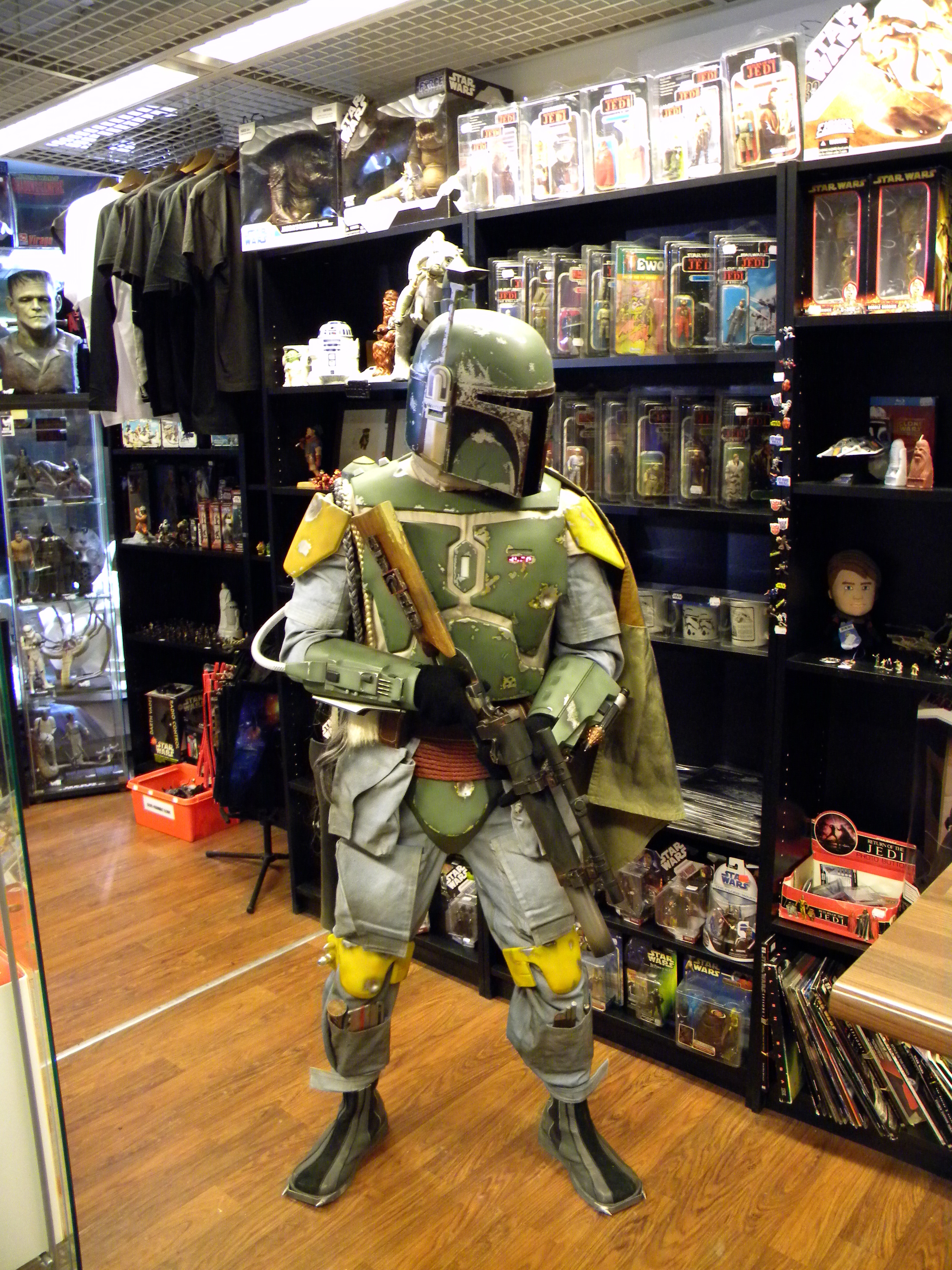

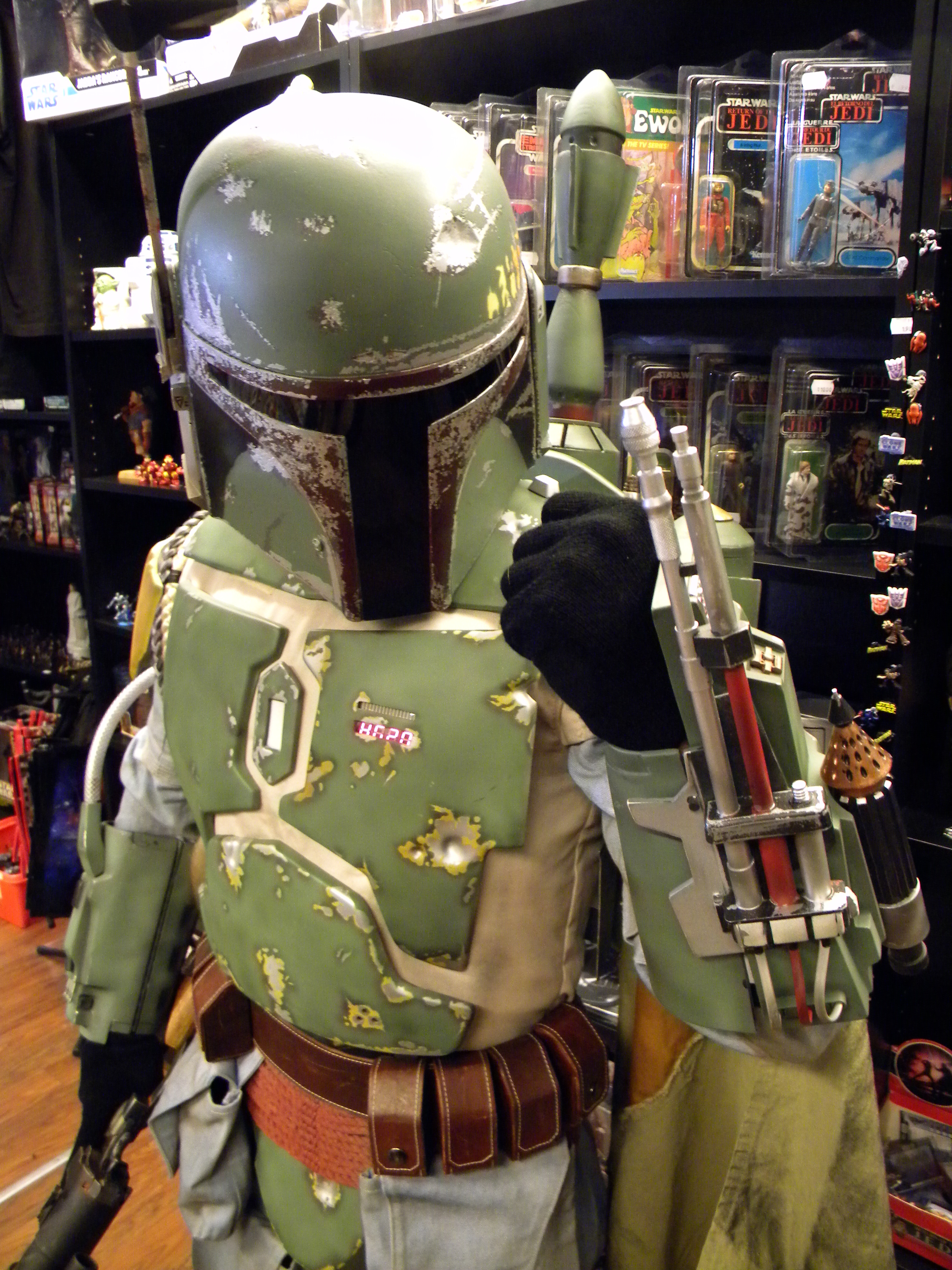

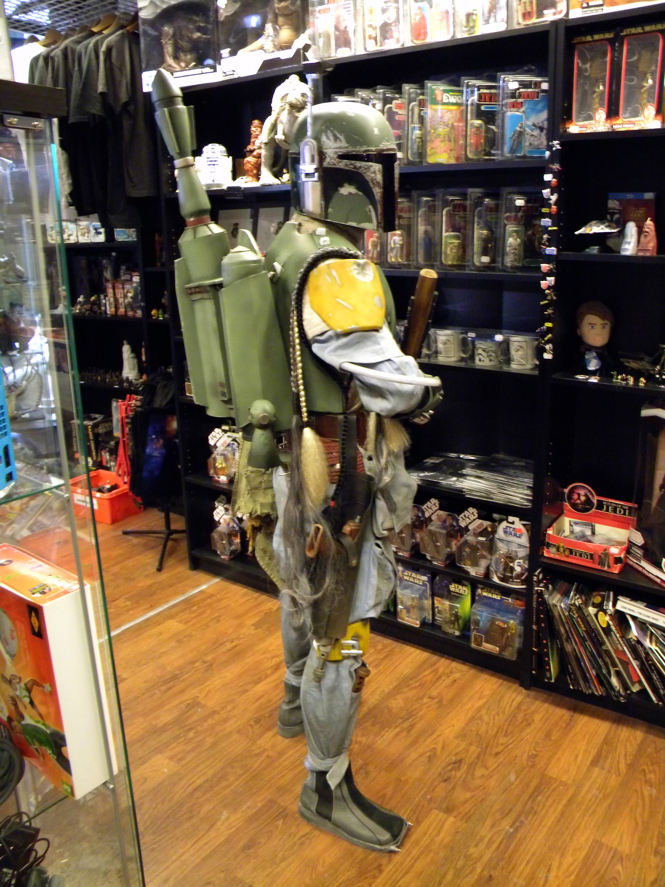

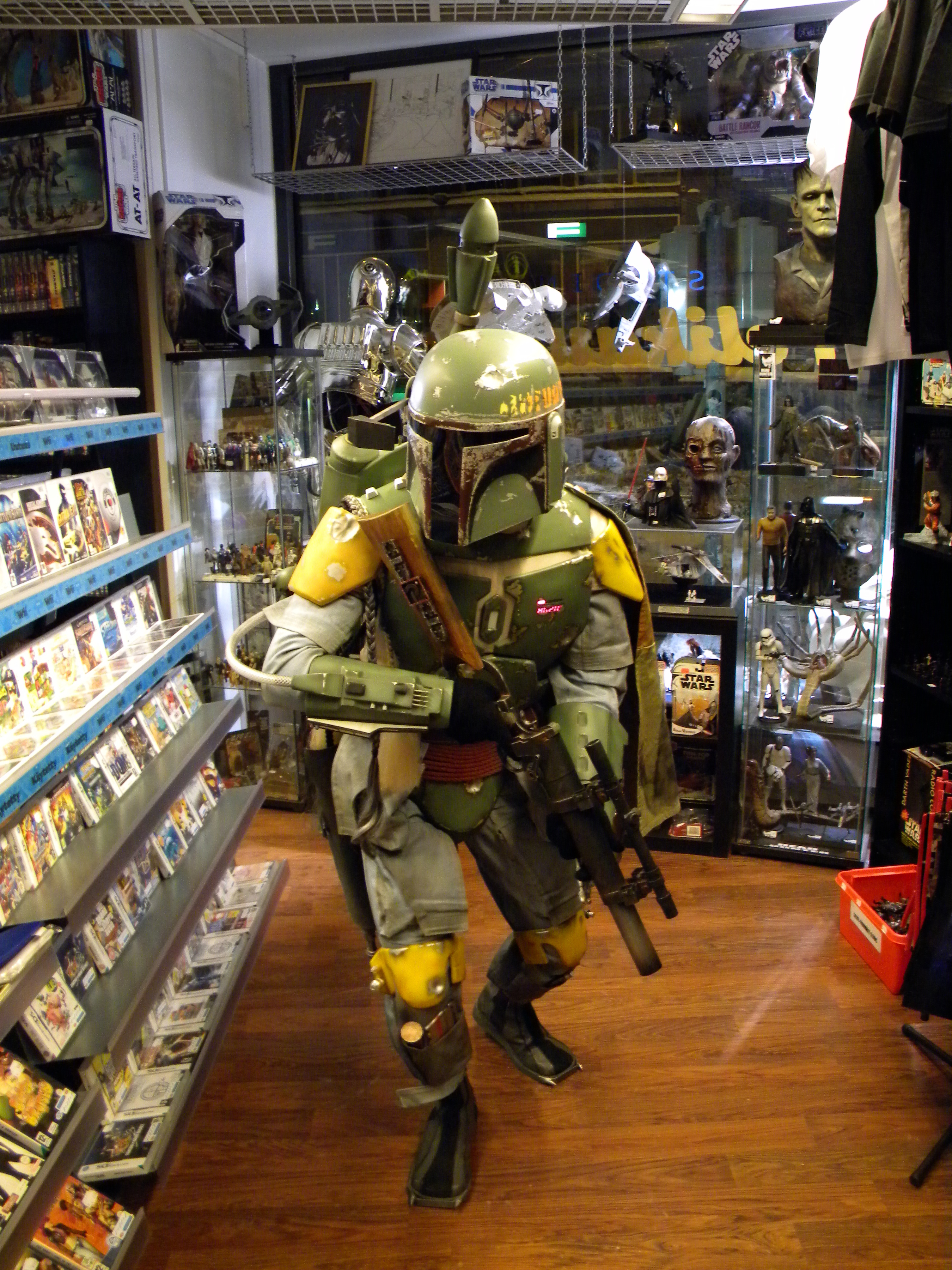

While waiting for rest of the packages to arrive, I made some small adjustments and tweaks all over the suit to improve accuracy and fitting.

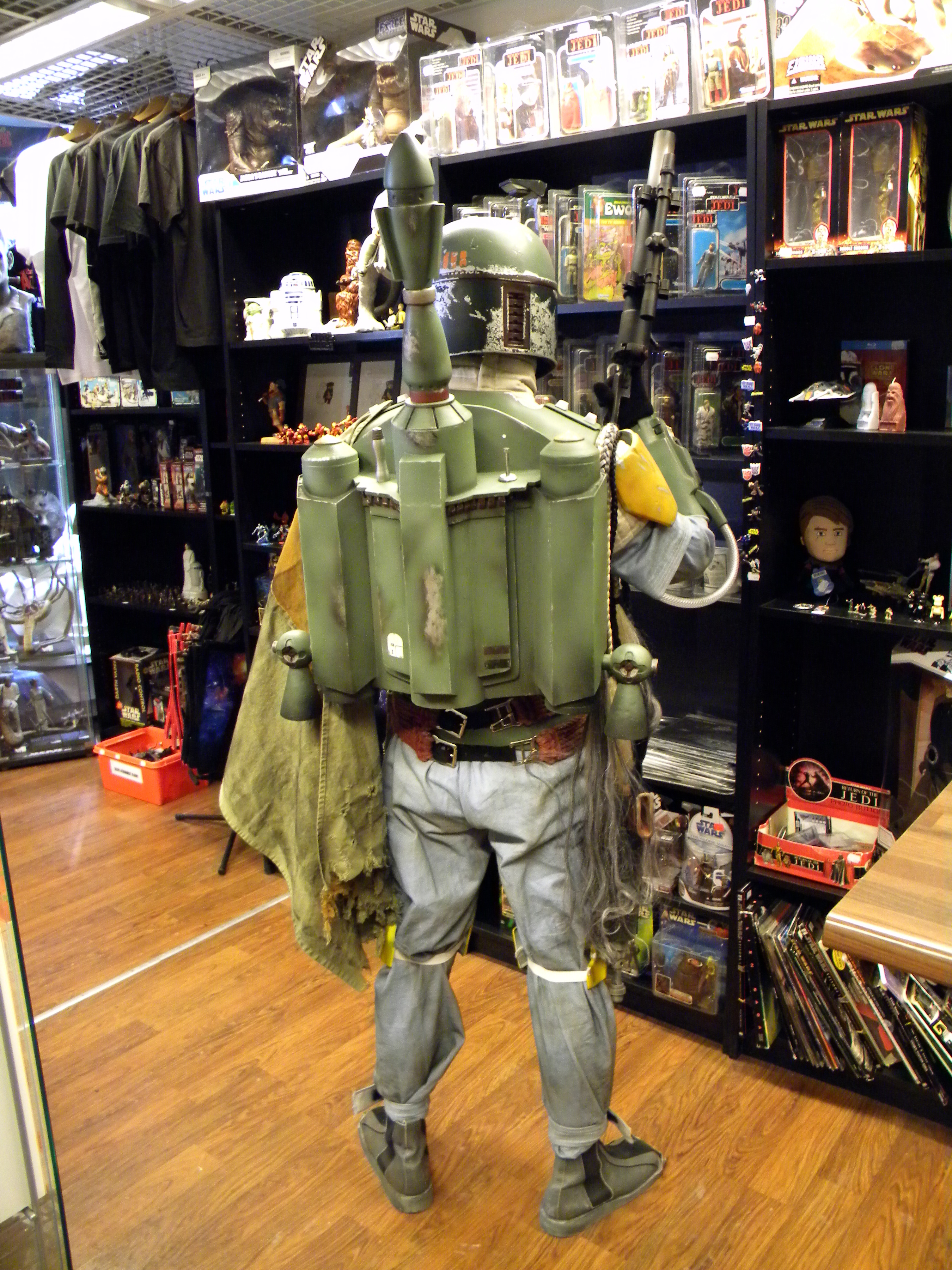

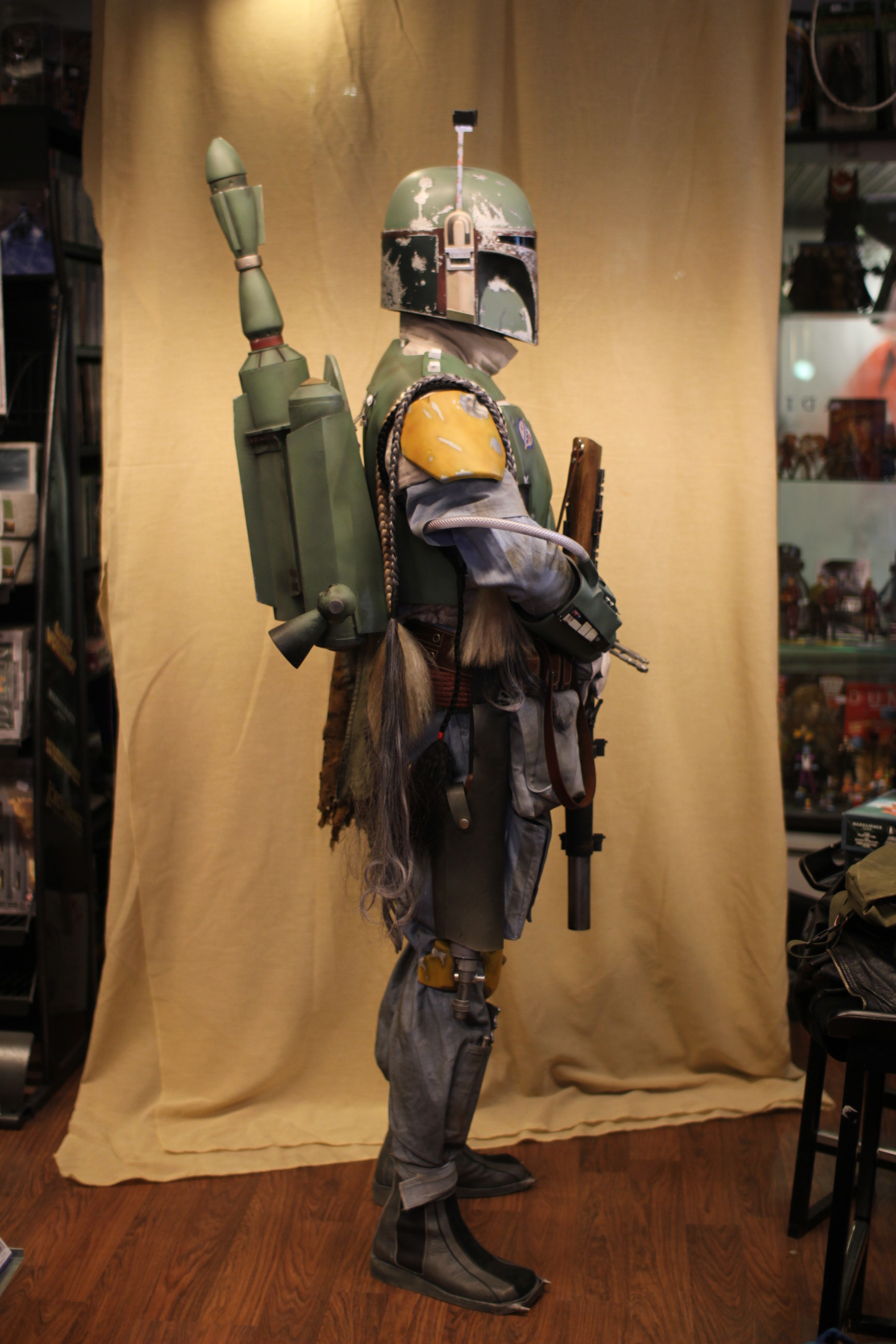

I installed the steel jetpack hooks to the jetpack and made a backup stiching to the harness system. If the jetpack is to fall off then it won't be because of the hooks because those things are sturdy! Harness also carries the weight of the pack PERFECTLY, it doesn't put uncomfortable pressure on the torso and it's almost as if it wasn't even there. Outstanding work made by BFUK.

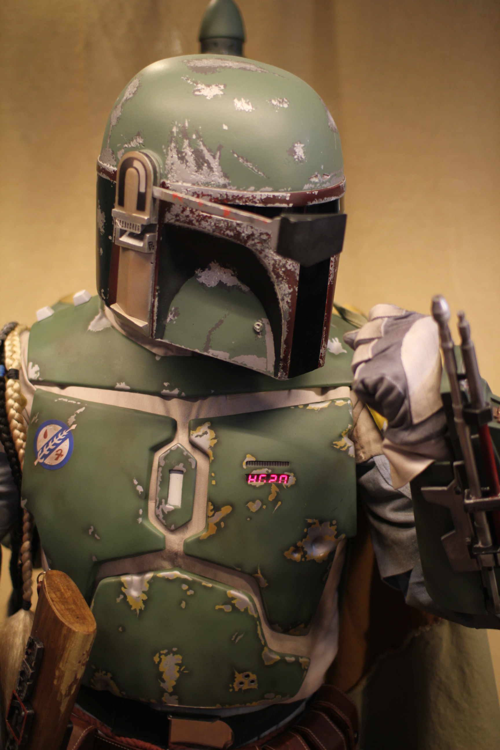

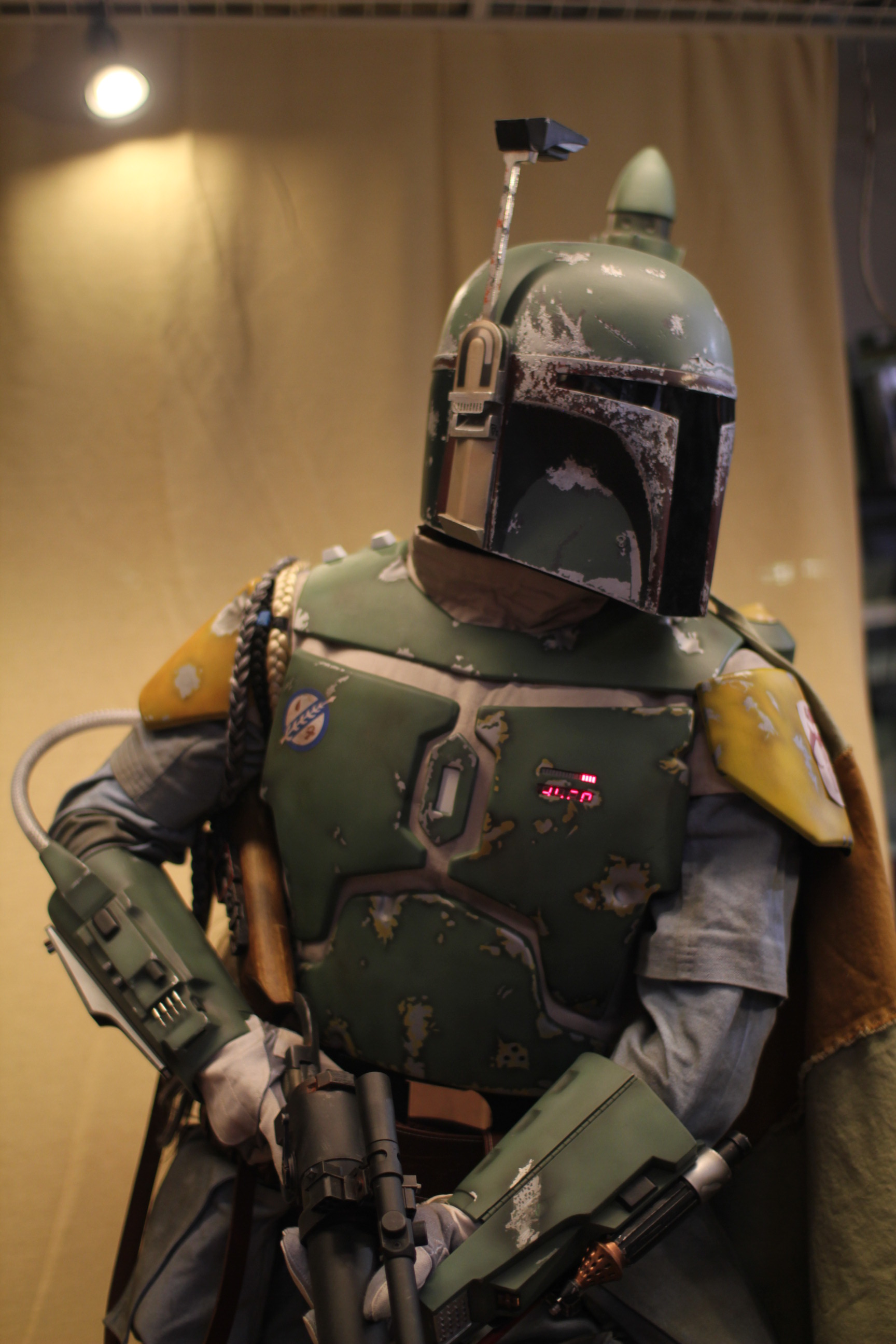

Some color tweaks were still to be done all over the costume, I painted the top of one of the collar studs red and also the knee launchers to have those black and red details. Cod piece still lacked the white studs on the hips so I made and painted those and installed them to the armor. Locitus suggested I should add a dirty "glass" or a clear visor to cover the chest lights, so I cut out a sheet of plastic package material, sprayed some weatheringon it and slided it between the armor and the lightboard. Finally we did a "quick" test fitting and took some pics of the costume. It's pretty close already...

Wow! This is looking great on you!
I like the weathering on the JP and the blasters! Nice effects!

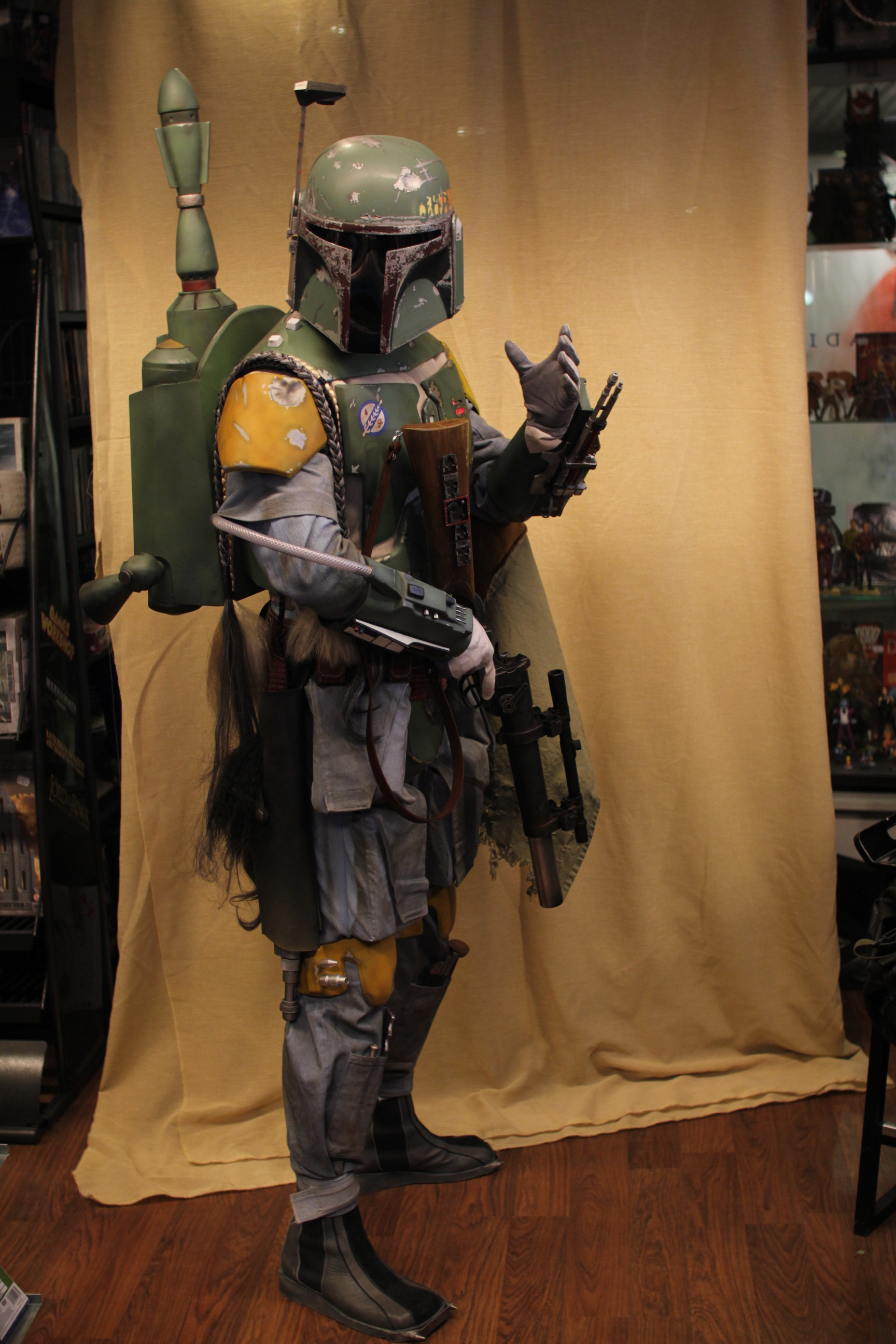

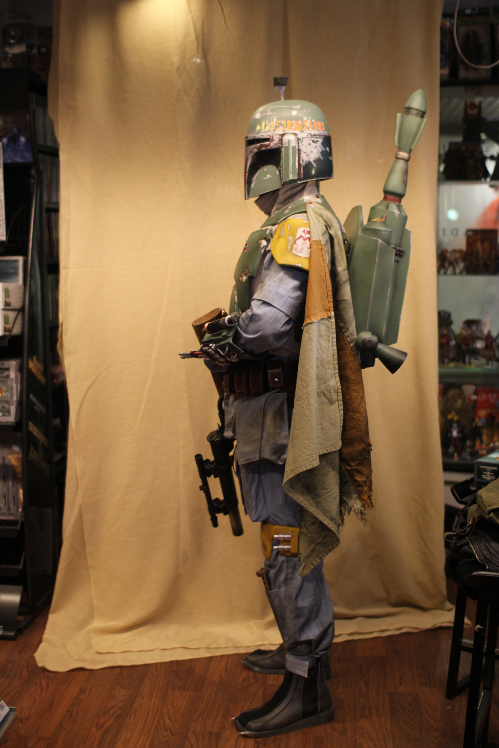

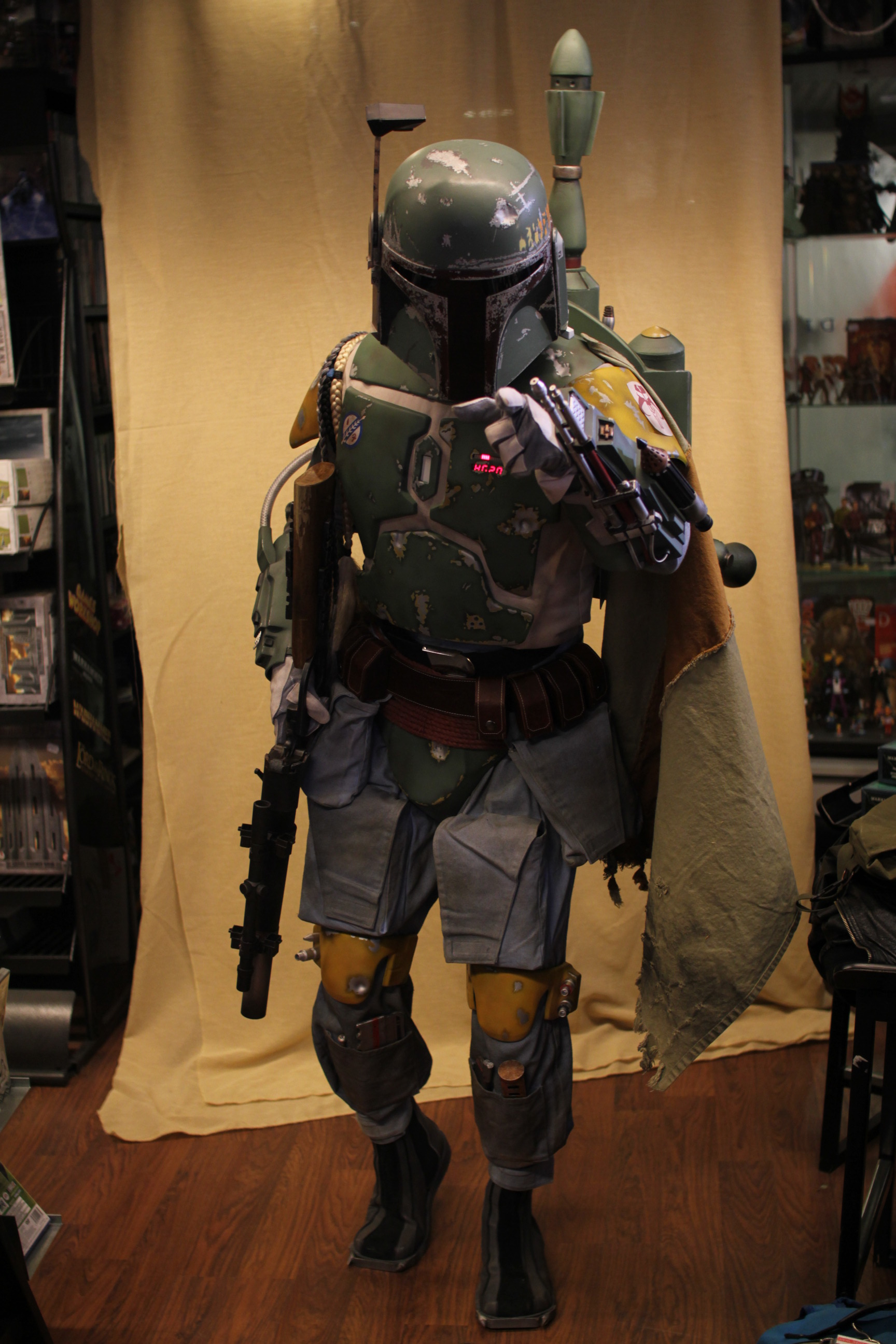

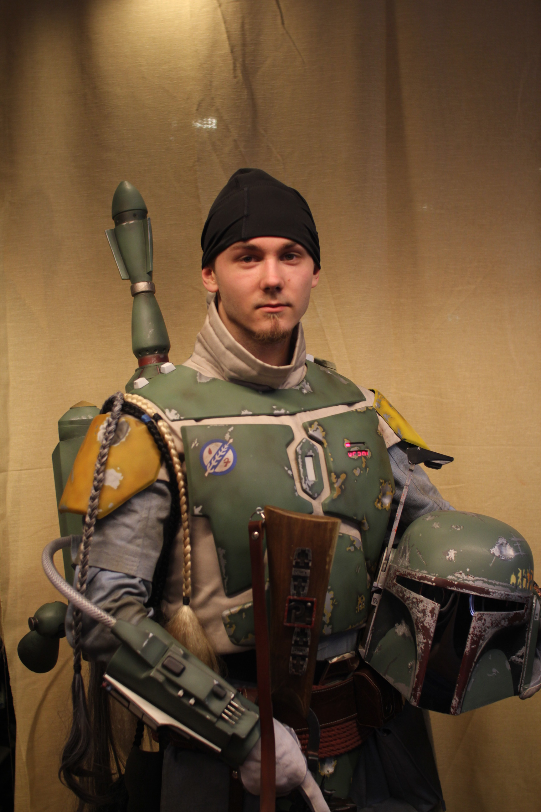

Today I installed the last required costume components! We held a photoshoot and I got to pose in the completed costume. Holster and helmet upgrades are on their way, but they will proceed in the background. As I've learnt from here, a Fett costume is never completely finished, but now I'm just gonna lean back, wait for feedback or correction instructions and enjoy the newly completed project!
Tired but happy. :)

Looks amazing! Well done!
One thing though.... i may be wrong but i think the neck seal should be a little tighter fit around your neck.

Thanks for the feedback guys! I'll definately keep it evolving and am open for any and all suggestions and ideas. It will be a long run campaign to make it better and better as the time goes forward. :) I'll see if I can tighten the neckseal some way. Any other improvement ideas?
