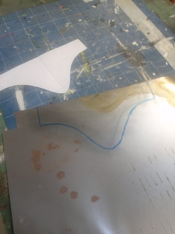

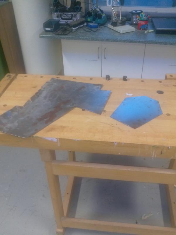

I never intended to buy any armour pieces, nor the helmet, so basically everything pictured in this thread was made by me, in my school's workshop or at home, on the floor, where I work best. My first plan was to make all the pieces out of worbla, but after some consideration I decided that only the armour plates would be out of worbla and the helmet either casted in resin or made out of fibre glass. My plans changed however when I, one day, stumbled upon some 0.8 mm steel plates laying on one of the "pick what you want and use it for whatever you want"- shelf at my school's workshop, and the idea of an all metal Beskar'gam came to me, and so, here it is, the start of my all metal Mandalorian!

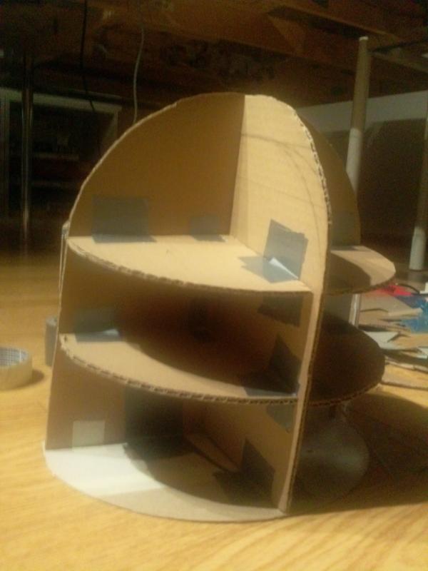

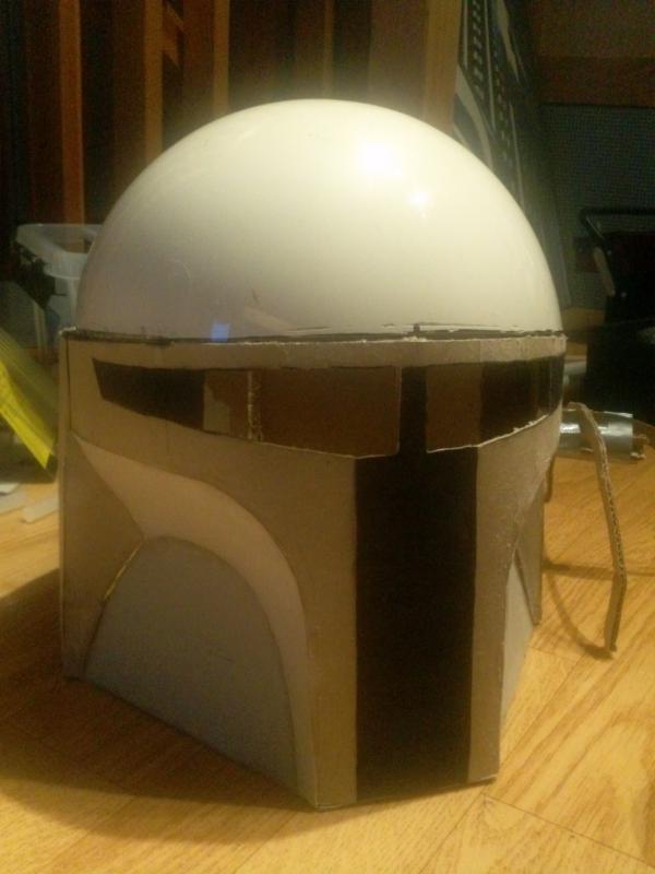

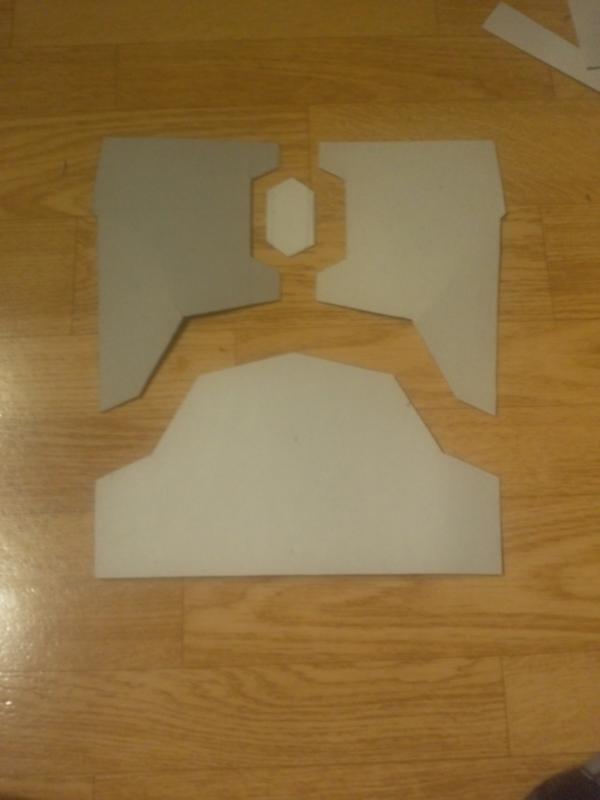

I started making templates of the helmet and the armour pieces out of cardboard...

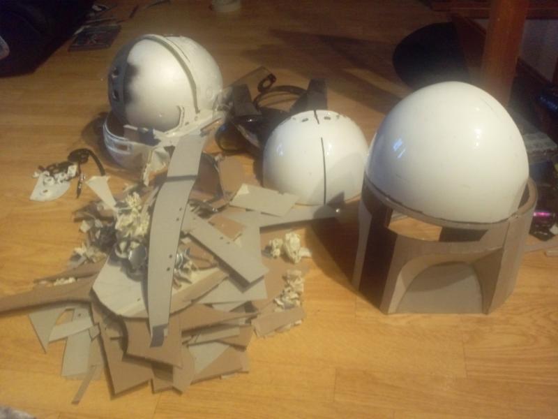

After a few days and a whole lot of cardboard, three versions of the helmet, and one destroyed racing/motorcycle helmet (to get the dome good), this was what I ended up with...
And don't worry, the T visor will be cut out as soon as it can be cut out without risking destroying the whole thing...
I think I got the size out pretty good, it's perhaps a bit too big, but it's alright for now...

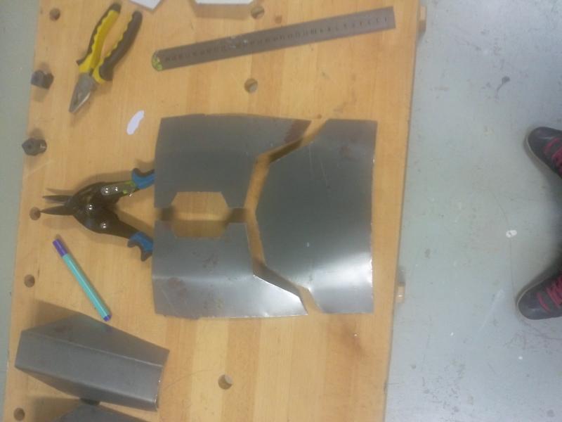

And so, on to the armour plates.. Templates were cut out of cardboard for these too, and my first plan was to make them out of worbla but...

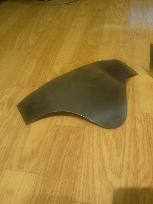

...this happened...

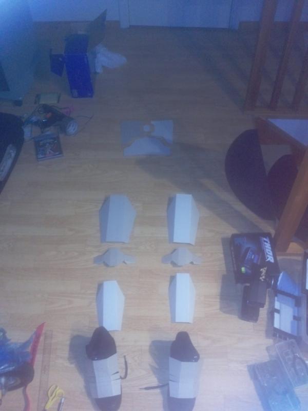

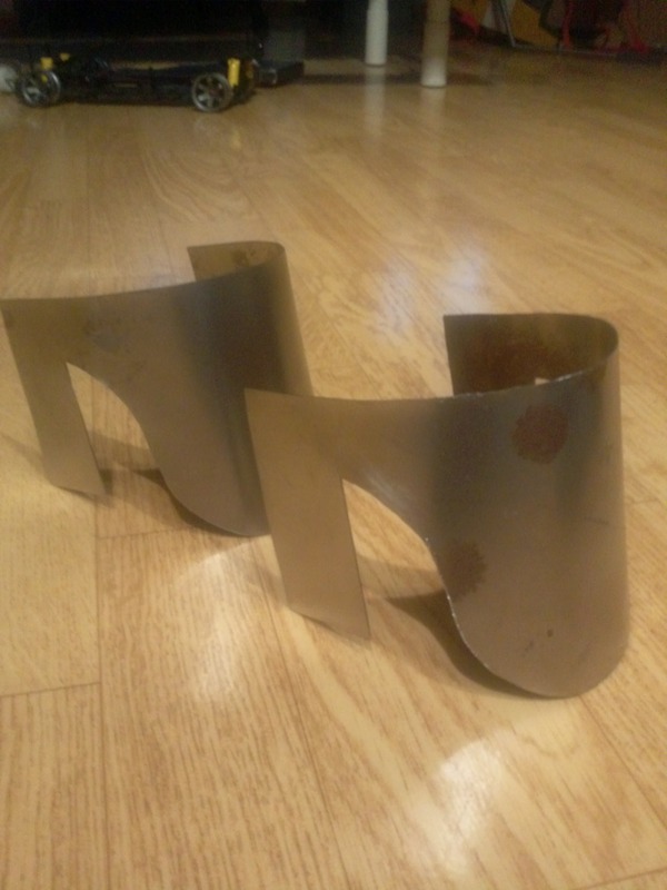

Did some test fitting of the leg plates using neodym magnets.

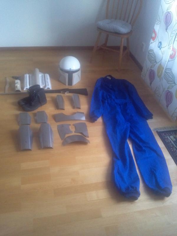

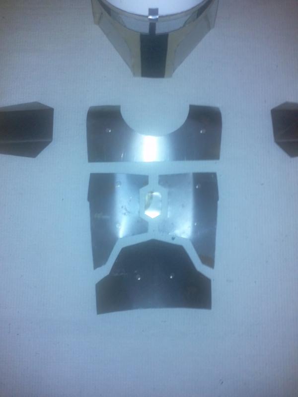

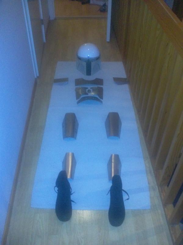

And here is the armor plate set, almost complete. Still missing is the knee pads, the backplate, some bootplates and the cod plate (I think it's called that.. If not; the crotch plate) and the gauntlets.
So yeah, this is where I'm at now, with about 25 hours spent so far. My prediction is that it wll take about 150 hours to finish everything, but we'll see about that in the end.. I'm hoping that my first version of it will be finished in the end of February 2015, as there is a con' here in Sweden which I'd like to attend with it. This first version will most likely not include a jetpack, but with that said, I'll probably start building that along with all the other things anyway.

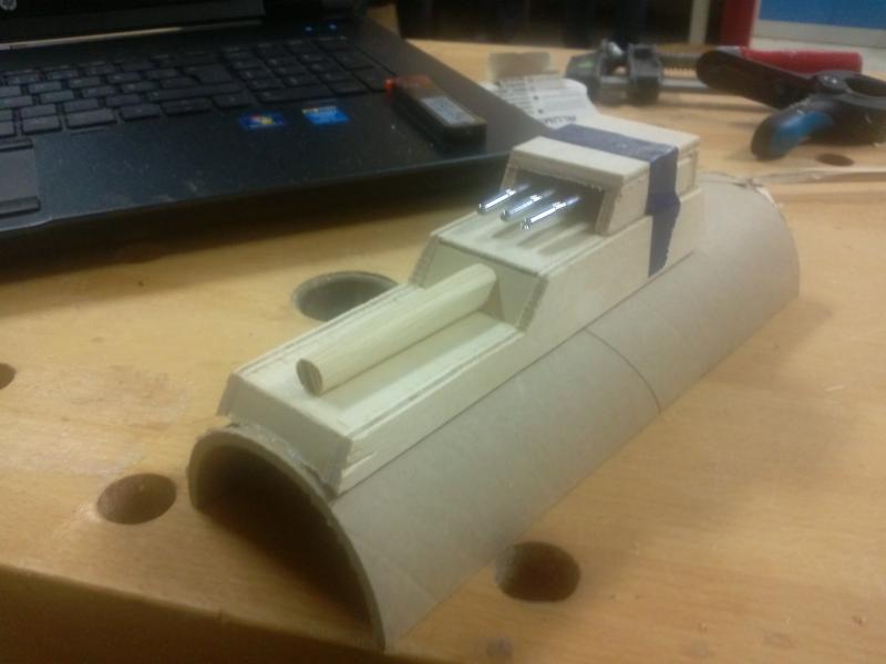

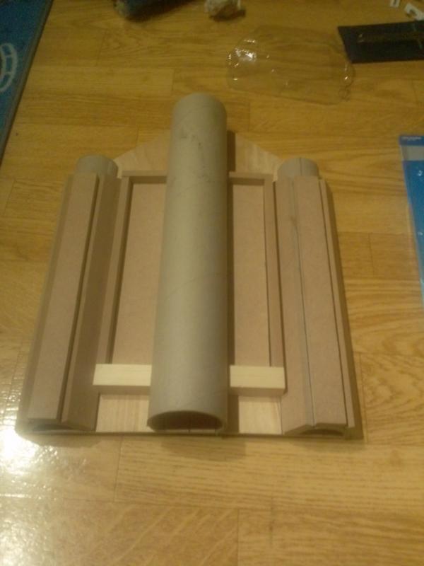

So after a few days of hard studying (university tests are a rea pain in the a** when you want to build cosplays...), I finally got around to work some more on my Mando. So today I've been making the first of two halves of a jetpack, and kind of a dagger or knife, took about five or six hours to get where I'm at right now.
Started out with this, two half pipes, a piece of plywood and six pieces of MDF board.
And added a three quarters of a pipe in the middle.
And then some pieces in between all the pipes.
And then I filled all cracks and such with filler, though only one layer on so far.

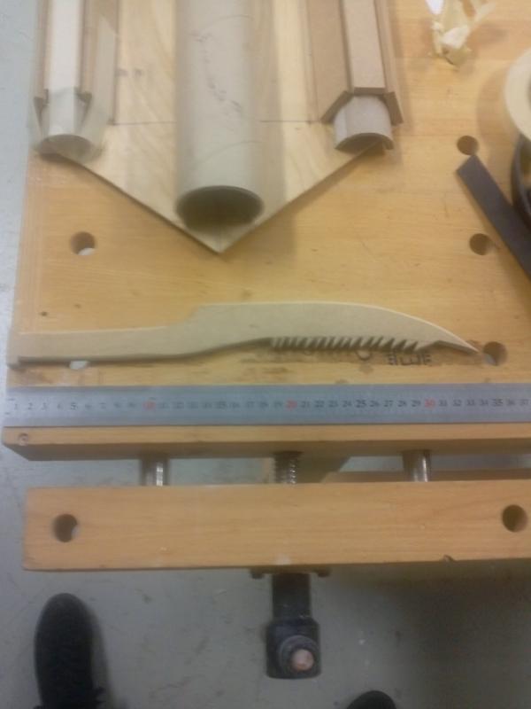

And while I waited for all the pieces to dryg from gluing, I started with a small (34 cm) blade/dagger/knife...
With some more details and a leather wrapped handle I think it's gonna look great...

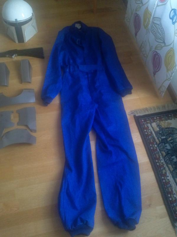

I got a hold of a racing suit which will have to due instead of the normal flight suit (it's nice to have parents and grandparents who has been racing for decades..).
I'm pretty satisfied with everything as of now but there is a long way to go. There's about 35 hours of work in it so far, with up to 120 more to go... My hope is to have it mostly finished by February, but we'll see about that...

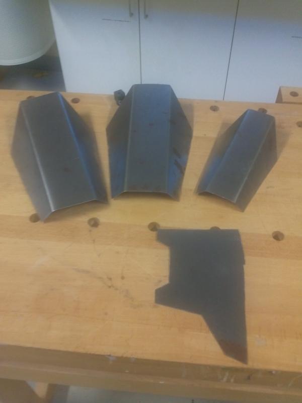

The COD piece is made, I'll get a pic of it finished later today...
And the knee pieces are being made today, one is basically finished.

Made the other knee piece yesterday...
And a pic of the COD piece.
With these pieces done, the gauntlets and back piece are the only armour parts left to finish. I might not do the back piece at all and just have a cape or the jetpack with some pieces behind it, I'll have to look into that.

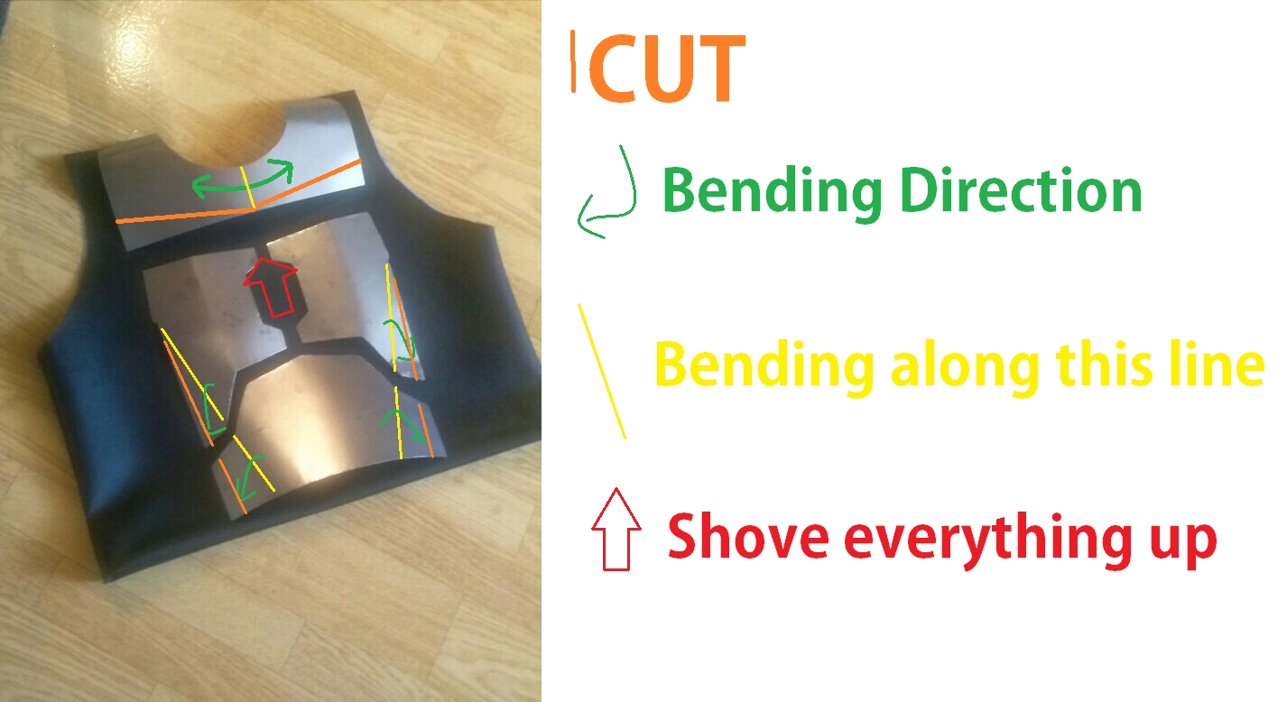

Writing how you can improve your Breastplates would take so long....
so i made you a sketch.
the idea is to cut the sides of the lower plates in an angle. You are small frame bodytype so you can get alot out of a elaborated waist line. The rest does a Knick-bend along the yellow line of the brest and abplate (it will also harmony with your edgy bended Leg-plates)
The Neckplate could be a litte more round- bended in the middle to extend the shape of the upper chestplates. - the lower edges of the neckplate will eventually collide with that overall look -> thats why Bobas and Jangos Neck are acually Pointy on the lower middle-point. Cut away what blocks the way. :D
Also i think the inner line where your Neck lies is way too tight.
Either you make the hole bigger to avoid cutting your throat when trooping -> or you take a look at old medieal Armors how they managed to handle sharp edges ;-)
Jaro Krieg: Thank you vey much for the input! The plates have been shoved up about 1 cm since the pic was taken, and the neck piece is going to be altered quite a bit; basically everything you suggested is going to be made :)
