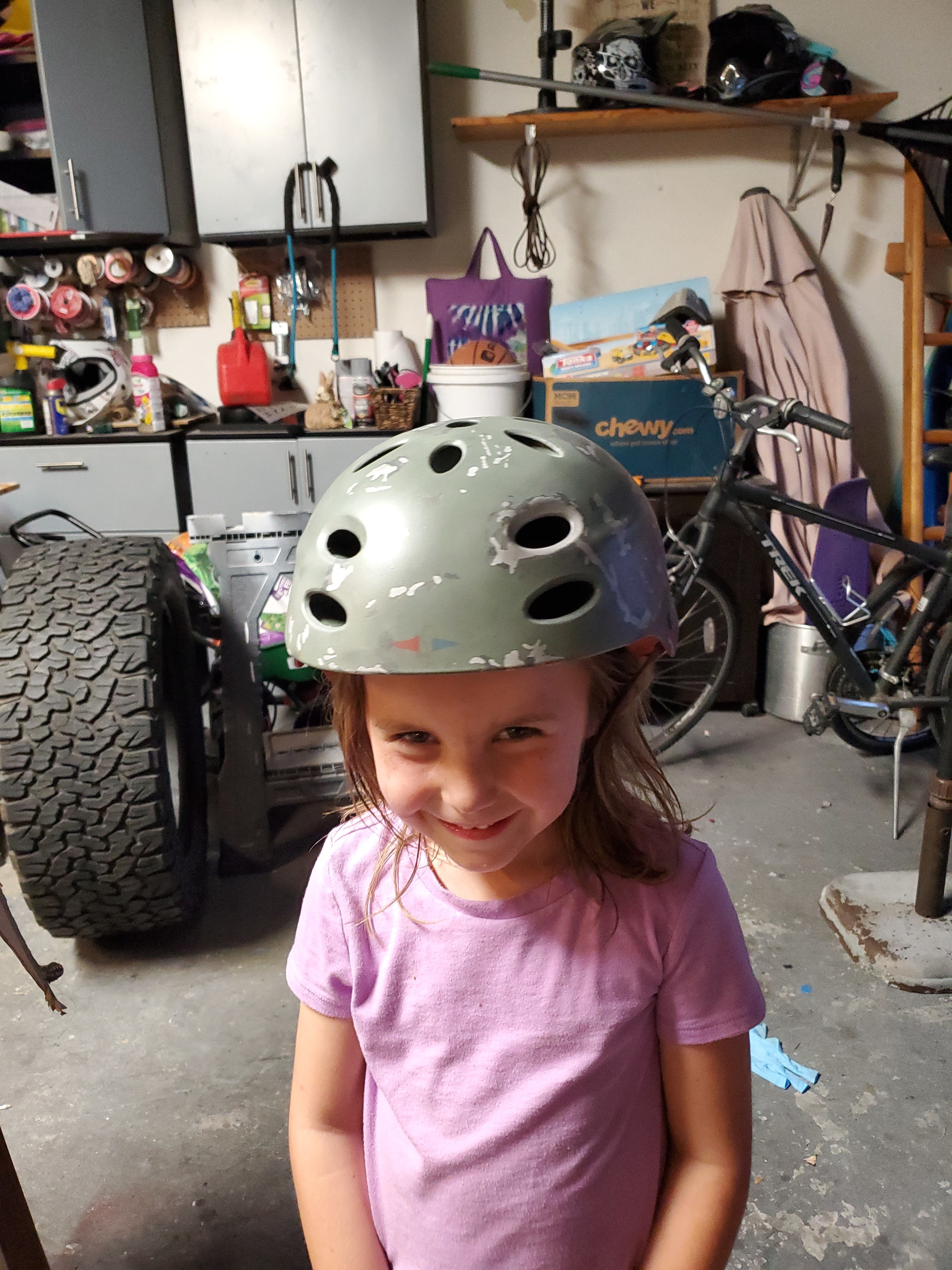

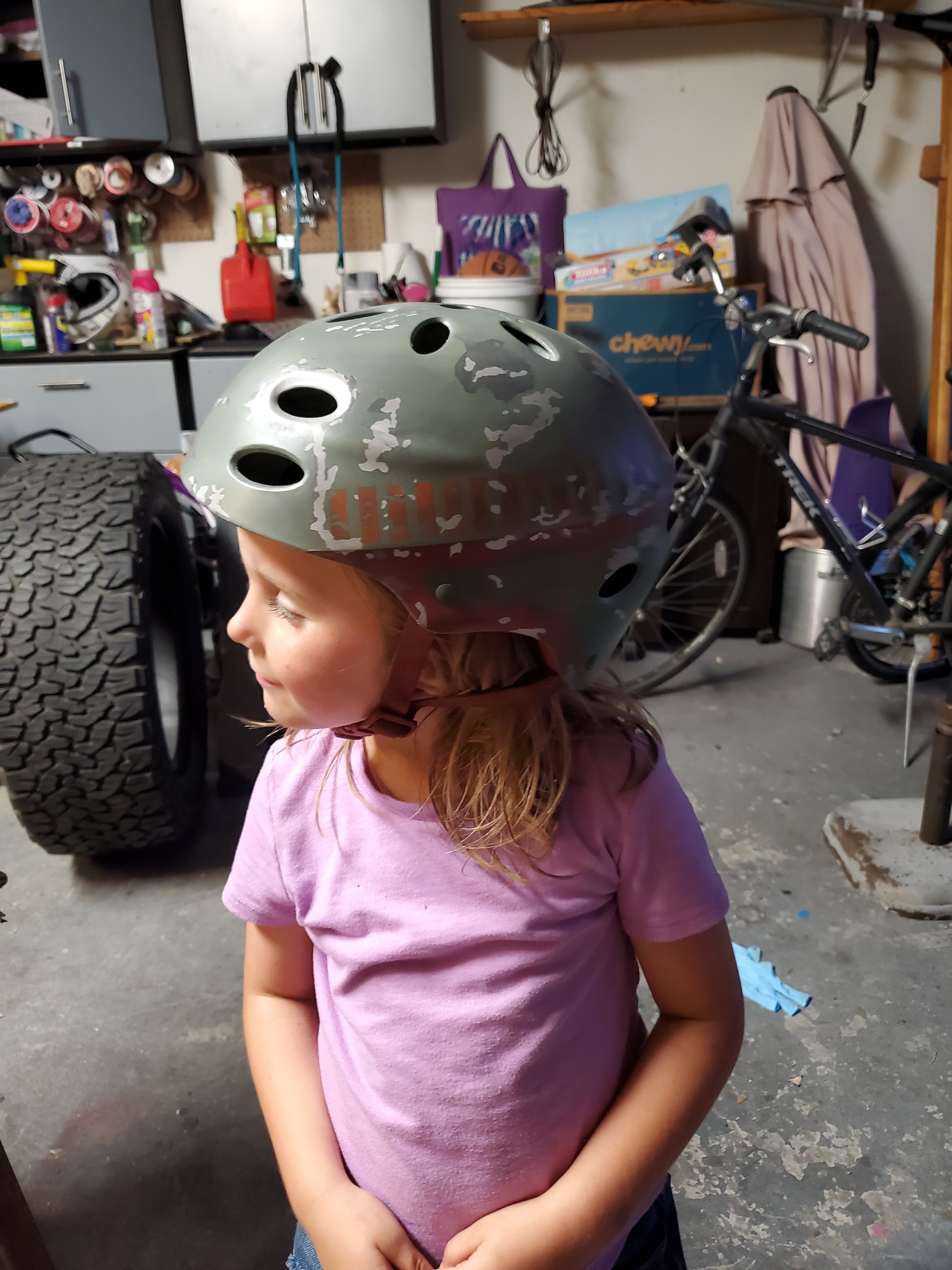

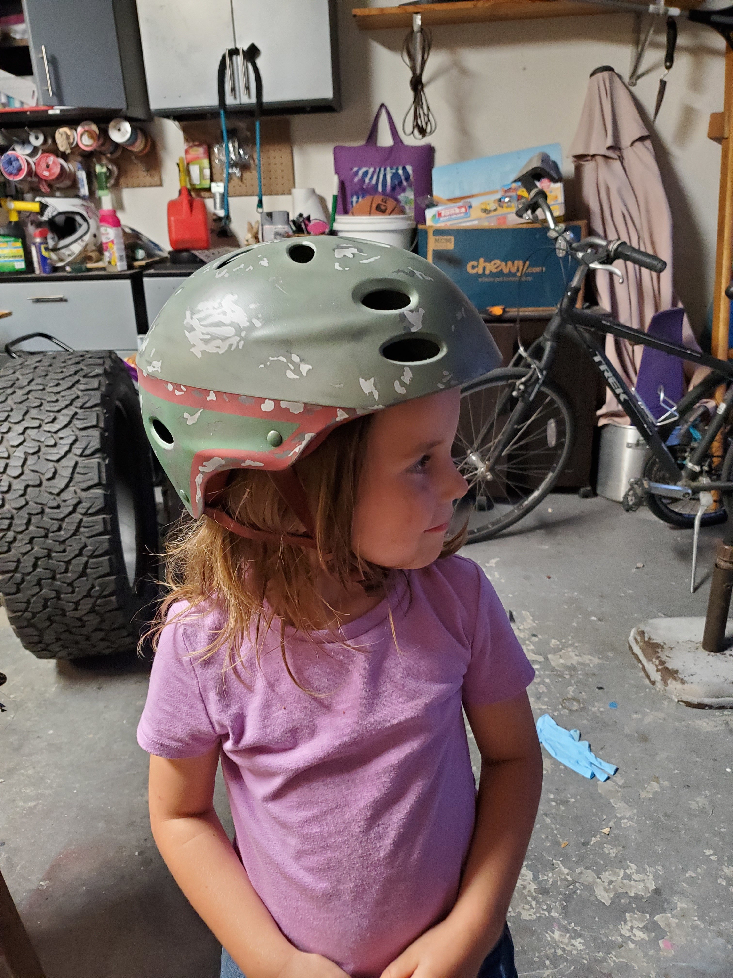

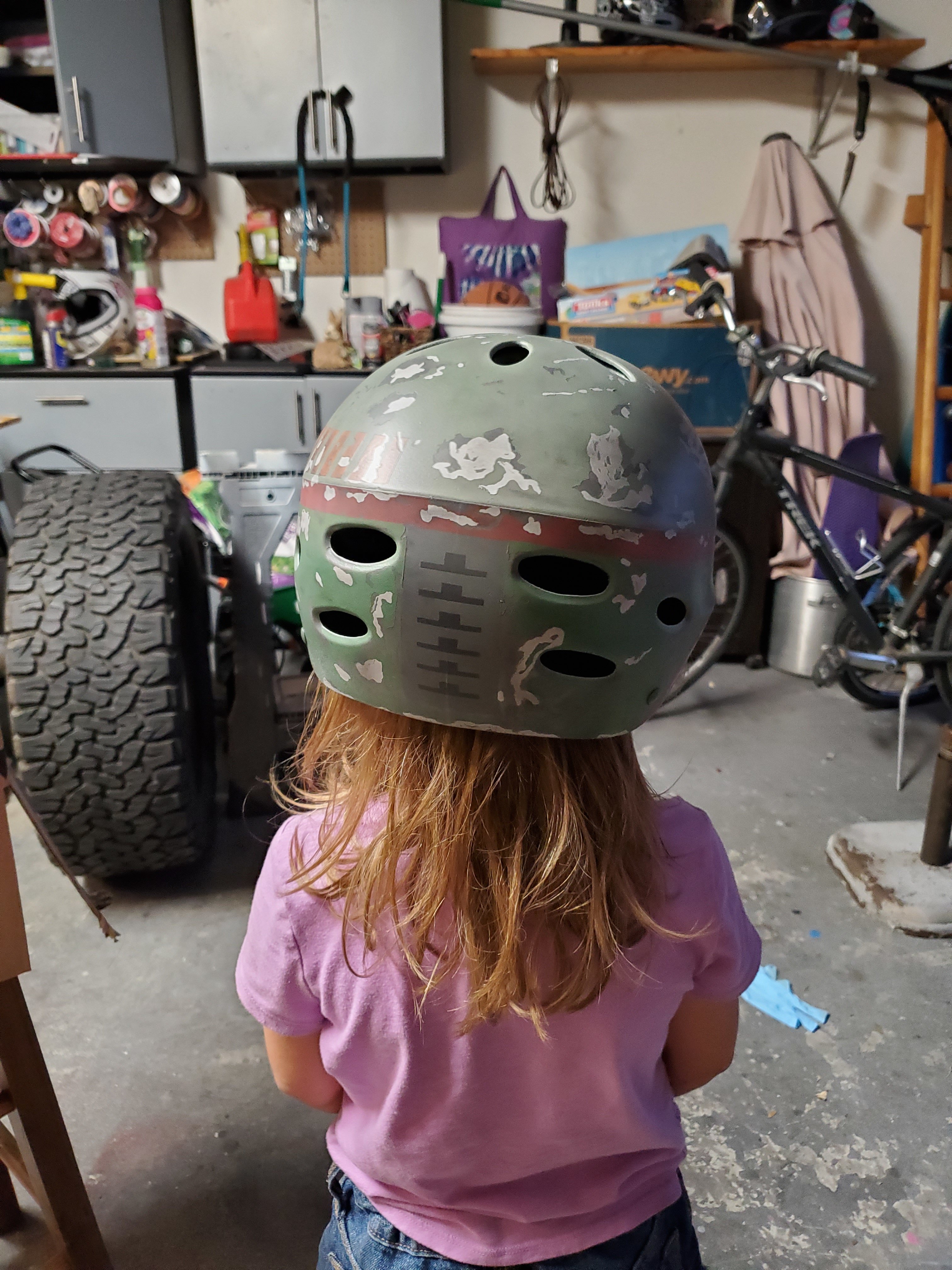

Hea guys, I didn't realize but I guess I have two accounts because I'm Jvala. Any way,
I finally got my painting skills up to par.
First I made sure my paint was thoroughly stirred up before I mixed my portions.
Second I switched to mineral spirits instead of paint thinner.
These two thing made a world of difference. Not only does it come out smooth (without brush strokes), but I don't use near as much paint as I did before. Quite a money saver. So I did some practices on my kids bike helmet and it came out great. Not 100% accurate but it looks amazing. Eventually I will paint another bucket for trooping and give the one I have to a friend. Here are some pictures of the bike helmet
