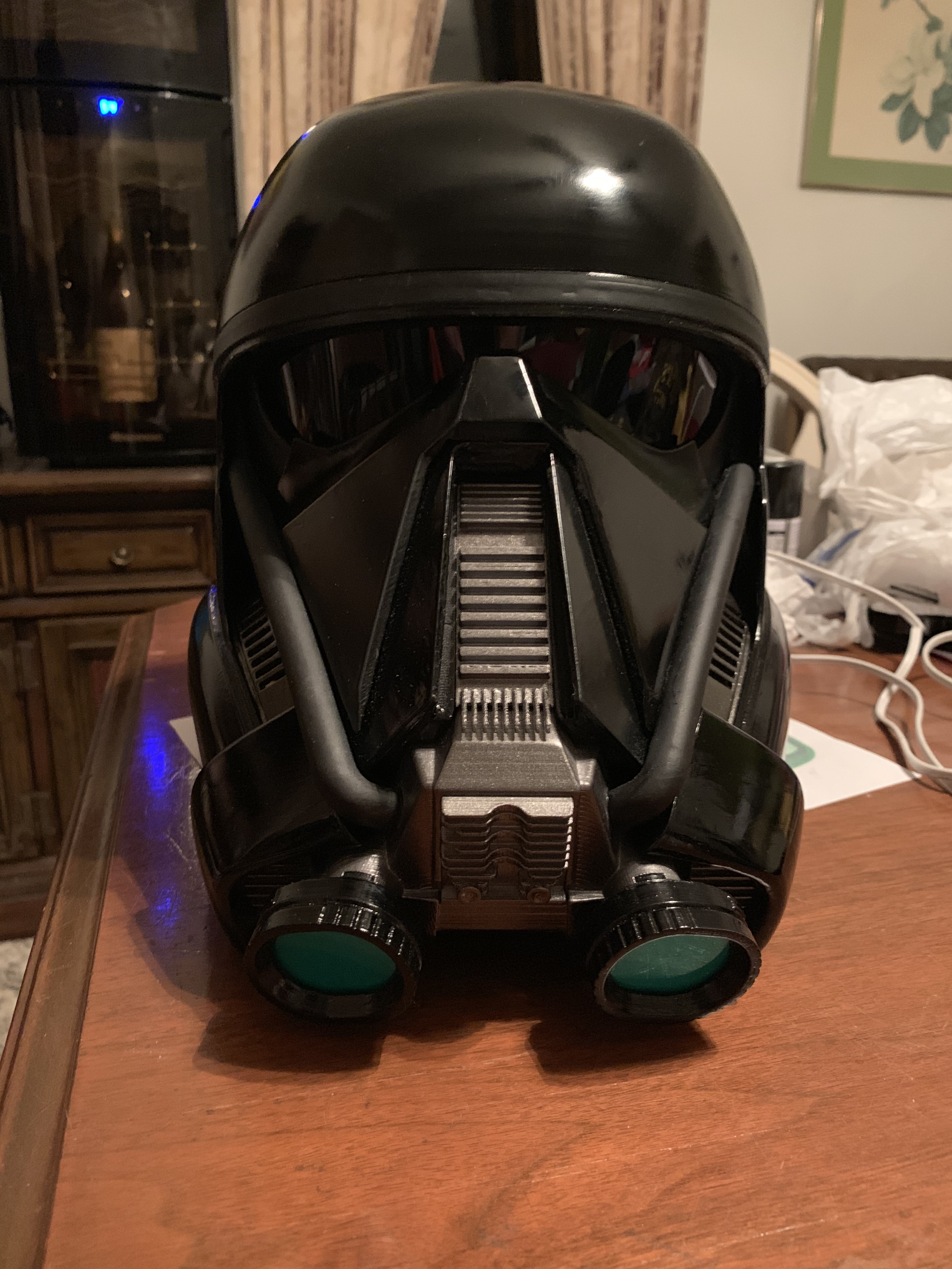

This was printed on my CR-10S in PETG. It took a while to get the gloss shiny, but overall PETG isn't too bad to work with once you get your printer amd slicer settings figured out.
Would you be willing to share what settings you typically use to print armor at as well as the slicer info? I just picked up one of these off a buddy recently in a trade (though Im not sure if its the regular 10 or the 10S) and have a few projects I'd love to try doing on it.
If it has 2 z axis stepper motors its the 10s. PETG needs to print a little slower than PLA so I have mine set at 40mm/s. I use Cura becasue I'm too cheap to spend $150 on Simplify3d.
