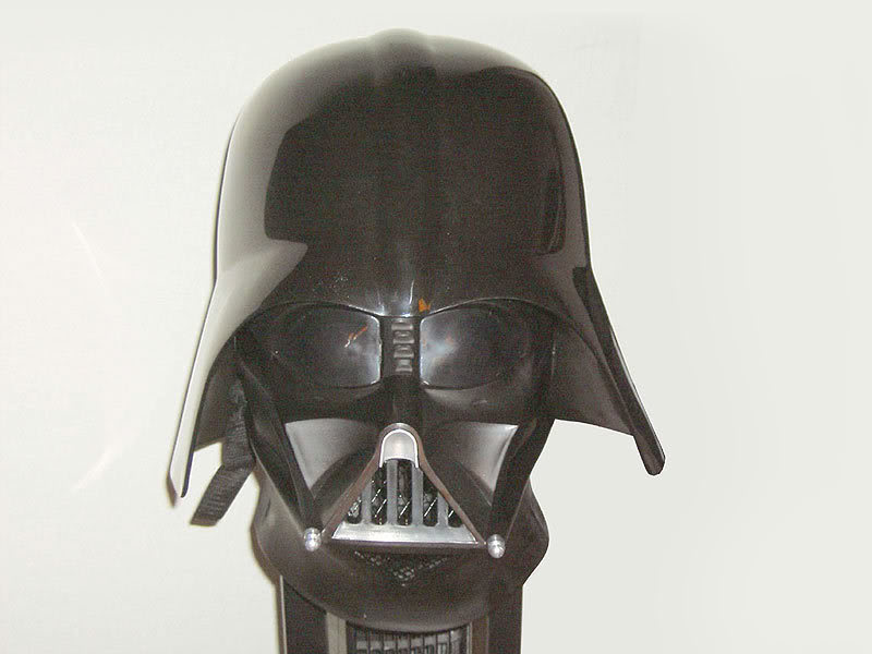

Hi Rob, I got your PM, asking if heat treating a Rubie's mask would help in your modification goals. I hope it's okay that I post my response here, if it'll benefit more than one person. Please bear in mind that my background has primarily been Vader and not Fett products, so with things specific to Fett, I'm going to have to differ to the expertise of others here on TDH. My direct experience is using heat to modify a Rubie's Supreme Vader. Perhaps someone can confirm that Rubie's used a similar or the same vinyl material in their Fett helmet.
My guess is that you saw one of my posts about bringing a heat gun into the equation to modify the shape of a helmet. If the question is "Does heat treatment of vinyl plastic make it stronger and more rigid so that I don't have to reinforce the interior" then the answer is no. I hope my post didn't cause anyone to come to this conclusion. Please allow me to clarify.
Heat makes only certain plastic more supple so you can manipulate it. Cooling it rapidly under water allows you to "fix" its new shape into position. If you don't and if you want to hang around and allow it to acclaimate to room temperature and you don't mind babysitting it, when it eventually returns to room temperature, the material will resume its original hardness/toughness/rigidity. However, heat does not increase rigidity. Even after heat treating my Rubie's Supreme Vader to reduce the width of the skull (ugh!), once cool again, it was still as tough and stubborn as anything, but it was like that in the first place. The cooling process (running it under cold water after exposing it to heat) will merely restore it to its original level of rigidity, and this method just shortens the cooling time.
If the question is: "Does it work with manipulating the shape" the answer is yes it was successful for me. For example.
BEFORE
AFTER
(Above: how it looks after heat treatment, photographed about 4 feet away).
Now here are two "gotchya's" (possible pitfalls) to using heat to modify a vinyl helmet.
1. You must be patient. It's a bit of a "feel" thing. You do not want the heat gun too close to the plastic, otherwise it will melt or blister that area. You want to move the heat gun around and evenly distribute the heat as much as possible. Eventually there will be enough heat build up even if you don't focus the heat in a continuous blast. You will start seeing the plastic sag, and when you do, try to manipulate it there with oven gloves. If it's just about the right shape, then run it over to the kitchen faucet and cool it while holding it in the shape you want. You may need a few tries.
2. If there is any kind of fine granular texture to the plastic, it might melt under this process. But if you're going to sand it, prime it, and then paint it, then more power to you!
3. You want to heat treat not just that immediate area but the surrounding area. People have told me that they manipulated something with heat, but eventually the memory of the material asserted its original shape. Doh! Well, two possible solutions here. If the surrounding areas were asserting their memory, then you soften them with heat. But if the immediate area still has memory, then it may take a second time. Or perhaps insufficient heat was used.
