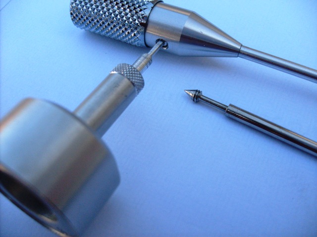

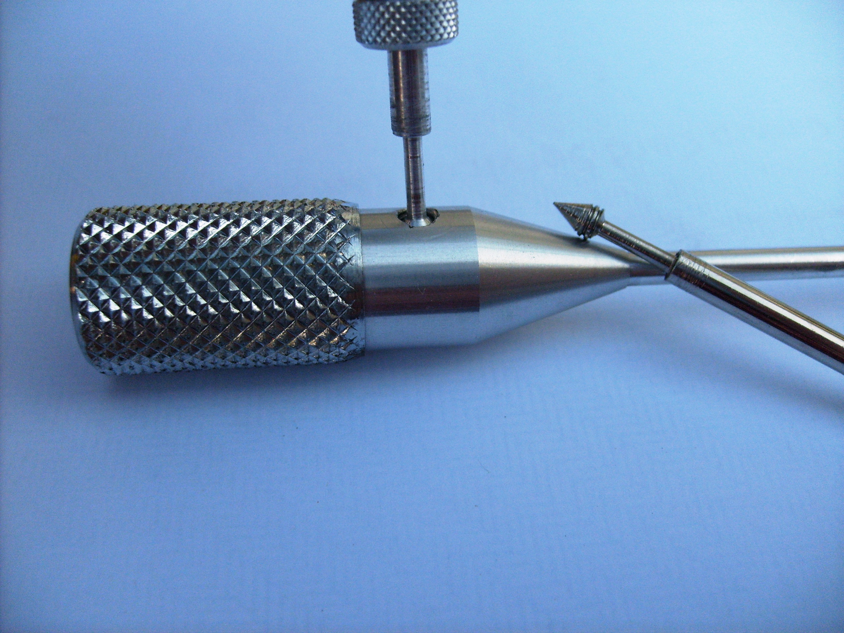

A couple of pics...

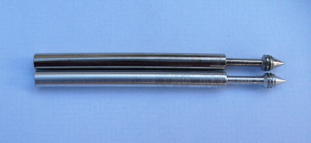

Cool.
Is there any way you can take some larger close up pics of the pointed end side by side with the real one?
I can try... :facepalm
The only other thing I noticed and forgot to say in previous post was that the original has 'flat' peaks on the thread form and the prototype is pointed... therefore he's gone in slightly too far (0.2mm) and compensated in the O/D hence being 0.2mm smaller...
One funny(?) question. The replica dart fits on your replica stabilizer? Would be funny to take some pics of a replica sweeparm :D I just need your replica knee dart :lol: (and the wirst dart, of course).
